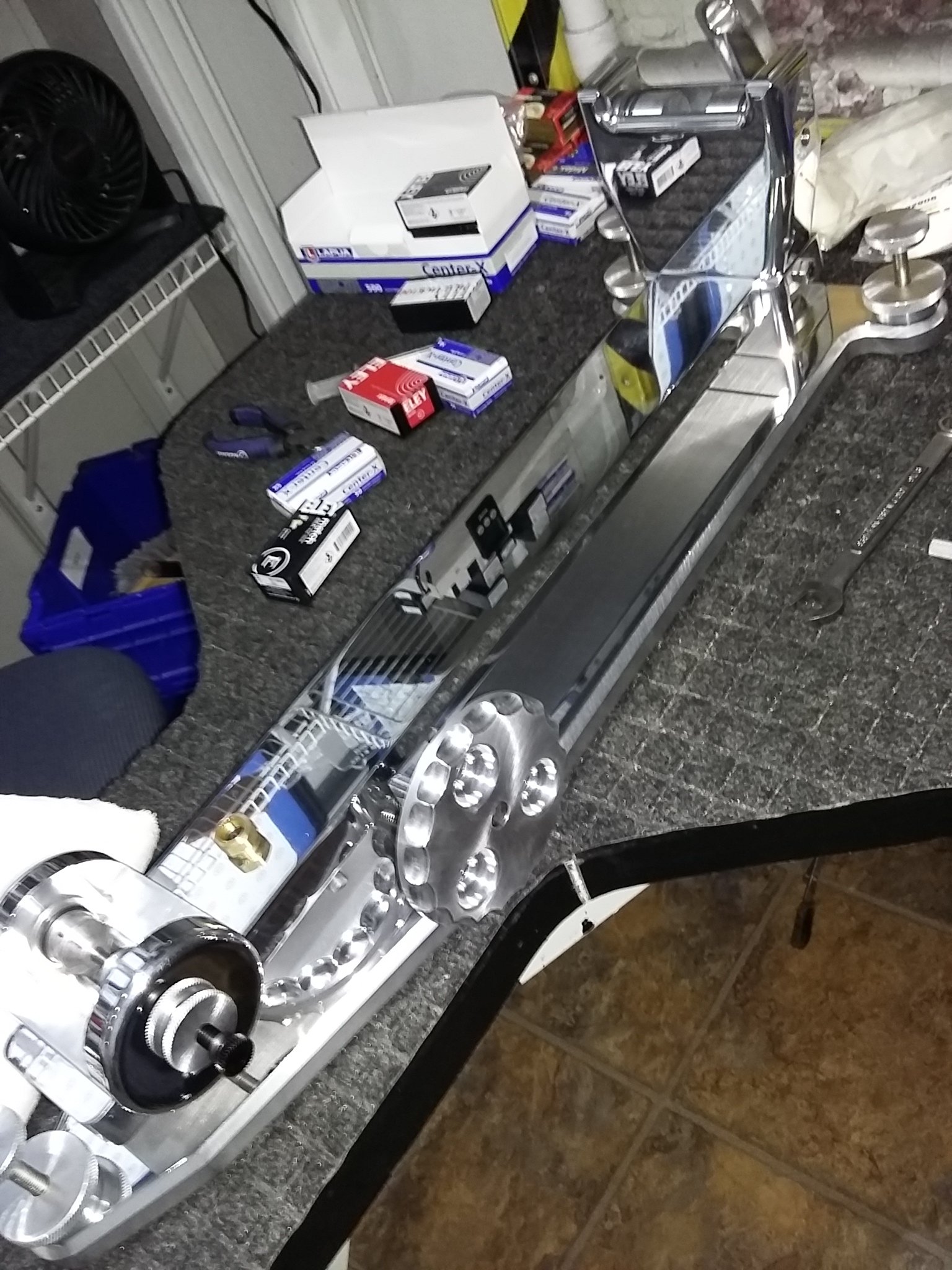

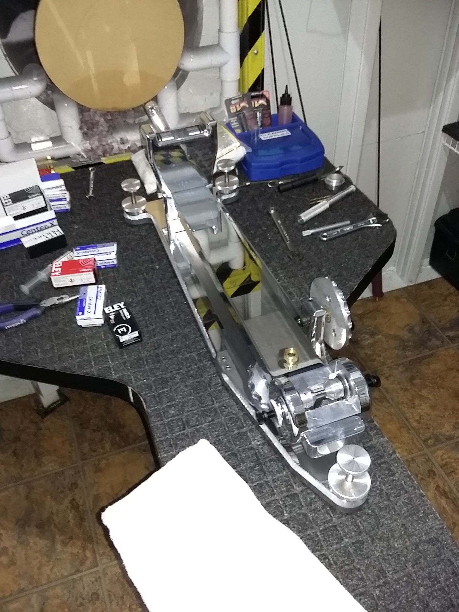

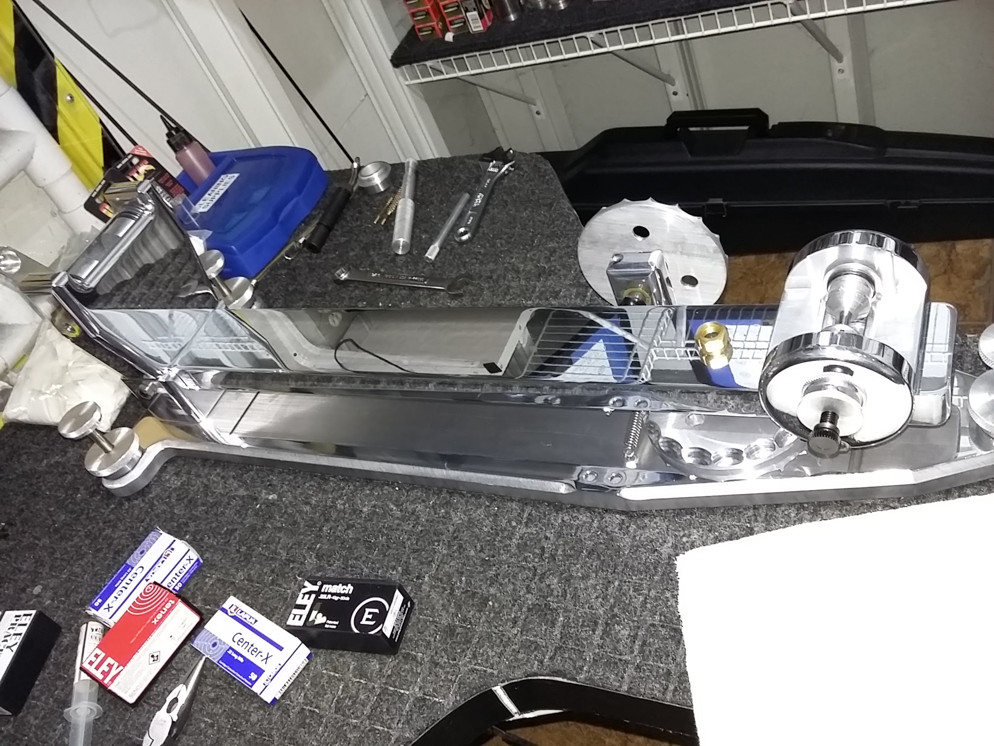

Ok , my question, if you have thoughts. Regarding only MI or aggressively MI.
Not any specific. Muller, for instance, makes a couple configurations that are MI....the 4 & 5 groovers are, the Shilen ratchets are somewhat.
In the strictest sense, any time you get away from lands that stand away from the grooves at 90 degrees and flat across the top is closing in on an MI type label, anything with shallow lands is, I guess, there as well.
