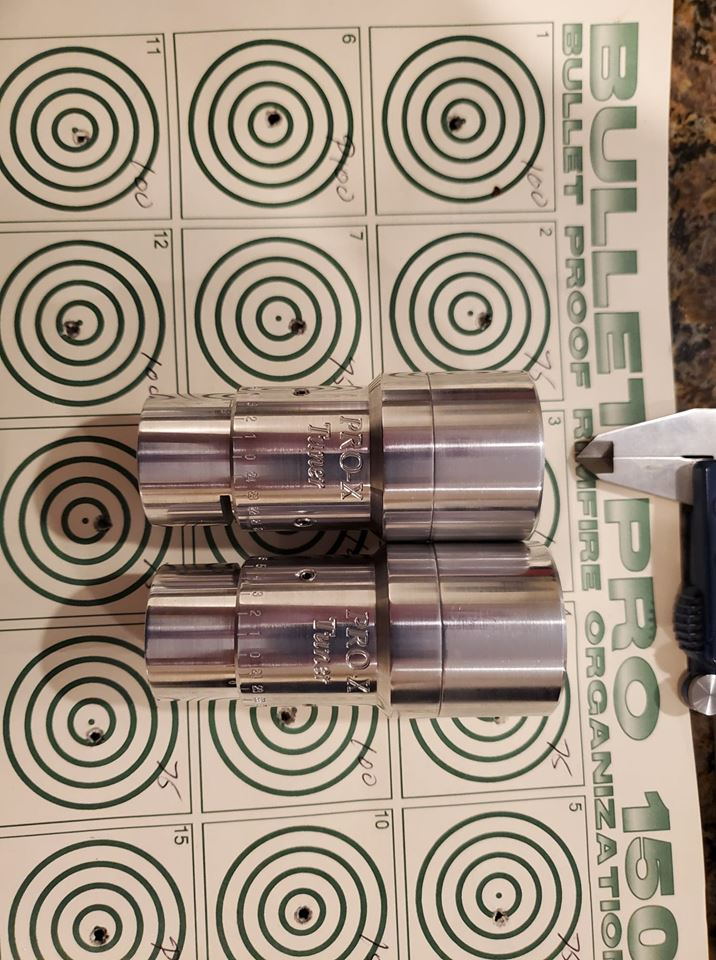

Here are my Tuners, both rifles will be running Kahles 10-50's and I to am using the Ratchet barrel and FF trigger.

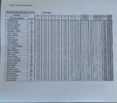

Congrats to Greg Monroe and his Ivanhoe Rifle for winning the Missouri State Tournament with 2350 AGG...Very nice!

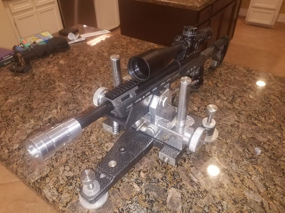

Ok fellas, lighting it up as promised. I carried my V-22S barreled action to KY and Jamie at BBRS did a bang up job on the stock. Once it was all together, we went to Ivan's tunnel to see what we had and it certainly didn't disappoint. We put a tuner on it, ran through the range of the tuner looking for key signs of what this thing likes and after we had it in the ballpark, shot a few rounds from three different boxes of Eley Black Box. Then, I shot my first ever BR card for score and turns out, we have one helluva competitive rifle on our hands. Still a bit of fine tuning left to do, but this rifle will be in St. Louis in early Sept.
V-22S Single Shot Action
Mueller Barrel (yes, this is one of the four I slugged early on and after a wee bit of finish lapping, I'm likin' it)
Pro-X Tuner
Vudoo/Flavio VS-BR Trigger with Vertical Fire Control
BBRS Custom Stock
I know a few guys have thrown around the question, "yeah, but is it going to be competitive?" Well, I do believe so....
Thank you Ivan Wells and Jamie Burgess for an incredible amount of work in a really short amount of time. You guys have impressed me time and again and I appreciate the hard work.
MB

In preparation for receipt of my VSS I want to order a tuner. What is the barrel dimensions at the muzzle and at 1" back from the muzzle?
You’re quite welcome Trav. As you can imagine, this has come together very methodically and the really hard work in the forefront is paying off nicely. I’m really pleased with how this rifle came together.
Nominal diameter of what we’re using is .900”, but there’s a slight variation barrel-to-barrel. This Mueller is .872” and there’s a .0005 slip fit, tuner to muzzle. So, when you order your tuner, you can use the .900” diameter, but it’s best to order it undersized and have it properly fit to your barrel.
