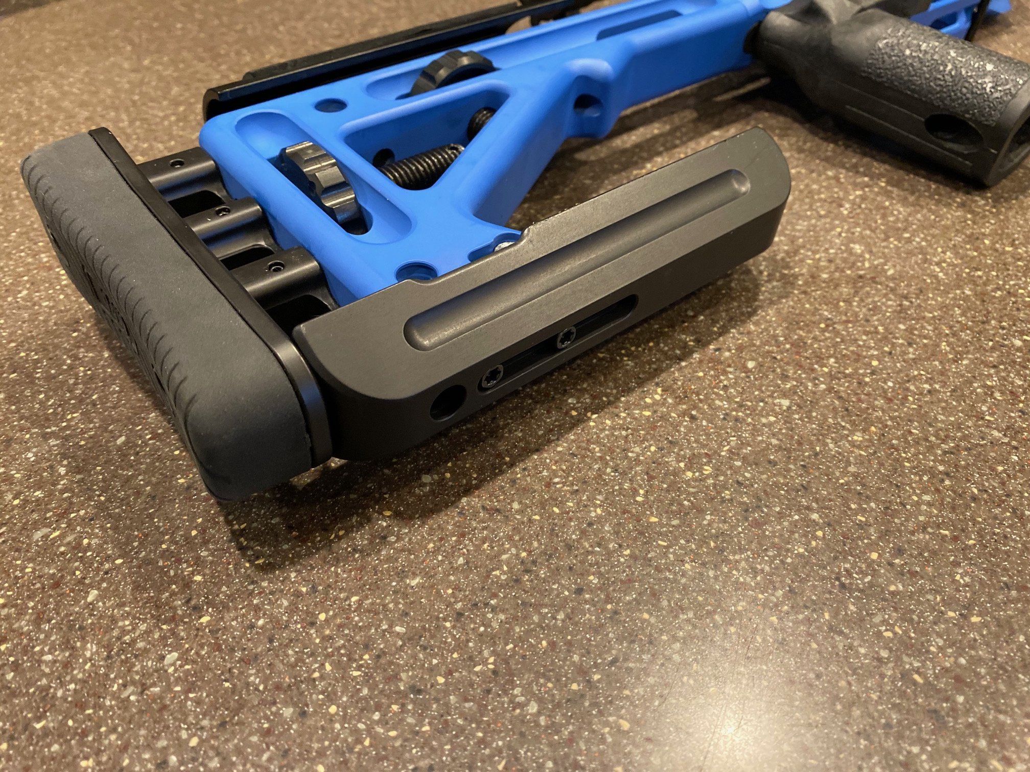

Good morning Guys. A question from a Newby to this sport.
What would be the down side to putting the V22S in a Masterpiece Arms MPA BA Chassis with a good rear bag rider and a good front one?
Is a Chassis/Aluminum Stock less forgiving than a than a traditional BR Stock? BR Stock absorb shock?? What are the pros and cons?

Right now I am running my repeater in an mpa setup for BR. Works great in my one piece rest, but you are correct about the chassis causing a shockwave. I had to start putting my hand on the rifle to dampen it. Tuesday night's ARA match I did the best i have ever done. 2250, 2150 and freak 2400...Our scorekeeper looked that card over a number of times. That was a crazy night and we had started shooting just after a bad storm and the air was awesome. Back to the mpa, I have also had to add weight to keep it from bouncing on the nose. My rest is unforgiving!

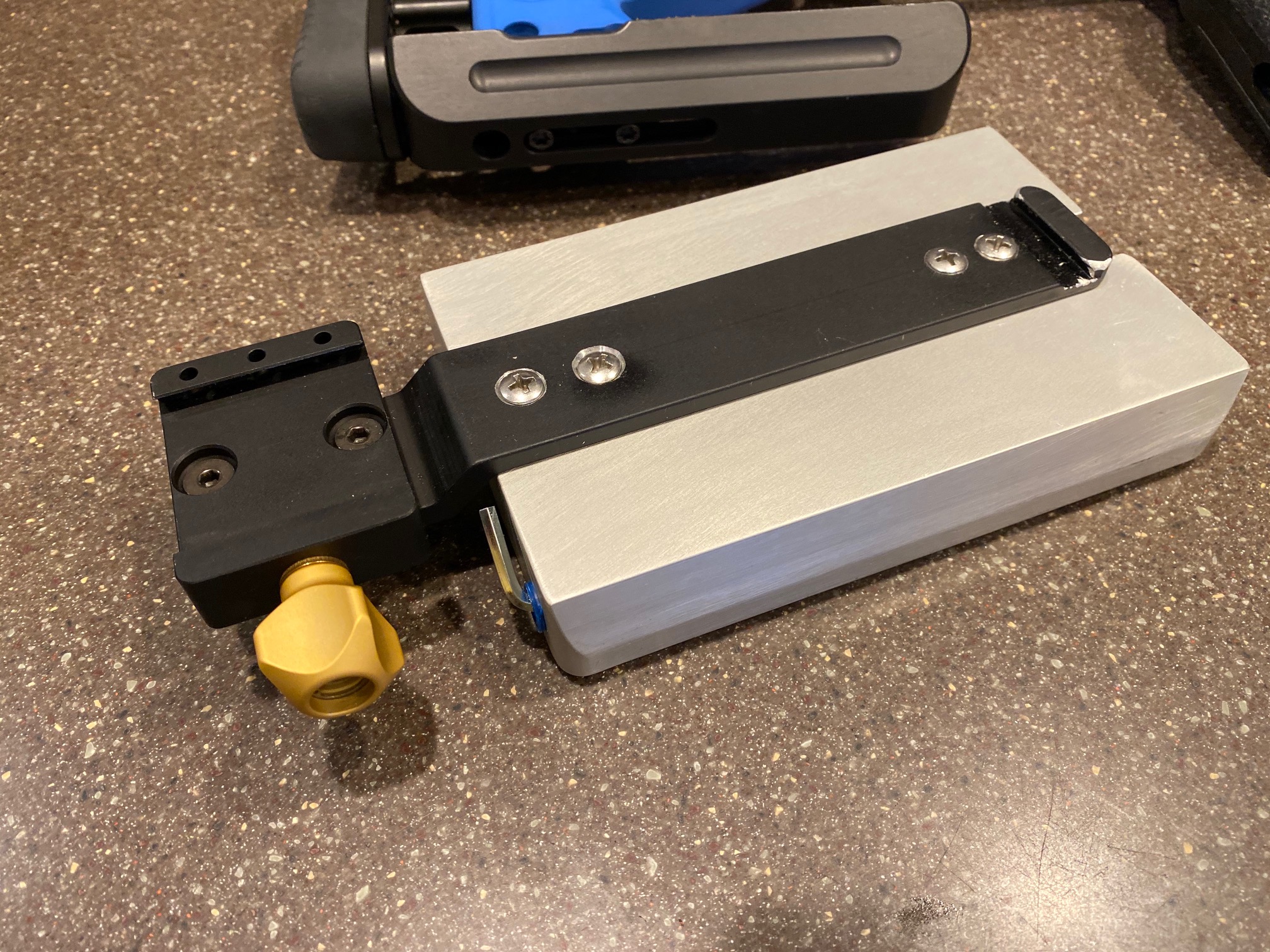

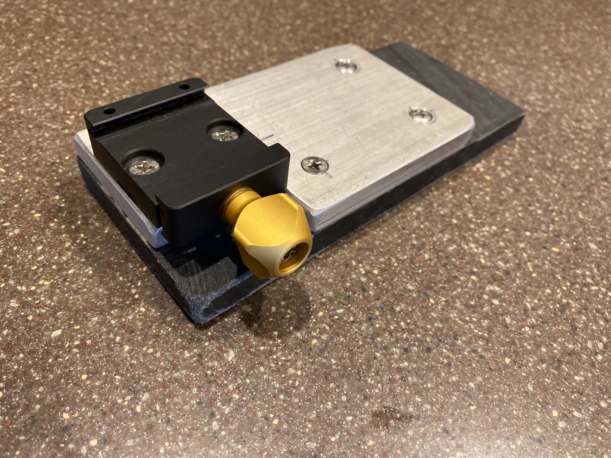

Good morning phlegethon. I have made several. Purchase components and assemble. Purchased the Arca Rail Clamp from Midway. The one on the above pic came off an Area 419 Front Bag. Pic below is another version with UHMW. The Aluminum Bag Rider above came from www.TargetShooting.com. Wally Brownlee. He has 3" wide and 4" wide. I have found the longer ones seem to work better.
Just carefully align. Drill and Tap. Used mostly 10-32 Stainless Flat Head or Oval Head Machine Screws. Aluminum plate as filler and or for stiffness. 4Certain

I am running the MPA front slider, made for BR or F-class and bolt to the chassis. I am also running the same bag rider you are!
Thanks Marks A18138. I saw the MPA Front Slider but could not tell how it worked or attached. Can you take some pics?
I do like that Rear Slider. Tried the other one. It was good. Like this one better.
Thank you. 4Certain.
