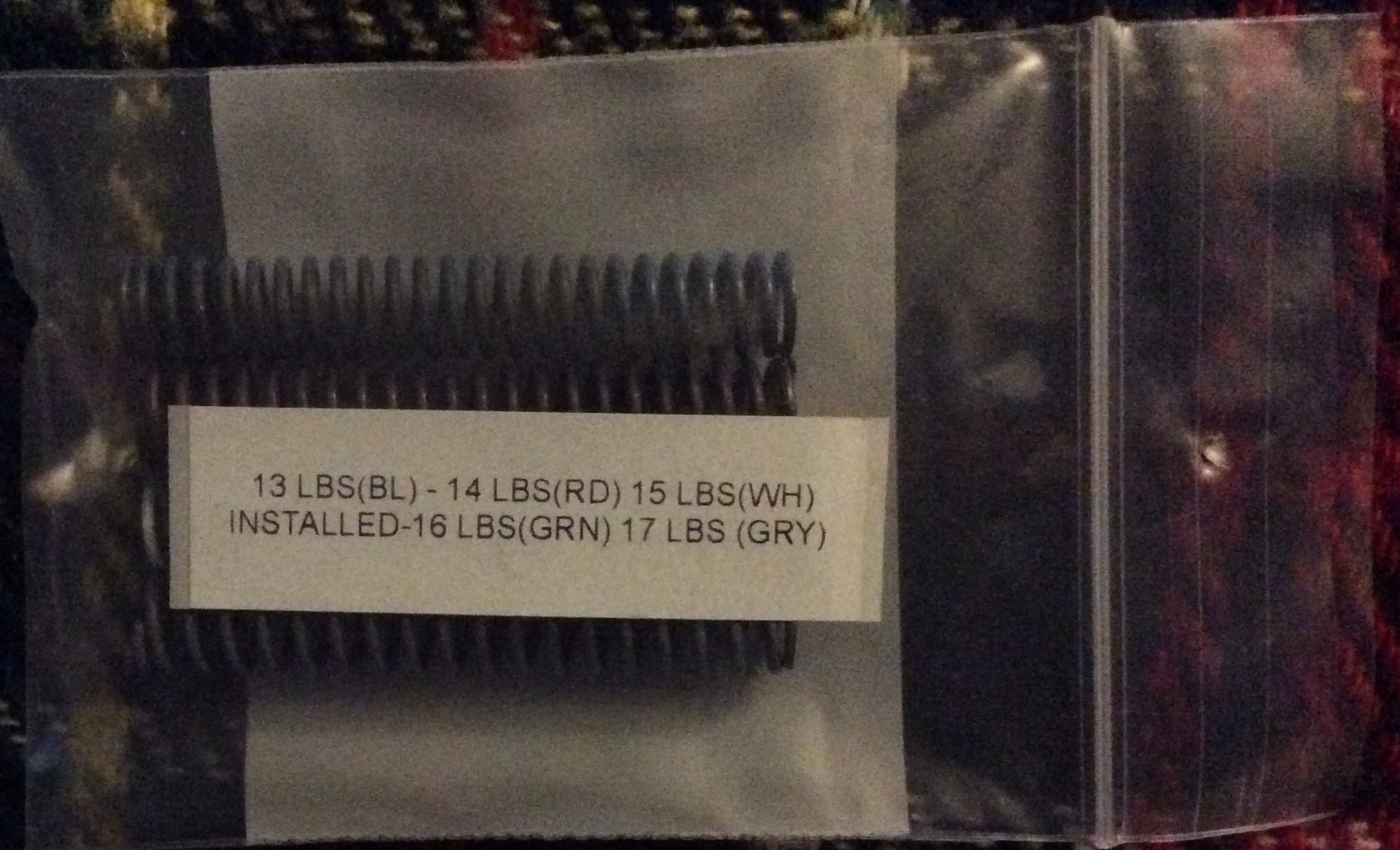

I agree with everything you're saying, but I'm not sure that you're aware the kit has 13, 14, 15, 16 and 18 lbf springs. So, @marks_a18138, definitely go to the 13 lbf spring as @Tim7139 recommended and if you get a rare FTF, bump up to the 14 and try it again. Please do not cut coils as it causes other issues....

Sorry, Grey is 18....I'll fix that.
MB
thanks I will change it on the bag.
