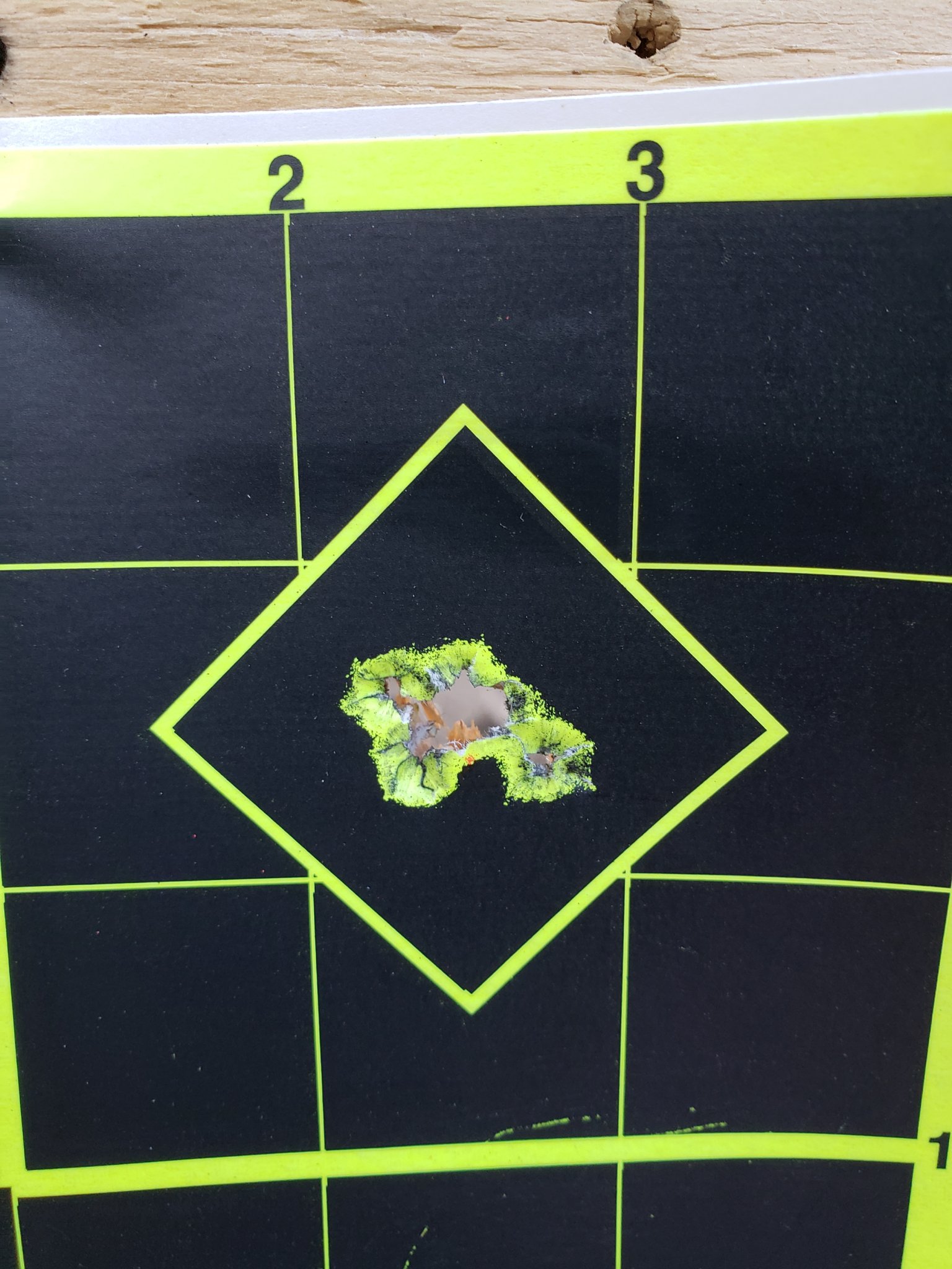

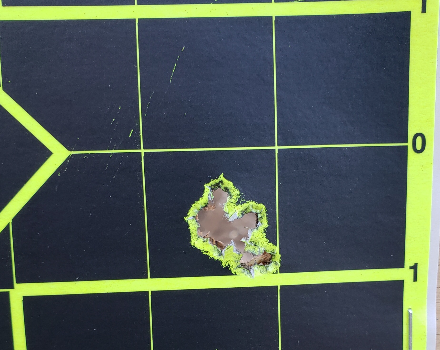

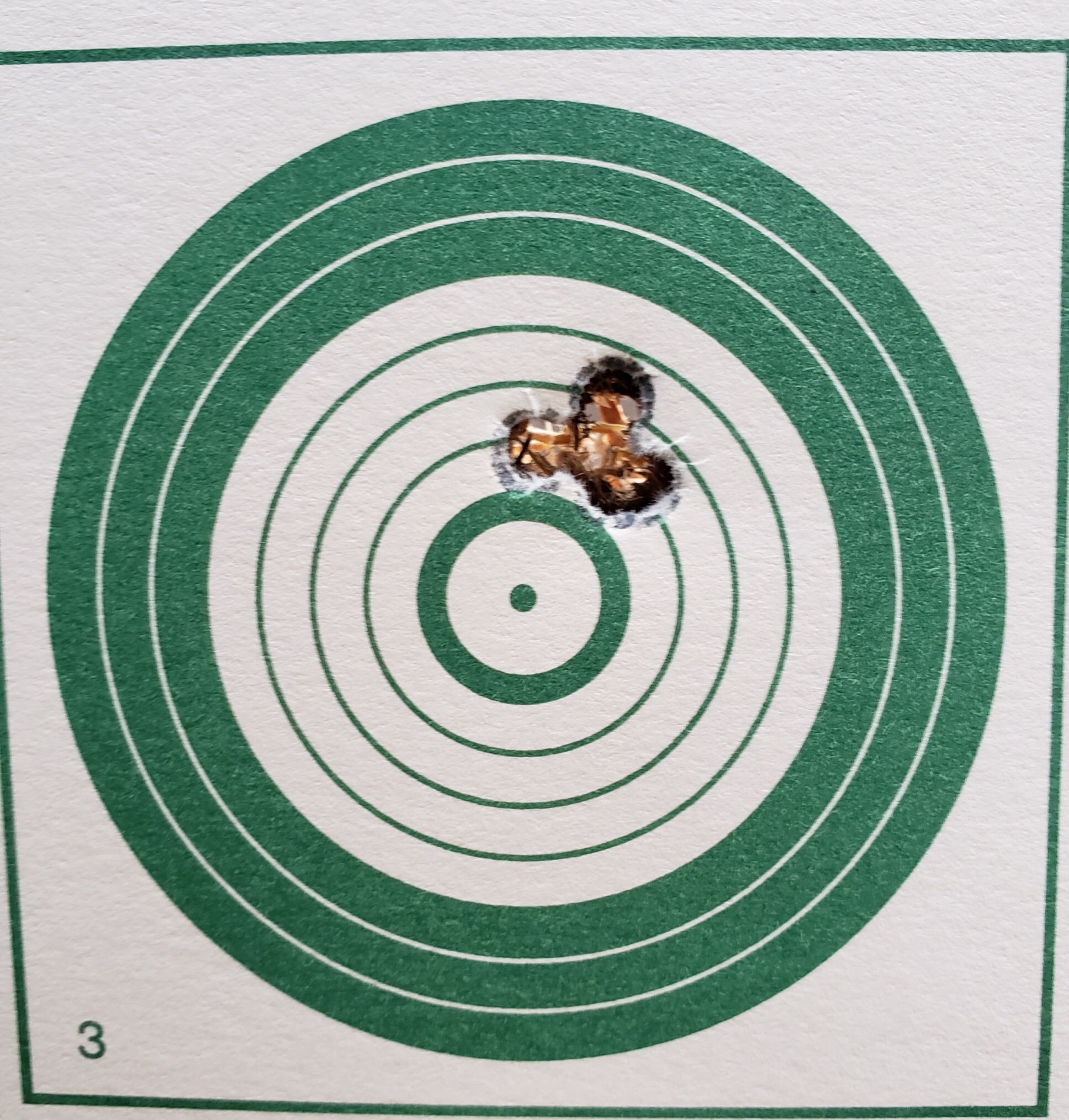

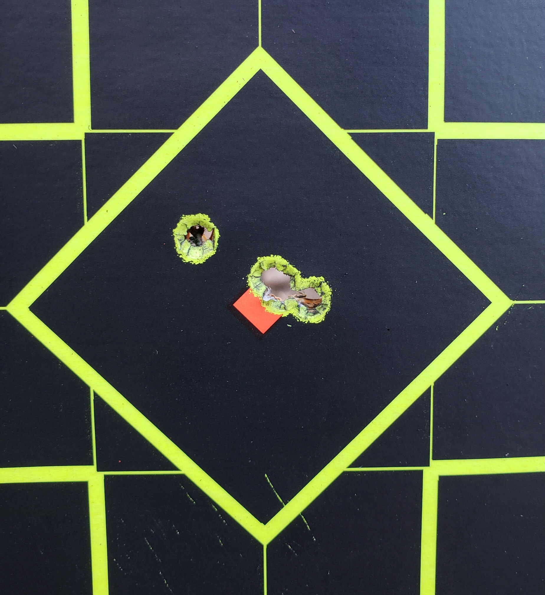

10 shots Sk Standard not lite hits 13 lbs spring
I change to Midas plus and started getting a light strike about ever 10 to 15 shots release the bolt lock it back which rest the firing pin and off the round would go.
I would go back to the SK and no problem.
Change up to the 14 lbs but this time I did the 1 turn back on the spring , the POI would more little about not sure if was the time between changing spring of barrel cooling but it did seem to tighten the group.
Next photo 10 with SK no light hits , back to the Midas plus.
Next photo
Midas plus 5 shot group
3 in almost one hole but what about the one that fell out of the group..
Light strike and that was shot number “ 4 “
I cycled the bolt just enough to reset the firing pin as I did before and took the shot.
And it fell out of the group
Why
It was me . When I cycle the bolt the rifle came off level and it pulled.
The next shot “5 “ was back in the group.. 100 percent me not the build.
So maybe MB can add to what I saw, I did have some other Eley ammo as well as other SK but by this time the sun was gone and so was my range time.
Hopefully this will help other , more over more questions but this fun stuff.

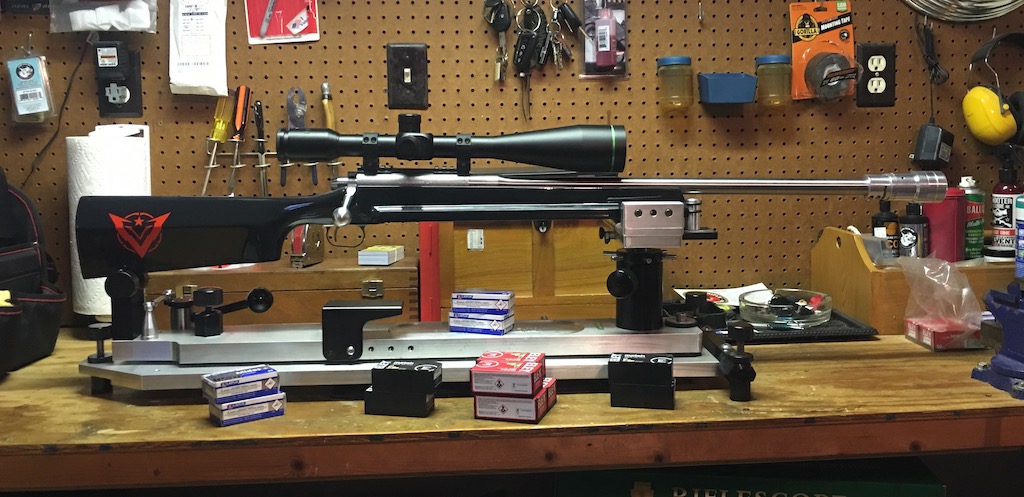

My V-22S full build arrived yesterday. I picked it up at my FFL and began the process of inspection, scope and tuner installation, and initial testing. All aspects of “day one” proceeded smoothly and the “proof of the pudding”, i.e., precision/accuracy testing was truly impressive.
My V-22S is a single purpose build benchrest rifle intended to shoot primarily at 50 yards but, from time to time out to 100 yards. I intend to shoot both postal, club and sanctioned benchrest matches.
My build specs include a V-22S action, a Shilen 24” Ratchet barrel, Flavio Fare trigger all housed in a McMillan Edge stock. I added a Mueller 40X56mm scope (that will soon be replaced with either a Nightforce Precision Benchrest or Sightron SIII SS) and a J N L PRXIII tuner that I borrowed until my Harrell’s is refitted for the Shilen barrel.
The custom paint on the stock draws attention to the manufacturer by contrasting the glossy black stock with VGW’s unique company logo that Paul, Mike and I discussed earlier in the year. I think the paint met all of our expectations.
I scoped the bore and chamber and, as expected, both were pristine. I did run a wet and dry patch through the barrel on general principal.

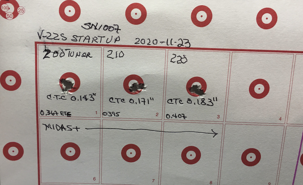

The barrel to muzzle length and tuner opening were measured and used to feed the Purdy Prescription which calculates physical (overall) length for initial tuner setup.
The next step was setting the rifle on my one-piece rest, getting a rough zero and shooting both Eley Match and Lapua Midas +. I think the Shilen Ratchet on my new rifle is a good one as even the first few rounds were “hole in a hole” impacts.
The final activity for the day was to shoot a few five-round groups (Lapua Midas +) and begin refine the tuner settings. Three groups were shot, one at 200, 210 and 220 tuner setting. Center-to-Center groups were 0.143”, 0.171” and 0.183”.
I’m VERY impressed with these initial groups and look forward to my next range day to continue refining the set-up. If all goes well this rifle may even begin competing in a few ARA Indoor Matches.

I had plenty of time to develop my initial plan and it went smoothly, maybe except for the tuner - my Harrell's needs a little attention to fitment but luckily, my shooting buddy was willing to take the tuner off his Turbo until I can fit my Harrell's.
Clean Bench ... Laugh-Out-Loud!!!
In all honesty, the wait was painful at times but I always consoled myself by saying that I knew Vudoo well enough that any delays would result in a better end result. I think Ravage88 has made several comments about it being "right" before it would ship. I also realized that the pain of waiting would quickly disappear once the rifle was in-hand.
So, Yes ... the wait was worth it. I think those readers who have orders pending will be very happy when their number comes up!!!

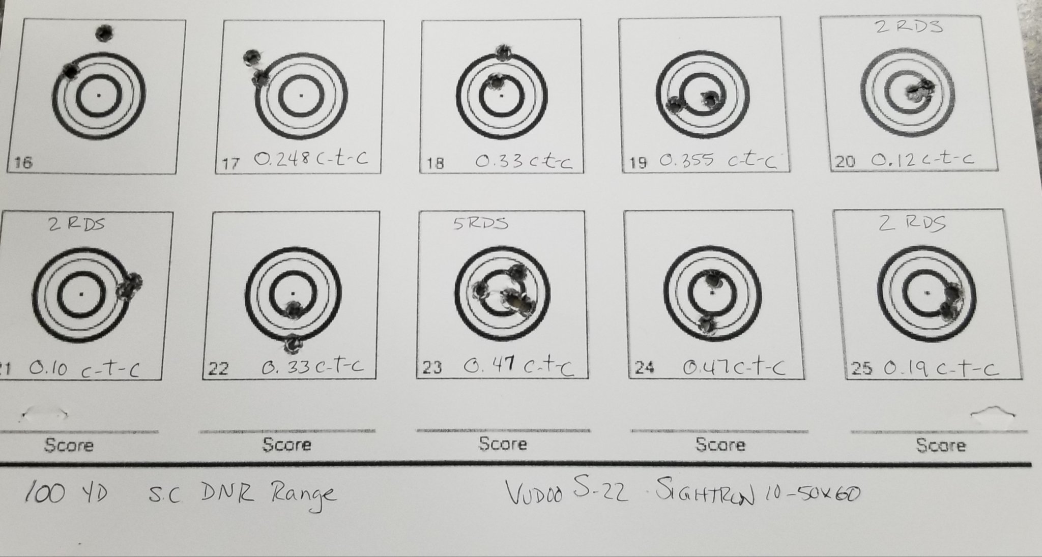

I'll be head-over-heels happy if mine does that well at 100 - what ammo were you shooting?

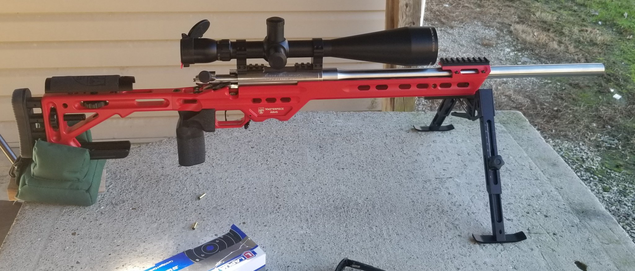

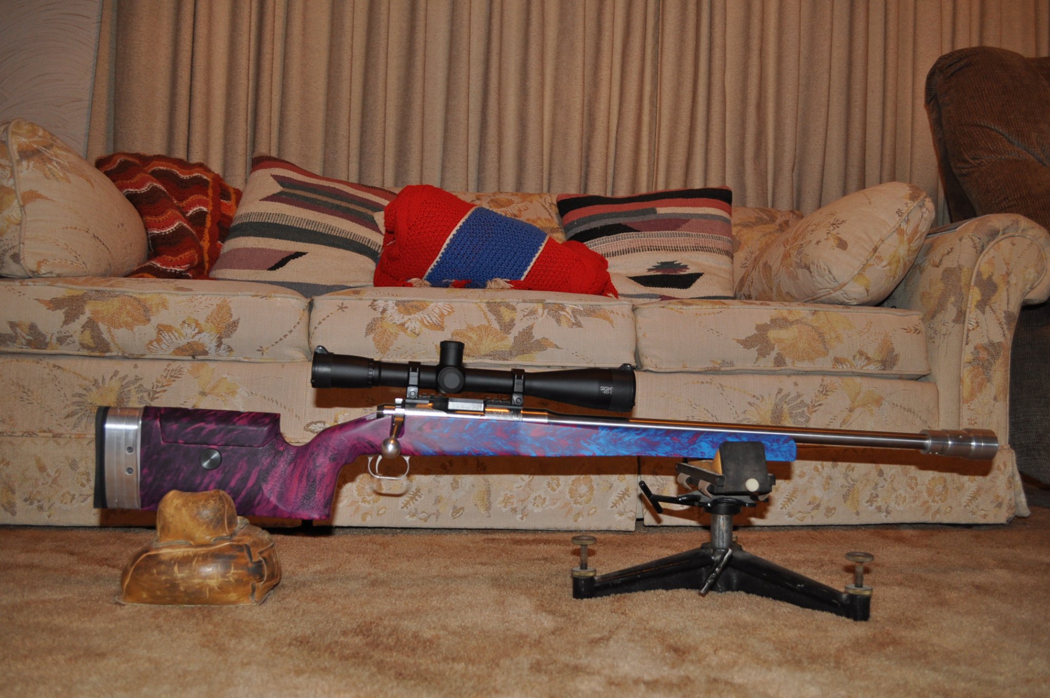

UPS made an abortive 'attempt' to deliver this Kestros stock yesterday; came back today while I was in town for lunch and left it sitting at the front door. If the weather is decent tomorrow, I'm going to take a day off from watching the GPS steer the tractor over the field and go shoot mine...if not, we'll just keep on burning diesel fuel.

great looking rifle ,what were conditions like?
No wind flags. Because it was a DNR range I was shooting through sewer tubes behind a huge berm so I could not read the wind at all, which was anything from stiff and switching to non existent. :)
