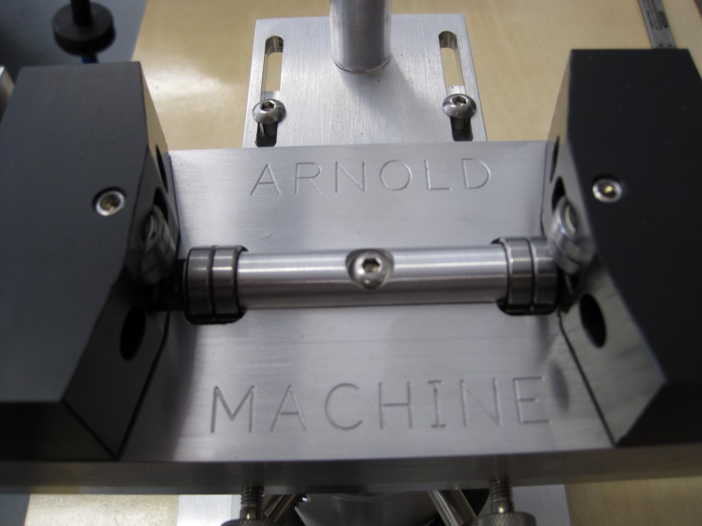

The rest is an Arnold with the roller top. The roller tops are available on both
@DRACO
Thanks for the intel.
Are there rollers on the sides and bottom? I cannot tell from the photo. Anyway, I have lusted after a one-piece rest with roller bearings after @Tiger_Shilone 's results with a one-piece roller bearing rest. Have sent an email to Cliff. Perhaps he can make a light enough rest by removing some metal or perhaps by modularizing the rest so it can be disassembled for transport and reassembled for shooting. If that not possible there is the T-REX.

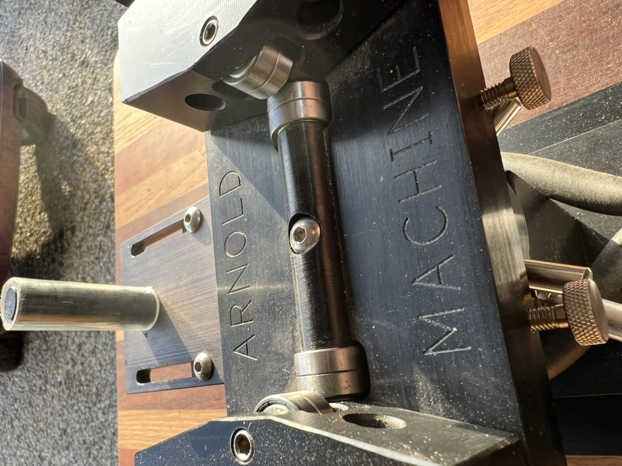

Here are the roller tops on my two rest. As the Arnold is an older model I can not attest to his current model being the same.

Rick
@DRACO
If I read the photos correctly, the Arnold has rollers on both the sides and bottom while the T-Rex only on the bottom. It also appears the lateral supports of the Arnold can be adjusted. I will not be using a true Benchrest Stock but a Foundation Centurion which has a forend width of 2.6".

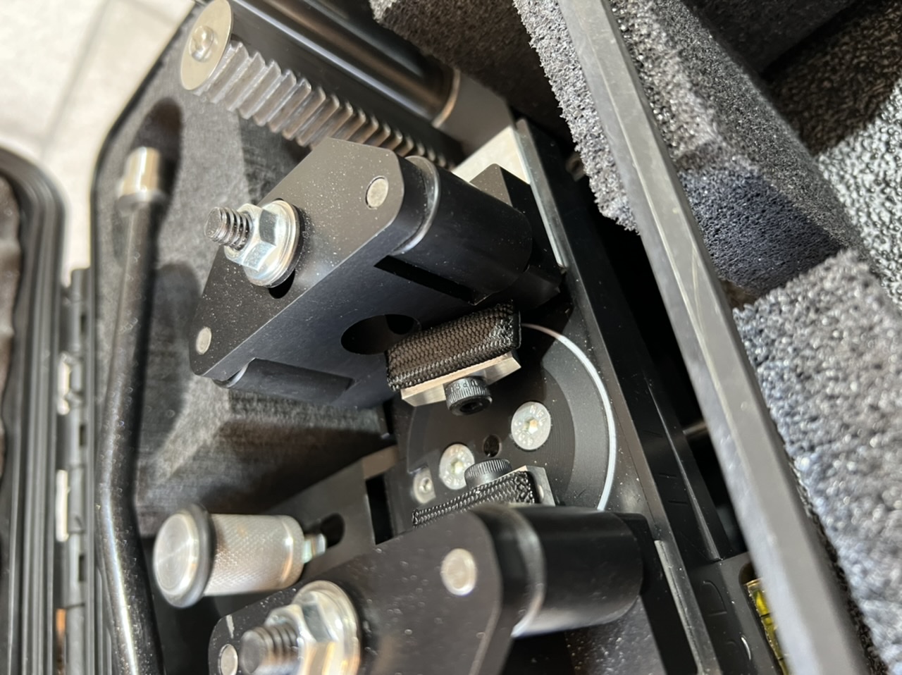

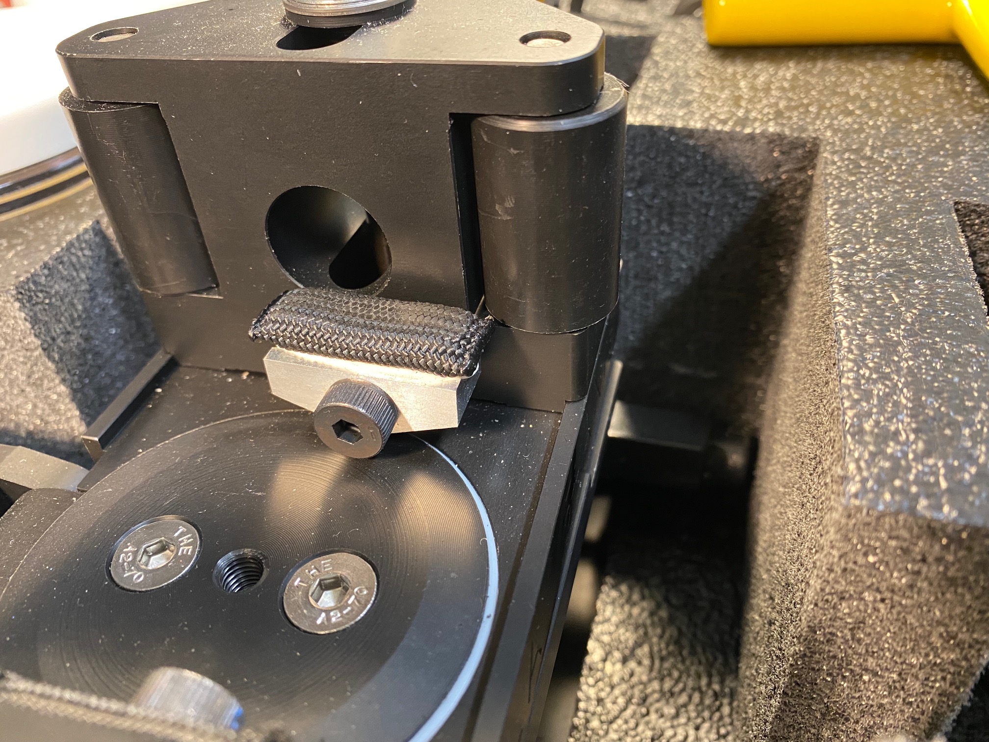

Rick. The T Rex has the rollers on the sides and pad supports on the bottom.
The Arnold uses spring tension while the TRex is manually tensioned. I had to add a small plates to the TRex so it would adjust down to the stock on my CZ

Are those little sand bags independently adjusted to make it level? Haven't seen one with the double rollers and tiny sand bags like that.
Good afternoon TurboShooter;
The Little Sand Bags are glued to a metal shelf that is held on by a bolt. The Geometry keeps them the same on Each Side. The leveling of the rest is done by the feet on the bottom. See pic of Little Sand Bags attached. I understand it is 'required' by many shooting venues that the gun rest on Sand Bags. And that is what you have on the T-Rex, all be it little ones...
I absolutely Love my T-Rex. It has helped my shooting. It is an Incredible piece of equipment.

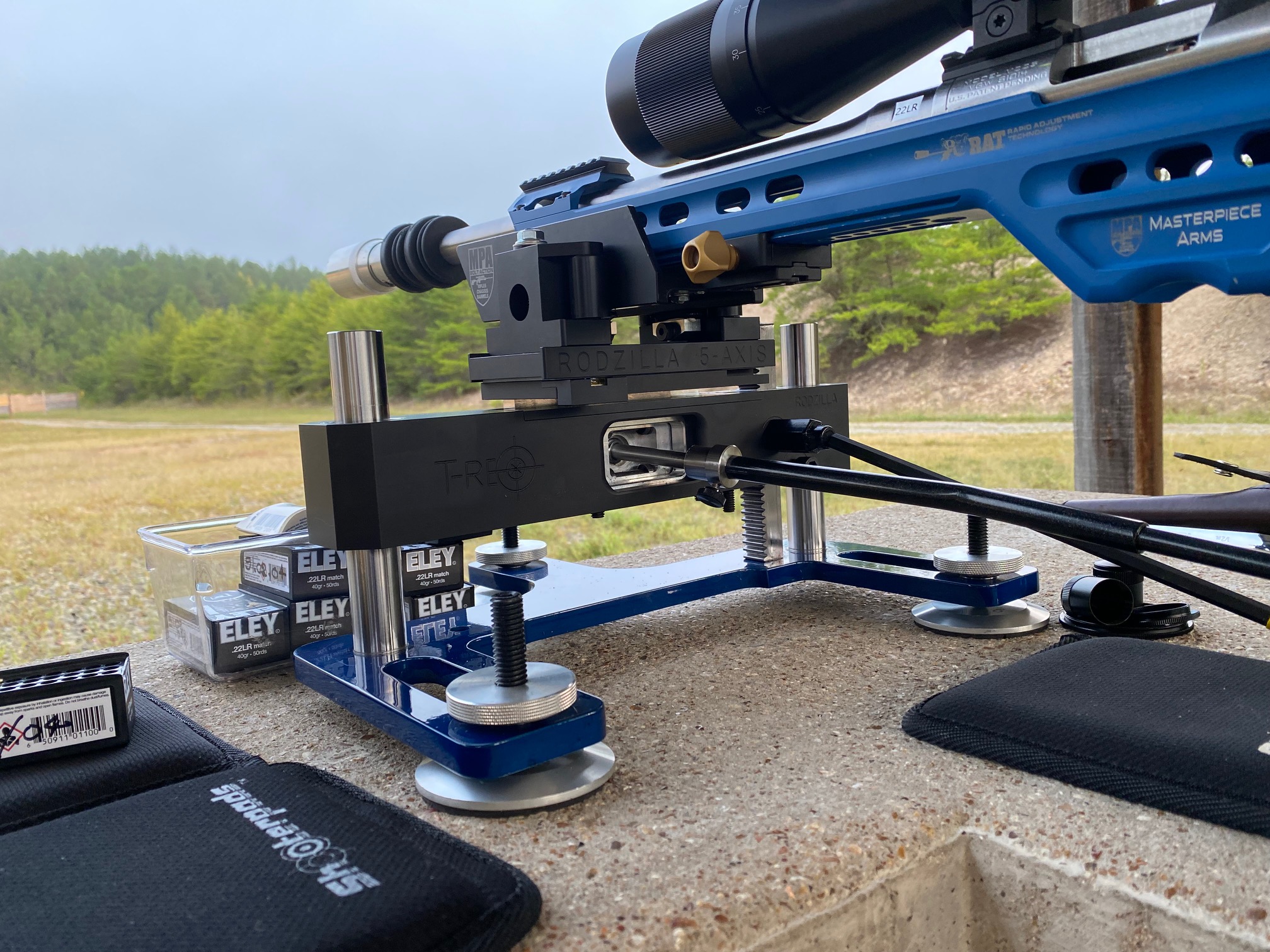

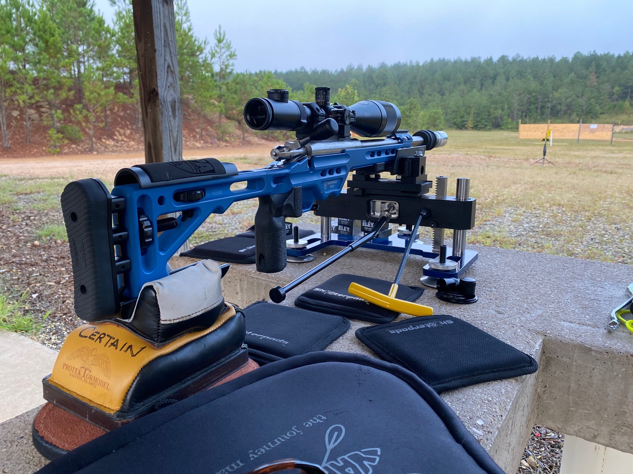

Who makes the T-Rex? When you Google T-Rex Mechanical Rests all you get are dinos.
Good afternoon Rick137.
Not sure anyone answered you. T-Rex is made by Rod Brakhage. He is a prince of a fellow. Good shooter. Excellent machinist.
The T-Rex combines the best of a number of excellent rests. I have been super impressed with mine.
Here is the link: https://therodzilla.com/product/t-rex-front-rest/
Best of luck.
