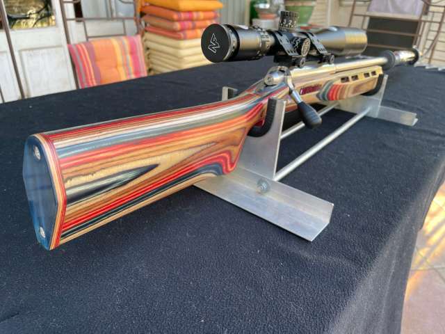

Hello Folks, here is my new vudoo, prepared by LB Precision in France.
And the first trial target !!
I will participate to the french national championship, potentially qualifications to the world championship RIMFIRE Benchrest.

Nice looking piece of wood. Close up of tuner? Please. Nice target!

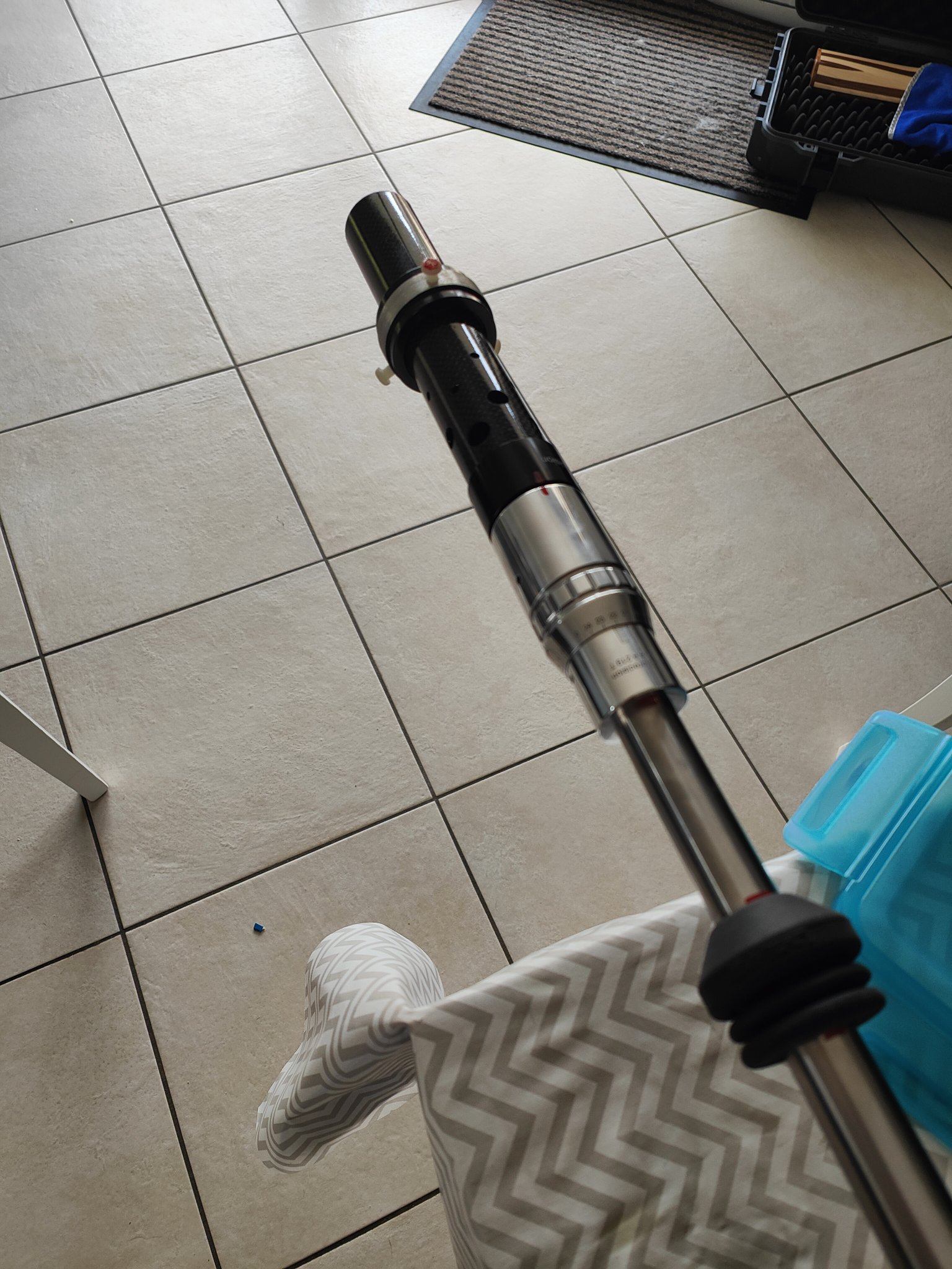

Here is the details of tuner/bloop/deresonator attached
The bloop is in carbon.
Total weight is 430g
The action is full/heavy bleech, total weight is 6.345kgs (WBSF max is 6.350kgs )
My gunsmith is Luc BROUQUIER in France (www.lbprecision.fr)
My other rifle is a stiller/muller 4MI prepared by richard GORHAM, shooting awesome
Reactions: fredfish

Could you please explain your process for determining the optimum setting/position/length for those devices.
Thank you ICEMAN
Hi williwaw,
First you have to setup the screws of the action, in NM, to see the best clamping (without tuner, nothin)
After, you setup the deresonator, in moving cm/cm in check the best group. The best group is every 3 cm, this is the amplitude/harmonics
same for the tuner with the bloop, you start from 0 and go from 1 to 5 position with the best group and you are in for the global setup.
Tuner, bloop, stock, deresonator, every thing is setup and sold by the gunsmith Luc Brouquier using the best ammos (Xact or Tenex)
Then you shoot on a target and you have the trial target i displayed.
Easy no?

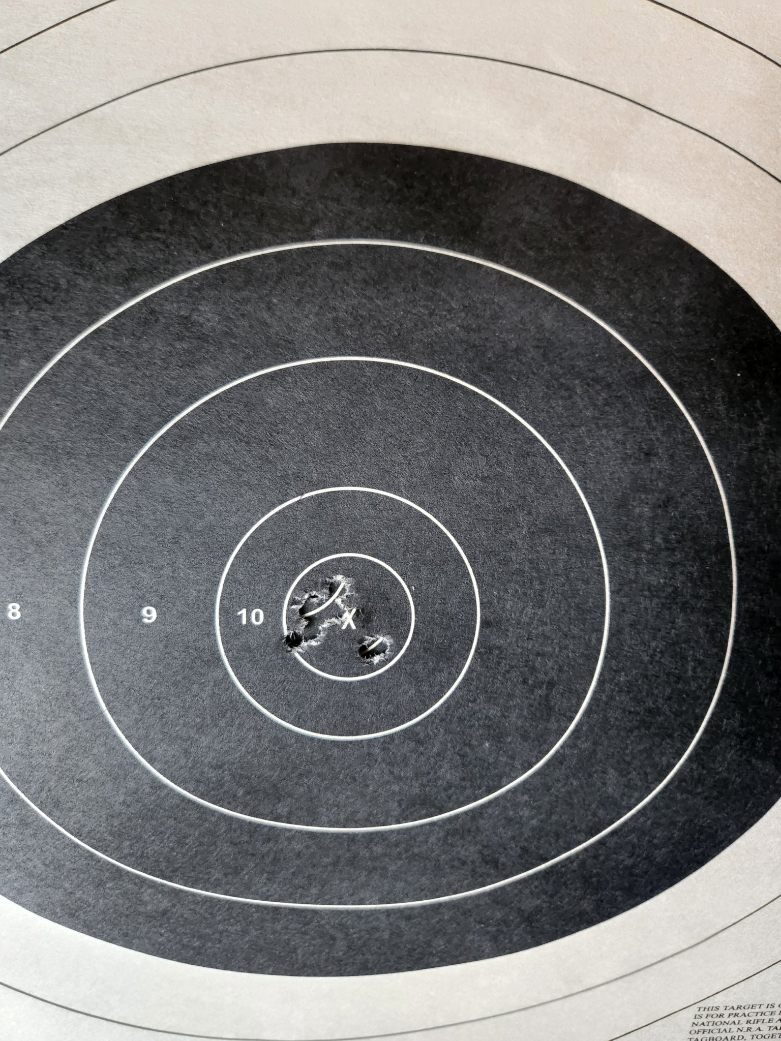

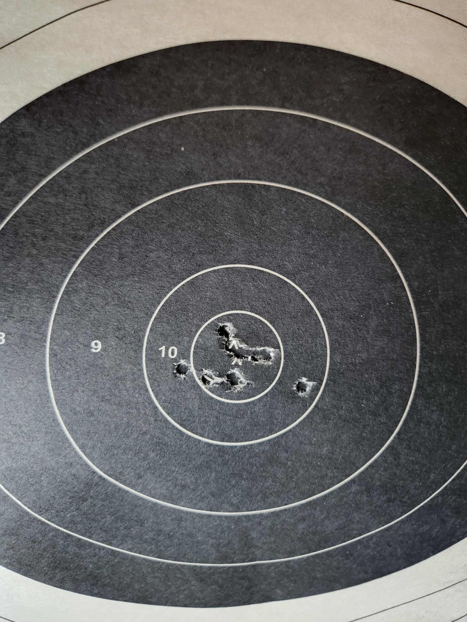

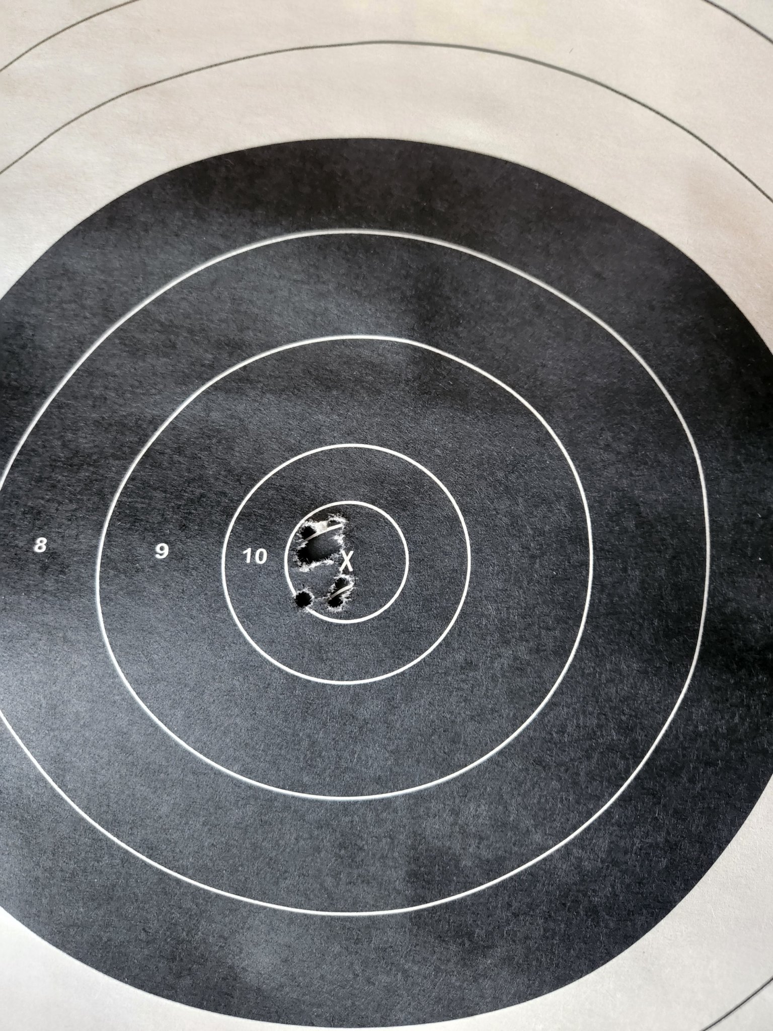

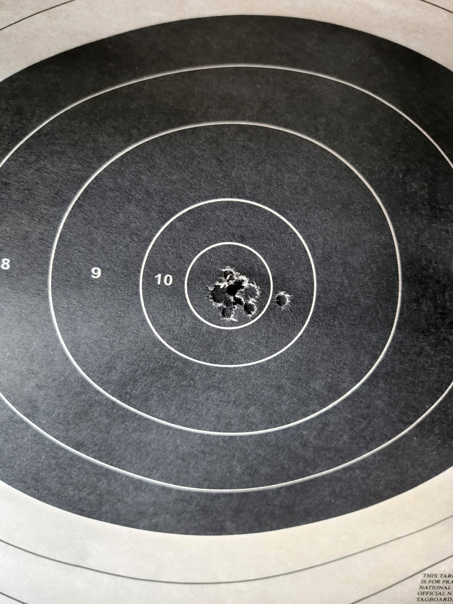

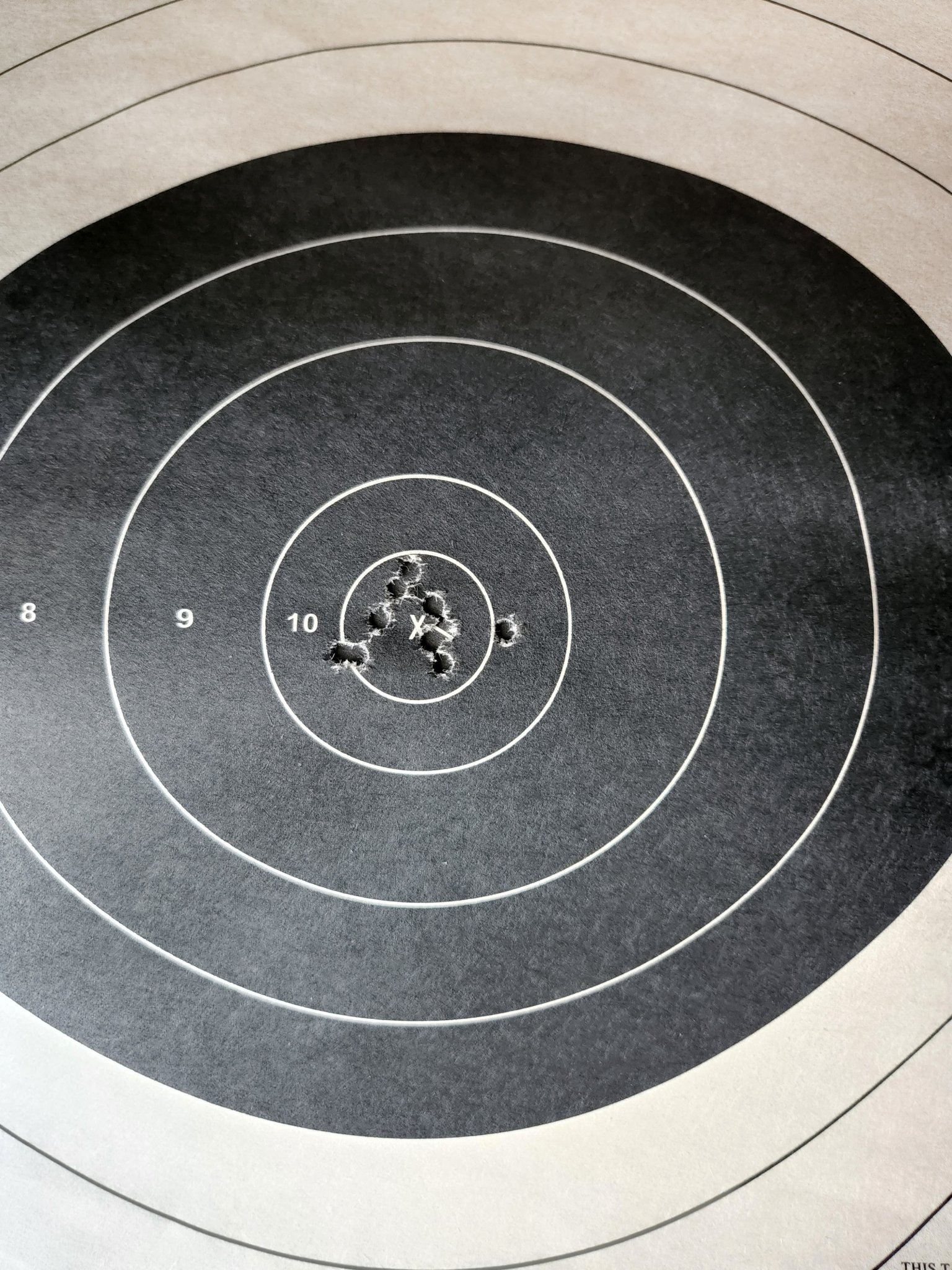

Our local club has a 100yd outdoor bench match every other month. 2 targets, 10 shots on each. X ring is 1". Perfect score 200-20x which as far as I understand has never been achieved. Finally got the V22S tuned and gave it a go. 2 rounds of 200-19x. The two high 1&2 o'clock shots occured on the last round when it started to heavily rain. Other than those two, the overall vertical is around 3/4 moa...
Nice shooting!
