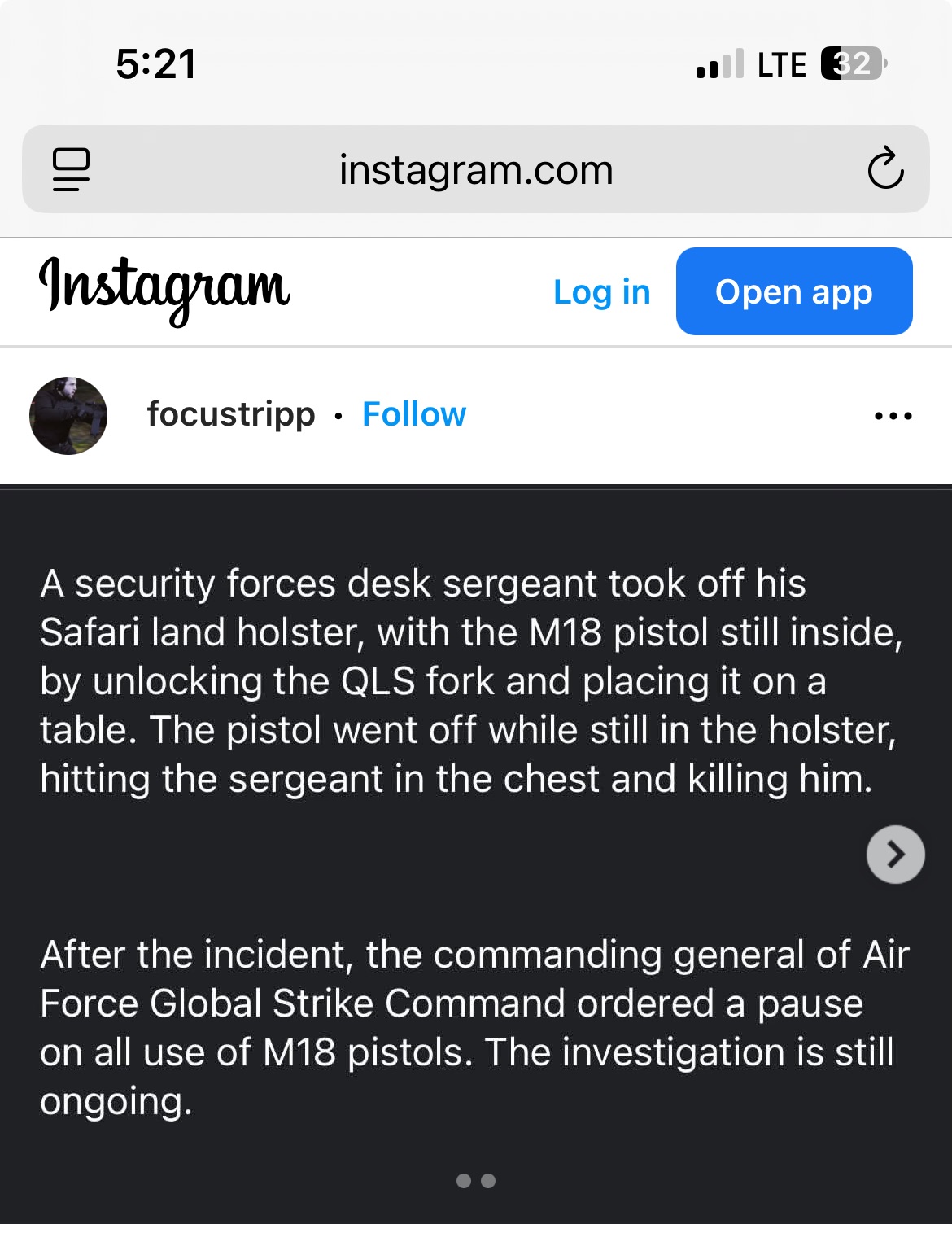

So is this real or for entertainment purposes?
Because if real, ooooo if I was that SGT's dad I'd be driving to someones congressional office as a very pissed off dad with some sort of legal council in tow.
I was skeptical as well ; seen it covered other places think someone even has a thread hear from another source here on the Hide .
