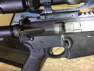

The only issue that has been noticed is how the Nikon M-223 mount fits, either the mount is a little out of spec or my top rail is, as its on as far as my gun smith could get it without putting some real effort into it. As it turns out, its location is about where it needs to be.

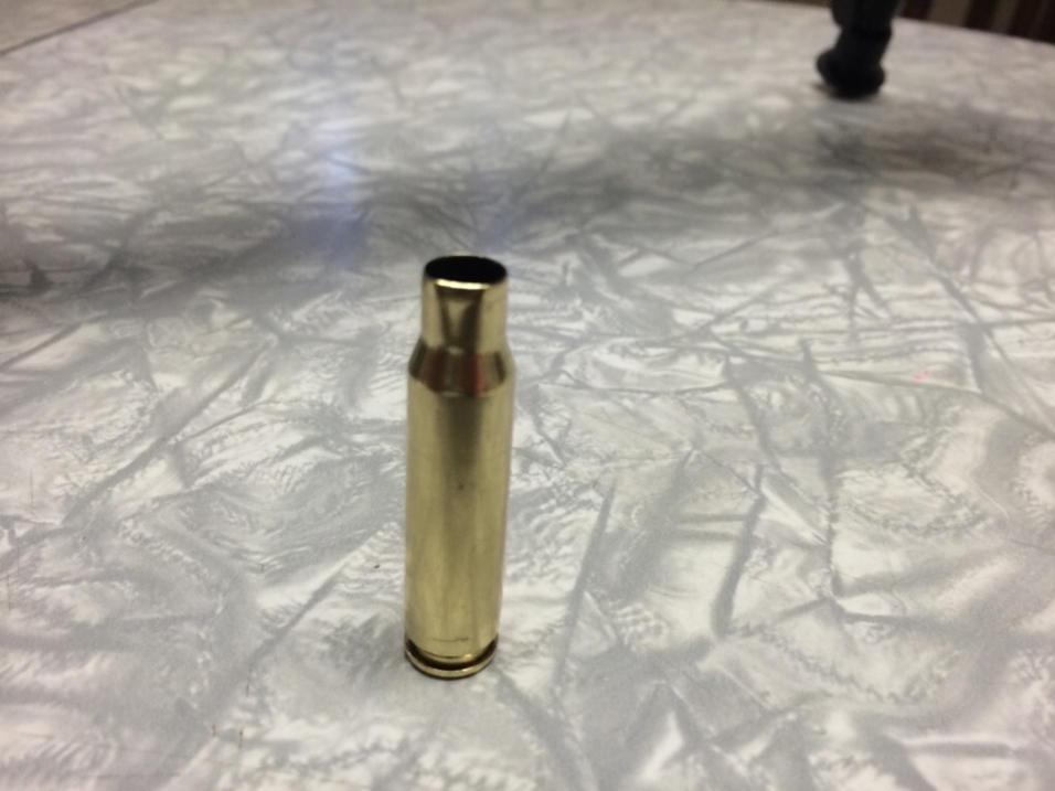

Since some have asked about the brass, it actually looks really good, it all fell in about a 1 1/2 - 2 foot circle just a few feet behind and to the right of me, making recovery very easy. The rim looks good, the mouth looks good, so I say they are good to load again. The Primer strike looks pretty good as well.
I will try loading some pics of rifle and my worst piece of brass in the morning. The only internet I have is from my phone, its 4G unless its in my house and then its -4G

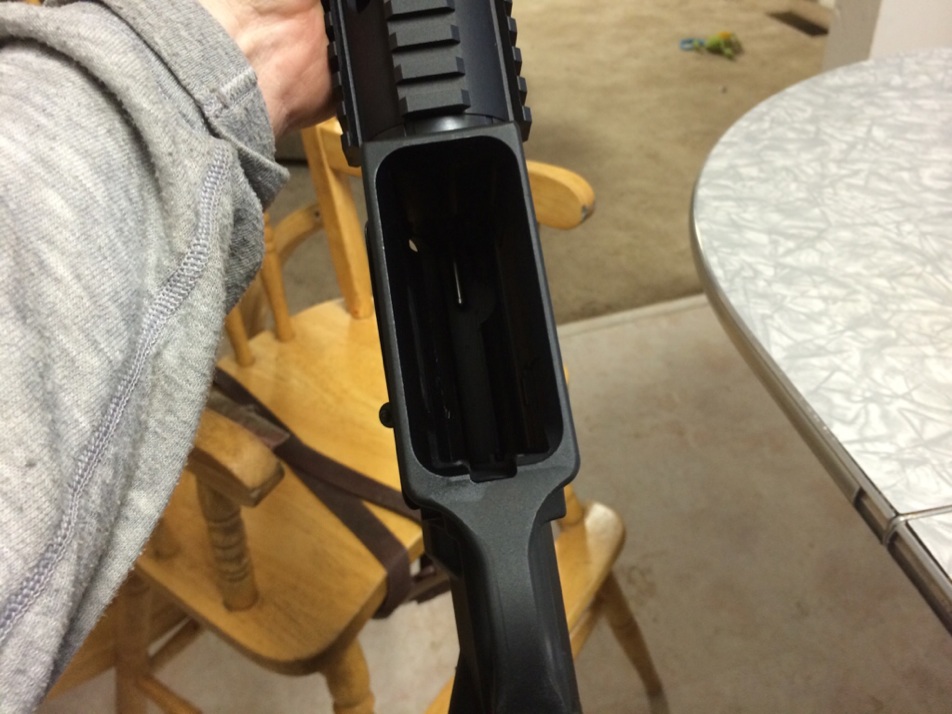

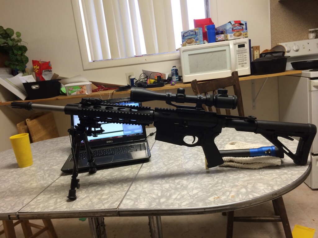

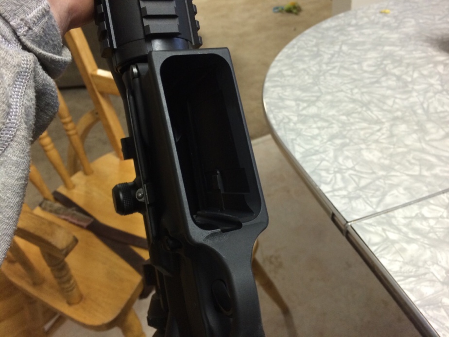

ImageUploadedByTapatalk1395182598.396906.jpgImageUploadedByTapatalk1395182609.395417.jpgImageUploadedByTapatalk1395182620.595796.jpgImageUploadedByTapatalk1395182641.397669.jpg
These are pics of my new Recon

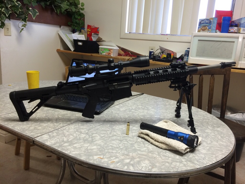

ImageUploadedByTapatalk1395182787.958653.jpgImageUploadedByTapatalk1395182801.846099.jpg

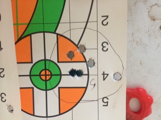

For those saying "meh" and "not that good", what you are seeing is the skill level of the shooter shooting a rifle without enough rounds through the barrel. (No offense to jb326).
The fact that the rifle has produced sub-minute groups with a new barrel means that the rifle can do this consistently, with a competent shooter, shooting tuned handloads, from a steady rest, while applying marksmanship fundamentals.
Echoing what Elfster said, I have never had a rifle that shot consistent MOA groups with a new barrel...virtually every rifle i shot (except my savage .243 bolt gun) started off above MOA and then somewhere between 200-500 rounds, really settled in.
Keep putting rounds through your rifle...one day, shooting sub-minute groups will become the norm rather than the exception.
Jb326, just to be clear, Nice rifle, good shooting, and thanks for the update. You've put me over the top...I think i'll be adding one of these to my collection later this year.
I would agree, and no offense taken. I'm a consistent sub MOA shooter with my bolt guns, and my former DPMS bull barrel, so I'm not much concerned about my skill (or lack thereof) contributing to the larger groups, but I am also usually using a little more than a 10x optic.
But I do agree whole hearted lay about needing more rounds through it to really come together.

I did see something that I have never seen before from a standard pressure round from Winchester or any other commercial ammunition manufacturer.........
the primer had a deep indentation from the firing pin and a pronounced raised circle matching the firing pin hole in the bolt face. The primers were not flat and no primer flow but it was odd......I shot military high power for 8 years back in the late 80's early 90's but we were rolling our own for accuracy but I have handloaded some rather hot rounds and seen the effects of high pressures from tight chambers etc. but not this. I'm not concerned really, just an observation. BTW, these GII guns are different in many aspects to the old DPMS LR guns (of which I have owned), and I like this gun. If the the trigger jerker (me) can get his shit squared away I know the accuracy is there.....of a 15 round group I had 1 group of 4 nearly same hole and 6 that were barely over an inch @ 100 yds. I went for 15 rounds for a good group but my shoulder psychologically ain't there. Flinching and anticipation hurt the groups, not the gun.

ImageUploadedByTapatalk1398006829.387708.jpgImageUploadedByTapatalk1398006840.256016.jpg
I was finally able to make it back out and try some more test loads.
The circled group is the best I was able to get with 150 grain Hornady SP over some BLC-2. The other group is IMR 4064 and some pulled 175 SMK's
I those are 1/2 grain increments so I am not sure how much better I can get with the BLC-2.
But that should be good enough for killing appear and plinking.
Sent from my iPhone using Tapatalk
