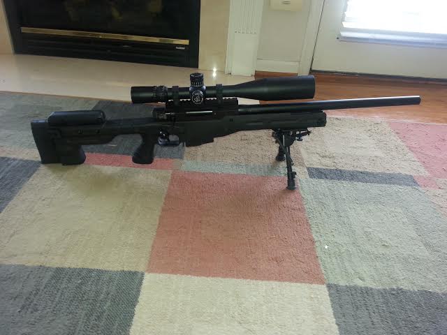

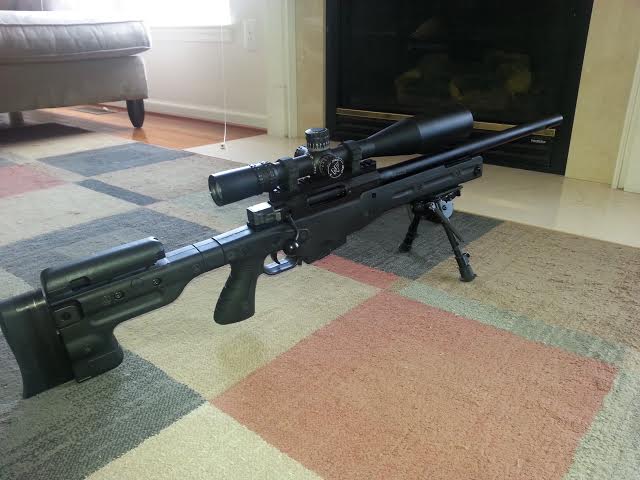

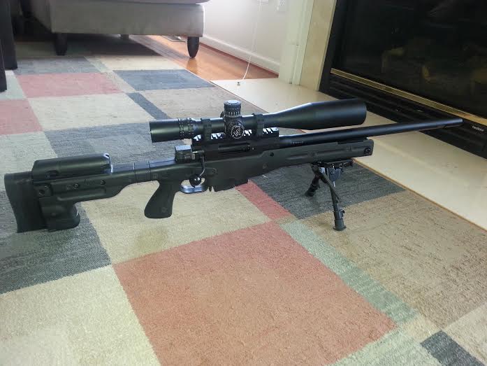

Here are some pics of mine... I am a very proud Pappa!

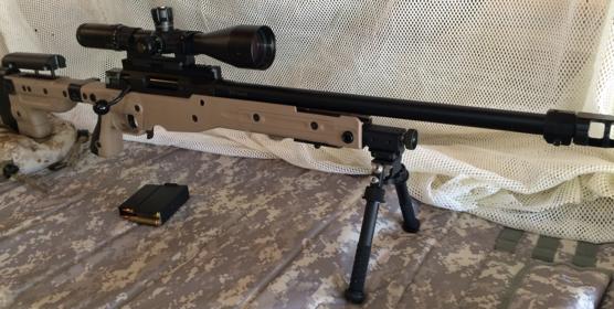

Well, I sent out my barrel to TS customs for a thread job... in the mean time, I'm painting my skins as I'm not a huge fan of the pale brown. Looking at going with a tri color brown scheme. Guess I'll just post a few pics when it's all back together.

Thanks guys.... If your interested, I used was a sea sponge for the pattern. I laid a light base coat and followed it up with a brown and grayish green.
I figured why not, AI's are shooters/functional guns, not lookers... kinda like Glocks ;)
