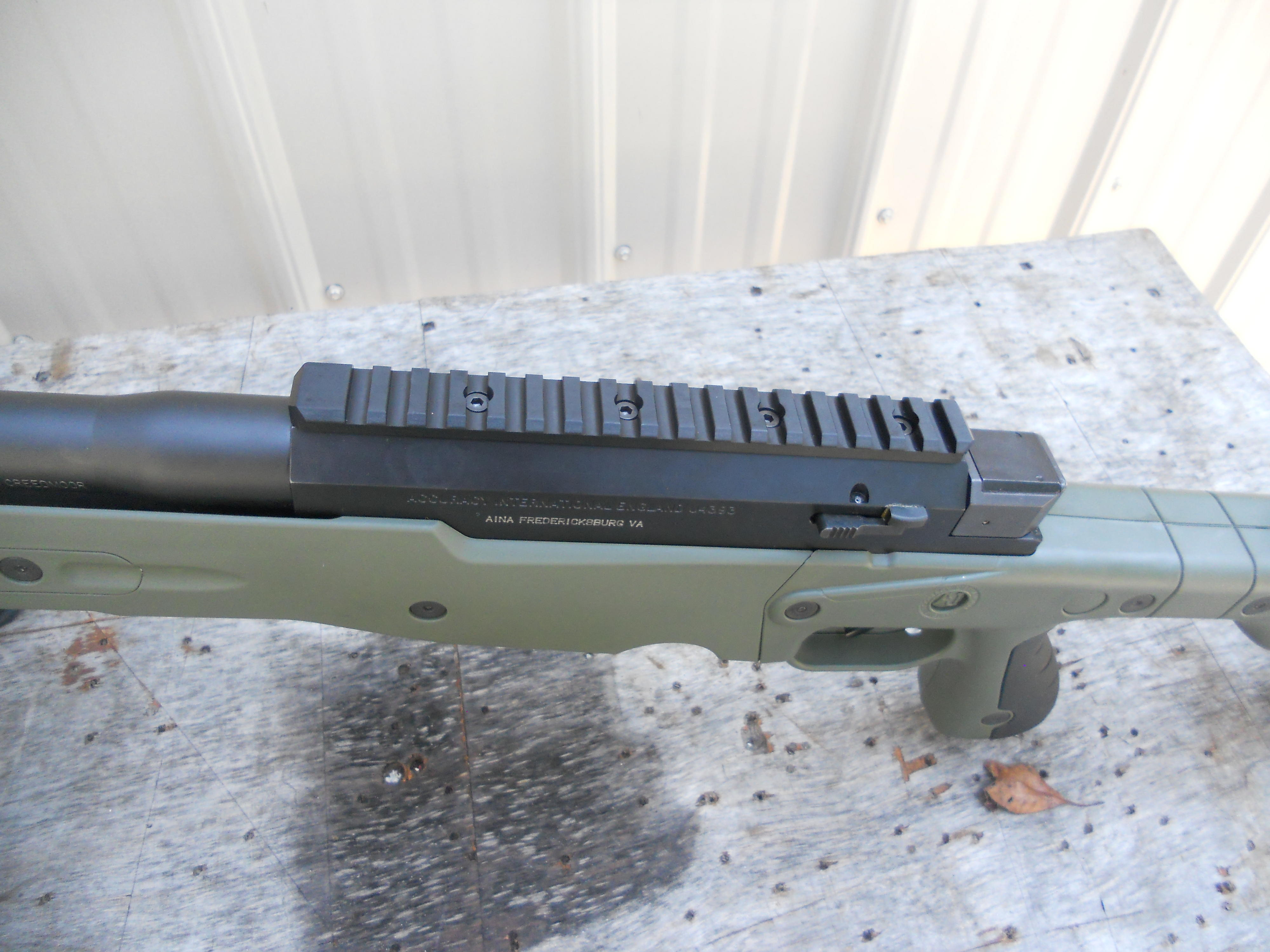

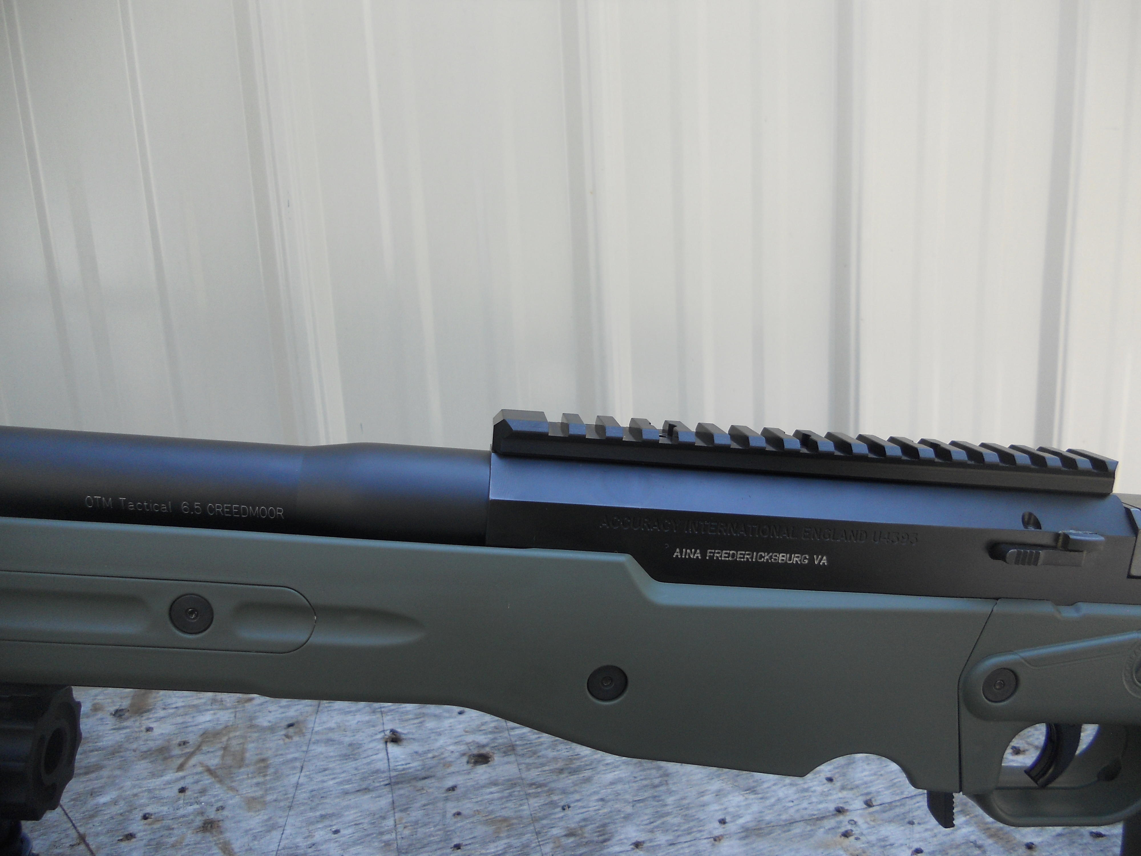

Here's a pic of the barrels that OTM sells with there lower profile AT rail after hard coat.

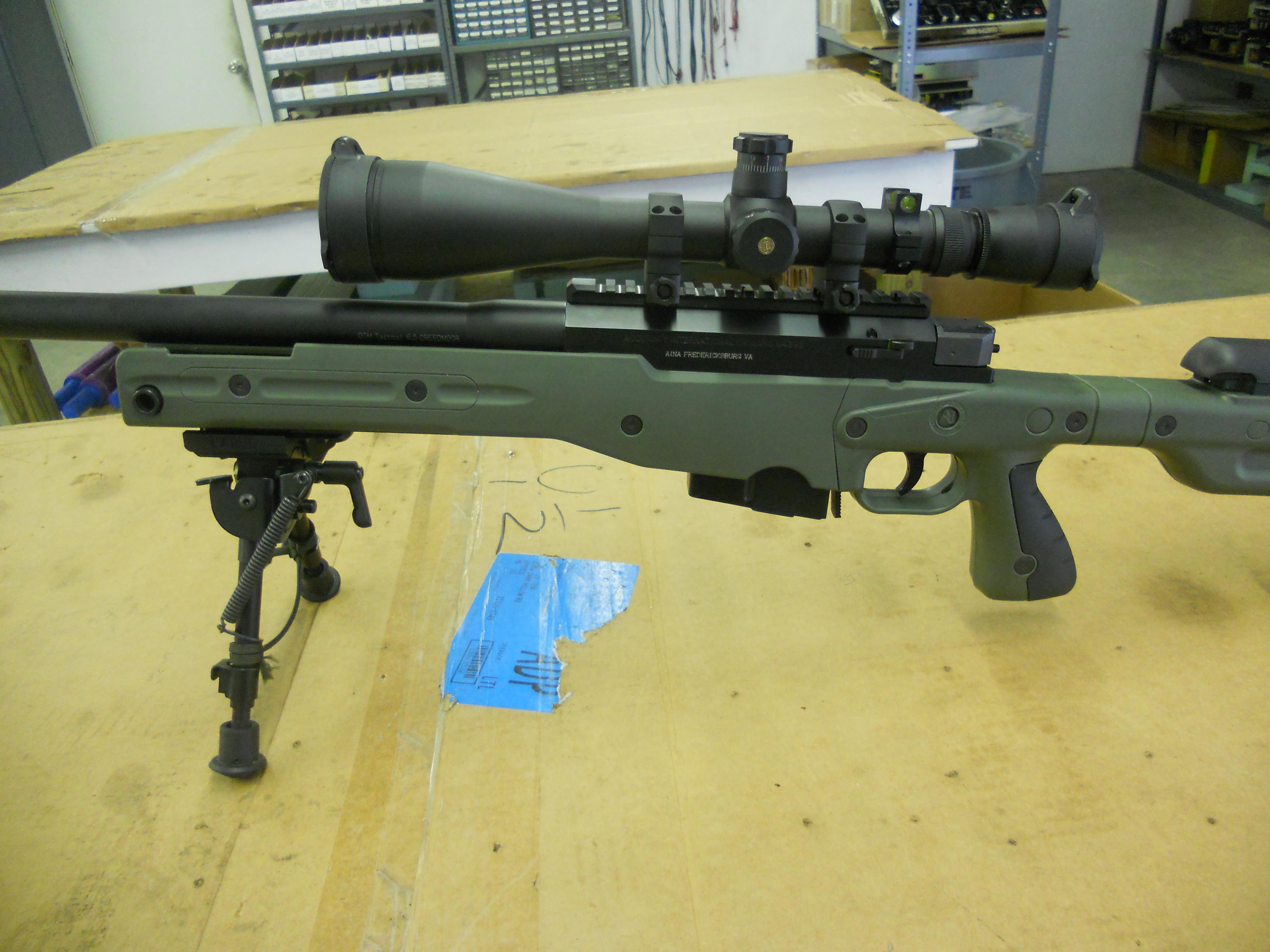

Ordered my black 20" AT folder tonight. Already have a Vortex Razor HD II 4.5-27x56 for it. Really hoping to get jake6547's lower rail from OTM. I'm on their waiting list thing.
Then I can sort out which Spuhr mount I need.
