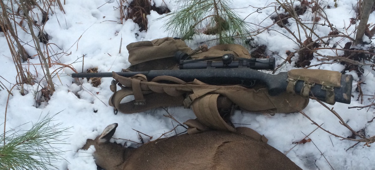

I have a Remington 700 Long Range in 7RM and really like it. It shot under an MOA with the factory Hornady 162 grain ELD-X ammo out of the box and it is a real hammer on whitetail at longer ranges.
Mine has a Timney two stage and is at the smith now having the bolt handle and muzzle threaded for a knob and brake, flush cups installed, and magpul dbm installed. Can’t wait to get it back. If I ever shoot this barrel out I’d love to have the action true’d and go with a Bartlein chambered in 30-06.
Glad I didn’t get the Sako A7 Roughtec Range that I was considering now as the Remington barrel shoots just fine at half the price.
