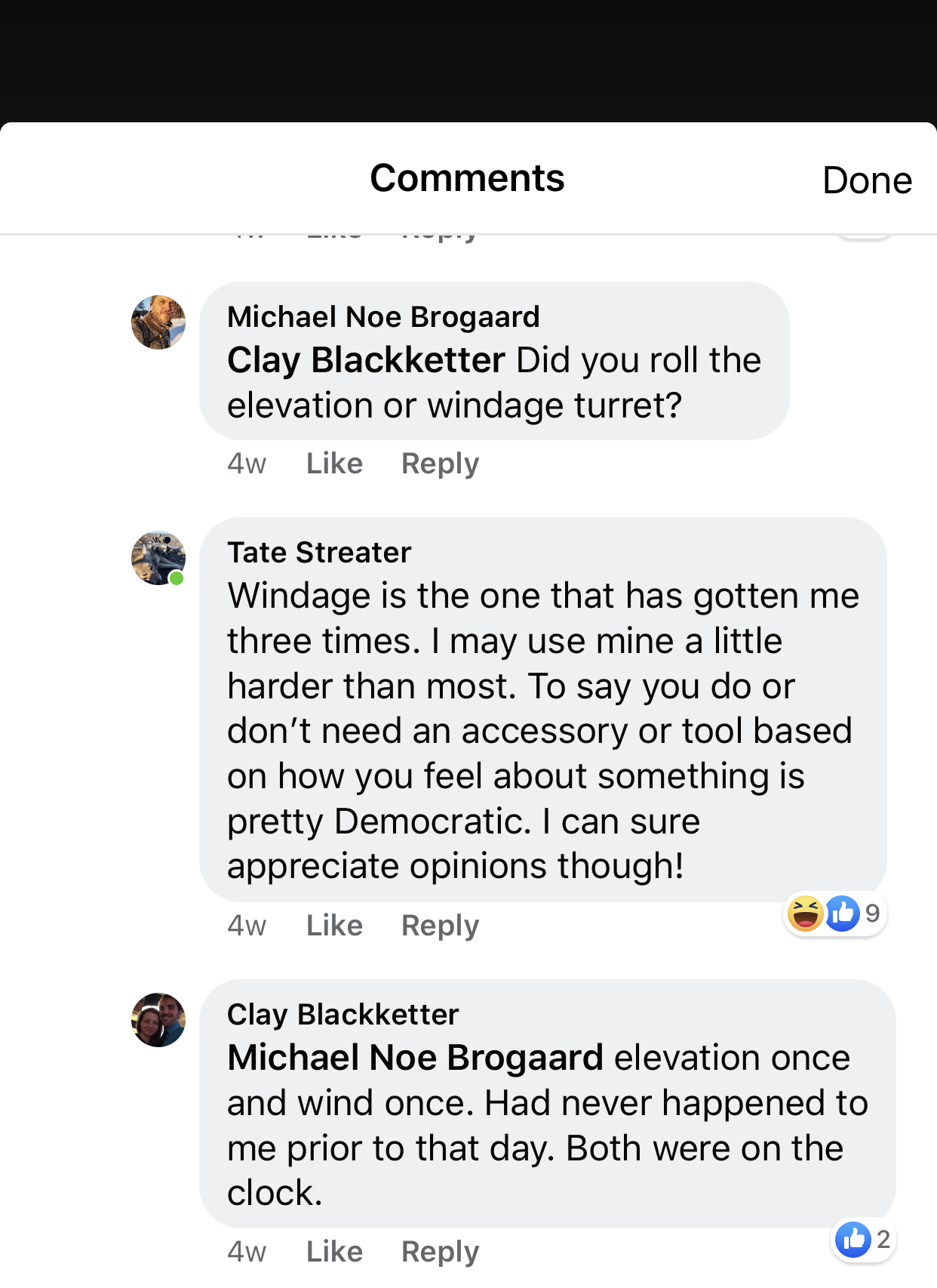

Most anyone shooting matches long enough has rolled a windage turret.
You can even hear the current NRL season champ on a podcast mention rolling his turrets several times.
Shot big matches for 4 years with tons of 1 days and haven't rolled one yet. I've heard guys say it happened but never seen it or experienced it.
Which podcast? I shot with Tate several times this year and he was running what seemed like a different scope each match.
I misremembered. It wasn’t on a podcast. It was on Spuhr’s website talking about the gray ops turret guards.
