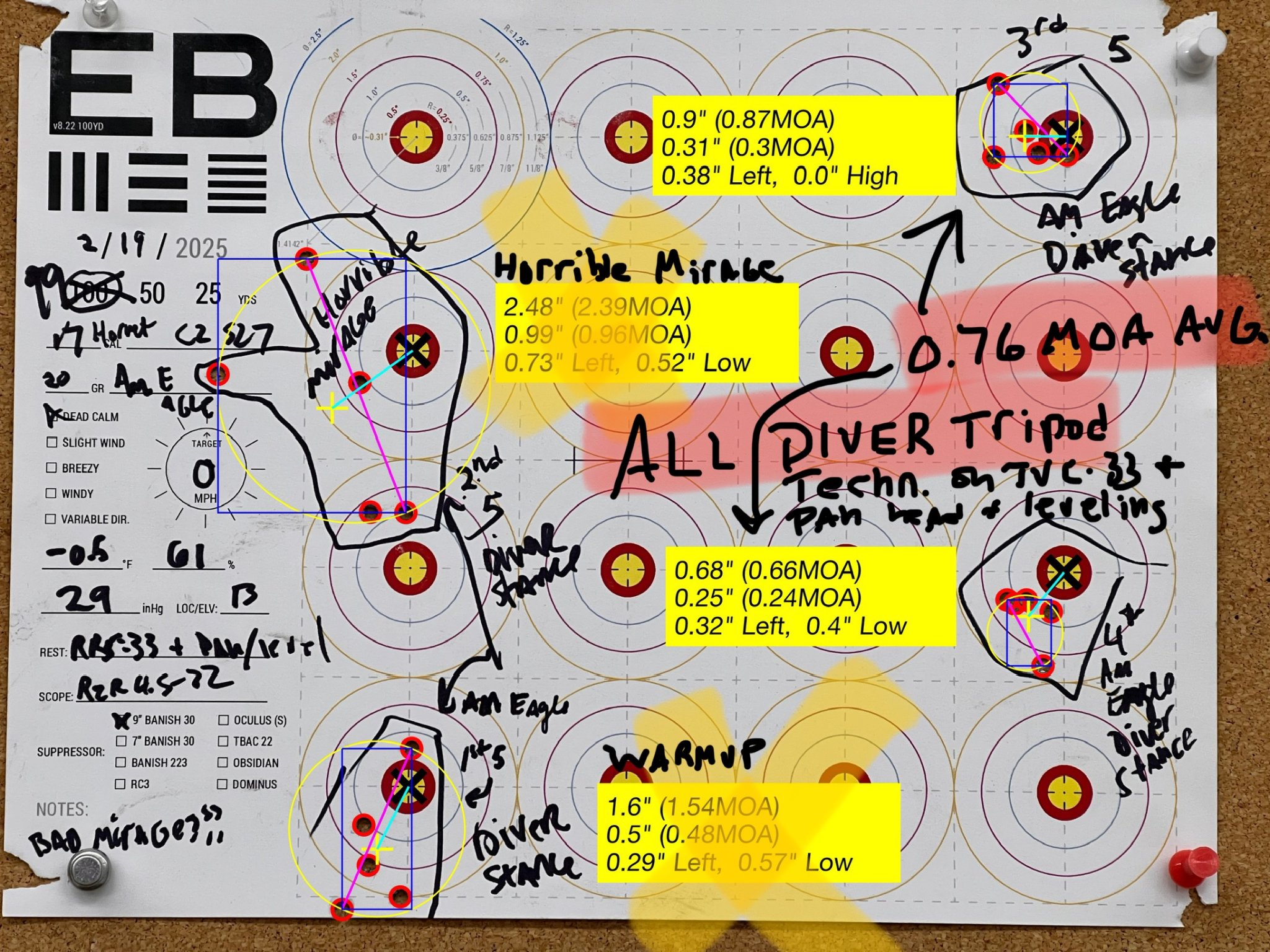

So I went out tonight at 6:30pm to the 100yd outdoor range, which has giant floodlights. Pitch black at this time of year. It was -0.5°F when I started, and -3°F when I ended. No wind.
Snow on the ground, about 7” powder on top of a half-foot to a foot of compacted snow.
This was the second very strange winter shoot I’ve had in which there was significant mirage, starting before I even shot a round. The gun had been out in the cold truck for an hour, so that wasn’t it. Even unscrewed the lens hood, as that can trap warm air from a vehicle (strange but true, learned that with photography).
The mirage continued, on and off, until the end at 8pm. The whole time the suppressor was almost cold, and the barrel was cold.

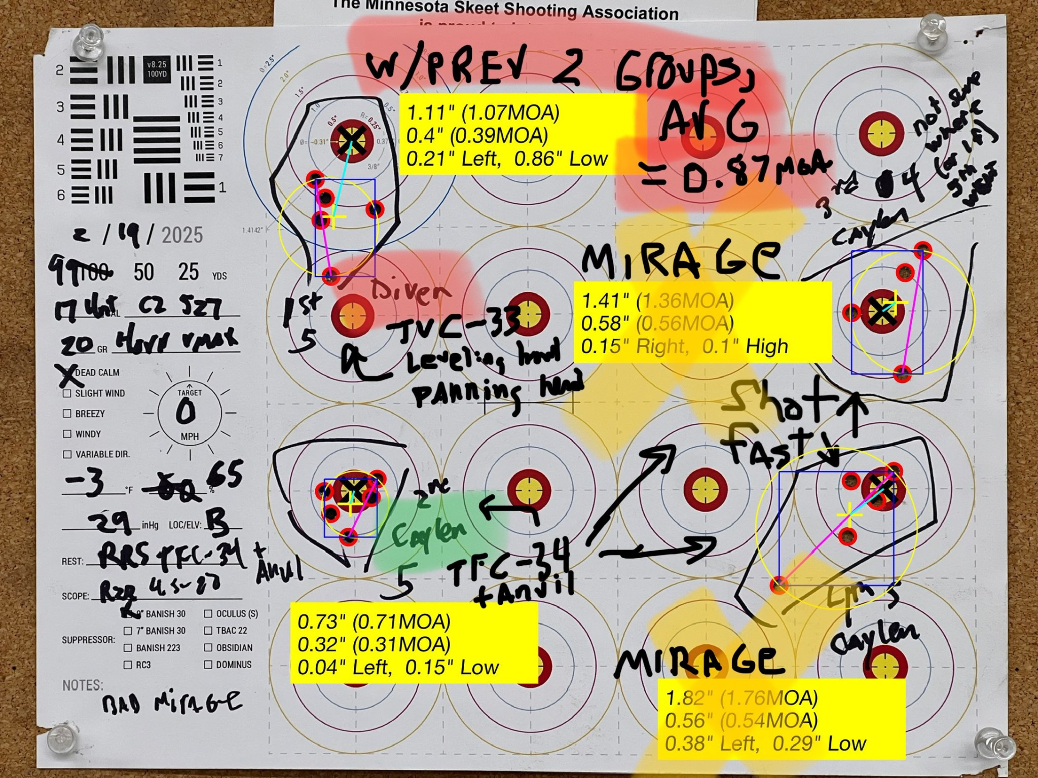

Anyway, the goal was to shoot some “Diver” groups and some “Caylen” groups. Decided to try a light centerfire caliber to start, a 17 Hornet. Figured that largely would eliminate recoil from the equation…I’ll work my way up to a 6br or 308 later.
Eliminating a warmup group and the groups utterly spoiled by extreme mirage, I got four 5 round groups that were shot rather excruciatingly slow. The results are as follows:
American EagleAmerican EagleHornady VmaxAvg MOA
Diver*0.870.661.070.87
Caylen**0.710.71
*RRS TVC-33 + leveling bowl + panning head
** RRS TFC-34 + Anvil 30
I was impressed by the decreased wobble I noticed with Caylen’s technique. I definitely am going to keep testing and practicing it.
Next time I’ll be using just one ammo type and one tripod setup. I had thought I was going to get more shooting in with more vmax groups as I ran out of the American Eagle while warming up.
Had to use two tripods as I had forgotten I can’t clip in a pic rail to the TVC-33. Ah well.
But that damn mirage kept popping up and greatly slowing me down. A slight breeze would’ve helped. I can’t figure it out…it was overcast…I guess the ground was just a little “warm” (lol at -3°F) compared…to…the air? We’ve had two or three -18 to -20°F nights immediately before tonight, so I don’t know where this mirage is coming from.
I know the ground is warm deep down, but in MN we have about a four foot frost line. That means the ground freezes four feet down. For example, if you build a deck, the support beams need to be driven at least four feet down to avoid frost heaves wrecking your deck.
But maybe the ground is just warm enough that on a windless overcast night there’s enough heat differential to create mirage? At 99 freaking yards? My best guess.
Anyway, I’m a believer in showing the ugly and entire groups/truth. Here you go:
