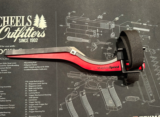

SOLD MagnetoSpeed V3
MagnetoSpeed V3 in good condition. Everything included and works as it should. Selling as I bought a Labradar. $340 shipped.

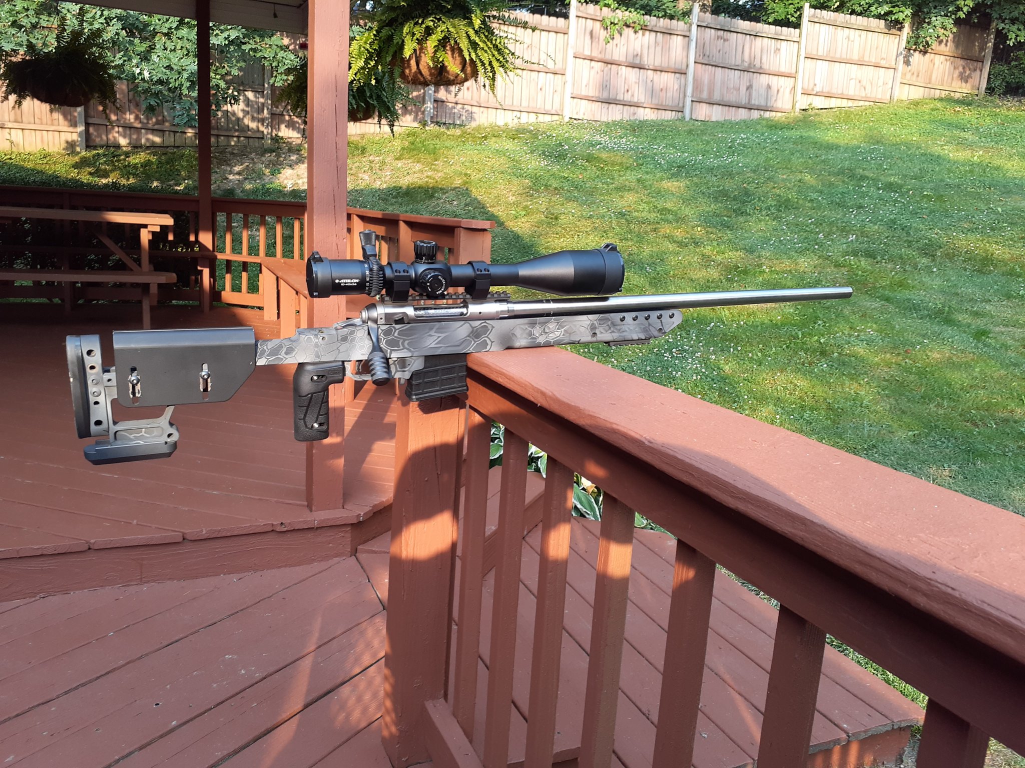

SOLD 6BR rem700
Trued reminton 700, bushed bolt, fluted firing pin, threaded bolt handle.
6 BR, 28in bartlien, mtu, 1-8tw, 4 port muzzle brake. About 1200 rounds through it, still cuts holes at 100yds
Cerakoted burnt bronze
Timney calvin elite
Greyboe ridgeback, sawtooth arca, dbm
$1400

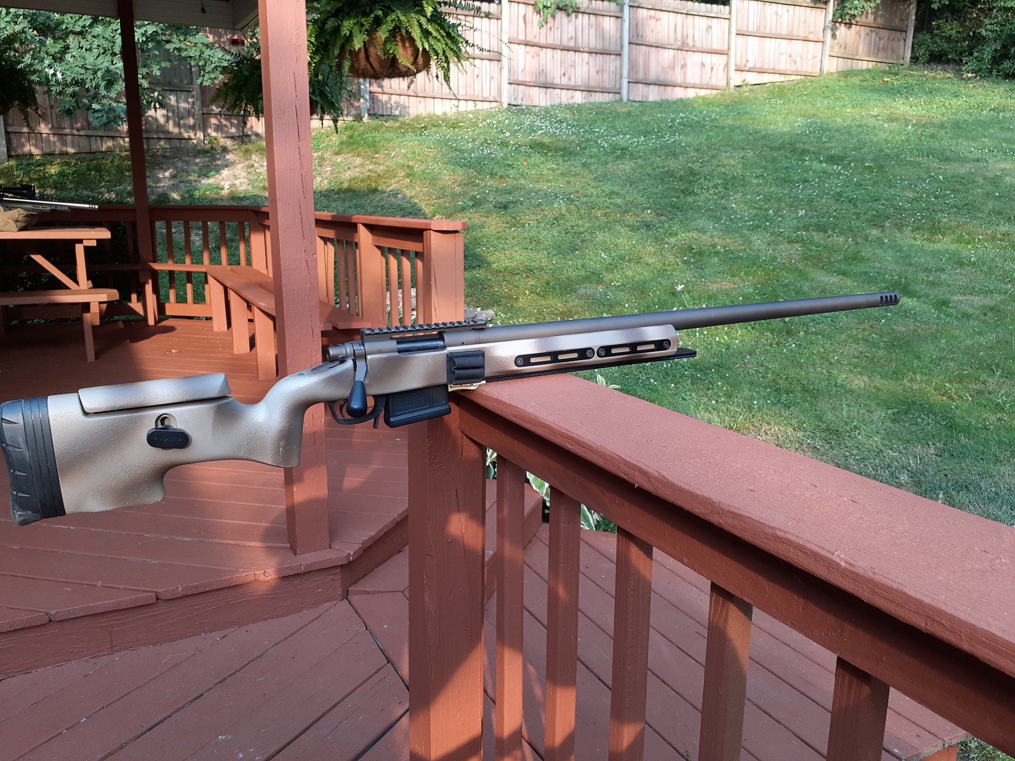

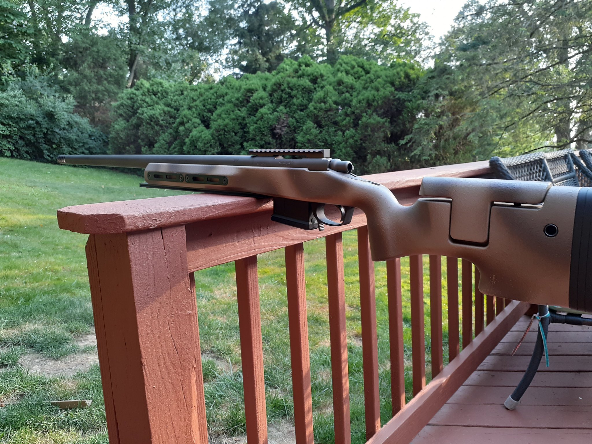

SOLD 223 semi custom
Savage model 10 stainless
223 criterion 1-9tw, varmint contour, 300 rounds
NSS recoil lug and barrel nut
Badger steel 20 moa pic rail
Tac bolt handle
Mcree precision chassis with bag rider and front pic rail
Scope can be included for additional cost.
$950
