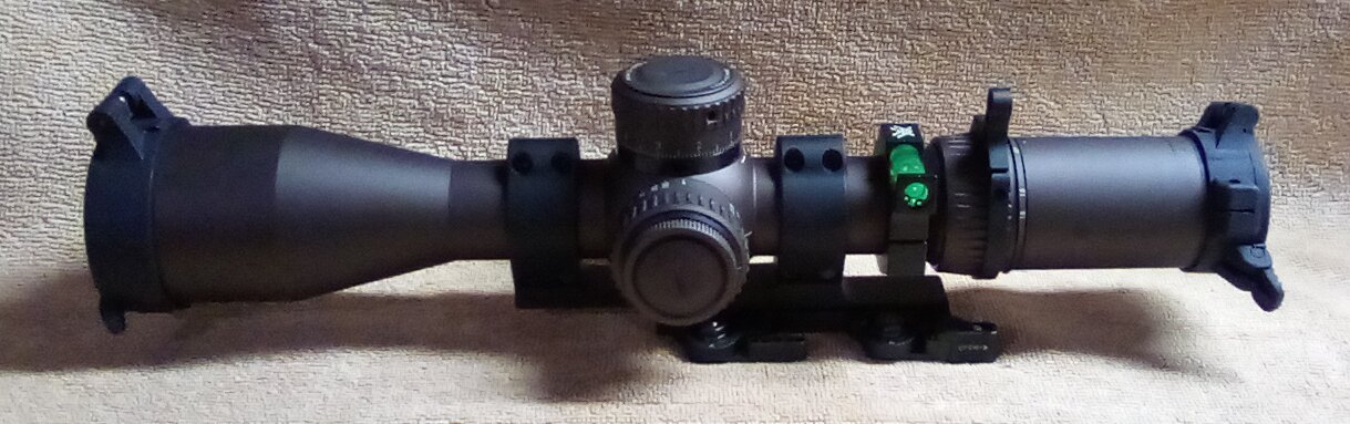

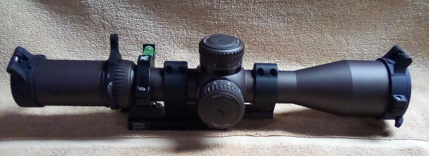

Optics SOLD... Razor Gen II 3-18x50 mil/mil (another price drop)
Up for grabs. Excellent condition. Bought here a month ago for a build that ain't happening.
Comes with Larue SPR 1.5 quick detach mount. Put it on my air rifle to get a feel for it then back in the box. (Included also). Vortex bubble, throw lever and Aadmount flip ups.
Asking $1275 shipped f/f or add fees.
Thanks
