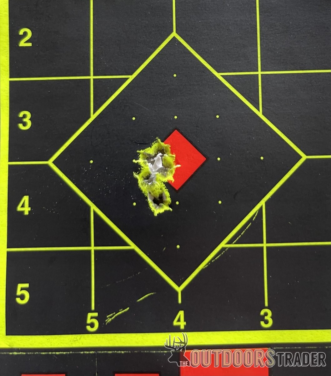

Curtis axiom 223 26 inch brux barrel 1in7 twist with tuner ,apa chode brake and triggertech diamond trigger. Gun was chambered by elemental industries out of Tennessee. Shoots 75 80 and 88 Eld bullets very well. Will give load info to buyer the group below is with 88 eld 2825 at 200 yards. Approximately 475 rounds down the barrel.
1650.00 shipped.
