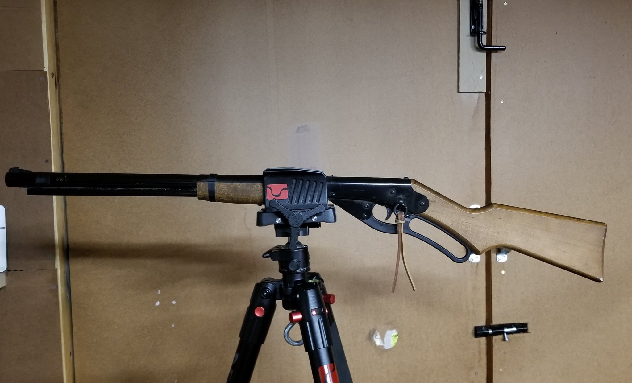

Received my kit and I’m super happy. Great setup.

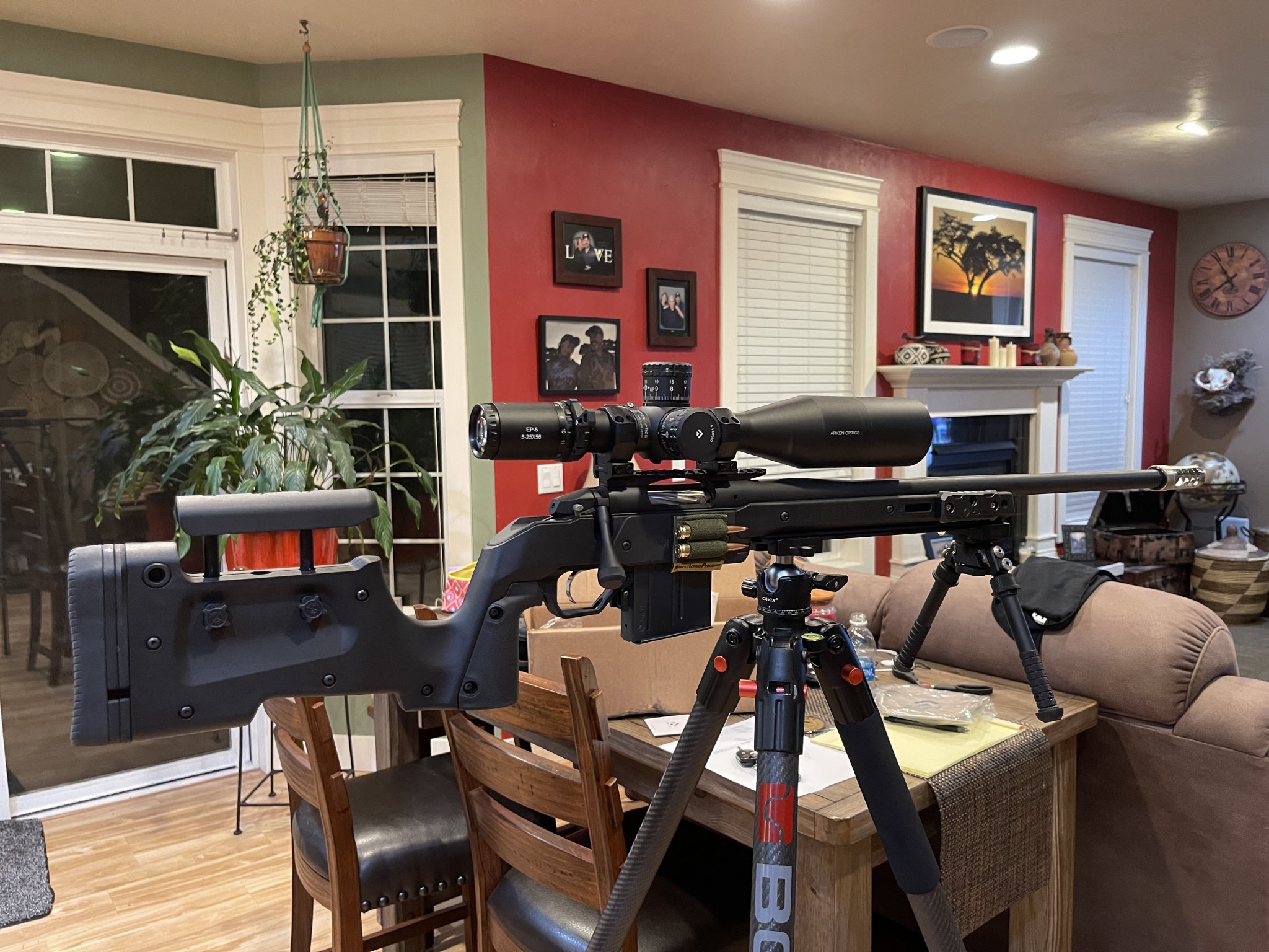

To install you would have to remove the one bolt holding the deathgrip to the tripod. Once you do this the bearings and bushings (you will not need these any longer) will come out. You will end up with a hollow casting as seen in the images. Once you have this you can insert the aluminum bushing from the bottom, then insert the new bolt through the bushing and install the ball head onto it. I recommend a dab of Loctite on the bolt before installation.
If you want to use the deathgrip that you just removed you need the kit with the adapter plate. This plate with the 4 supplied screws will attach to the deathgrip head and can then be locked into the arca-swiss ball head.
This entire assembly weighs ~15oz, you will be removing ~8oz to install. So in total you will add about 8 oz to your setup, plus any additional items you decide to add.

Got my full kit yesterday and installed it last night. I was impressed by the fast service, communication and quality of the kit for the money. Simple to install and bushing fit perfectly. Certainly improved the functionality and versatility of the BP.
I have not acid tested it yet by throwing it in back of the SxS or bed of pick up and headed to pasture and hunted with it yet, but based on what I've seen so far, I'm sure I'll be grinning.
