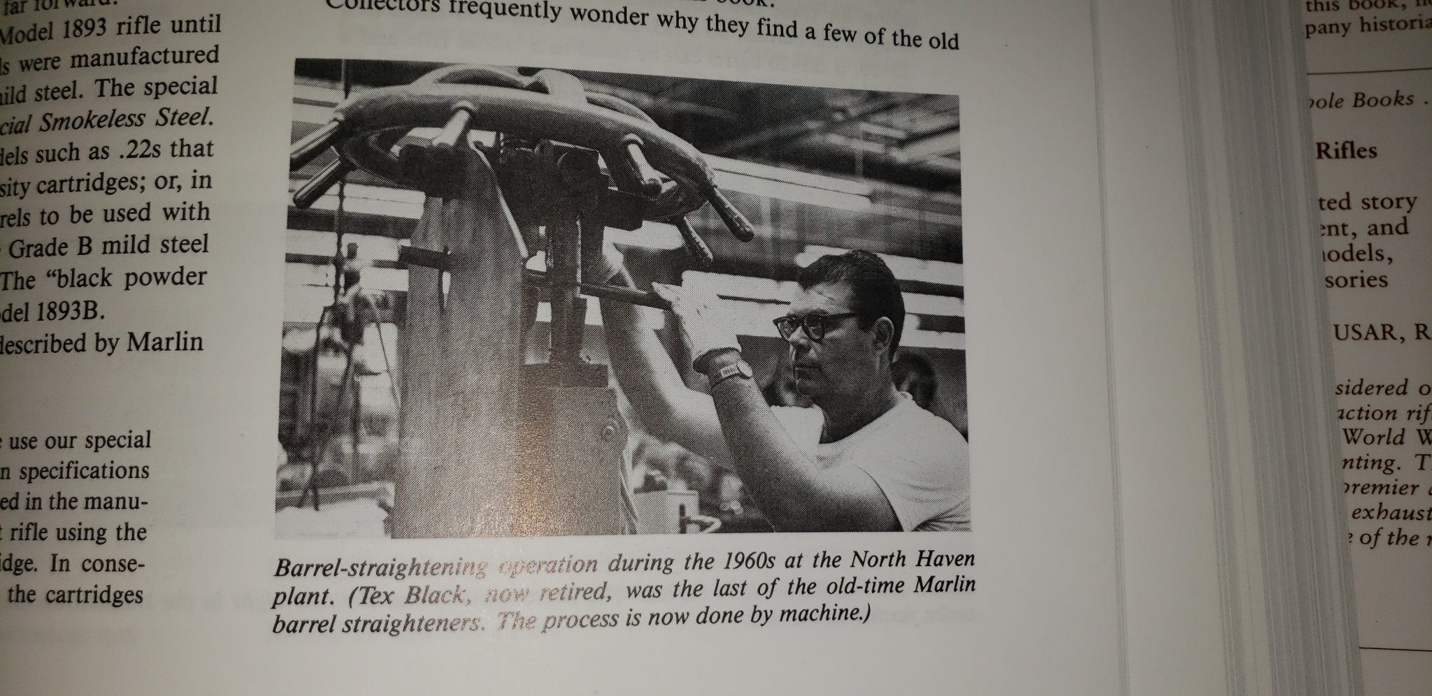

Also, on straightening barrels, as I noted above: Springfield musta not noticed thats detrimental because they straightened barrels..?? I wonder if they simply aint know its detrimental or ifi it was for reasons of consistency/interchangeability among stocks..?? Maybe they did know it was detrimental as I wonder if 1903NM & M1 NM barrels were straightened..??
Thay probly just used barrels which required no straightening for NM barrels. This is how the PSG! barrels were, whichever barrels came out that required no straightening were designated for PSG!/MSG90 barrles.

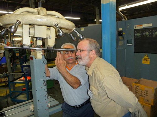

I've got another picture or two at work of barrel straightening but this is how it was done. The blank was inserted into the machine/call it a press. There is a block in the middle per say and a block on each outside end. A guy would look down the bore of the barrel and by eye index it and bring the press down and straighten the blank.
According to the book Marlin now uses a machine to do it and not by a person. I know Savage till at least the 70's maybe early 80's still did it this way.
Don't know if Springfield Armory (old SA) straightened barrels or not. Never seen any documentation that they did.
Again to us straightening a barrel is bad juju. For a factory sporter type barrel....I get it. On a hunting rifle and for a shooter who doesn't shoot a ton of rounds thru the barrel and or get it hot most likely doesn't really effect the accuracy a ton.
Also on lower grade/quality type barrels on lets say more of a factory type rifle it's about how fast they can get it done/get the barrel made. Time is money. So instead of scrapping the blank.....the one here or there they straighten it to use it.
Just a couple/few years ago I was watching that military channel where they go to a defense contractor and watch how military items are made. They went to a AR manufacturer and was shocked when I seen a worker putting a partially assembled AR barrel into a arbor press and going off the o.d. with a indicator would straighten the blank until a gauge pin would drop thru the bore. I guess it's a machinegun in the end! You get what you pay for.
I just recently (don't ask me to do this for anyone) took a 70's made Savage 112V barrel (223 Rem.) that was a take off for a gun I rebuilt for my son. This was the older J series single shot varmint/target rifles they made. Actually pretty nice guns. Anyways the bore was heavily shot and was pitted. So while waiting for my new 6.5mm blank for my rebuild/build of a model 110S in left hand (silhouette rifle) I took the 223 barrel and got a hair up my butt to rebore it to 6.5mm and rerifle it. The barrel had a slight bow to the muzzle end but it wan't horrible. The barrel turned out excellent. Rechambered it to 6.5CM. The rifling was done in 5R and 1-8 twist. I shortened the barrel from 26" original down to 23" and ended up cutting the bowed section completely off. I've done a couple quick tests with the rifle and it's shooting box Hornady 140ELDM ammo in the .5moa range and handloads with 135 ATIPs in the .21 to .32moa range and I've shot it out to 430 yards and the frickin stock isn't even bedded yet.
Reactions: sinister
Here is a better pic compliments of accurate shooter/Savage/cast boolits.
So as of 2011 Savage was still straightening they're barrels.
I stand corrected on old SA they did straighten they're barrels.
