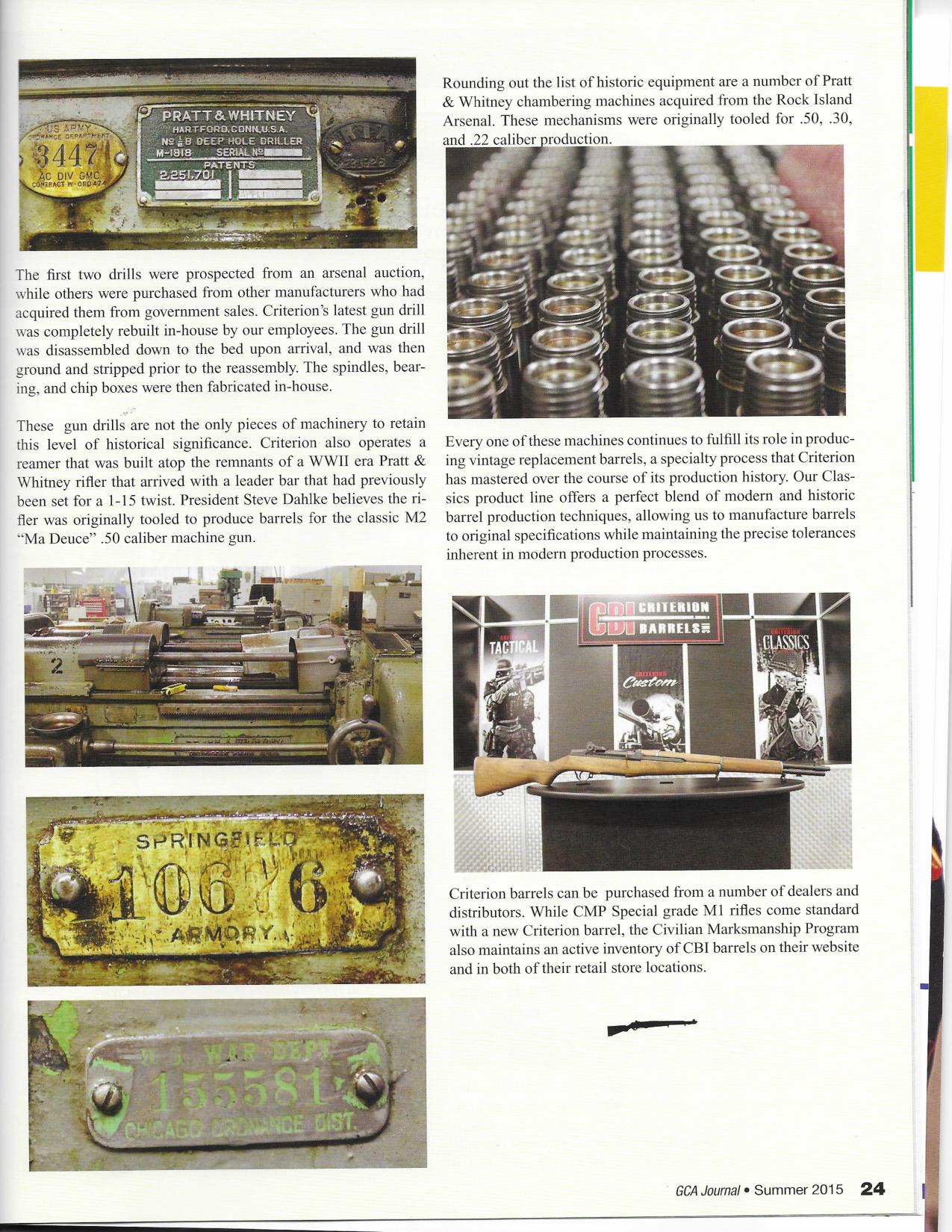

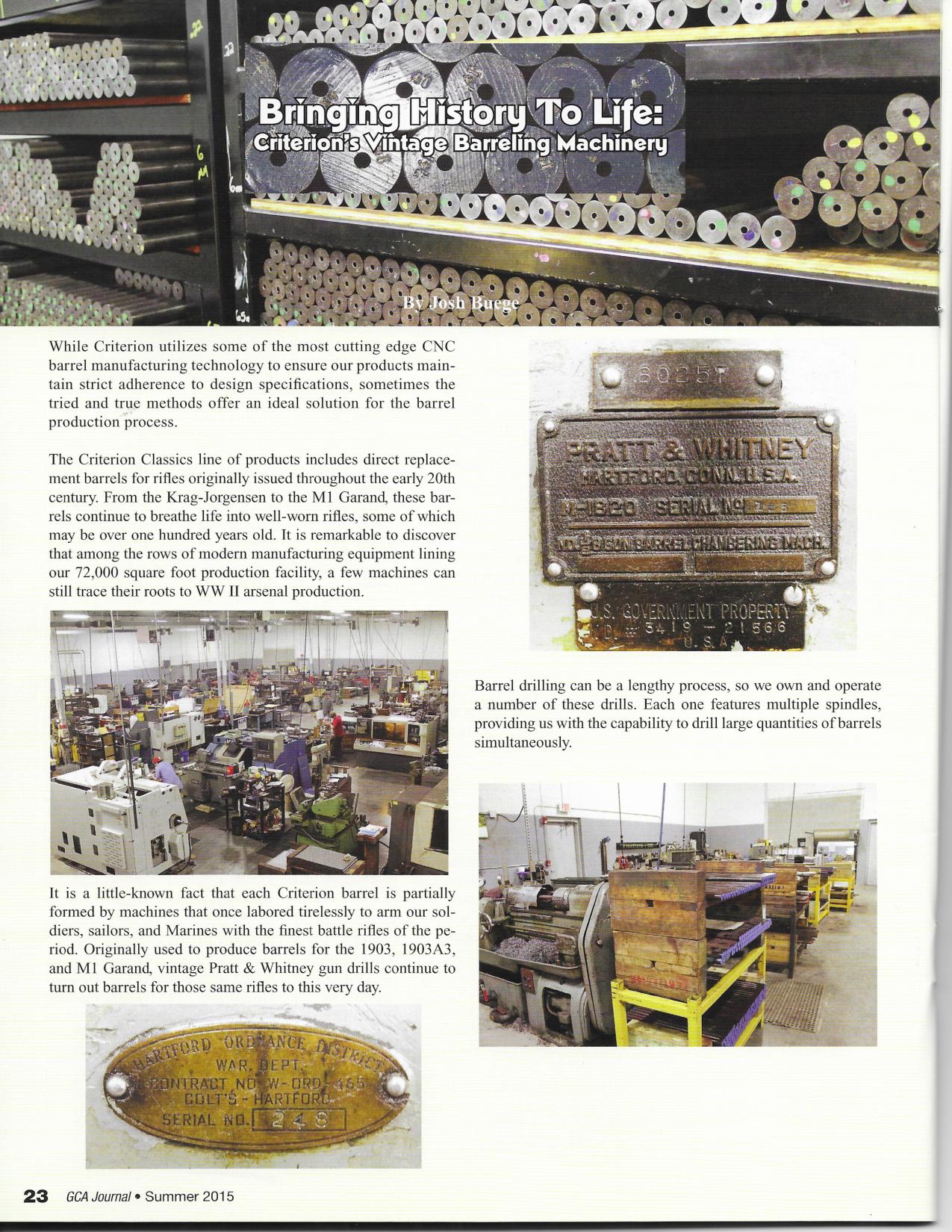

Criterion bought up a bunch of the original equipment that made a lot of our stuff and refurbished it and are making stuff for CMP.
Josh would be a good person to ask this question to,I'm sure he could tell you more than you'll ever want to know about it.
Thanks for the shoutout @Ravenworks - Imagine my surprise when I'm just casually browsing along on the Hide and my name pops up in conversation!
These days I'm no longer affiliated with Criterion (I work for a marketing agency that represents a few firearm manufacturers like Vortakt Barrel Works and Midwest Industries, and put together my own little side-hustle start up called Precision Rifle Components), but I do still have a copy of that GCA article we published regarding the vintage WWII machinery Criterion was using in the shop at the time (see attached).
Aside from that, @Frank Green is most likely correct with his assessment that Pratt cut-rifling machines were used in the wartime production of M1 Garand and 1903 barrels (with both Sine Bar riflers and the B-Series hydraulic riflers).
You can find a nice little write-up on the subject here.
