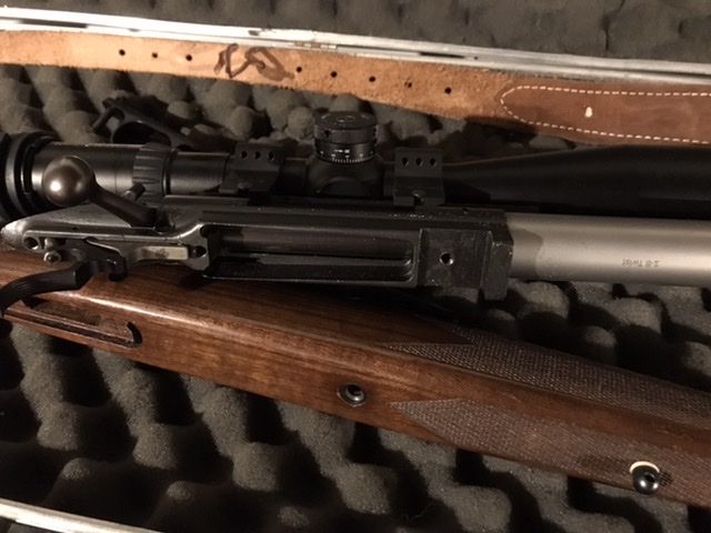

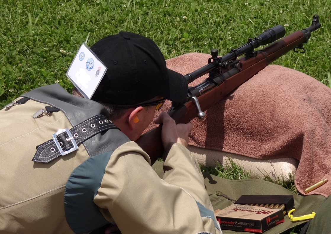

Super late to the party but I have this

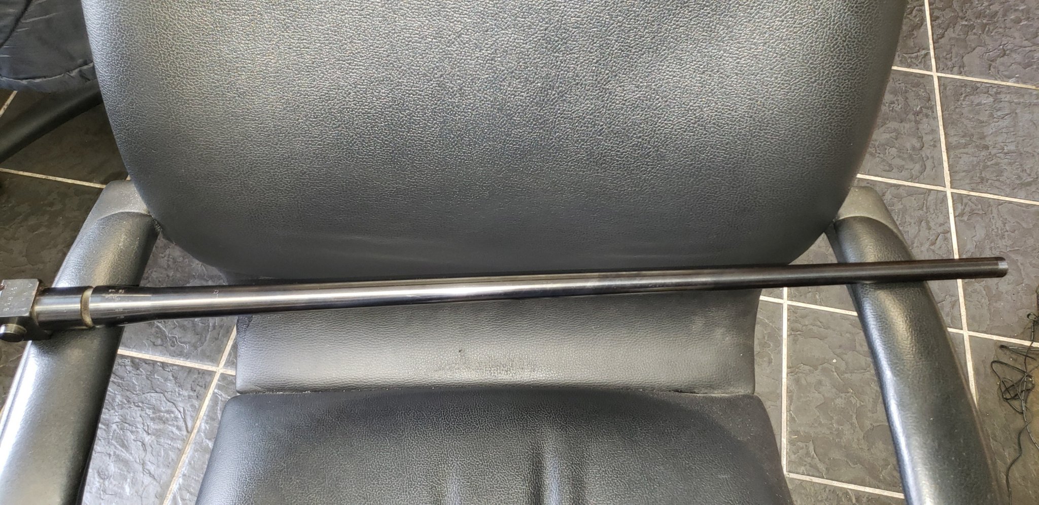

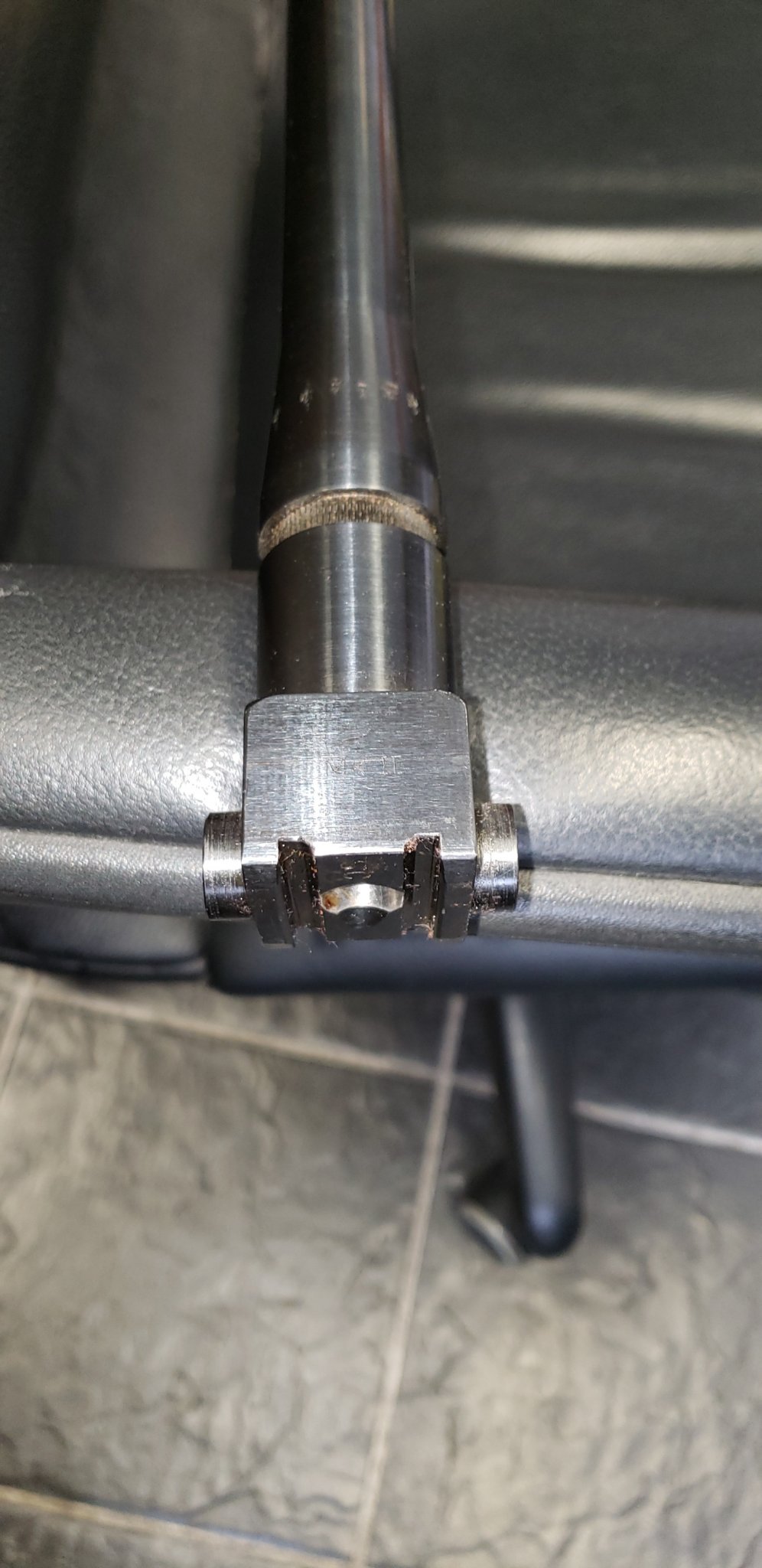

Sorry if the barrel is a little dirty/dusty in the pic's but this is the 303 Vickers barrel that is dated 12/45 that I spoke about in the previous reply. Wish they made stuff like this now a days.
For $30 I couldn't make a barrel like this with that one piece breech end/block and lugs on it.
Look at the fine polish too on the surface.
Its a damn shame the industry got away from cut rifling. At the same time I understand it, but still it'd be nice if stuff like that was still standard issue. Ultimately tho it just aint needed, and as you said getting rifles in soldiers' hands is most important, and CHF is so fast while also producing a service rifle barrel thats capable of minute of man to ~300yd and possibly providing some barrel life benefits. I believe you're right also in that 6 MOA is what we currently hold our service rifles to. And I cant imagine basically every M16/M4 doesn't pass that with flying colors, even non-free floated with FMJ.

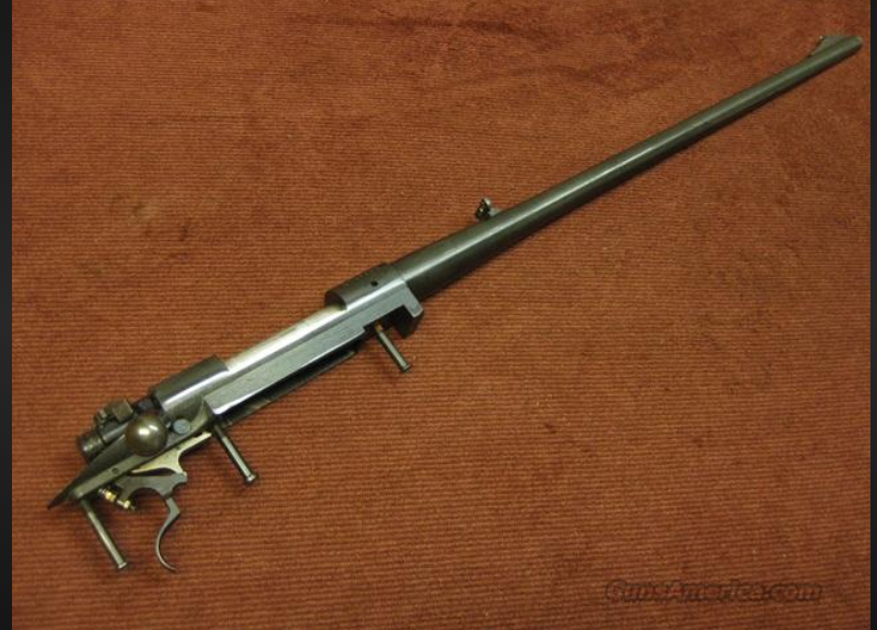

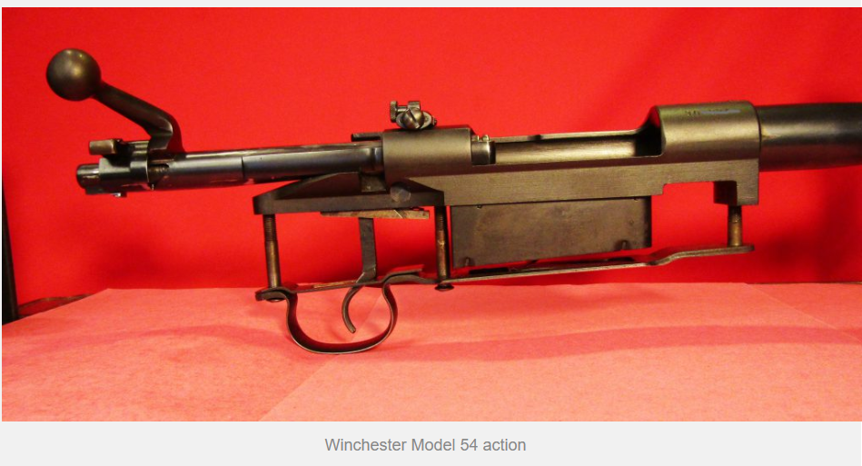

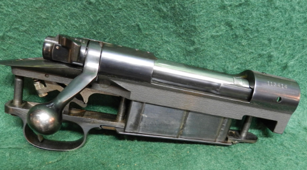

What do you think about actions with the front action screw going into the recoil lug @sandwarrior ? Any disadvantage there - or requiring different bedding?
LOL ...
You mean like Mausers and Winchesters? There is a huge advantage there. That is why some of the top accuracy actions have gone to an integral lug instead of the R700 style where it slides over the barrel. Although, the front screw doesn't go into that lug. Many are now coming to the conclusion the R700 style leaves too much to vary. It looks solid, feels solid, but is three parts instead of two. In a place where most of the stress is initiated.
One thing I always do with any recoil lug is bed FRONT and BACK and SIDES of the recoil lug. Leaving the front open gives the action a direction to move. You don't want that. Torsion while firing is why I also came to this conclusion about bedding the sides.
Added: I also full bed the tang, and pillar bed the action screws. ALWAYS making sure there is no stress on the action. That's huge with any action.
Added: I put Winchesters in there as an afterthought, thinking I might have forgotten them. I went back and looked at my post-64 and not, the front action screw does not go into the lug.

I’d prefer not to have the screw go into the recoil lug. That being said I’ve bedded 03 type action with no issues. Bedding being in front of the recoil lug is a preference thing in my opinion but I do the whole action area for the most part no matter what.

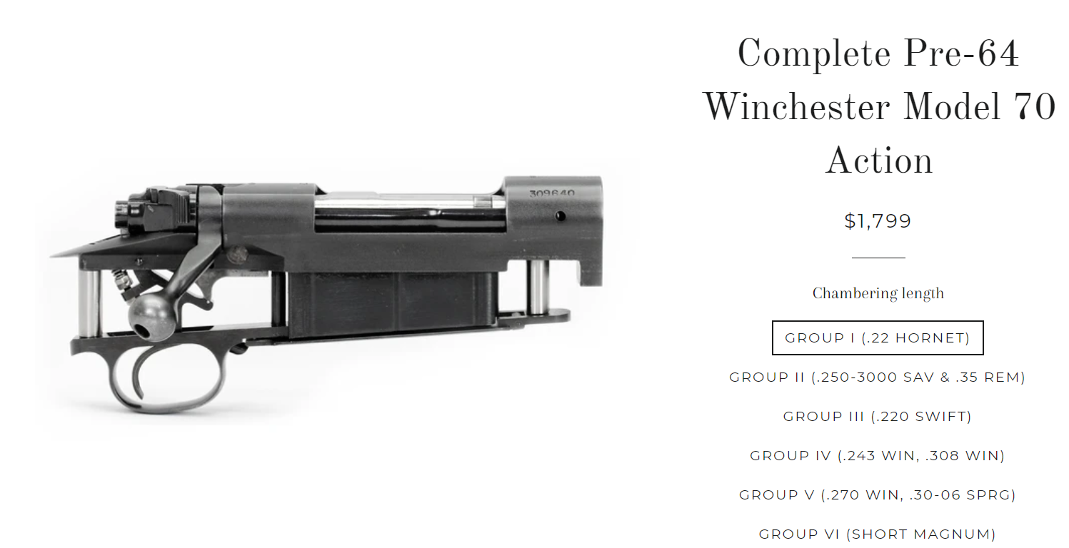

And Agreed, I have to imagine Winchester got away from screwing into the recoil lug for a reason.. How about bedding the barrel shank? Ive always figured fully free floated was best but screwing into the recoil lug like Mausers/03's might change things?
Winchester never got away from screwing into the recoil lug that I know of. Unless they did it with their XPR model. Which was a way to reduce costs, not make better bedding. The classics, last time I looked, still have the action screw going into the lug. The integral lug, IMO, is the real benefit. One drawback could be that the screw going into the lug might be a casue of stress, but in a properly bedded rifle, it should not be. That's a reason I also make sure the bedding is under the recoil lug.
