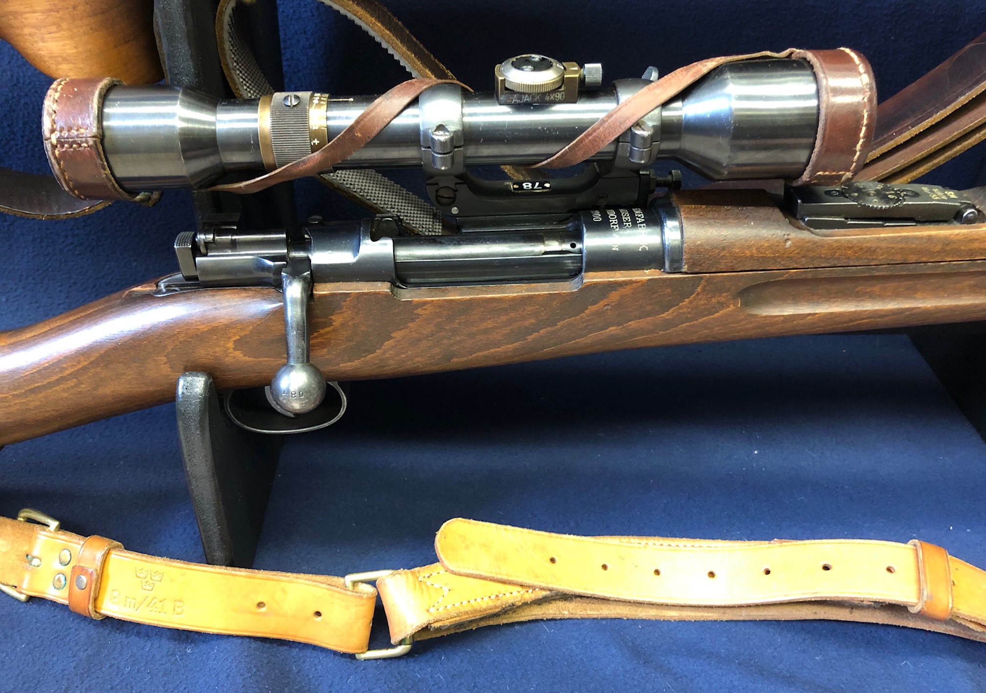

Attached is my example built on a 1900 Mauser action along with a 1941 dated scope. I've read that 5900 Swedish M41B sniper rifles were made, so I assume that was what they needed to equip their army, esp as a neutral country that avoided armed conflict in WWII. Combined with excellent ballistics of the standard GP41 ammo, and the practice of individually testing potential M41 sniper rifles - they were probably one of the most accurate sniper rifles of WWII.
The Swedes never bothered trying to mount a scope on the M42B (aka Ljungman) b/c they already had a very accurate sniper rifle in the M41, and probably not enough scopes anyhow. I think mounting one would have been a huge challenge given the lack of real estate on the receiver and associated violence of the action on an M42B. (fwiw, "M1 Thumb" is gentle compared to what happens within a Ljungman action during its powerful cycling movement, which would probably quickly beat to death a typical WWII era optic. Heavy-duty British Mk 32 scope would probably be the one exception).
After WWII, the M41s were updated in the mid-1950s to the M41B designation with Germany rebuilding all of the Ajack scopes with coated lenses, an improved mount was used, new rear sight, and various other small details were incorporated. I recall reading that they were actually used up till about 1990.

The best optic for an K98 is probably a 6x Zeiss or something similar, but I think the CMP competitions limits it to 4x power. The problem with many of those scopes is a lack of windage knobs for quick adjustments in the wind. The high cheek weld is pretty bad on them too.
I don't know what "gamesmanship" issues are being discussed re the CMP vintage sniper match, so I can't comment, other than to say the 1903 w/ 8x scope typically dominates the competition. Its been that way since the cheap Leatherwood USMC replica 8x scope came out for $500 back in 2011 or 2012. Perhaps some don't like that, but an 8x optic at 600 yards allows much more precision aiming capability than a 2.5x, 3x or 4x optic at that same 600 yards.
That said, two of the best shooters who have won several times recently competed with an M1C with 4X scope and shot a team score of 390-12x - which is phenomenal. So shooting skill of course matters a lot, and this article is pretty inspiring to me...and shows that a 4x scope can also be effective.
The 1903 with 8X scopes should use the Steve Earle scope blocks as they are properly hardened and better made than the Chinese parts that come with the Leatherwood repo 8x scopes. The screws in the mount should be replaced with properly hardened screws, but the optic itself is fine. I've not had any issues with my set-up, which was built in 2012 and has been used ever since (but not this year thanks to the pandemic).

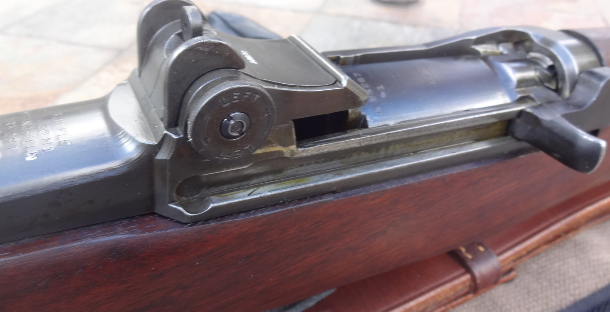

Check out the milling at the very rear of the Win op rod track - square cut - like early SA. SA changed to a round finish at some point.
So SA modified the design through the war not so much Winchester.
