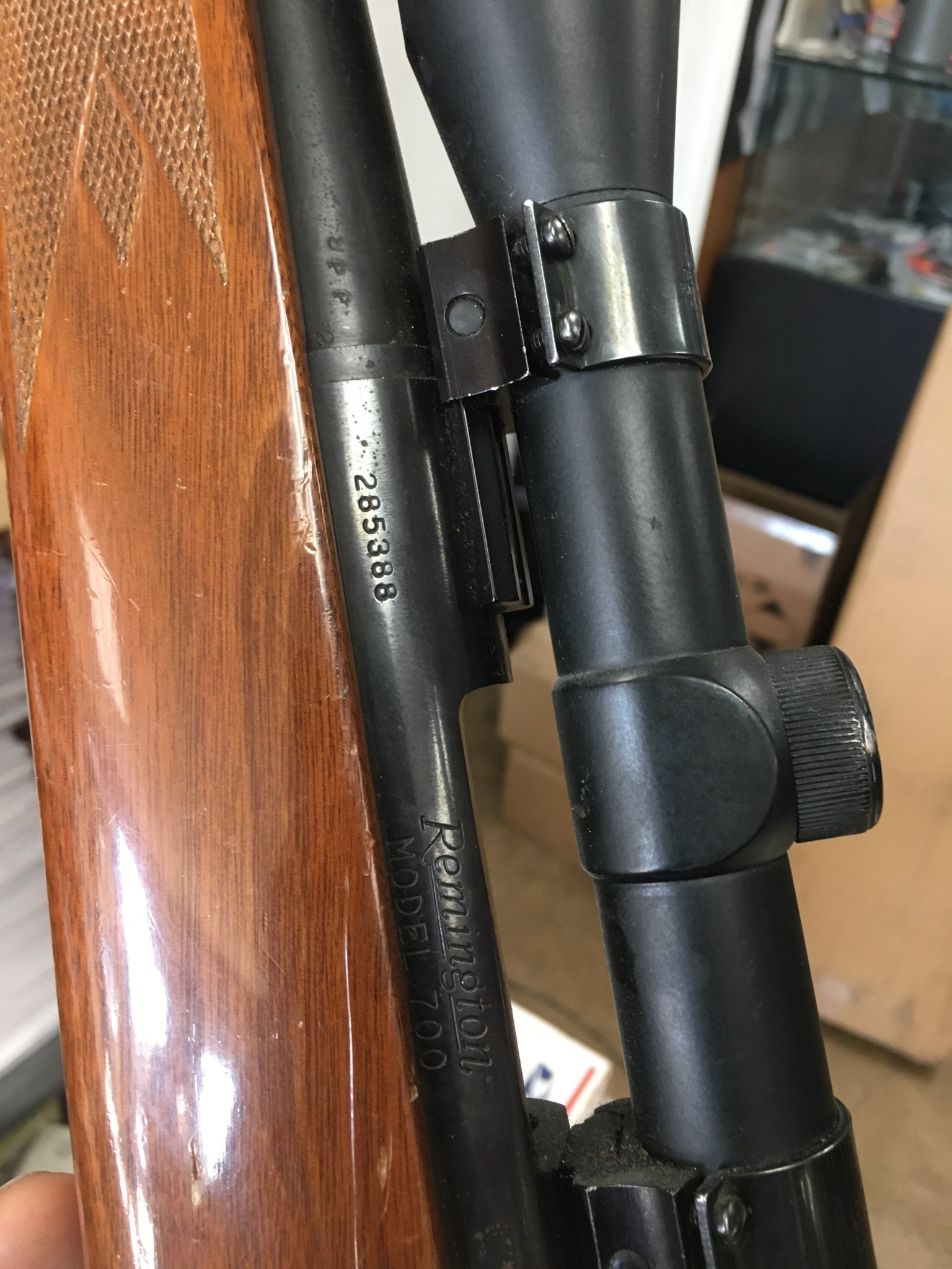

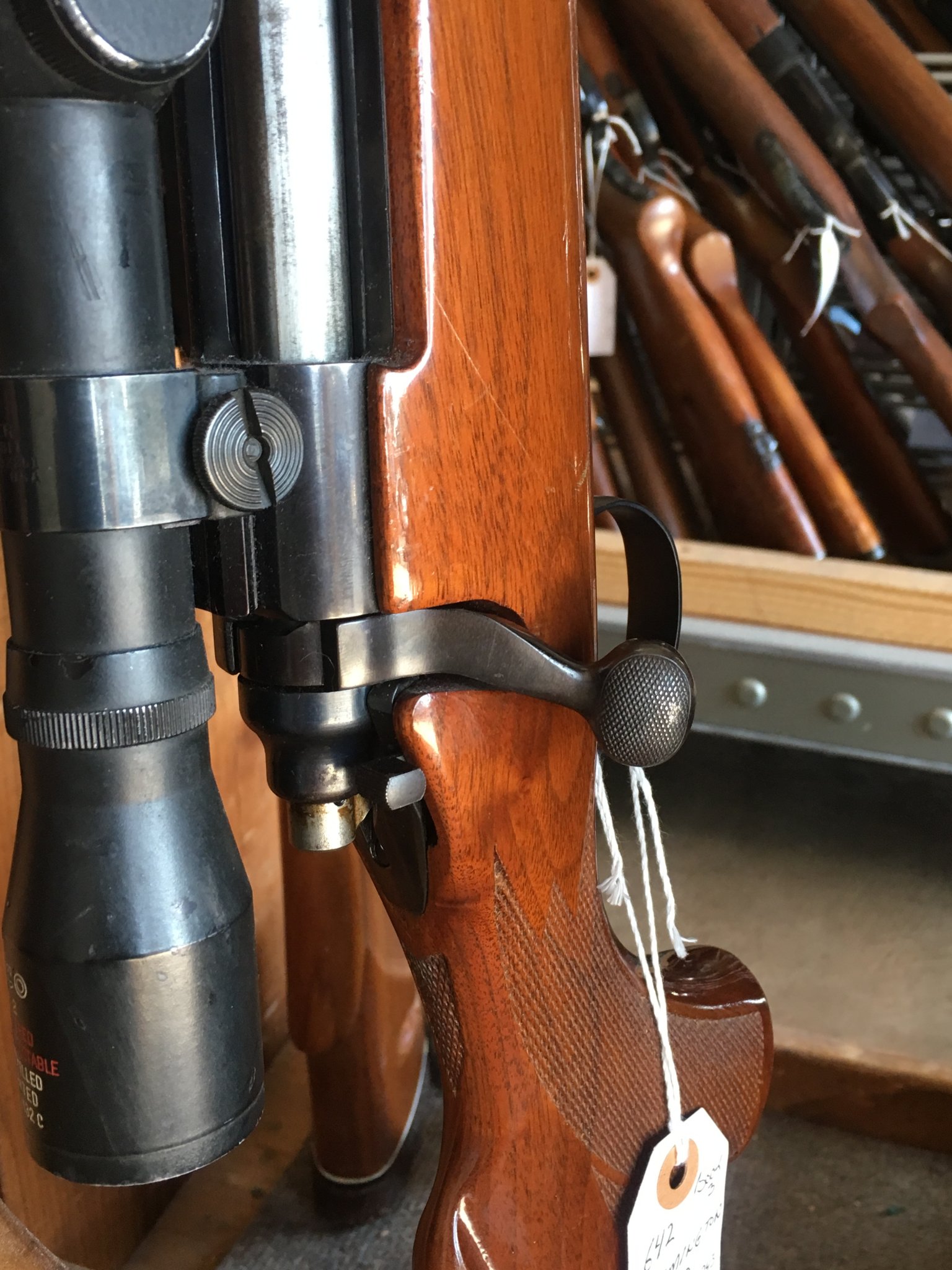

Came across this old thing at the local consignment rack. Barrel code indicates assembly in June of 1967 and the SN is within range of the original USMC M40. Didn't plan on building one but I just might have to if I can get a decent deal on it. Has the short nose shroud and tombstone safety. Not the prettiest rifle, but it might just do. I'll research a bit to see if it'll be correct for an A1 build.

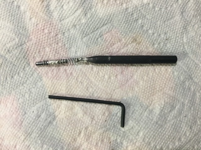

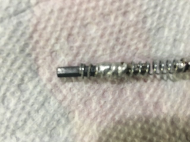

On a lighter note, I made a version of the tool used to run up the screws in the Unertl style rings. I saw one posted some time back that looked really great. Mine doesn’t, but it works. Smallest spring the hardware store had of the proper type, a piece of the correct Allen wrench cut off and the body of a broken punch. I soldered it together because that was the fastest, most solid connection I had the technology to make.

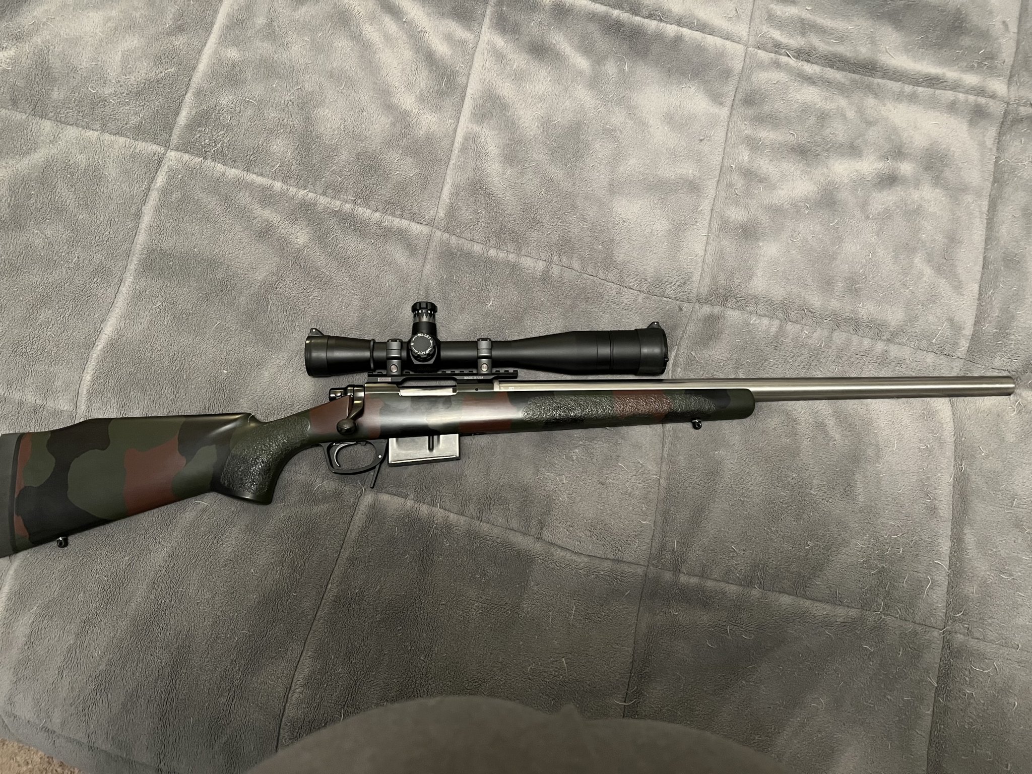

The scope is a one-off custom, based on a Redfield 3-9 scope with 3D printed parts to make it look like an MST-100. I ran across it for $100 and couldn't pass it up, Its perfect for my 40X 22lr and small game hunting ; ) By the way, I Love your rifle!!!!!!

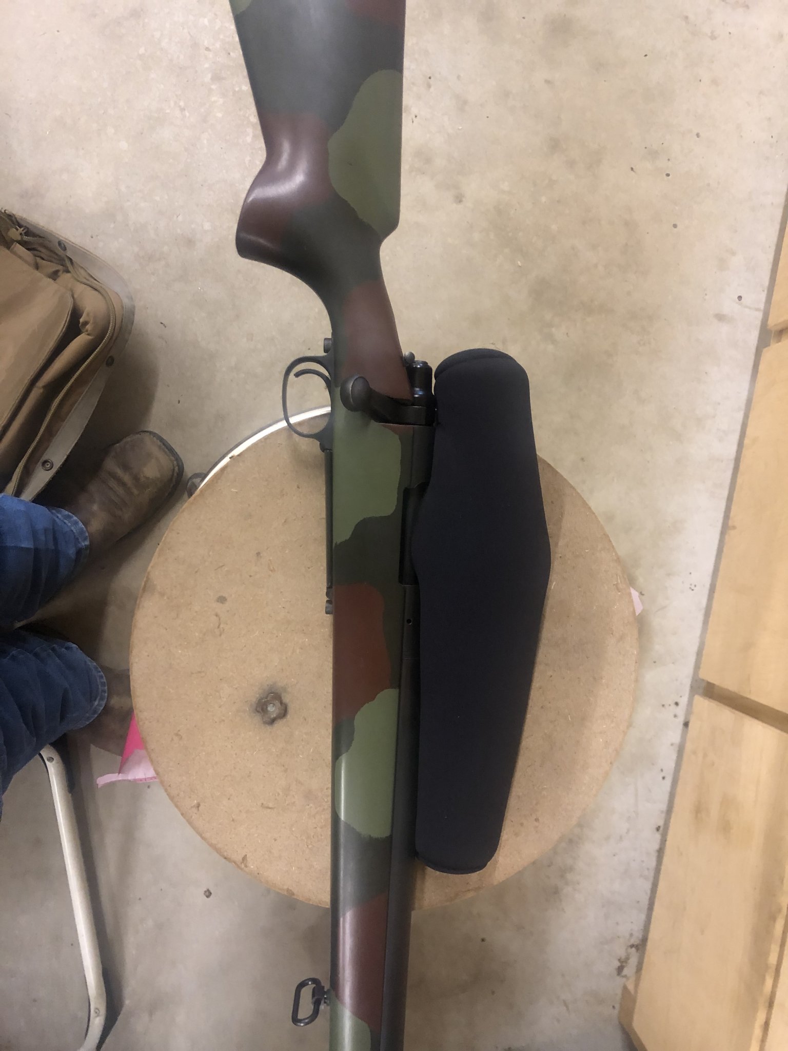

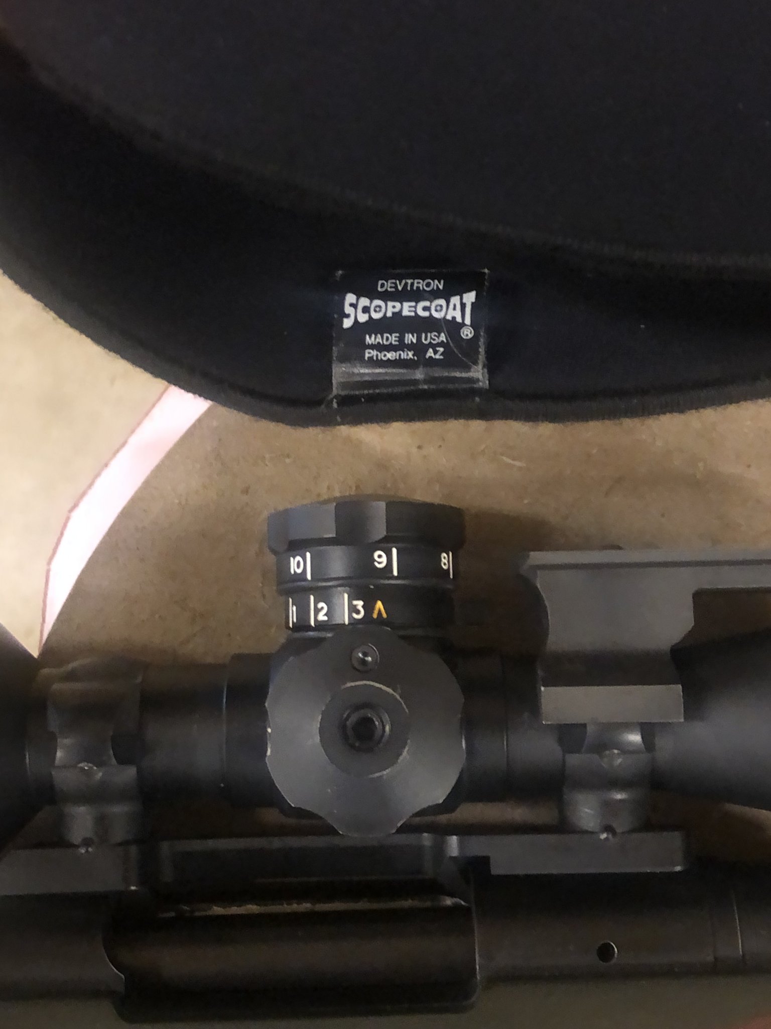

Ebay gets the eagle scope covers off and on. In my platoon they were privately purchased so I saw green and black.
The sock method was simple.
Cut a slit in a sock lengthwise but leave the toes and calf intact. Slip the sock over the scope through the slit. Tie the calf/opening in a knot.
The sock will now slip off and on using the cut slit.
Clear as mud?
Reactions: Redmanss
Eagle Industries is still in business, but don't have the scope covers or other HSRC items at this time.
Ebay has some of the Eagle Industries scope covers listed. They appear to the original but use your own due diligence:
