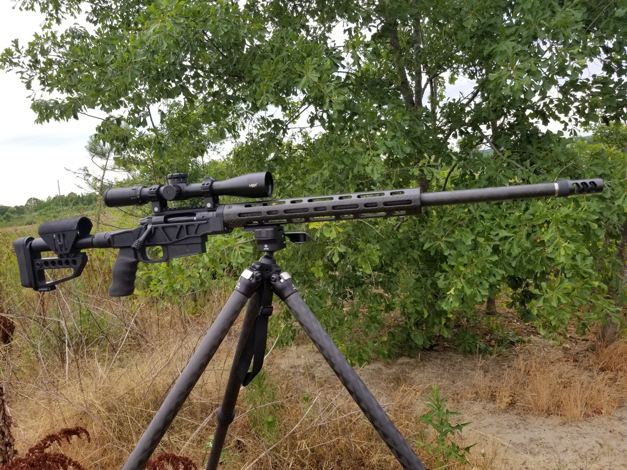

I also went with the 300 wsm. Main reason for me was the availability of components and data versus some of the wildcat cartridges. I should have my build finished within the next week. Waiting for the barrel to come back from the cerakote shop. I plan to reload for it but there also appears to be a lot of good factory ammo if I change my mind. I'd like to try out the new'ish Federal Edge TLR's. Good luck on the Elk hunt.

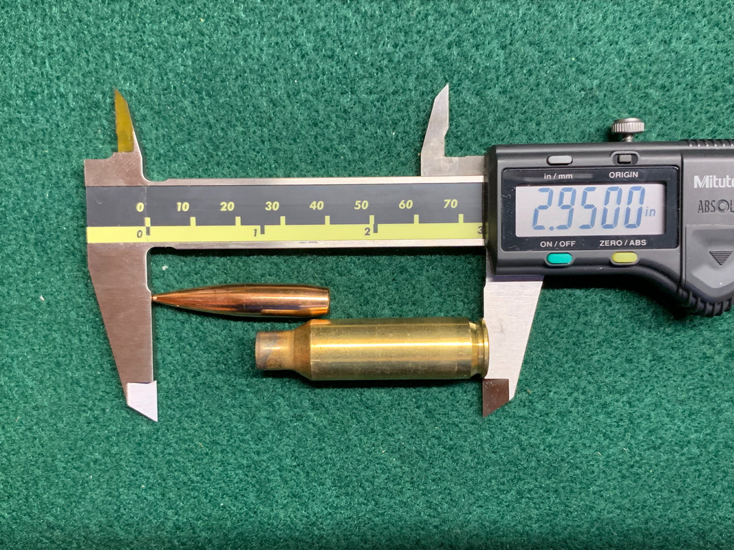

Is anyone running the 300WSM or 300SAUM in AICS mags with the 215 BERGER?
The 215 Berger has been an absolute hammer on elk for me. And I wonder if I could squeeze it into the SAUM or WSM case and AICS mags.

215 hybrid with a 300 SAUM case. I never worked up a load before I sold the rifle, however.
