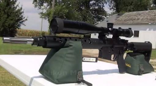

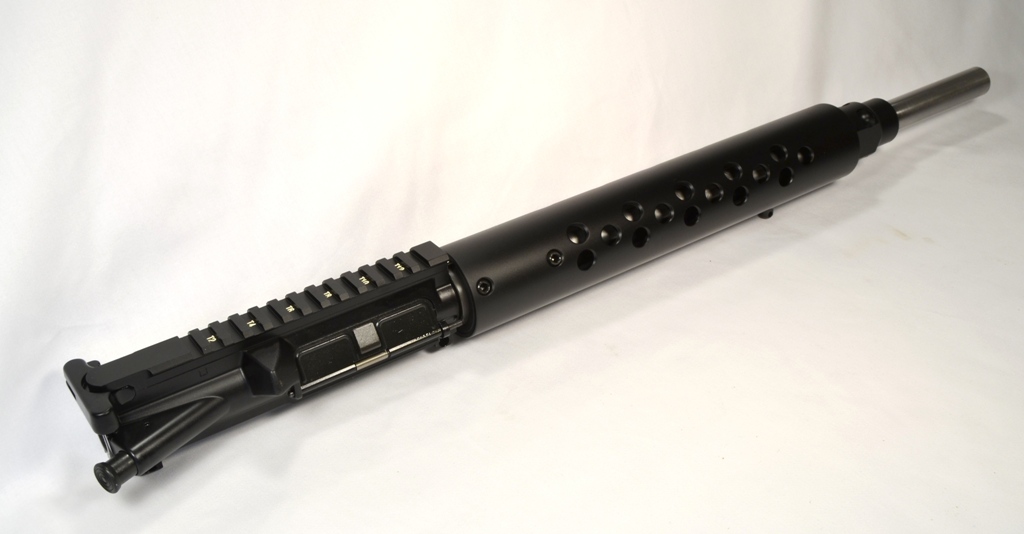

I have a complete WOA 18" Varmint upper 1 in 7" twist that will be full length fluted on order to put on my Colt LE6920 M4 lower which has a Geissele SSA-E trigger. I decided on it because of all the good recommendations I got on this chat room. They are supposed to be as accurate as any other.

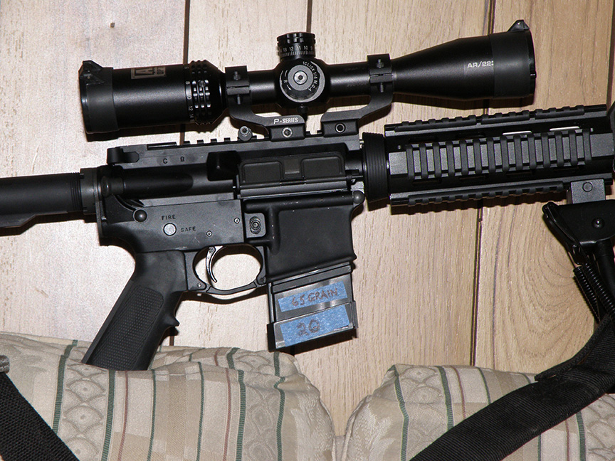

This is the scope I got and for the price it is great. I got it here on sale for $174 with free shipping. It is crystal clear with very good contrast. You can easily see your bullet holes at 100 + yds. The turret clicks are almost as good as my Vortex PST FFP MOA 6-24x50mm scope. They also return to the aiming point time after time.
BUSHNELL 4.5-18X40 BDC RETICLE TARGET AR-SCOPE | Sportsman's Outdoor Superstore
