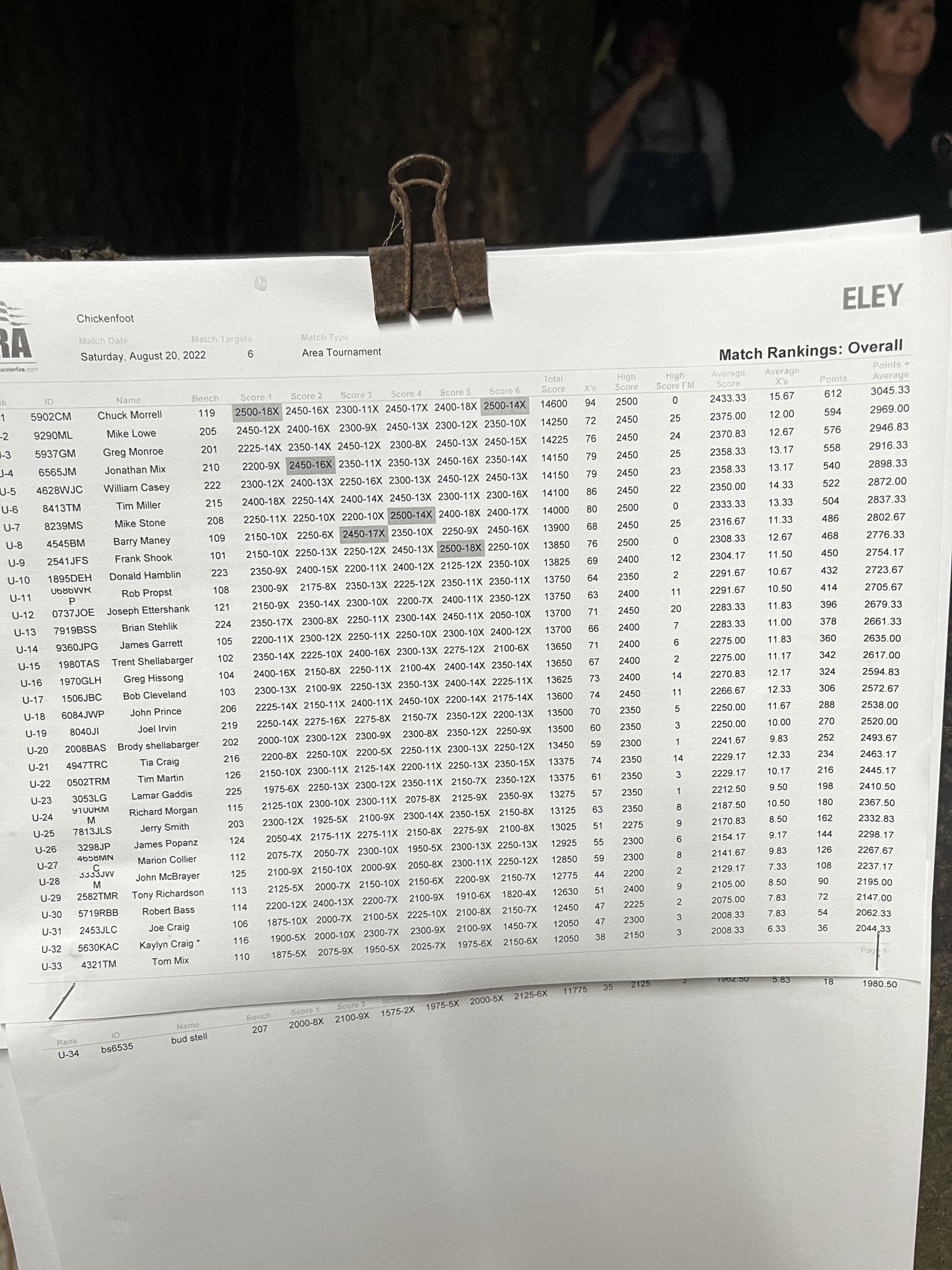

Chickenfoot. I went from 19th after third card to 7th after 6 th card.

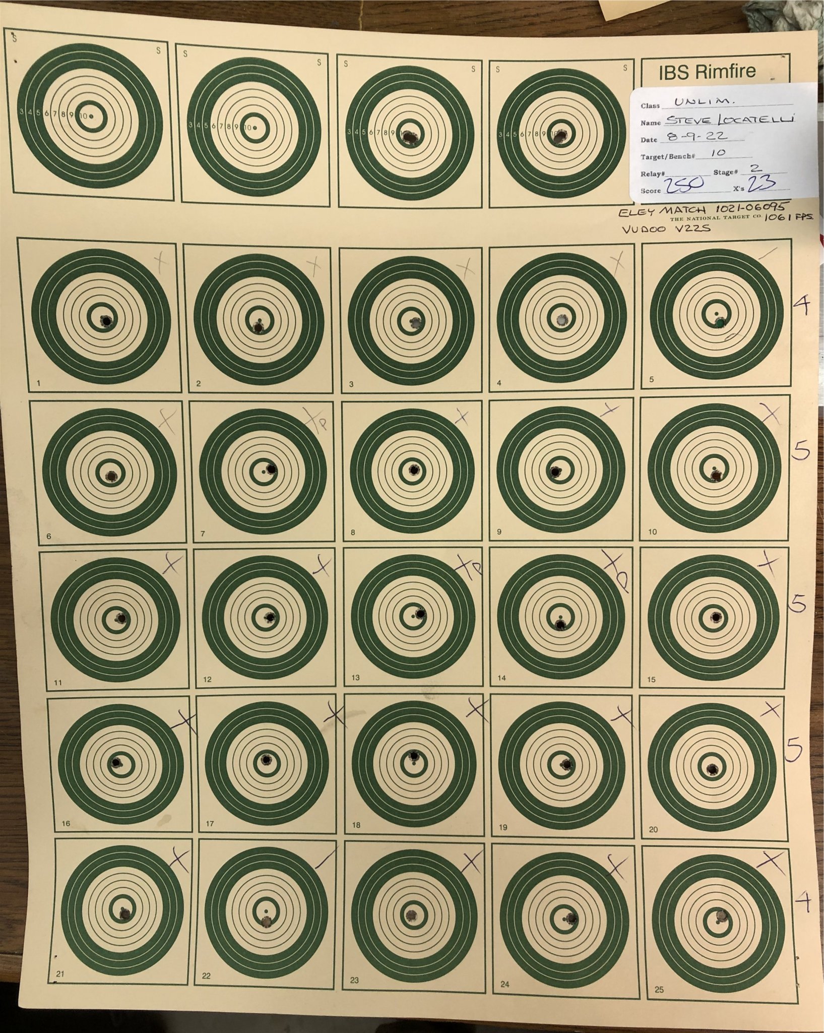

This week I shot my V22S in my club's monthly RFBR match. Conditions were excellent and I shot a personal best and won the Unlimited class.
I used Eley Match ammo and my Arnold one piece rest. This was my first use of this lot of ammo and it looks good.
My Vudoo sports a Shilen 24" ratchet barrel, McMillan Kestros stock, Flavio Fare trigger, Holeshot tuner, and NF 42x44 scope.

Good to hear from you 4certain.
I wrote the lot number on the target pic that I posted. 1021-06095 @ 1061 fps. I wish I could find more of this lot.
On the card just before this one, I learned something new. I found that on my Arnold one piece rest, after each shot, my cross hairs would recover from recoil "exactly" back to the spot where I shot. I learned to then stop and examine the relationship between my hold off and the bullet strike. Remembering this, I would use this hold off for the next shot, adjusting for any wind change of course. I have not had a rest that would do this previously. When shooting a two piece rest, this does not occur because there is no bungee to return the rifle forward to it's stop, and returning the rifle manually does not get the cross hairs back to their exact spot for me and my set up.
Regards, Slo cat

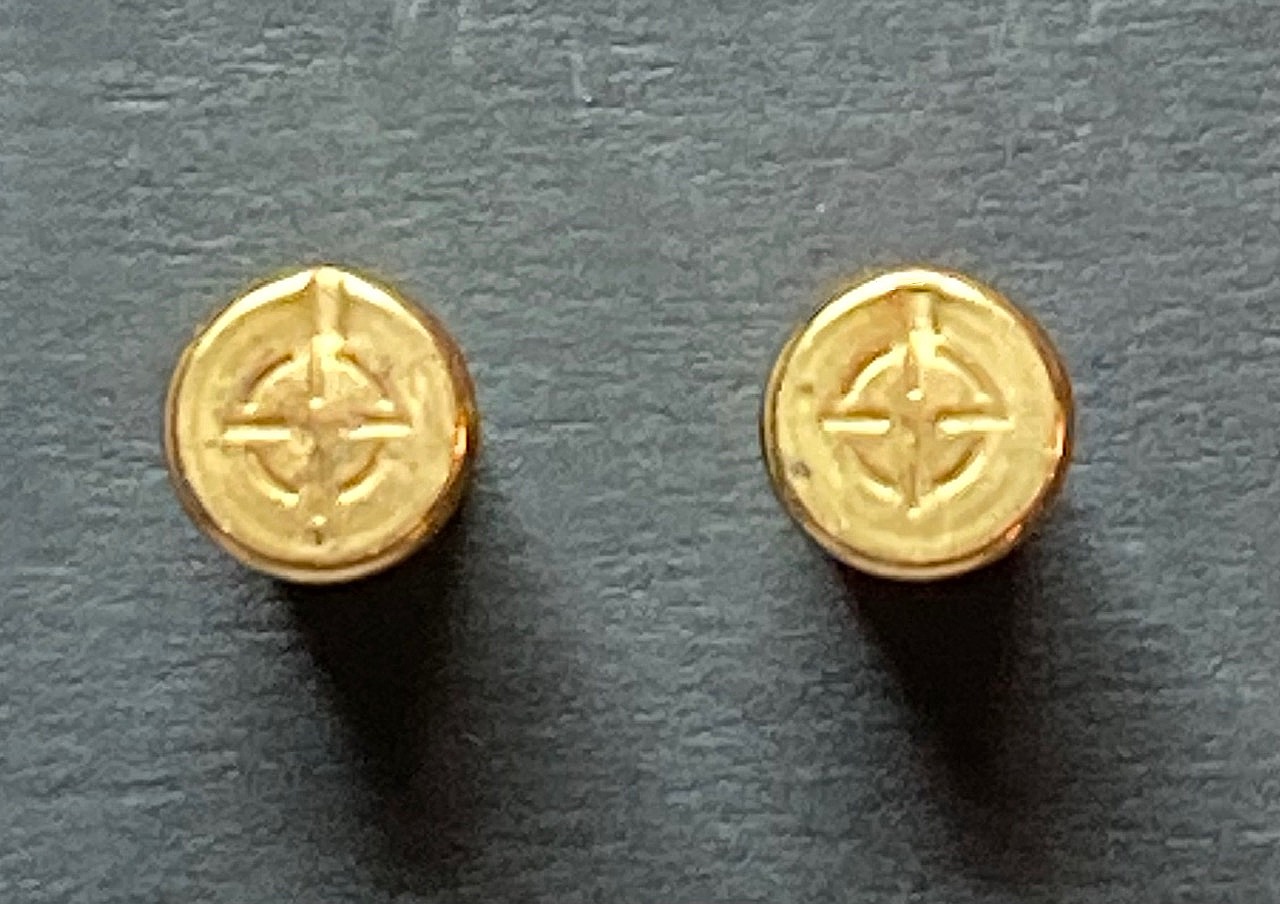

Here's the before-and-after of my own Vudoo firing pin strike pattern:

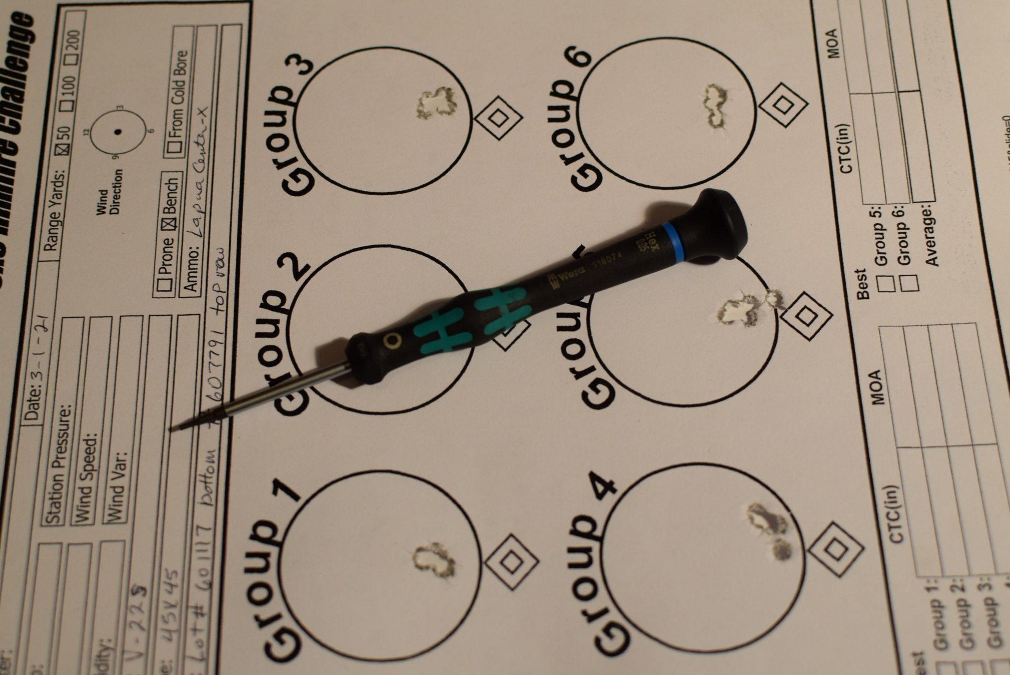

For whatever reason, the .050" allen wrenches in the sets I had wouldn't fit the little screws in my V22S bolts. I've had really good results buying Wera brand allen & torx wrenches from MSC, which is where I get most of the end mills & other machine tool parts & cutters I use in my lathes & mills. They're made in the Czech Republic, and are quality tools. When my order arrived, these drivers fit the screws in the V22S bolts perfectly, and I had no issues loosening & re-tightening them while experimenting to get the correct length.

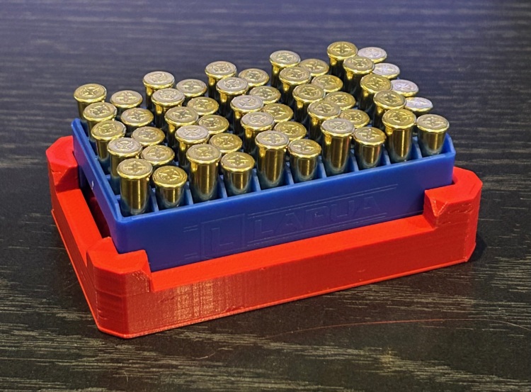

My old fingers have trouble getting the cartridges out of the Lapua or SK boxes one-by-one to load into magazines or to take out and put in a bench tray for single shot feed. Since the lube can be messy, I don't like to just dump them out, so I've made a simple fixture that you put the 50-round tray in right out of the box, and it raises the shells up -- with the rows in alternating heights -- to make them easy to grab without having to pry them up with my fingernails. Not a big deal, but takes care of a small annoyance. The staggered rows are tall enough so that you can use it for single-shot direct loading if you don't have another bench block you like to use. They're available in Classifieds with my other Vudoo items, HERE.
