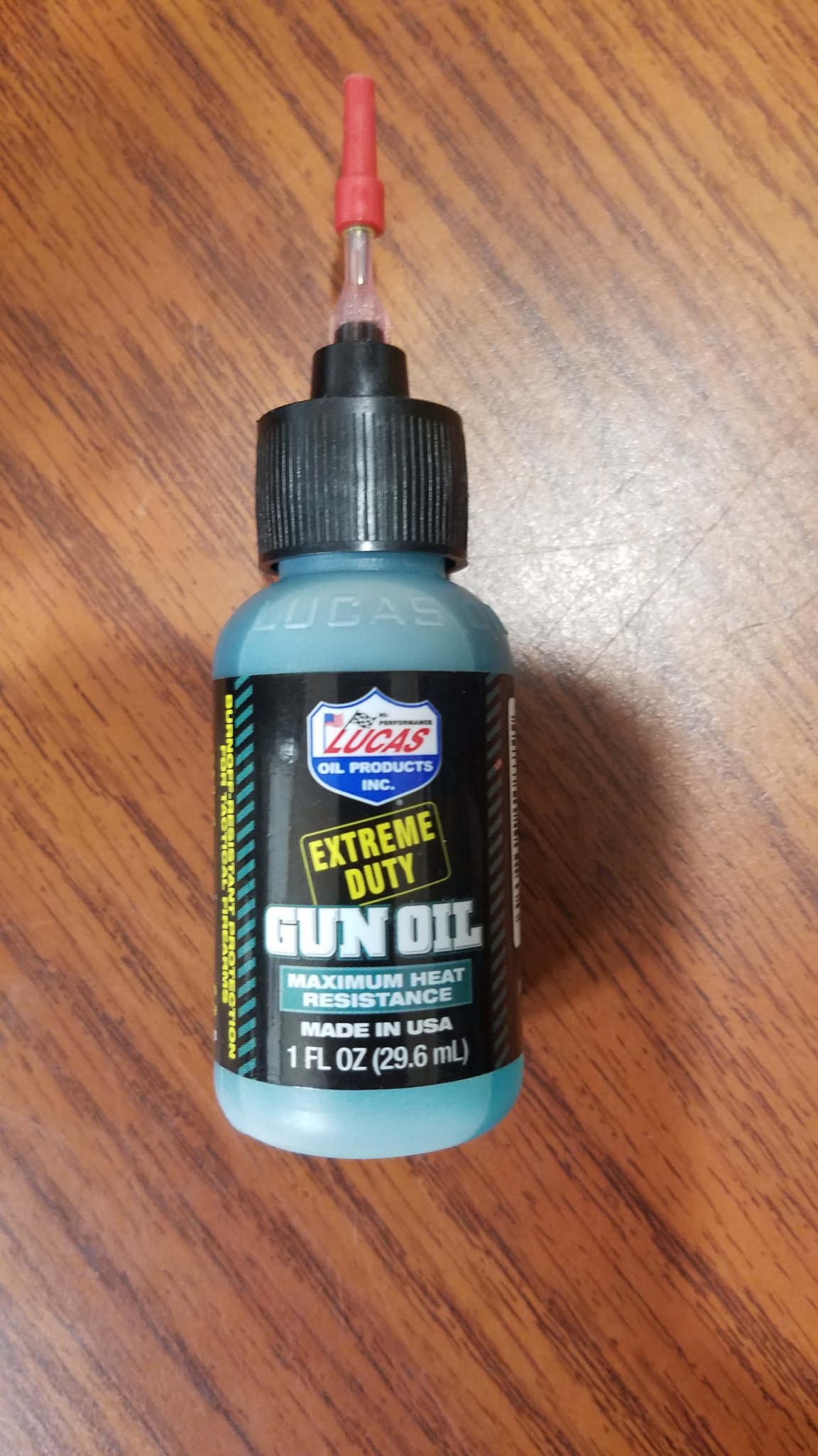

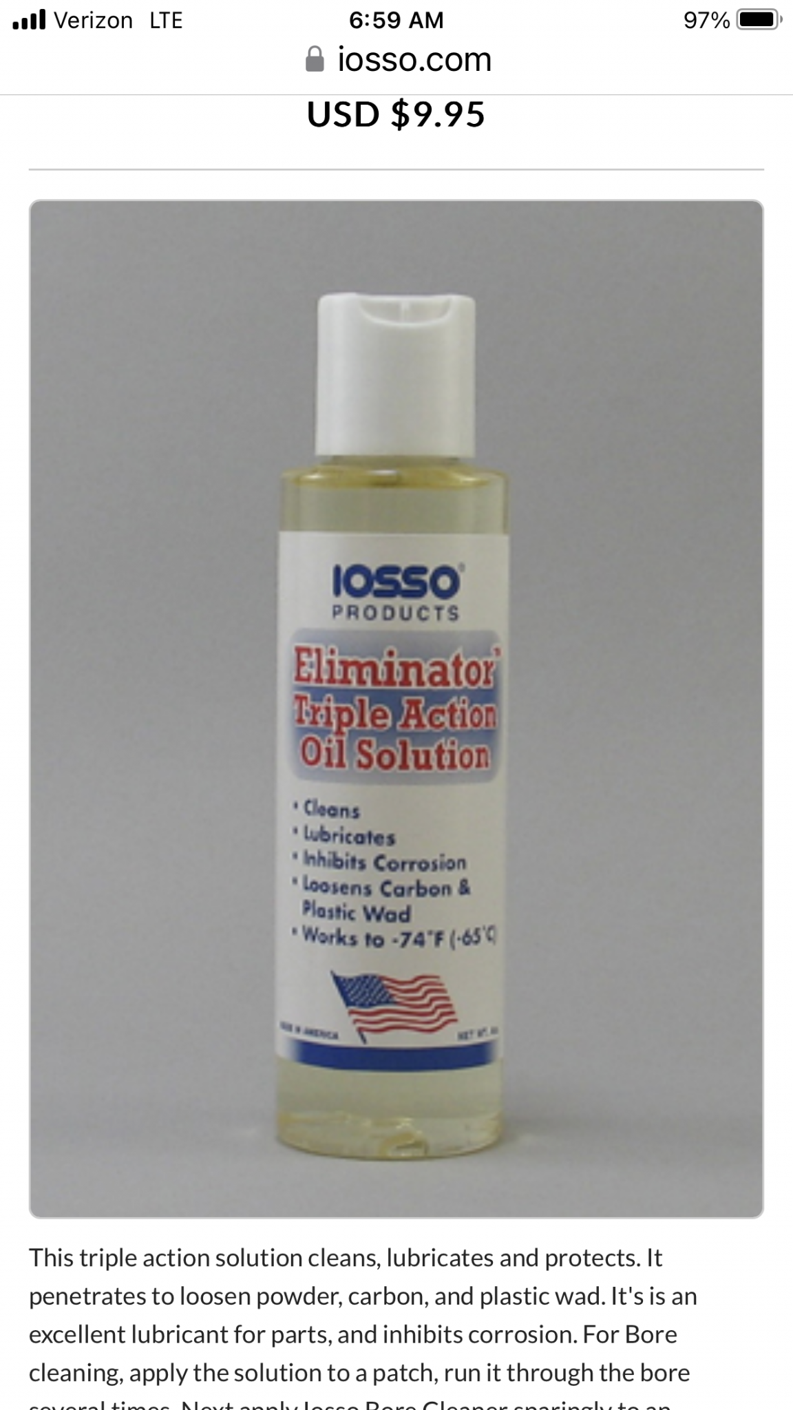

What are you guys lubing thr bolt with? I am getting little rust spots and dark gunk on the bolt body. It happens quickly. And it happens on all 4 if the v22s models I own. I have been using clp from mpro7. Thanks
I visited the factory last month while my gun was in for a tune-up and mentioned the same thing. They said that a little "0000" steel wool wouldn't hurt to remove those pesky rust dots. (I also have them on my V22-S bolt). I use "Militec" gun oil along with the steel wool to remove the spots. Works for me.
Hmm - makes me wonder about those reports of bolts rusting on the Vudoo single shots. I've never seen any sort of rust or spots on either of mine, but then the humidity out here is usually pretty low - though it's been raining here tonight for over an hour now... Will pull them both out tomorrow to look the bolts over.
I've notice a few small black dots on my V22-s bolt, figured it was small amounts of powder residue etc., and have used the scotchbrite pads to remove it w/o issue. I've noticed them more with Eley Black Box ammo than with CX.
I have 2 vudoo Single shots , and I’ve never seen any rust spots on my bolt . but then again, I clean my rifle after every shooting. Clean and wipe down bolt with Iosso triple action gun oil . I try to do this before it gets put away in my safe…Note this ! Directions on most gun liquids or aerosols will say to shake well before use!!! Lucas gun oil is too tacky for me .
My research showed Iosso is best , research it

Tacky is why I use Lucas Gun Oil....it doesn't take a lot.

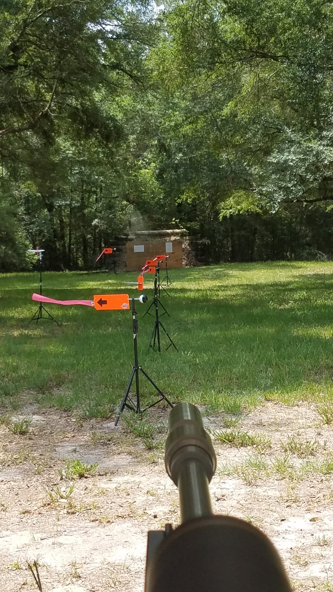

Graham Wind Flags are what I use.....they are awesome!!!! I have the Rimfire Ball Flags. The far flag to the left is a Graham Large Ball Flag.

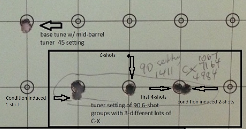

If your tuner setting can shoot multiple different lots or even brands of match ammo into the same group, it validates the tuner setting.
example my base setting for this rifle was 45 with a Scotts mid barrel tuner. I took it off and retuned and found 90 to be a better setting. 6 shots 2 shots from each lot of a different lot of CX. this was in 2016-17 and the tuner is still at 90 never been adjusted again. fast forward to 2022 my best ARA target with another different lot of CX tuner still at 90
