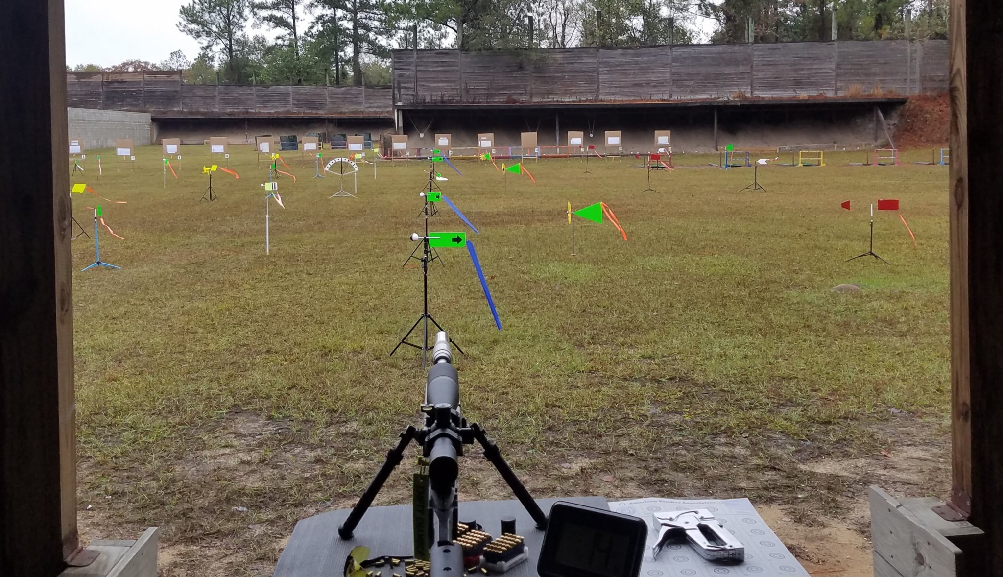

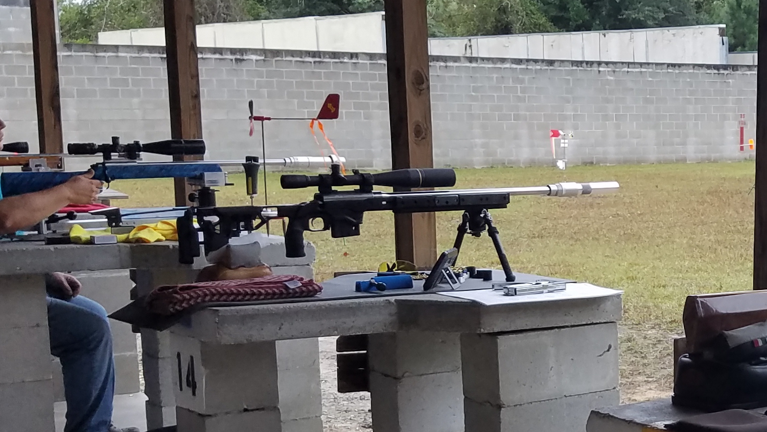

Graham Wind Flags are what I use.....they are awesome!!!! I have the Rimfire Ball Flags. The far flag to the left is a Graham Large Ball Flag.
Things that helped me........
A rifle that shoots consistent to begin with.
Good ammo
Harrell Tuner
Bob's Tube's 6 1/2" bloop tube
A good set of flags and practice a lot over them when the wind is blowing. If I had a dime for everytime I've been told it's a waste of time shooting in the crazy winds we practice in.........I'd be rich. ;)

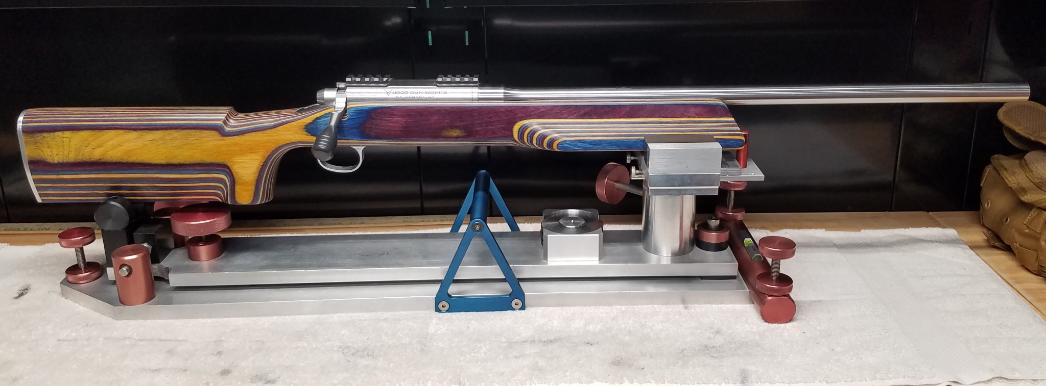

Decided to post about my Vudoo. 200yds with 2 different lots of R50, with limb saver that I use on all rifles. 22" Benchmark barrel, Kestros stock with cheek rest removed.

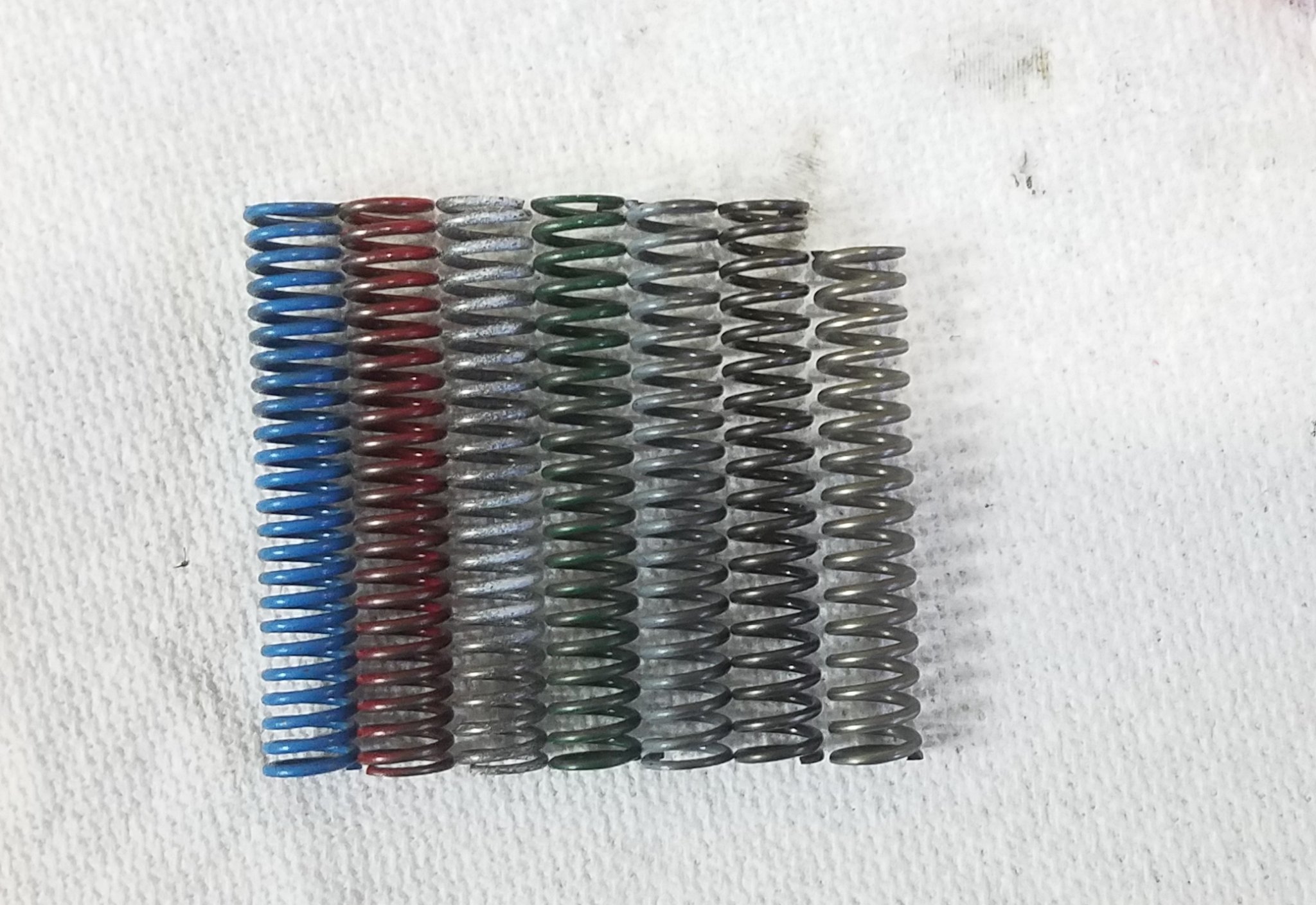

I was lucky enough to come into possession of a spring kit from Vudoo. So now I have a Blue 13lb, Red14lb, White 15lb, Green 16lb, Grey 17lb, 18lb. and 22lb. firing pin spring
Here are the measurements from this set of springs. Measured with calipers. All springs new except 18lb. as noted.
Weight- OAL- ID- OD- wire diameter
Blue 13lb.- 2.414"- .288"- .391"- .053"
Red 14lb.- 2.414"- .288"- .392"- .053"
White 15lb.- 2.414"- .290"- .393"- .053"
Green 16lb.- 2.414"- .290"- .393"- .054
Grey 17lb.- 2.414"- .289"- .393"- .053"
Used 18lb.- 2.400"- .289"- .392"- .052".......came in rifle, been used for 4 months and about 5000 rds.
22lb.- 2.217"- .295"- .408"- .060"
Hope this helps.

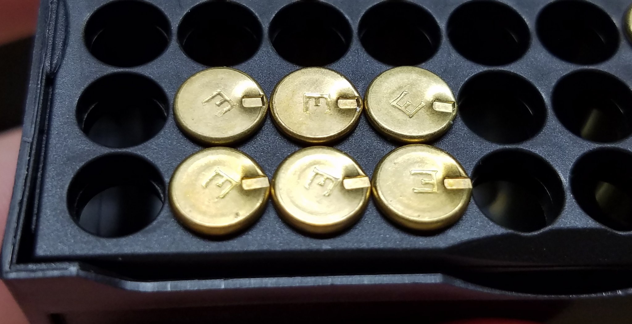

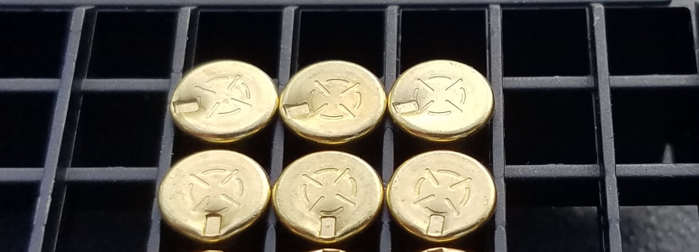

This pic shows my firing pin strike before and after re-profile with 18lb spring it came with from Vudoo.
Top row.............re-profiled firing pin with 18lb spring
Bottom row.....Factory firing pin profile with 18lb spring
This is after I reprofiled the firing pin and shows strikes with 3 different springs.
Left row 18lb spring....center row white 15lb. spring.........right row blue 13lb spring

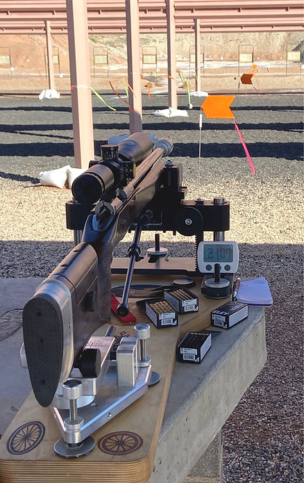

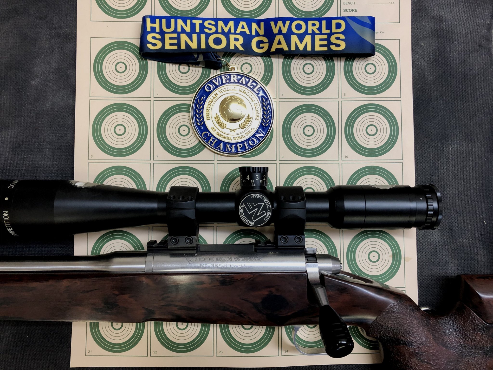

I just returned from shooting rimfire benchrest in the Huntsman World Senior Games held near St. George, Utah. This competition comprises of three days of shooting the IBS target at 50 yds. One piece rests were not allowed. Each day, four targets were shot for at total of 100 rounds. The three day total is 300 rounds for a possible score of 3,000. There were 58 competitors, from all the surrounding states, Colorado, Calif. Hawaii and various others. There were three relays, 9:00, 11:30 and 2:00. Each relay rotated to the next time the following day. I know of four Vudoo rifles in this match, maybe more. The 3rd O/A rifle shot was also a Vudoo.
My score was 3,000-238X. I shot in the unlimited class, where the maximum rifle weight of 13.5 lbs. Wind conditions were close to ideal, a slight variable breeze most of the time, with occasional periods of dead calm. The first day, there were 13 scores of 1,000. The second day, there were 7 scores totaling 2,000, and the third day this was reduced to three scores totaling 3,000 and the winner was decided by X count. My average X count for the 12 targets shot is 19.8 shooting Eley Match ammo. I shoot free-recoil, only touching the trigger.

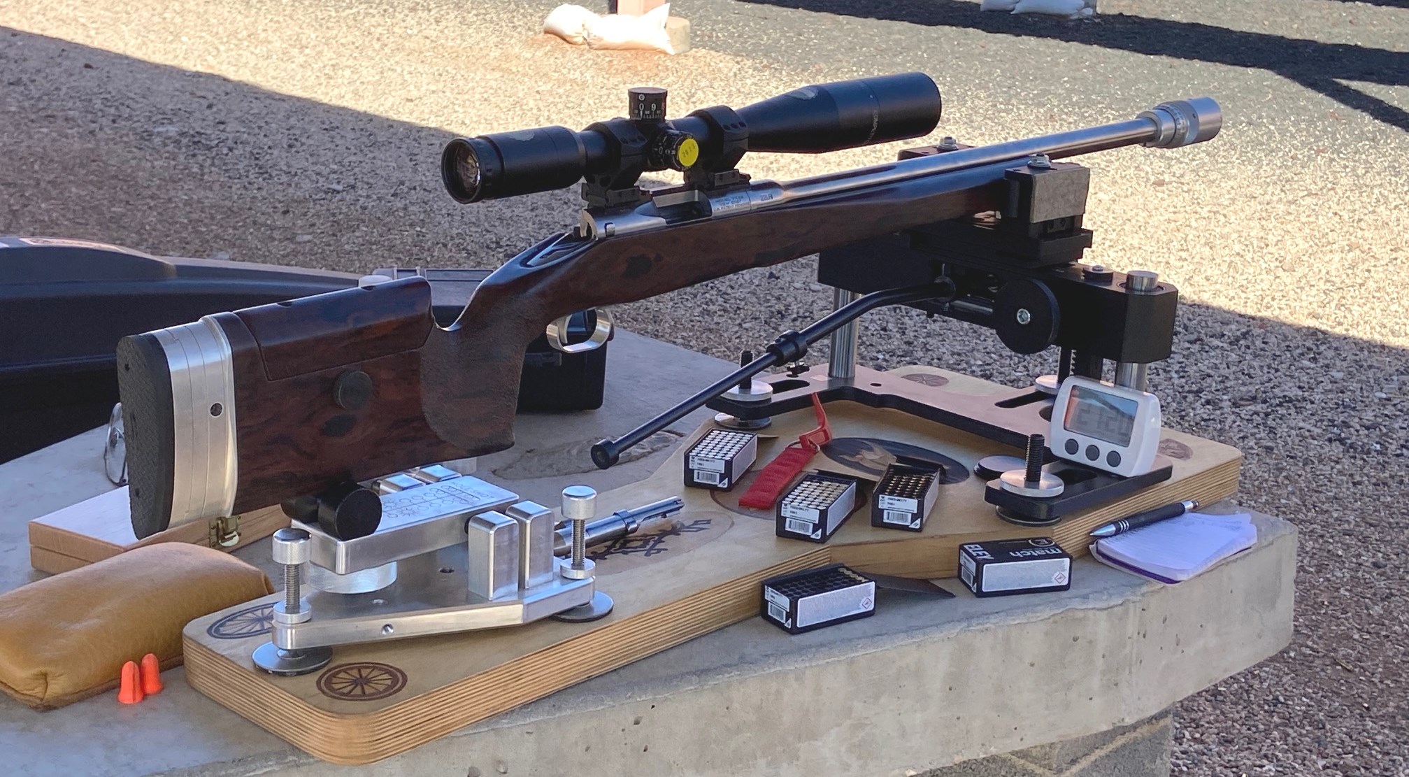

Here is my set-up:
And here is the view down range showing my home made wind flags.
My front rest is a Rodzilla T-Rex and the rear rest is a Holeshot. It was a fun match and I heartily recommend it to all.

Great shooting Steve! I see you are using a mechanical rear rest. glad to see they allow them, back in 2021 my good friend shot that match and they tried to rule that rear as illegal fortunately as my friend pointed out there was no rule in the book on it. that year also cut out a day's relay because of flooding from rains. well, you know as you were there.
I was planning on shooting it this year as I am in N. Las Vegas, but the scheduling conflicted with the AZ ARA State match. maybe next year
is the Eley you were shooting current production?
Lee

How do you like the scope rings you're using?

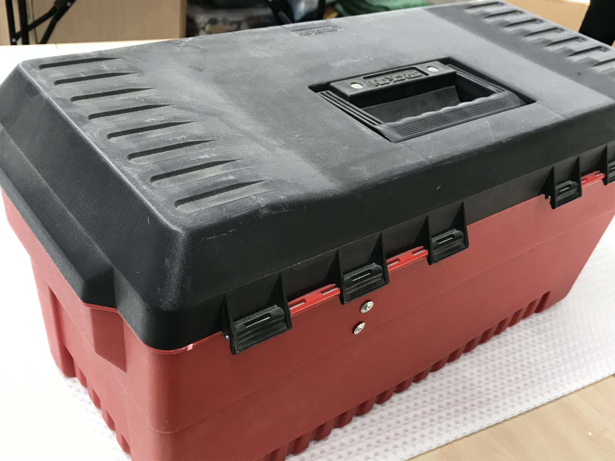

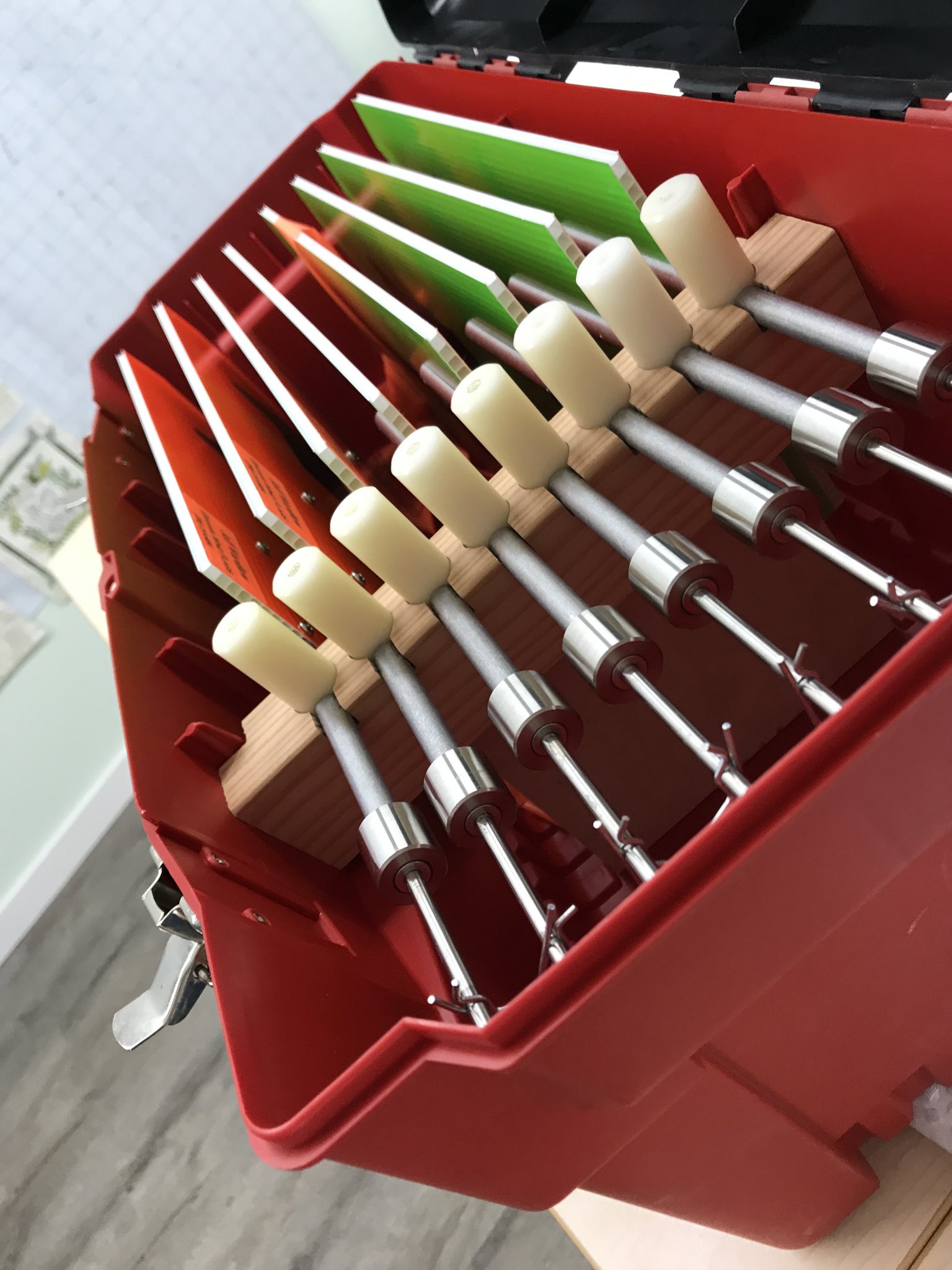

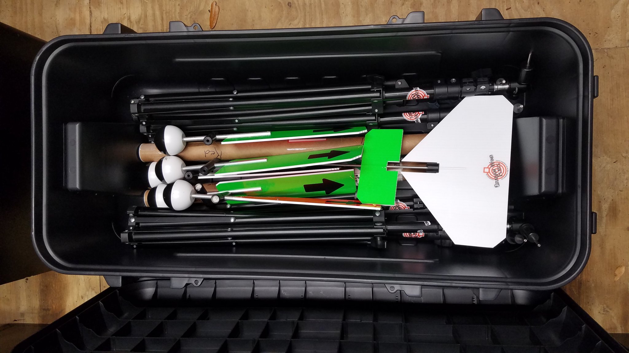

Bowchamp what do you use to haul your Graham’s to the range? I’m having trouble finding a decent tote to use.
