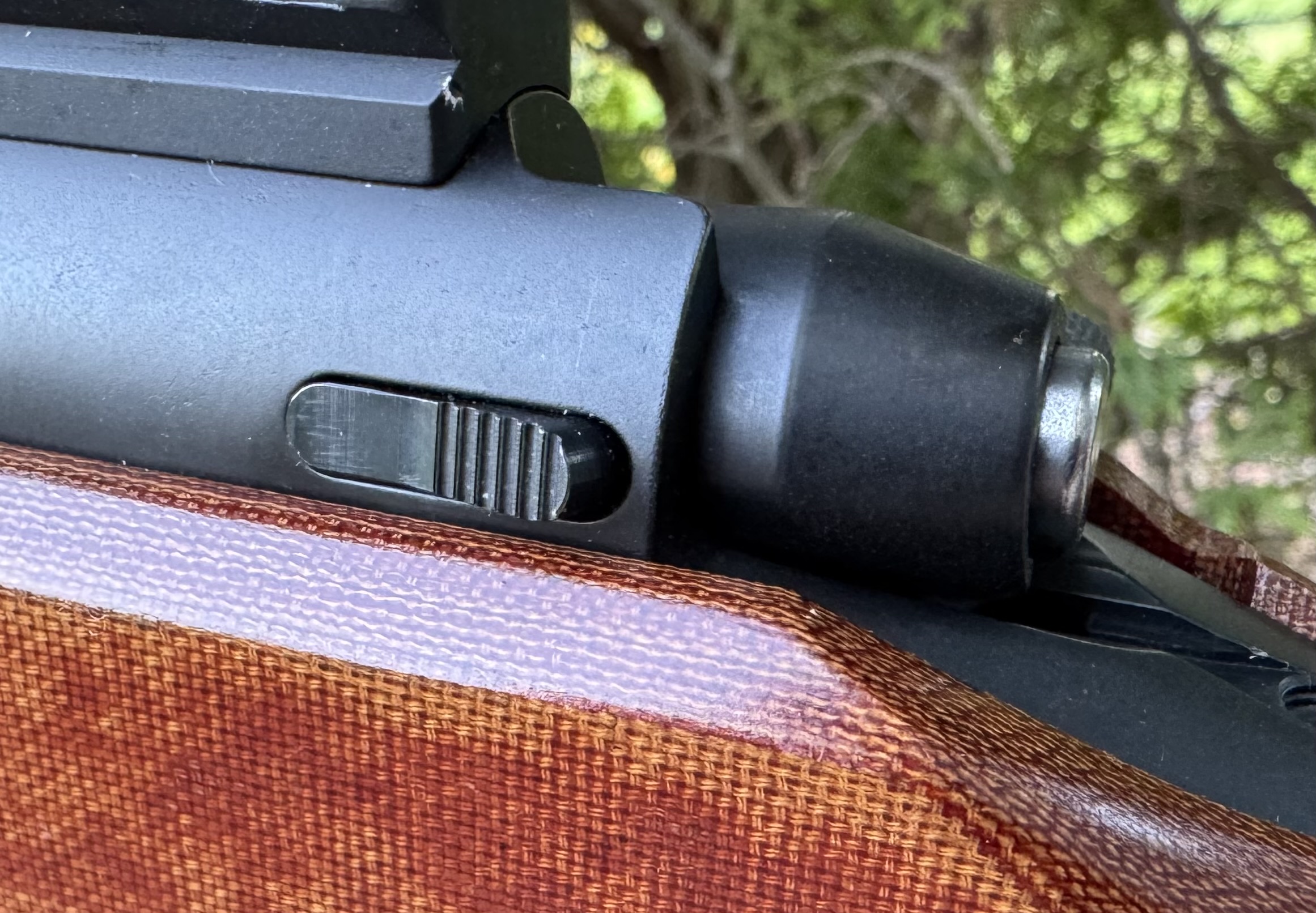

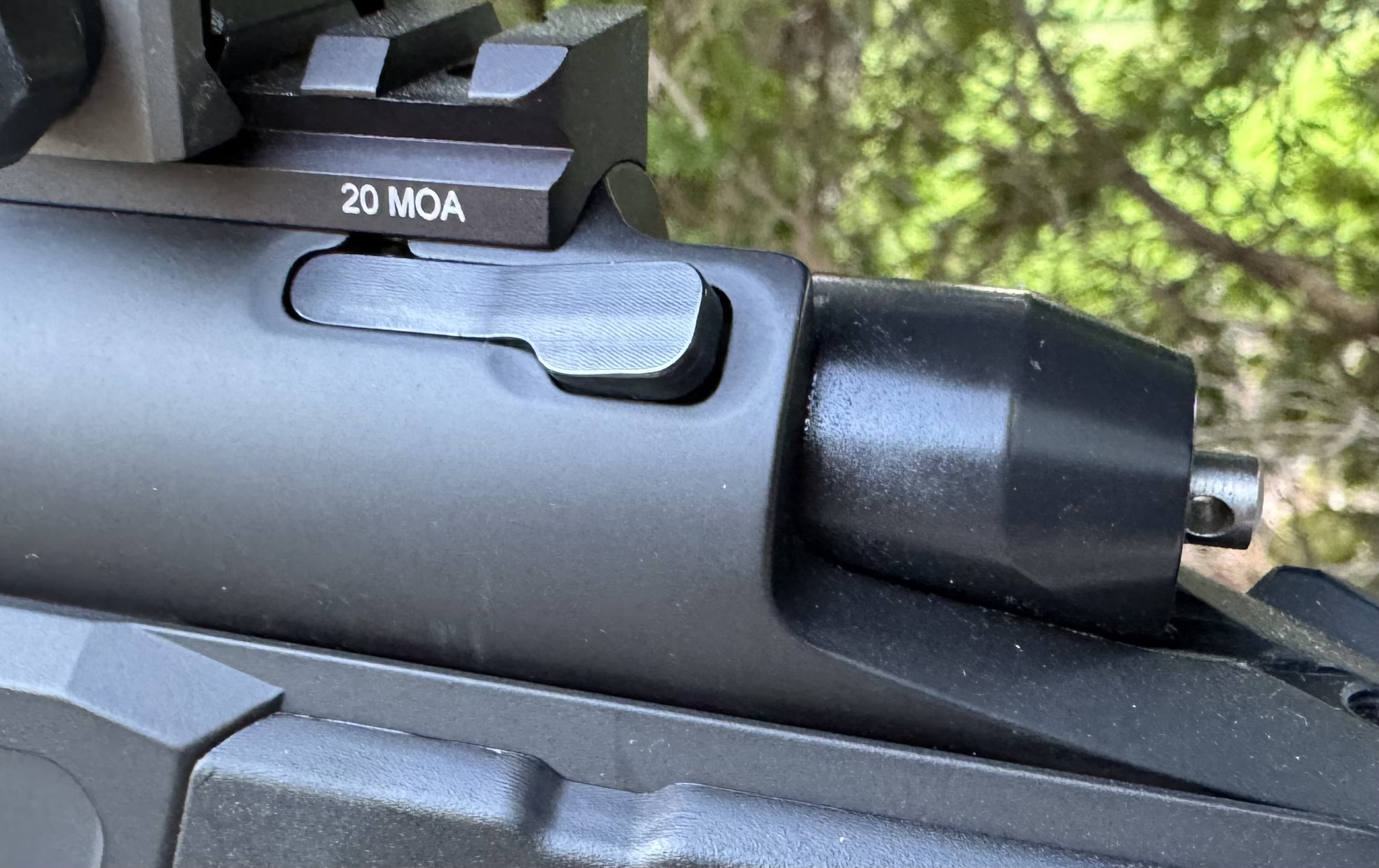

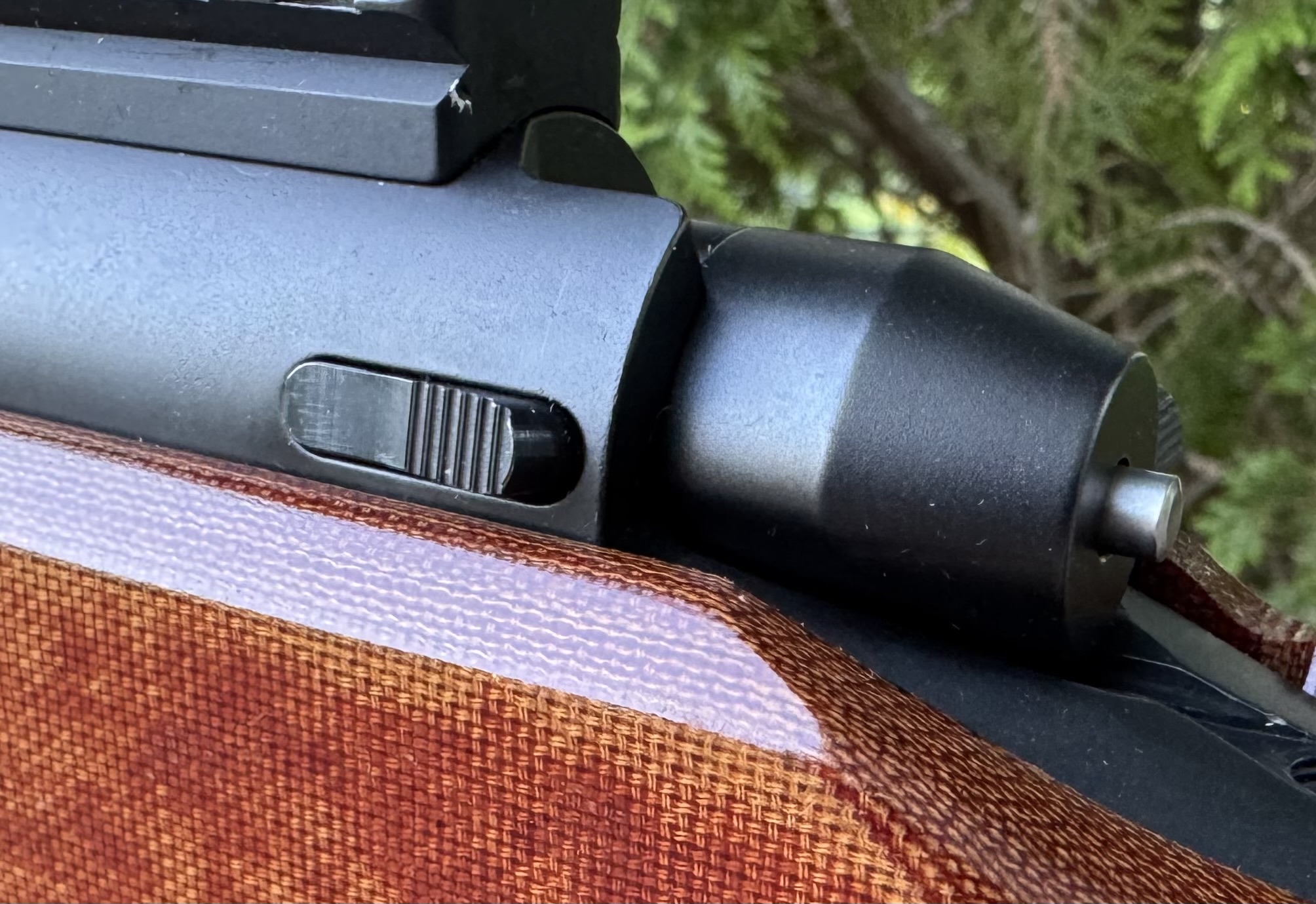

For those of you that do not know what generation you have, please see the pictures below. The easiest way to tell is by the bolt release, and for the Gen 1 and Gen 1.2, the cocking piece and bolt shroud are different.
Once I have the info, I'll organize a few details and keep moving forward. Also, when appropriate, I'll be accepting payments using the CASH App, which keeps me off the phone and provides some small level of "automation" for the process.
Gen 1
Gen 1.2
Gen 2, 22LR and Magnums
Gen 3, Three60 and V22S Single Shot

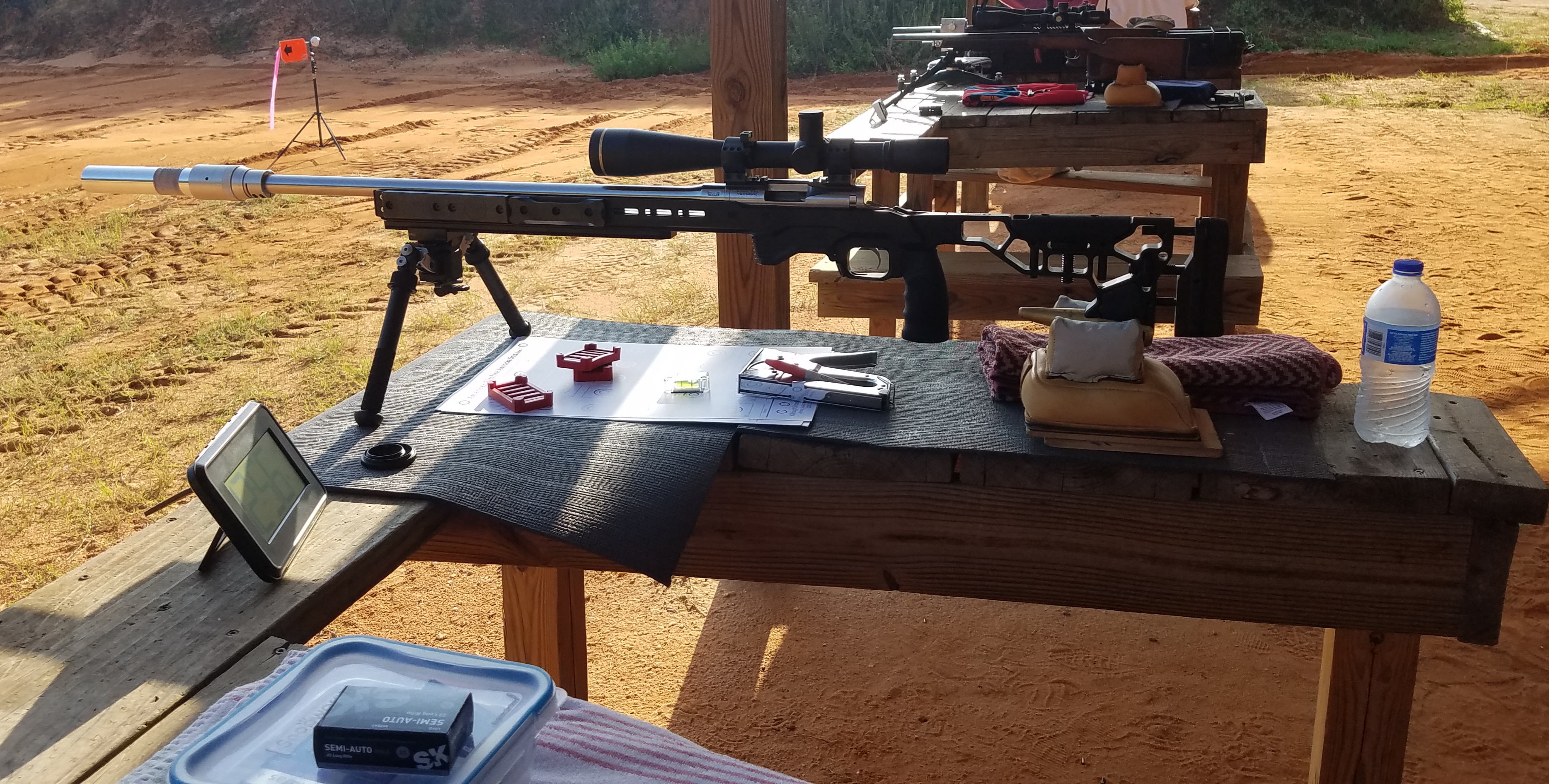

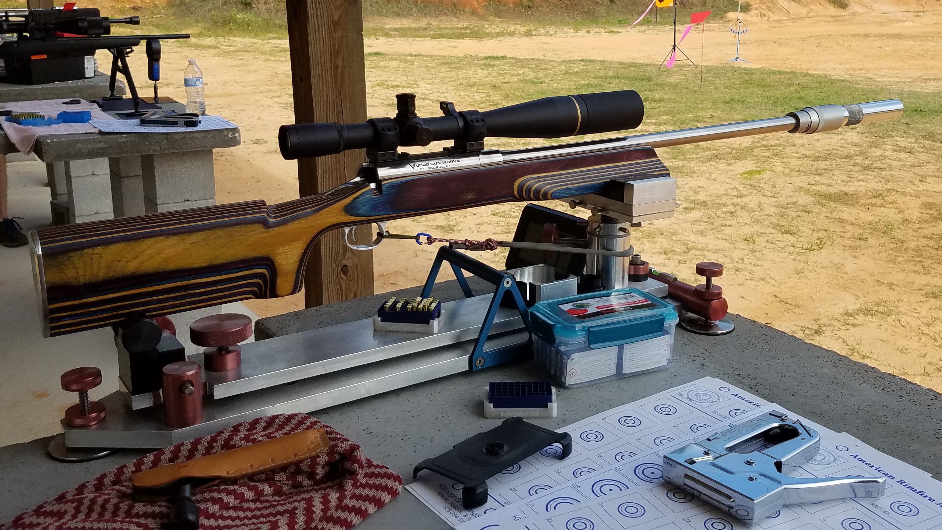

If I might be so bold to chum the water a bit I'd like to challenge the folks interested in the V22S to offer details of
1. How they'd configure their single shot actions ... barrels, triggers, stocks and scopes,
2. How/where they'd shoot or compete with a full V22S build,
3. How they'd address the ancillary equipment, i.e., rests in particular (one piece or two piece) and finally,
4. How they might deal with what I refer to as "the ammo chase" ... a highly accurate rifle often requires lot testing to get the best results.
I've put some thought into my dream build and I'll share if my challenge catches on ...h7

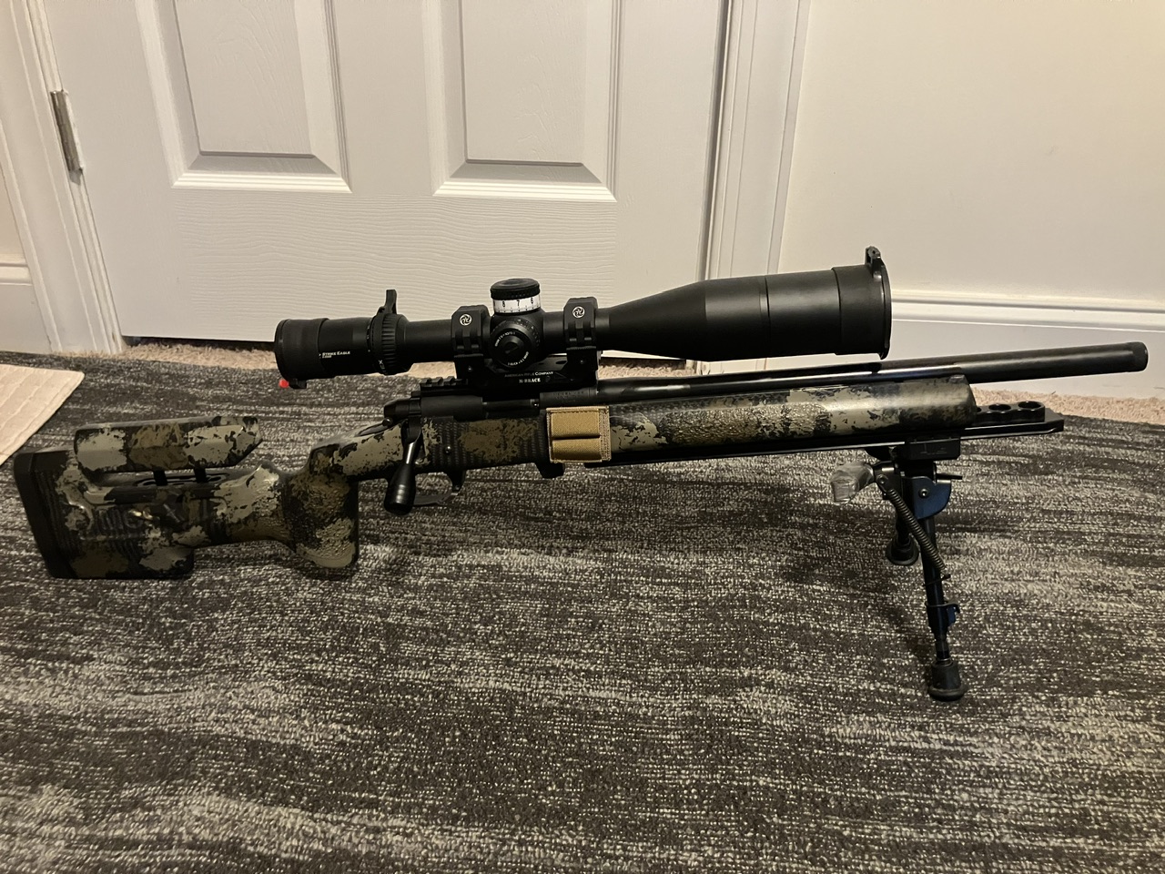

Okay here goes:
Muller barrel 8 grooves Ross taper
Flavio Fare trigger @ .7 oz
Randy Owens stock low and coffee color
Sightron SVSS 10-50x60 EDdot
John Langley builder
Eley tenex ammo
Harrell Tuner
Won a couple of times at Pioneer range, IBS Hunter at 100yards tough group to shoot against.
Shot two 50 point bulls last match, won with a 478 score two targets match. My 8x count won tied score.
Man I really love shooting this v22s Vudoo! Will repeatedly shoot .341 out to out groups @ 50yds.
Randolph front rest w/one-piece adapter w/Mark 2 top
w/Lenzi rear bag.
Stephen T
Reactions: StephenT and JimTN

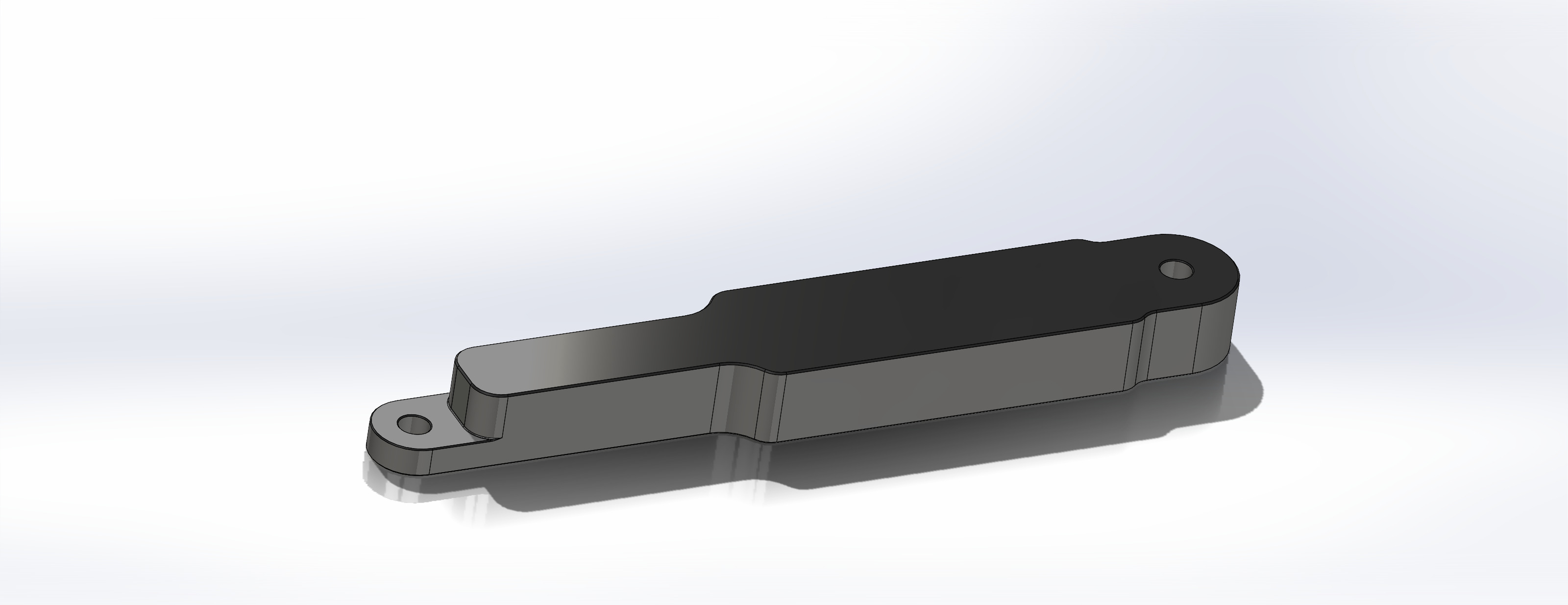

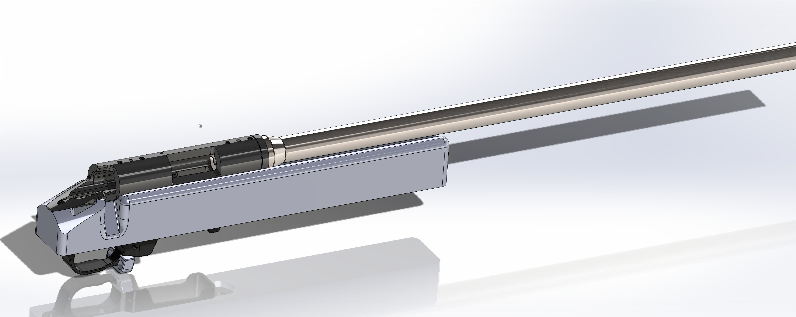

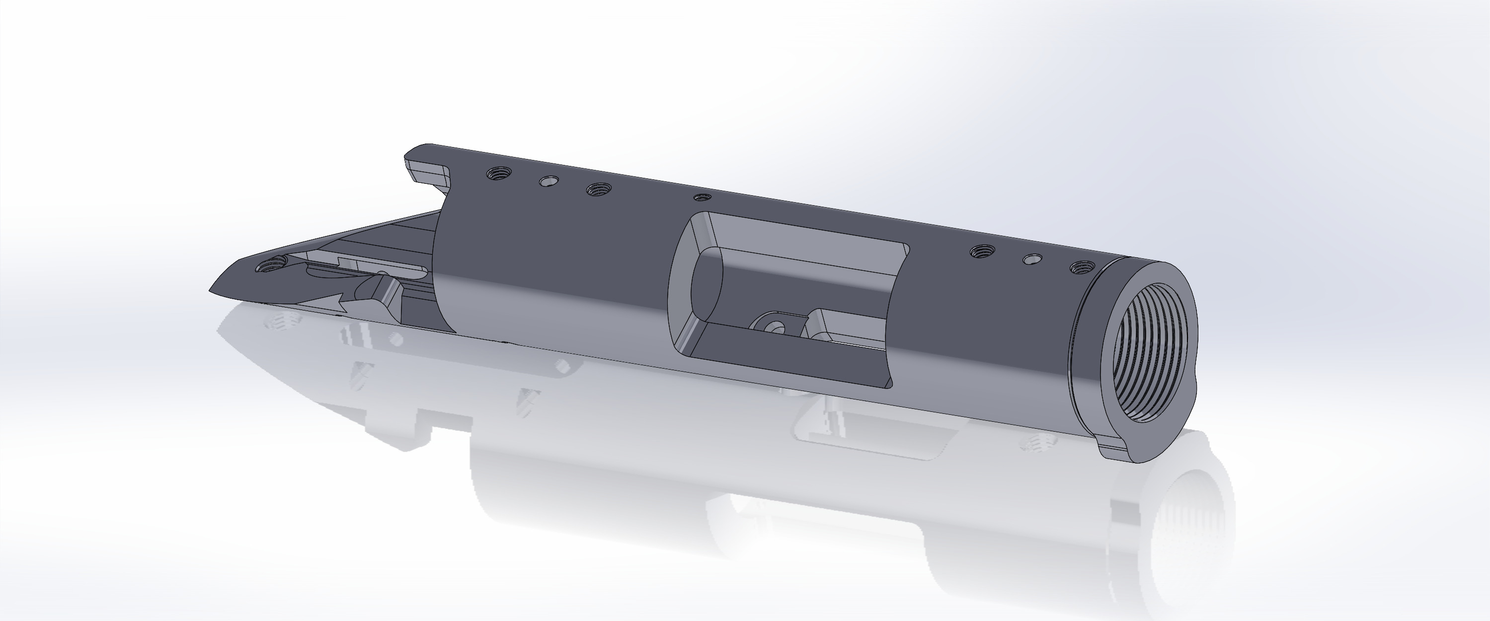

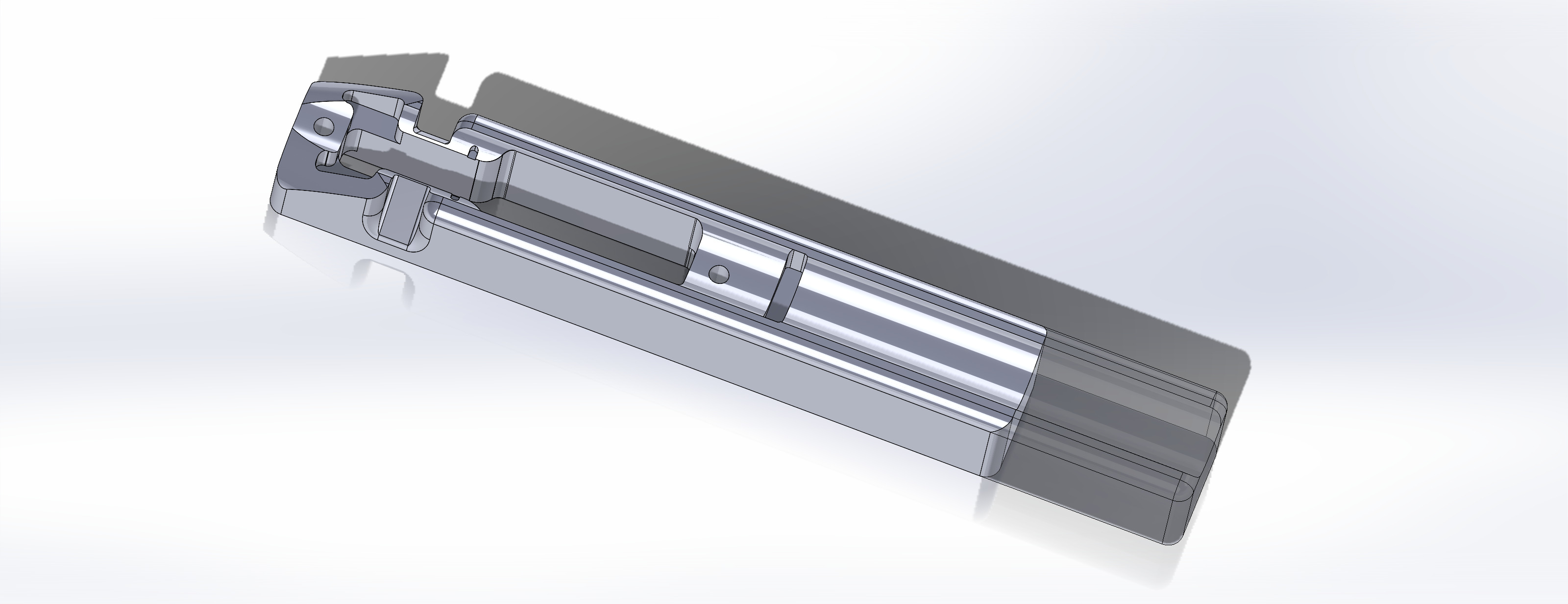

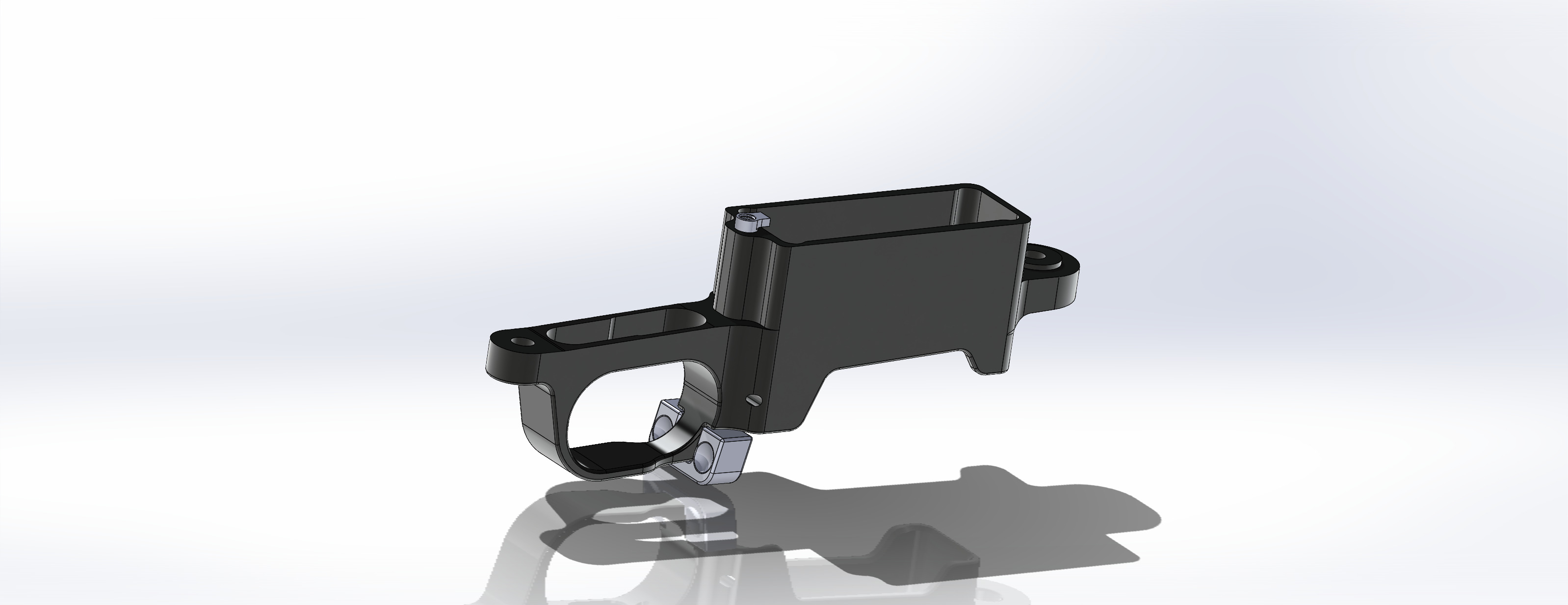

Ok, thanks to the responses from my weekend mass email, I have a solid handle on per generation inventory levels. Not surprisingly, the greater number of actions out there is the Gen 3, Three60 Repeater. So that's where I'm building inventory first.
I'm now going part by part in the SolidWorks Assembly Models to validate all eight configurations of the Gen 3 (four for the repeater, four for single shot). As I validate a part, it gets placed into manufacturing engineering and validation and then production. This might sound like a lengthy process, but not really.
The thought struck me as I've been reviewing files, I could start making these things today if I took a notion to do so.
There's enough interest in the Lot Test Fixture (LTF)) that I'll move it into production, but I also received questions/feedback about the overall length.
A number of you would like to see a bit more material forward of the recoil lug pocket to provide more surface for the vise to hold onto. So, the overall length is now 15" instead of 12". A Bushing Plate will be included with the LTF; it's used in place of a DBM for the Gen 3 Single Shot and while doing maintenance and/or cleaning. Those wanting to feed from a magazine can add the DBM. I don't have pricing just yet.
Additionally, all parts have moved into production, as well as the Receiver Wrench for two lug and three lug receivers. I'll announce when I'm ready to accept orders.
Thanks to those that reached out with questions/feedback.

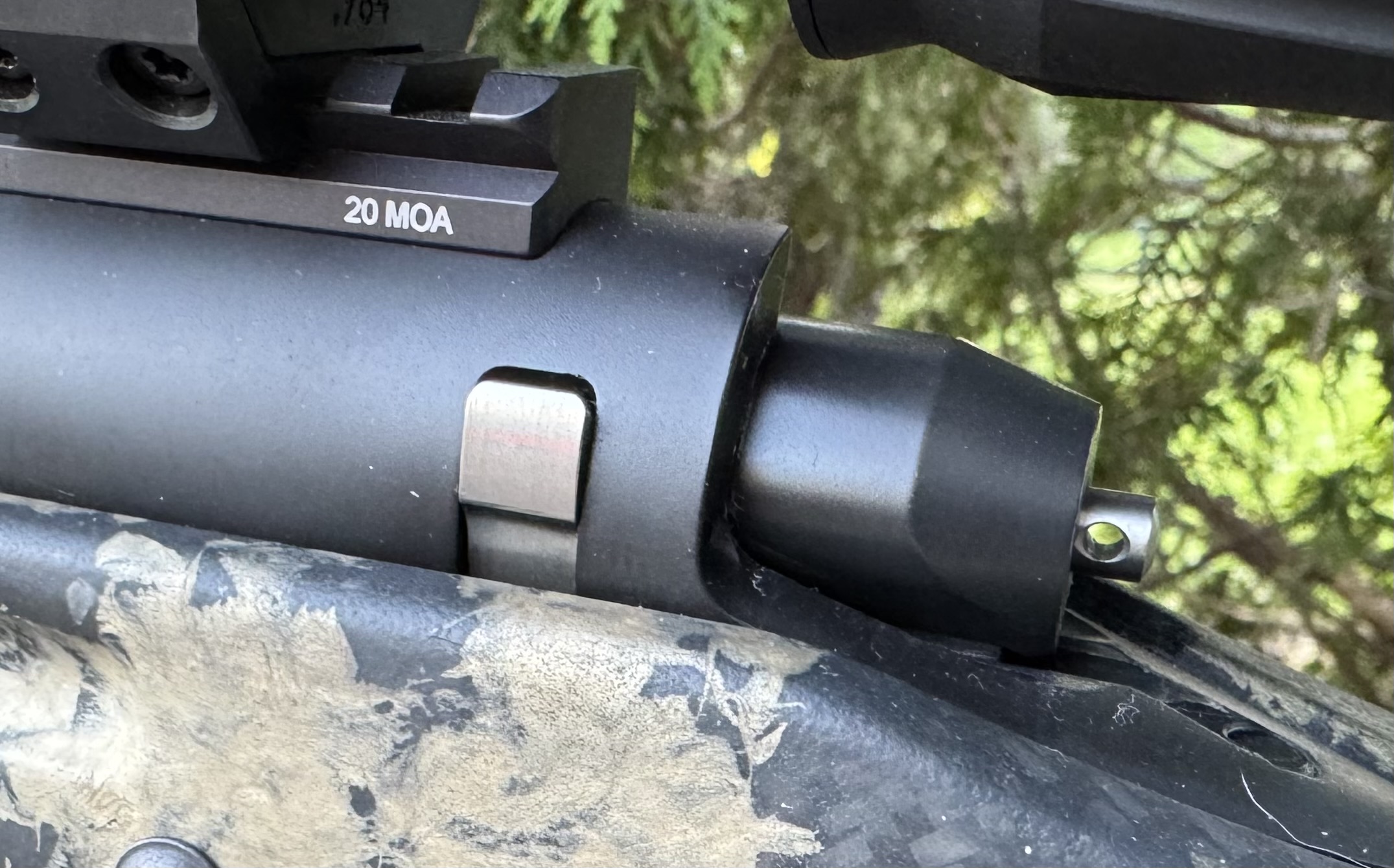

Gen 1 and the early Gen 2 were two piece receivers and there are two issued patents for my design. This is how I was able to eliminate the lug ways propagating the full length of the receiver bore, like the 40X Rimfire. Shortly into Gen 2 production, the receiver became one-piece.
The bolt handle is friction welded to the bolt body. There's a machine that spins a blank (that becomes the bolt body) at 4400 RPM while the handle blank is held stationary. As the bolt body blank spins, it is moved toward the handle blank until the point of contact. The friction creates heat and welding of the material occurs. What stops the spinning is the adhesion of the two parts.
This goes back to the early production of Phoenix Machine and Defiance Machine bolt blanks prior to the falling out between Glen Harrison and Ken Frankel, resulting in Defiance Machine bringing all their production in-house.
MB

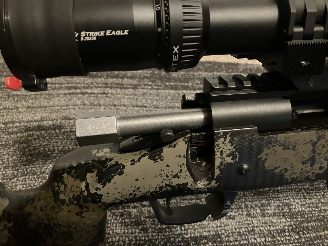

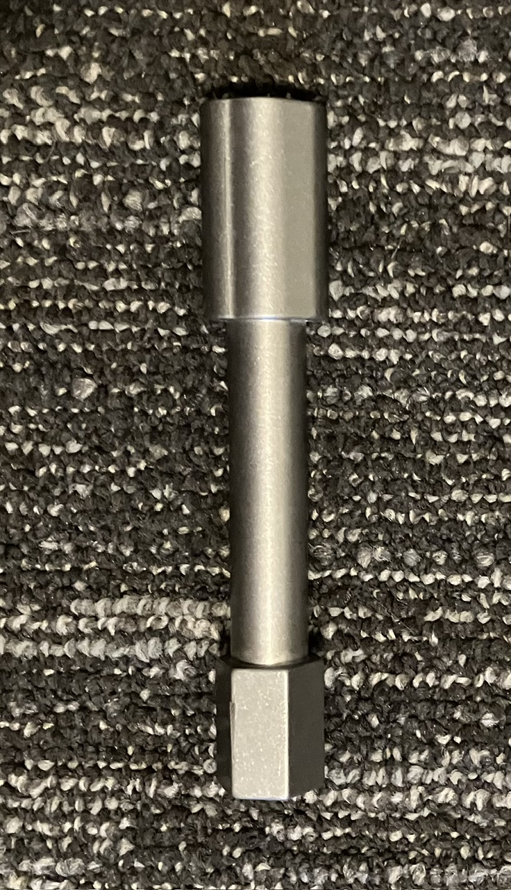

Got my Gen 1 action wrench in the mail today. Thanks Mike!
Fit perfect in my action. Below is a pic of how far it fits in the action for reference. Popped off my 23” 1.2” contour and popped on my original 18” Kukri and everything lined up perfectly. If it wasn’t pouring rain I would send some rounds through it but that will have to wait. If you are thinking of getting an action wrench or any of the kits don’t hesitate!

Second match 10-20-24 IBS Hunter @ 100 yds I shot 2 cards 478 with 8x's 1st place, 2nd place also 478 but 2x's. 50 degrees wind 3-4 mph from every direction, Man this Langley v22s vudoo will really shoot when I do my part.
Okay here goes:
Eley tenex ammo
Harrell Tuner
w/Lenzi rear bag.
Stephen T
This is how it shoots. The #1 target, I was told, was the highest scored at Pioneer “Gun Club EVER” shot with 2 pc rest 6/15/25
Thank You again Mike.

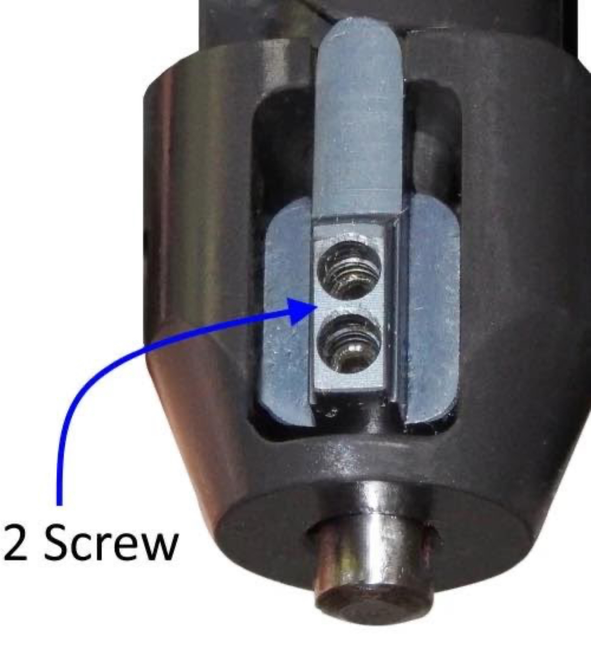

Quick Update:
Receiver Wrenches:
For those that have been waiting for the Gen 3 RH Receiver Wrenches; first, thank you for being patient, it truly means a lot. The Gen 3 RH Receiver Wrenches, PLUS Gen 3 LH, Gen 1 RH and LH and Gen 2 RH and LH, are headed to me right now. I'll post pics when they arrive and anything not already sold will be in stock.
Gen 2/Gen 3 Cocking Pieces, Single Screw:
They're in the same shipment with the Receiver Wrenches. I've received lots of outreach from folks that have been experiencing the loosening of the screws in the two-screw cocking piece. For those that missed the post about this, the loosening is caused by a crack that forms between the two screw holes due to a thin wall condition. This issue can affect some later Gen 2 and many Gen 3 actions, including builds from Masterpiece Arms. I'll have a large inventory of Single Screw Cocking Pieces within another few days. Two-screw, bad. Single-screw, good.

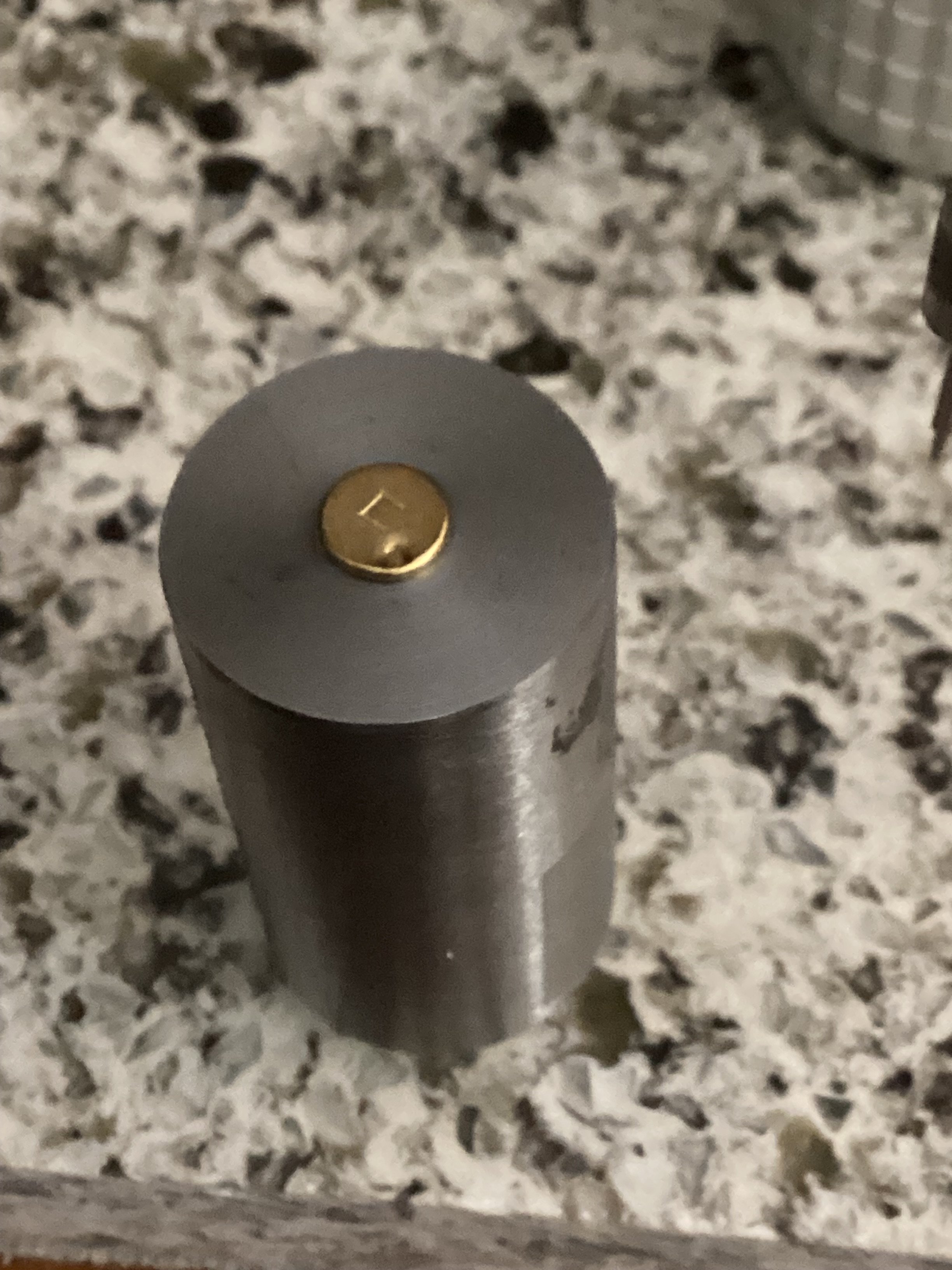

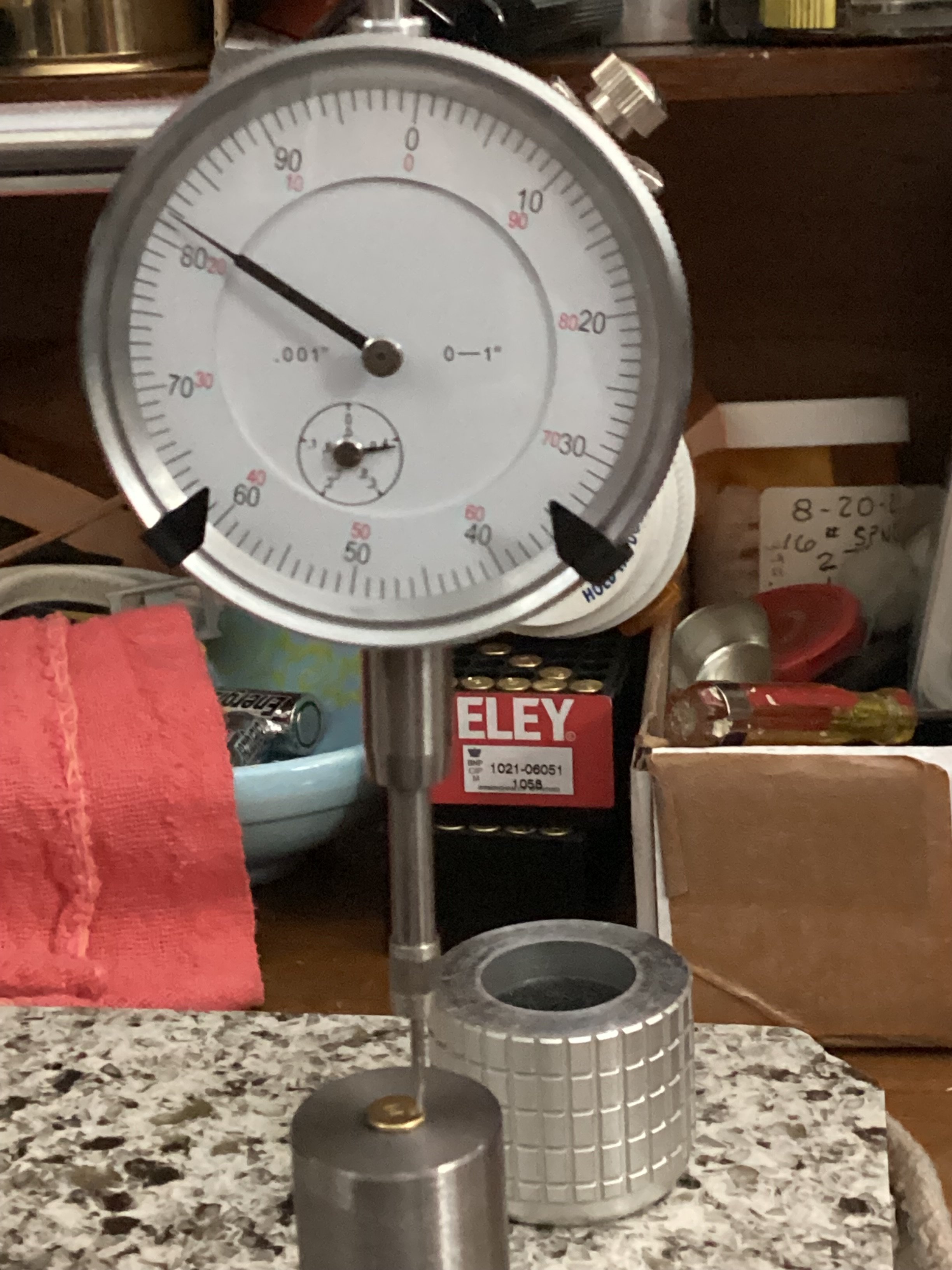

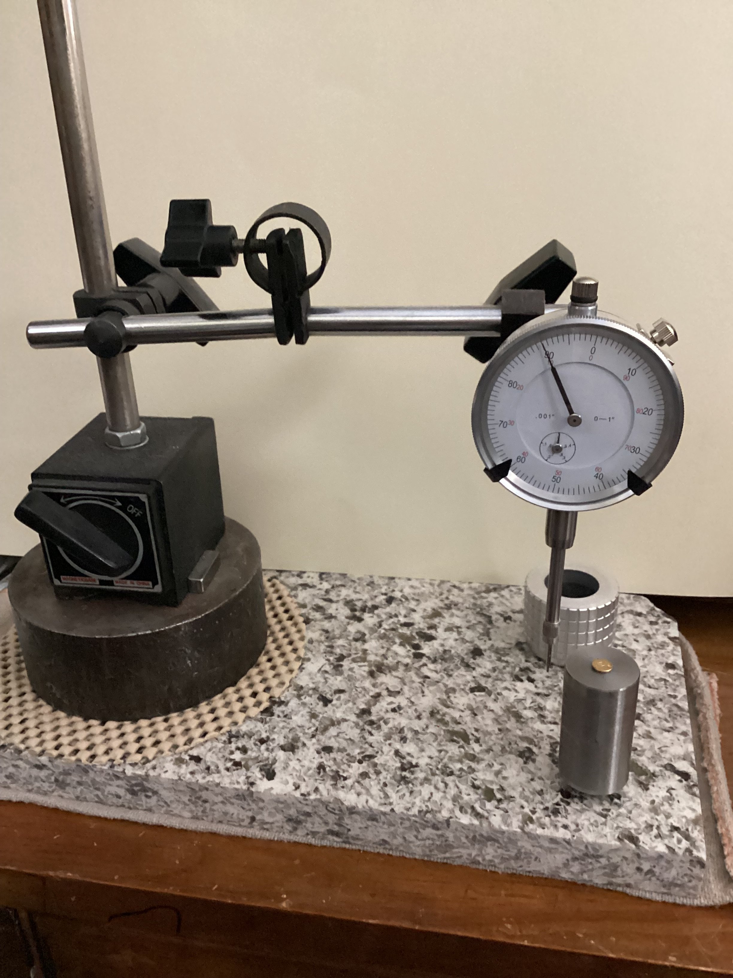

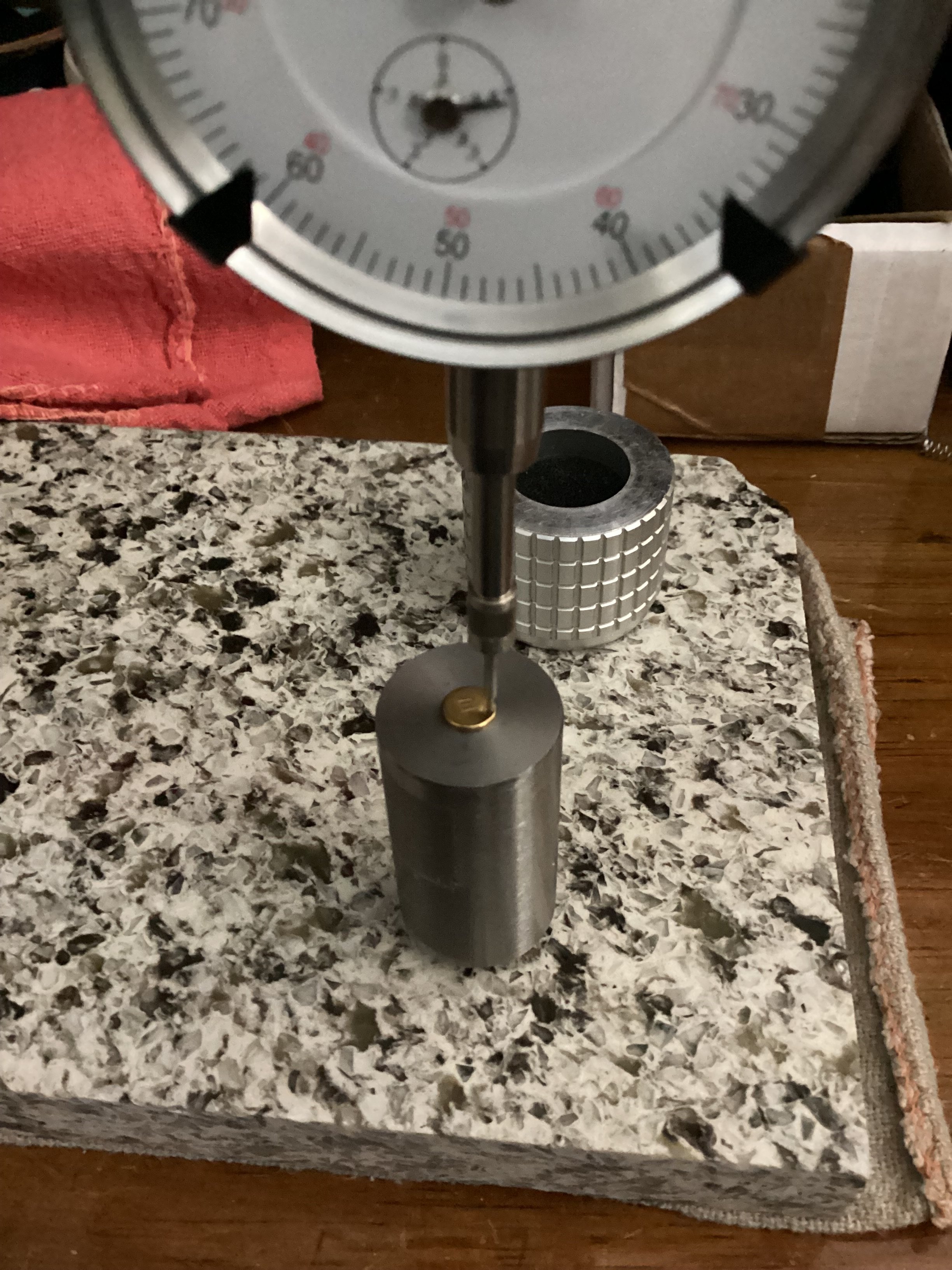

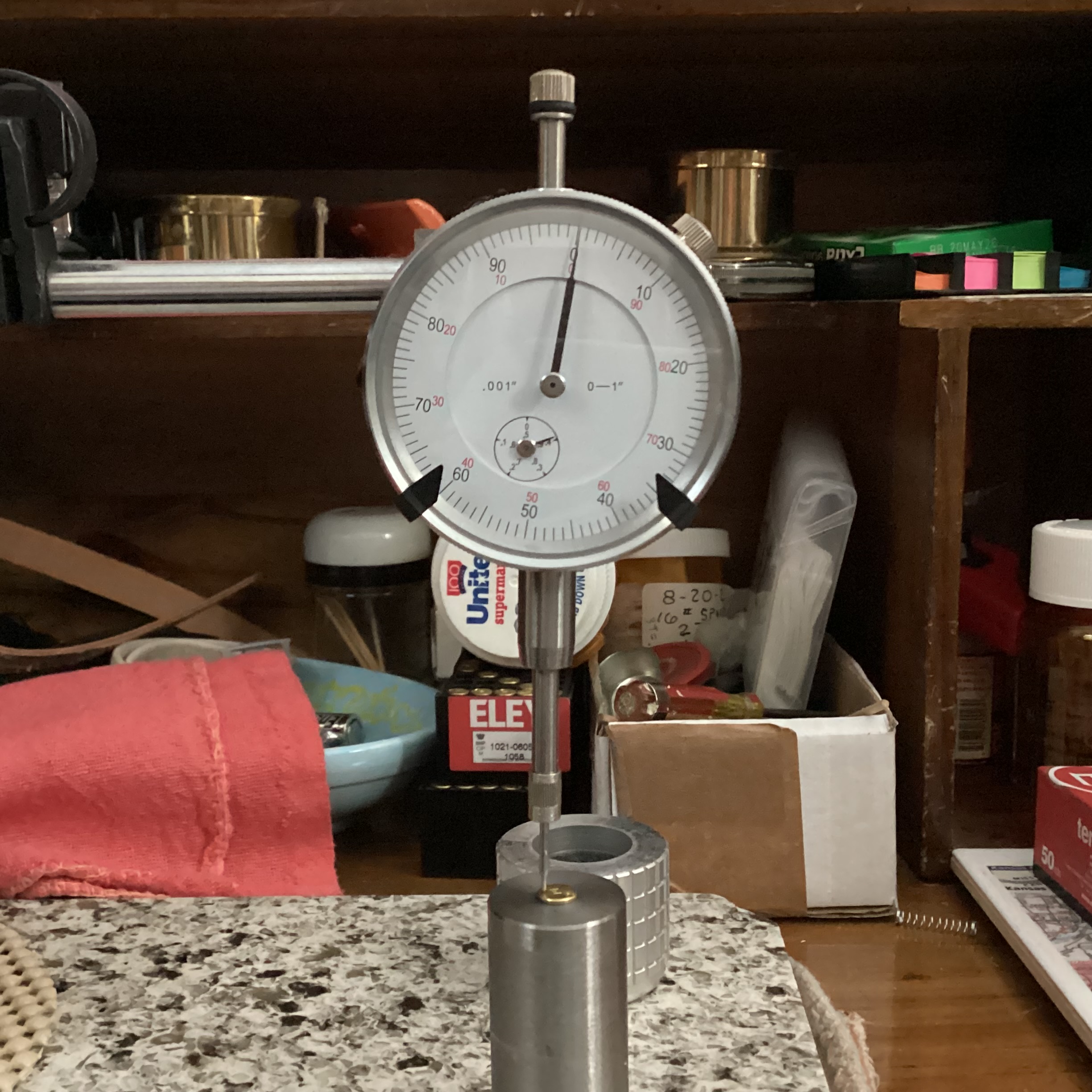

Have Question about firing pin, chisel point, my latest attempt to adjust hit depth is a failure.
Changed 16# 1 turn pin spring hit .017.6 avg to 15# 1 turn pin hit .019.5 avg depth hit. NO FAILS TO FIRE.
HOW do I adjust pin for/to hit depth to .013 to .015 ?
Reactions: RAVAGE88
Thank You for the tip.
Hey, Stephen, the first thing I’ll ask is, what are your goals? Also, the minimum depth of strike for Lapua is .014” and Eley is .012”.
I’d recommend not focusing strictly on the minimal (or less) strike depth, but instead, the highest level of depth consistency with the lowest spring rate possible.
What will determine the spring you use are all the things that make up your fire control system; trigger, type of lube, surface finish of materials, etc.
Also, the firing pin isn’t actually being adjusted, as various videos have suggested/advised. Instead, point of hand-off is being adjusted upon closure of the bolt and this handoff is based on the location of the sear surface.
Ultimately, the goal is to tap in to the required energy to maintain consistency and the depth of strike is going to be what it is based on what you’re seeing down range. Chasing a minimal amount of strike depth isn’t the goal.
Instead of “adjusting the firing pin,” the cocking piece is actually what’s being moved, as the pin always stops in the same place, meaning that pin protrusion beyond the bolt face does not change.
Another way to look at it is, what’s truly being adjusted is the amount of energy delivered to the case rim, which is what determines depth of strike.
How are you measuring the striker depth?
