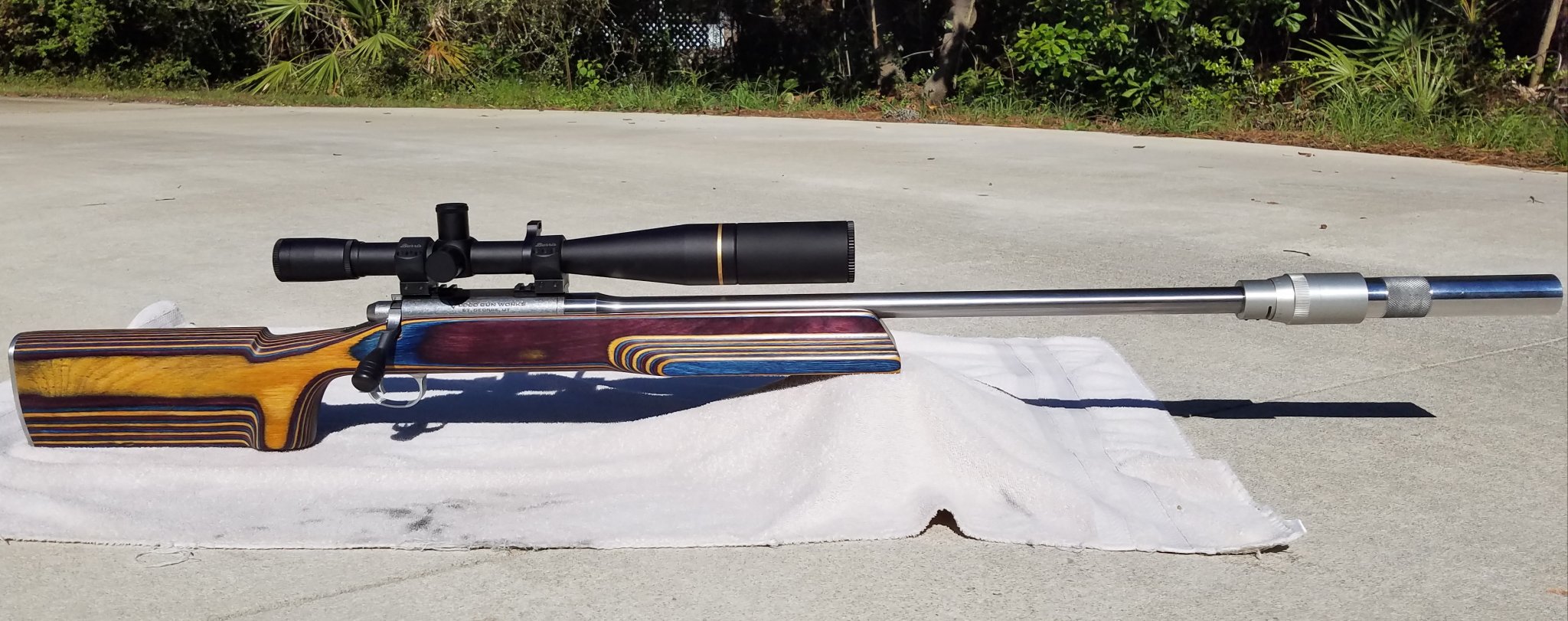

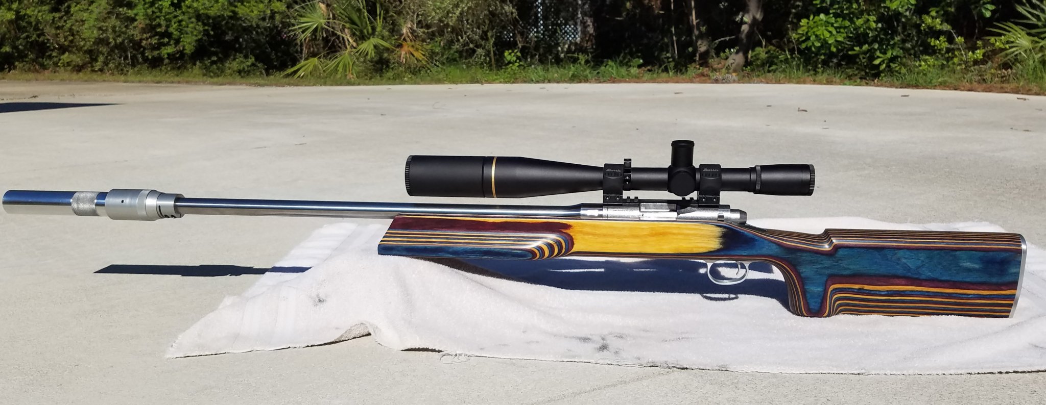

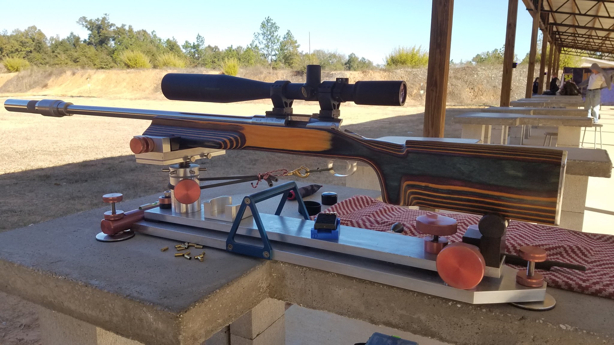

Wow! That's beautiful! Those Burris cases also fit 3 boxes of 22 rimfire perfectly!
Join contestThanks!!! Yes, those Burris scope ring boxes come in handy.That's a great-looking stock, BC.
One of the best I've seen!
Looks like a Burris scope ring box in the 1st and 3rd pics.
It makes a great box for fly fishing after removing the rings.![]()
Thank you Sir!! My wife was responsible for the colors....she made and excellent choice!!!Wow! That's beautiful! Those Burris cases also fit 3 boxes of 22 rimfire perfectly!

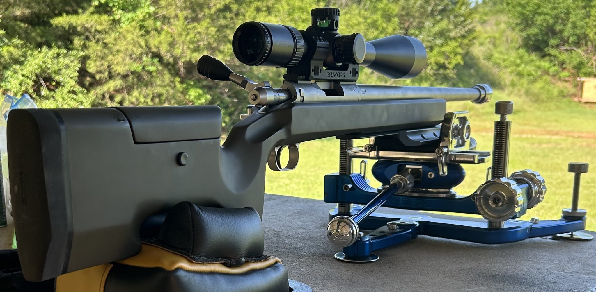

Maybe a dumb question but do those “bloop tubes” make a difference?Got my Vudoo V22S back together just in time for our ARA Unlimited match yesterday. Also shot my personal best high card of 2350 13 X's during the match. I'm thinking it's gonna do just fine!!!
The short answer...... Yes, they do work for me.Maybe a dumb question but do those “bloop tubes” make a difference?
once you have found the sweet spot you rarely need to move it EVERI was looking at the one on Harrell's site to go with the tuner, but I wasn't really sure if they actually did much. Did you have to readjust your tuner once you installed it?
I didn't have to change my tuner setting. I have tried a couple different tuner setting over the last year and always come back to my original tuner setting.I was looking at the one on Harrell's site to go with the tuner, but I wasn't really sure if they actually did much. Did you have to readjust your tuner once you installed it?
