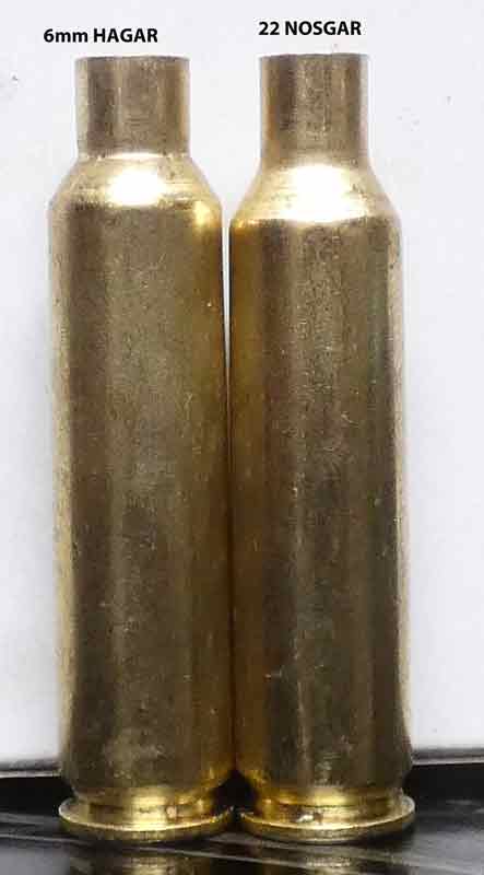

The 6mm hagar case has the most powder volume of any case I know of that runs in an ar15 magazine. Necked down to .224(220 thunderbolt)allows you to run 77 grain bullets at 3200fps without any pressure signs. Guys are getting 3500fps with 55 grain bullets. This uses the same bolt and magazines as the 6.8spc/valkerie, and is much better than the 22 nosler. Padom has posted some great information on this cartridge.

The 6mm hagar case has the most powder volume of any case I know of that runs in an ar15 magazine. Knecked down to .224(220 thunderbolt)allows you to run 77 grain bullets at 3200fps without any pressure signs. Guys are getting 3500fps with 55 grain bullets. This uses the same bolt and magazines as the 6.8spc/valkerie, and is much better than the 22 nosler. Padom has posted some great information on this cartridge.
Tougher bolt than a grendel/arc, little more capacity in the mag. With quality bullets a 22 nosgar could do a lot of damage. Nosler should sell 22 nosgar brass, they are idiots for not doing it.

The 22 Nosgar, shortened from the 6mm Hagar/Thunderbolt holds less powder than a 22 Nolser but is a stronger case.
The 6.8 sized rim doesn't take much metal out of the bolt face over the 5.56 sized bolt of the 22N.
Body Die to resize (slowly), Modified Lee Collet .223 Neck Die, Trim, Use 22N barrel, 6.8 bolt.
I consider the 22N (Nosgar) the big brother of the 224V for long load slow fire :)
Interesting
6mm HAGAR necked down holds more powder than the 22 Nosler or 22 NOSGAR.

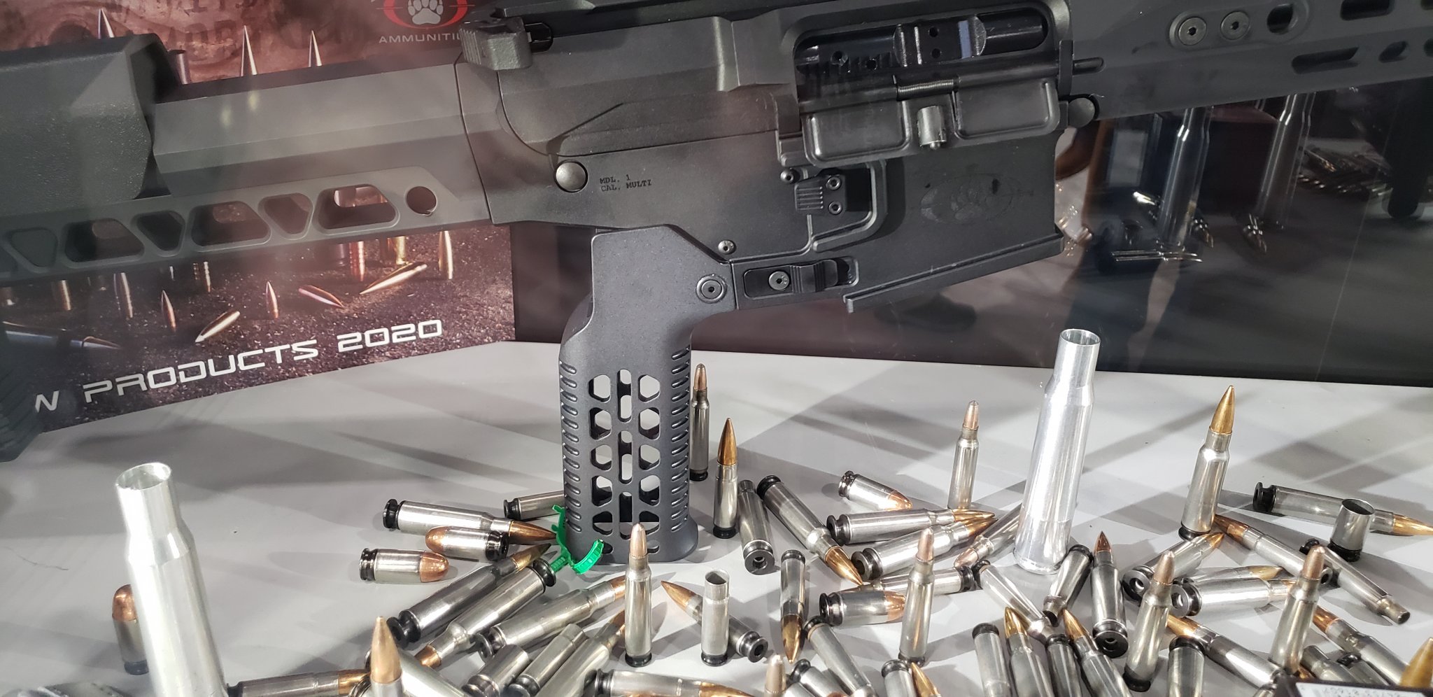

there was a previous thread about the 6.8x51 that sig was playing with, and I thought you mentioned something about new alloys and durability, I couldn't find the exact exchange so I thought it better to summon you and see if you had any commentary on the rounds high pressure/velocity causing fast or premature throat erosion with the new alloys (if you're allowed to say anything at all)
We all have 223/5.56 and it's been around long enough. Even the military wants a new cartridge. There have been many advances and discoveries is tech, powders, aerodynamics, etc. If cost and availability were not an issue, what do you think should be the next cartridge standardized for the masses? https://www.shootingillustrated.com/content/the-complete-guide-to-ar-15-cartridges/
Supposedly theyre about to settle on some plastic cased 6.8mm (all new) not related to any other 6.8. Odd round and the fun submissions are plain bizarre and honestly what good did all the extra ammo that coud be carried do?
The round was working pretty good in our new BB material.
Standard 416R and standard c.m. barrels that hot round chews them up like water. I'm going to keep the round count to myself for now from what I was getting on the barrel life on the ammunition test barrels. It was the first round of testing that I got data back on and it was in standard material. More testing is in process and I haven't heard of any new numbers yet.
The other thing I've heard is the steel case head/brass body is hard on the chambers as well. The steel doesn't expand/shrink back like the brass does.

Kind of like these two piece cases in the attached picture. Steel case head with an aluminum body. Interesting thing I heard on these was that after firing you didn't have to resize the case. You could reload it right away due to the aluminum contracting back to size is how I understood it.
The attached picture was a 40cal rifle we made the barrels for testing etc...used the two piece cases. Barrel was like 40" long in that picture if I recall correctly. This was at Shot Show two years ago. Right before pandemic hit.
Later, Frank

Kind of like these two piece cases in the attached picture. Steel and aluminum case heads with an aluminum body.
Later, Frank
