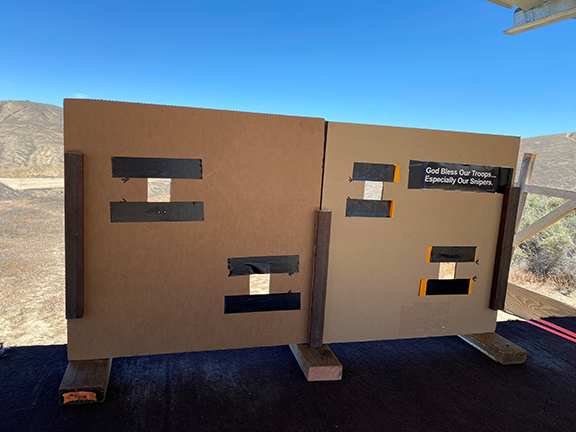

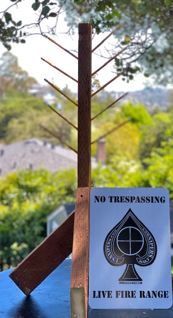

This image represents 2 hints of an upcoming stage. Teams will have to disable their targets to go to the next distance. The final target on this stage will produce a Stage Winner and receive a gift from BT Industries, also serving as the tie-breaking stage for the match.
FYI the image below is not the actual target hanger -- just used to proof the stage.
*Target with no visible backstop, misses will not have an impact signature to use for corrections.

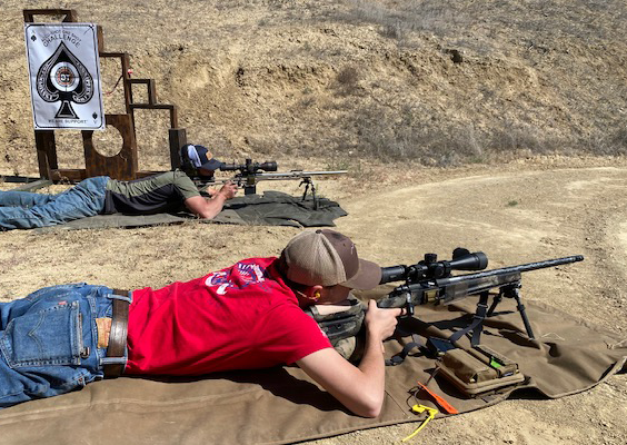

For time management, you always need to have the most experience shooter of the two go first. No such thing as having one be wind b* as y'all are teammates lol.
There's no such thing as split times. You're only as fast as your weakest link. Like diver said, if you skip a target, you'll just lose those points. And in some cases, you can't skip it. So you must try to engage it regardless. And no, don't shoot towards a different area cause you're struggling to find the target. That's a quick way to get you DQ'd.
@hic28 and I keep it simple. I'll find the target, range it and write my dope, while he shoots his pistol portion. If he needs me to spot him, he'll wait till I finish my pistol portion, if not, he'll shoot target 1 on his own and I'll play catch up. I give him the range so he can write down his dope as well. But we go fast enough that I'll be done with pistol as soon as he's done writing dope. He'll sometimes wait to get me on target before he starts engaging.
Here's a quick video. We where shooting same cartridge, but different bullet. He had to push his harder to match my dope as the bullet's BC I was using, was higher. It was so cold that day (hence mouth breathing) that I just went with his dope. They let us range and dope the targets prior to starting on this stage. So I was keeping warm in the truck hahaha. Since it was near identical. Maybe a tenth to half a tenth difference.

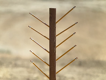

Target 1: The target is set between 12y and 50y and requires that the Teams brake the top 2 pencils on their assigned target stand to move on and each pencil is worth 5 points.
It does not matter who ends up braking both targets, so working as a team is best. We're using target 1 to illustrate the techniques that one can use to gain an edge on other stages or in the field, and it is really what the entire preface is all about.

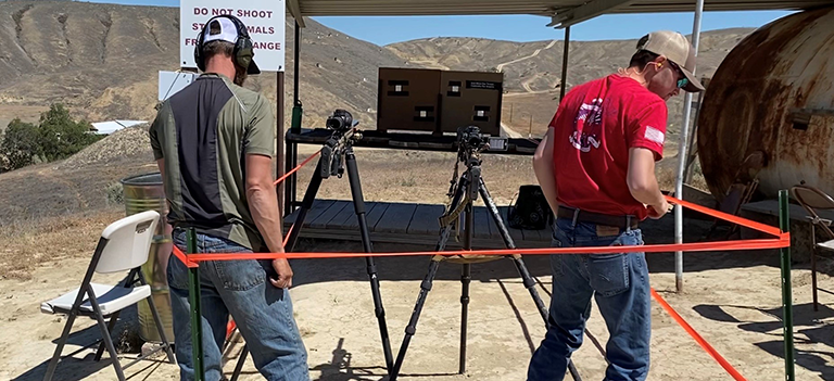

Tips for the Stage Target 1: See if you notice anything unusual in the video below. There is a very purposeful move that you normally do not see.
This is not the real stage: We videoed this to help illustrate the need for close-range targets or obstacles (hint for another stage), be as accurate as possible from the muzzle to the target. Most people range a target where they stand then shoot from that spot; it's often more than a 1 to 1-1/2 yards from the muzzle. That said, I am the first one to say that under normal circumstances, who would care. But remember, we are using these examples/discussion points in the hopes of building up to another skill test or stage. With that in mind, if we set target 1 at 12 yards, on my rifle with an SOB of 2.3"; a 1-1/2 yard ranging error is .6mils. It sounds worse than it is because we are mainly thinking of longer distance angular results. But it would be about the width of the pencil at 12 yards.

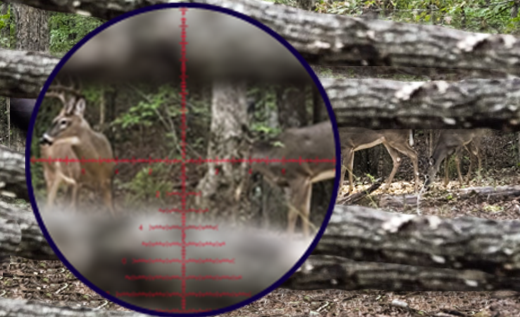

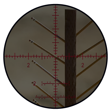

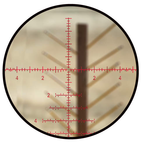

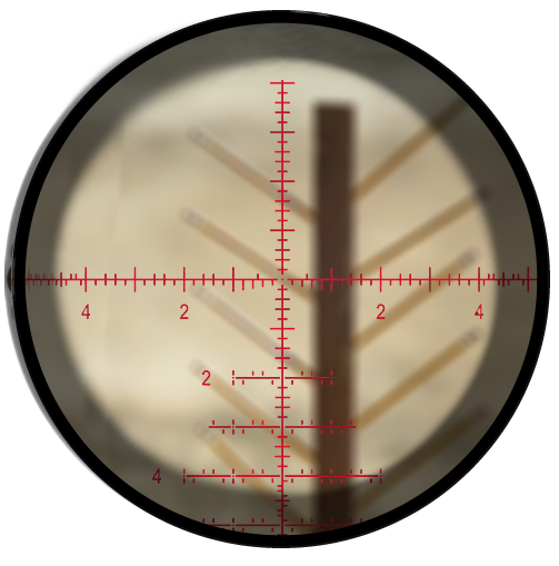

With targets SUPER Close, parallax can cause a real issue, as well as a blurry image. A blurry image can be especially problematic if you need ACCURATELY to identify an obstruction as not everyone's scope can adjust down parallax free to 6'-15'. (Hint for another stage).

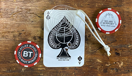

An old school trick used to ensure your scope is parallax free is scope shadowing. It is super fast and simple, move your head back slightly until you see even shadowing all around the ocular. It can be useful in several real word situations even today. Be it a stage with poor body position containing both near and far targets without the time to adjust the parallax to a long-range target where mirage makes it very difficult to ensure the parallax is correct. What's really happening is the even shadow around the ocular is indicating that your visual path through the scope is lined up and centered.

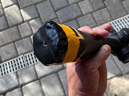

If you need ACCURATELY to identify a close-range obstruction closer than your scope can resolve, you can pop a hole in your objective scope cap and drastically increase your depth of field. Unfortunately, smaller holes yield more depth of field and depending on the size of your hole; your image brightness will drastically decrease.
On the Vortex AMG as shown, I put two layers of tape back to back so that there was no adhesive and punched a small hole in it. Normally I just use a rubber band, but I decided to tape in orange, so it is easier to indicate that I was not using the adhesive from the duct tape to stick it to the scope. You can do the same with a thick piece of dark paper or similar.

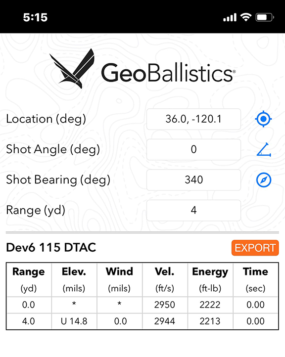

Lastly, the last tip for this stage is that your dealing with targets that are effectively "Skylined." They are too close to use trace, too small anyway as well. So the best way generally to deal with a target you missed and have NO possible hope to identify misses is either bracket the target or try to pull off and send one into a similar range where you can locate your POI. If you choose to bracket the target, first, you have to be certain your shot execution was perfect. Then make sure you don't just make partial moves. Move about the full size of the target. Remember that you have the target width, plus your bullet width. Did I mention your bullet will be >.6mils at 12 yards or about .3mils at 25 yards?

Hopefully, when we further along the image @Calvinho leaked will make more sense, when you see scope images like below, you know exactly what’s is happening; not everyone does. Hint, this uses and builds on the principles talked about in Dave's pencil stage spoiler... We'll have clear info later on and this will be easy stuff.
Above is the practical application.

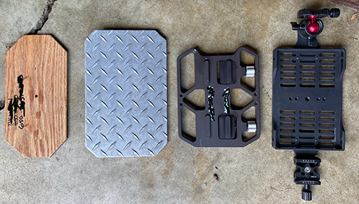

This represents approximately the last 10 years

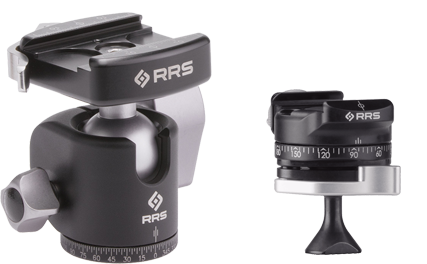

Left to right: Pre-commercial table, JC Tac-Table, Gray Ops Elite Arca Multi-plate and Able Table.
Wood: Uber light and very cheap, but when wet, the bags slid around. I used this with the old Manfrotto 055s with the center column. The center column was fast, so you could quickly adjust the rear height.
Tac-Table: This cam out and seemed like it would offer more traction and be stronger. Unfortunately, these came out when most of us switched to column-less tripods, so I never used it much.
Gray Ops Elite Arca Multi-plate: While some use this as a "gamer plate," this is a very nice optics platform. It is the heaviest, but most elegant, but suffers from having the glass too close for two shooters to both have binos on the same plate. You also can not change the orientation of the dovetail mounts; if you add a panning head, the plate can get too small with a large spotter and binos.
Able Table: This is my second Able Table. In the raw form, the lightest commercial option and has the most mounting options. The Able Table also holds the shooting bag in place the best.
Once spruced up with the optional mounts is wide enough to have 2 people use Binos simultaneously, run a large spotter, and binos easily pan, use three optical devices or shoot on with your binos and PLRF attached.

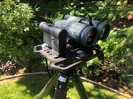

Here is an image with it like @hic28 posted (he is offering 10% off to the thread users). I added these images because I wanted to illustrate why I came back to using the Able Table over the others. Not only are there 4 flush cup receivers, 1/20 threads down the center, and a 3/8 thread to mount a QR for a rifle if you wish, but the slots also allow for 1/4-20 bolts use as I did with the Kestrel on the swivel. (Note- I don't use the Kestrel often or for my dope- this was just for the picture).
I have a panning head on the PLRF so it is easy to get on targets precisely. With the ball head and QR, it now weighs a couple oz more than the Gray Opps.
You can use the plate as a gamer table if you wish, but I don't use them anyway. If you do direct mount a rifle as shown, I would not have your optics attached, I'm just guessing, but I bet recoil over and over isn't the best for them.
A bag in the middle is ultra-fast, and the recoil is minimized to the optics as the gun slides over the bag.
I think it is worth noting that end of these as a rear support is all but gone; except in some very limited applications. Today, the technique of using a tall tripod leg to sandwich the butt of the rifle is so fast and so stable it is usually the best choice.
* The Able Table shown is going to use the RRS BH 30 on the left side for my spotter because it can hold the weight and has the panning base with the lighter Panning Micro Ball BPC-16 for the binos for better grid glassing this Elk season.

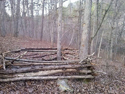

I added this to the tripod post. I was not going to include it because it really doesn't work great in the tall grass, bushes or on steep slopes hunting or in the field. But a buddy said I should at least show this method. BTW I cut my own hair with an electric razor and cut the racing strip in by mistake!
Here is another method if you know the stage is going to require standing to kneeling or kneeling to standing; well, any combination.
This works best in a PRS/NRL type match where the ground is flat and not covered in brush or tall weeds. You use a reverse setup with two legs in front and one in the rear. You control the tripod with the one rear leg and use the Apex locks to control the height. You'll notice is once again, the low standing height you marked on your legs are again perfect to provide an excellent kneeling position.

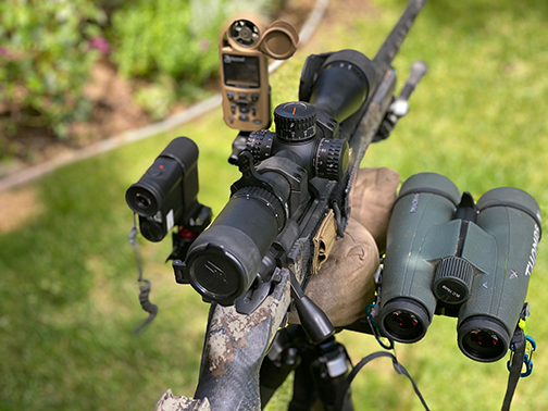

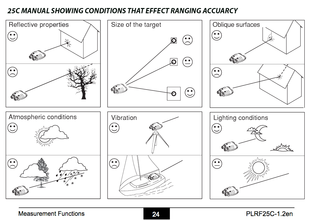

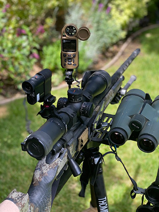

How well do you really know your Range finder?

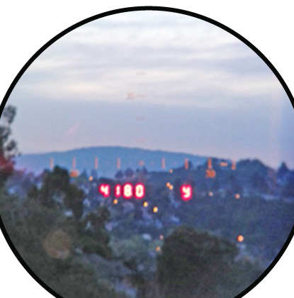

Here is an illustration that sums up what all PLRFs (personal laser range finder) like and struggle with, when attempting to provide an accurate distance return.
However, this segment is not about what PLRF is best, or why a rangefinder doesn't like specific colors, textures, or reflectivity distances; it is about understanding what you're actually ranging—knowing exactly where your beam is significant when ranging through loops in foliage both near and far, around power lines, over rolling terrain or just a smaller target all further ranges.
Unfortunately, most of us are focused on the maximum distance our wallets can buy, and usually at the lowest price. But is that really what we should focus on as the primary driver for our purchases?

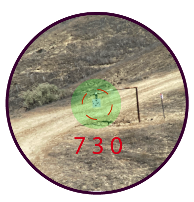

Above is an image from one of my range finders. Is this type of maximum distance return really that helpful, or is it better to know with certainty what your ranging?
How well do you know your Range finder? Is your range finder a circular beam, a landscape rectangle, portrait, or something else? I bet if I asked 20 people randomly, ten to fifteen people could not answer this simple question.

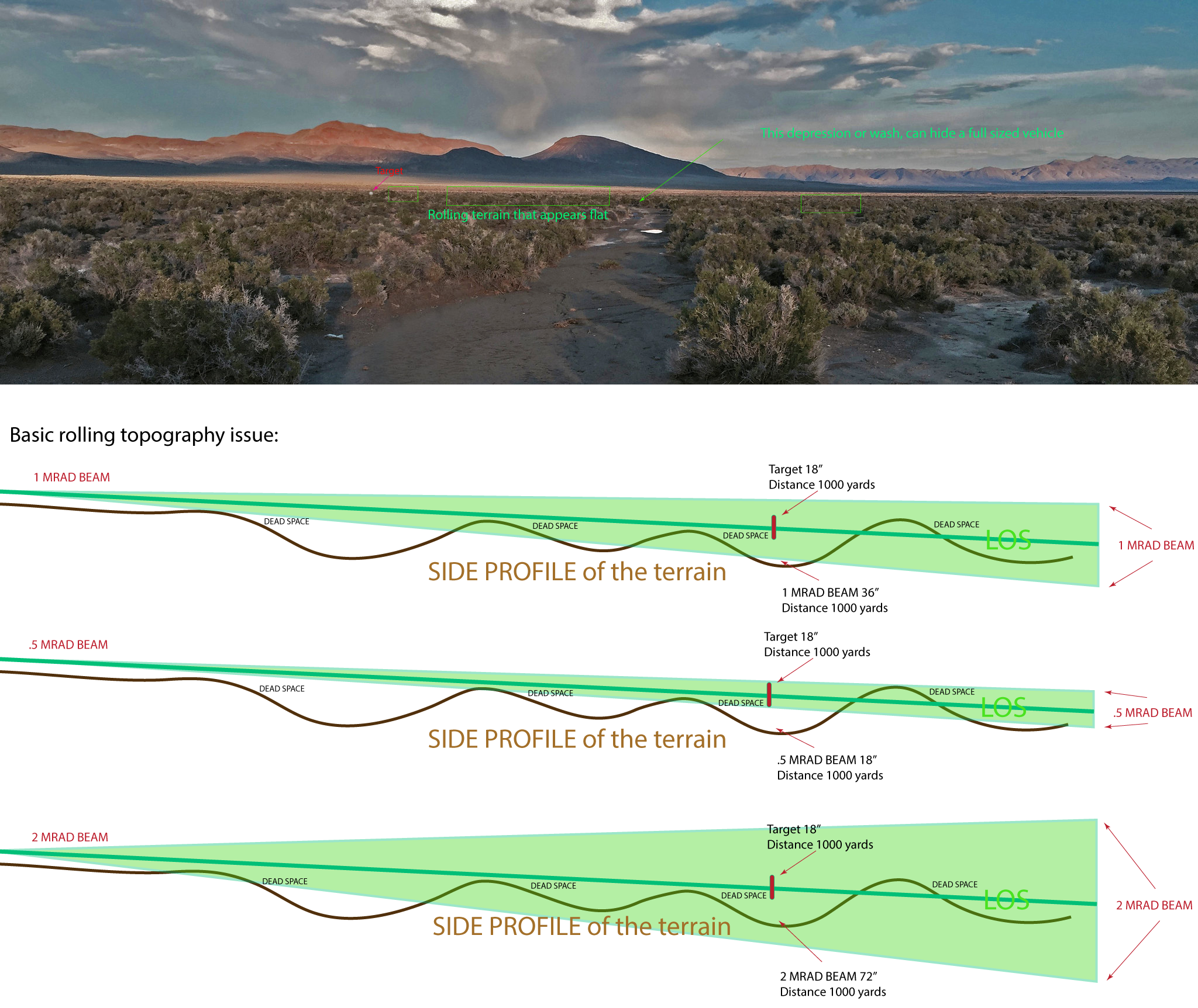

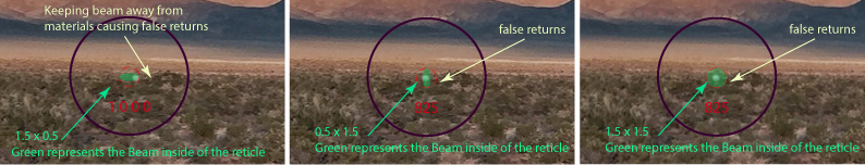

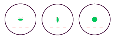

Beam divergence, the angular measurement of how much a beam spreads out over distance, and it is essential to understand for our use. Ideally, we only want to range our targets, not the terrain, bushes, or other items that might lead to a false return. Targets close to the ground set in rolling terrain can be deceivingly hard to range accurately. Below is an illustration of an 18" target at 1,000 yards, this represents .5mil.
Looking at the listed beam divergence numbers and you'll note that they are a mix of portrait, landscape, or circular. The beams listed as rectangular are usually a bit more of an oval in appearance. So why does that matter? Well, in some cases, you may be more successful, ranging a target either off-center or with your range finder at 90° to how you usually hold it. Below are 3 images that represent landscape, portrait, and circular beam patterns.
Let use the above patterns to see how it works on a target relatively close to the ground. The target is 18" and sitting at 1000 yards. Having a landscape orientation held off (away) from the small rise behind the target, you'll have the best chance for an accurate return from the target, as illustrated in the leftmost image. It might be worth noting that you can turn your PLRF on its side if you have a portrait beam when faced with a difficult scenario like this. You need to confirm where the beam is in your reticle before you can really begin using techniques like this.
We are starting with a challenge since we already know that we are trying to range targets generally smaller than the beams of our PLRFs. Ground effects, loops through trees or foliage, and target sizes can be a challenge for your PLRF. I am going to single out one of the hottest new laser range finding Binos, the Sig Kilo3000BDX; mostly because of its popularity, but also because it happens to be perfect for several downstream discussion points. Notting that our targets are rough 2MOA and the Sigs beam, at least 1.5mrad/5.16MOA, the beam is over 61% larger than most of our targets; it should start to become apparent that we might be facing a few strange distance returns. Generally speaking, smaller beam divergence is better for our users, but tighter beams usually need more stability. In reality, most of us are shooting targets much closer than the maximum distance a modern PLRF is capable of reading, so we really should be paying attention to the beam divergence over the maximum range. Here is a 12" (.48mrad) target at 695y that often returns longer ranges to the user than it should. The green represents the size of the beam we found on the unit we tested; to be clear, this is only one sample, and the Sigs are a great value.
There are several ways to control the beam size, the expensive way, through high-quality laser diodes and associated hardware or shifting more dependence on DSP (Digital Signal Processing). This is mainly important if you're using NV (Night Vision) to verify your PLRF's beam location. The truth is that all PLRFs use DSP to distinguish the real target from the noise that creates false returns. I'm only mentioning these to help put our discussion into a rough context when we look at images through NV.
There are two straightforward ways for you to confirm the size and location of your reticle and the lasers beam size that we'll discuss. The first is by using a NV device. Commercial grade lasers are visible under NV, but not all units are. The other is by trial and error; I call it Ghetto validation.

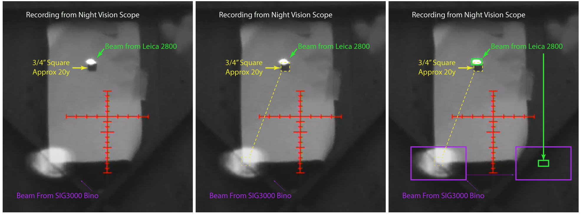

Below is what the beams look like under NV.
I generally use a grid target and place it at 30yards. In this case, I was at 27yards, so I drew black rectangles to match them as close to the specification of 1.5 x 0.5 mrad. 1.45" x .5". You do not have to be totally accurate. What you're after is that it lines up in your reticle and is close enough to what you expected. I use just enough artificial light to light the target, so I can align the reticle, and lock it down in the tripod. Well, don't do as I do - LOL I only brought out one tripod, I handheld this for the recording, so it was not steady or dead centered on the target.
After my buddy and I noticed his Sig Kilo3000BDX struggled to shoot through the opening in trees, that a Terrapin or Leica could easily navigate, we decided to compare the two under NV. This was just a quick and dirty NV comparison test we did while hand holding the devices.
Left image: The black square is the scaled target, The bright light above it is the beam of the Leica 2800 and the big oval light in the 7 o'clock position is the beam of the Sig Kilo3000BDX
Center image: The target is now Identified with a yellow dotted line around it. It represents 1 mrad. You can see just how large the Sig Kilo3000BDX beam is.
Right Image: A green box is placed around the Leica beam and a purple box around the Sig; these boxes represent the beams sizes. In the lower right, you see both boxes superimposed over each other to give a sense of scale.
If the Leica's beam tests as it did just under 1.5 mrad, then the Sig Kilo3000BDX's output beam is many times greater than 1.5 mrad. Realize that Sig is using DSP to try to reduce the beam divergence effectively. While this works, it still was significantly larger in practical use than the specified 1.5 round beam. Remember, we tested this because it didn't work as well through loops in the field as expected, again this is only one unit, so it is antidotal at best.

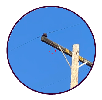

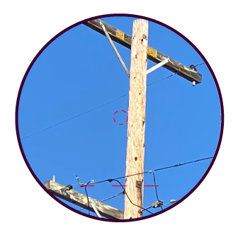

Ghetto validation:

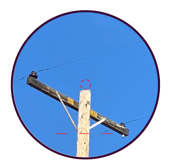

If you do not have access to NV, this simple test works really well. Make sure to use a steady tripod, or you'll be wasting your time. The goal is to find the areas in your reticle that does not return yardage. Telephone poles are good targets to use. Ensure that the background is clear from all obstacles except the pole that could provide a false return, especially the wires. Try to estimate the diameter of the pole at the spot you'll set your reticle, in my case, it was 8."
The first thing you do is find a distance that just fills out your PLRFs reticle. Range the pole and note the distance, for me, it was 145 yards. At this point, you're just confirming the approximate size of your reticle in the PLRF, NOT the beam size, or really the alignment.
A version of mill ranging or loophole sizing (more on that later, you'll use this in a stage) works well to confirm the size of the reticle.
(27.78x inches)/yardage = mils in the reticle
in my example (27.78 x 8 inches) / 145 = 1.53mil reticle. I have confirmed it is close enough to the manufacturers' claim that the beam should be 1.5 mrad at its widest point.

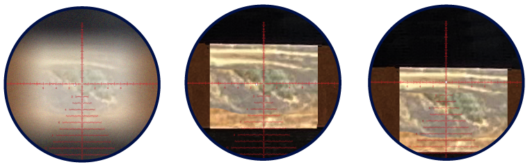

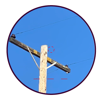

The next series of 4 images should be fairly self-explanatory. You need to carefully make sure you place your reticle as close to the pole as possible without getting a distance return. You want to do this for the top, bottom, and both sides. Get as tight on all 4 sides as you can to confirm where your beam starts and stops.

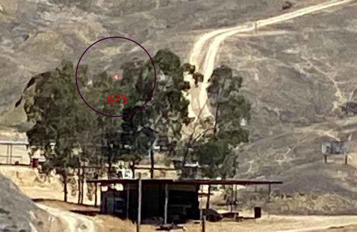

PRACTICAL USE:

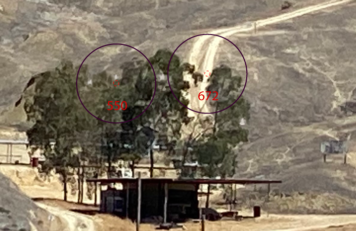

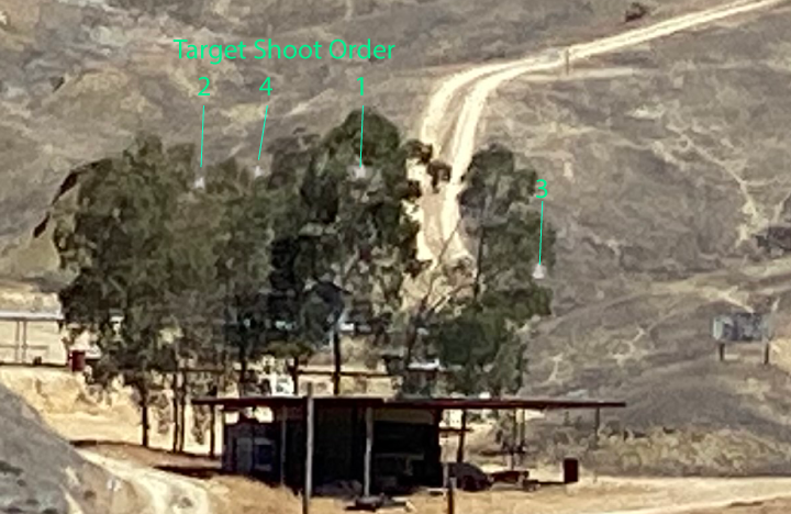

There are 4 targets, partially obscured by the trees. In a match setting, you will be task loaded by design. The clock plays a huge roll in creating this tension. Efficient shooters, don't do things over and over; this is especially true for ranging targets. Some will use a strategy to purposely range items that are NOT the target first to set known brackets. This allows them to quickly identify miss-reads and not have to try to range the targets over and over, hoping to get a good average return.
Here is an example where the shooter is looking to figure out what distance the trees are and what is the rough distance to the hill the targets are set. It is super fast and sets an excellent baseline of knowledge.
With the baseline known, my strategy for ranging a target like T4 would be to get a return above as the hill falls away. I expect this to be further than the 672 yards I ranged on the hill for my baseline. 710 yards makes sense with this return, so I will not try to verify it again.
I place the reticle on the target and get a return that is much closer than the slope that is falling away. It is very close to the expected distance on the hill that the baseline identified. Note that for T3, it is apparent that is is not on the same elevation as the other targets, so I'll range the hill to the right of that target. When I set the reticle on the target, I'll expect it to be 5-20 yards closer. The truth is, at these distances with a 2MOA target, 5-20 yards is not a deal-breaker and could be shot without verifying the actual plate.
Please feel free to comment and share with friends if you find any of this stuff interesting.

This stage simulates setting up deep inside of a homemade hunting blind or other hides where the shooter is set back from a small opening in foliage or other obstructions. The stage will have a boundary area between point-blank and 5 or 6 yards (see the orange flag tape), with a makeshift wall with two small ports that the shooters must shoot through to hit targets between 900yards and 700yards. This is a true team stage, if the shooters operate independently, they'll probably time out.
What it looks like - This 6-second clip shows Jon on the left and me on the right, proofing the stage. We are shooting a 900yard target through a 1-1/2" loophole. For the record, staying on glass is not helpful because you can NOT see your partner's target from the loop your shooting, that why I just came off the glass, I have a better chance of helping with my naked eyes, even better with Binos looking over the top.
The stage setup and scoring:
The guns may be staged with the mag out and bolt back inside the makeshift room marked by the boundaries of the flagging tape. Tripods and mags in hand, time starts. One shooter will shoot out of the upper loop, and the other shooter will choose the lower loop, shooters will engage two targets each at one of two specified distances and communicate to the RO their loop and target choice. The shooters may NOT use the same loop height as their teammate, and each shooter must shoot a different distance. There will be a small and large target at each of the two ranges.​
Shooter one will let the RO know what loop and target distance they choose, then engaged the small target first, worth 4pts for a first-round hit, 3pts for a second and third-round impact. Then the large target with the points value being 3pts for a first-round hit, 2pts for a second, and 1pt for a third-round impact. Shooter two will follow confirming they are shooting out of the alternate loop and alternate distance using the same points schedule. This is a high-value stage, so that time management will play a key role. We will have a tape measure on site.​
What's the catch? Well, if there is any contact with the loop board or the tape surrounding the loophole that shooter will score a 0 for their stage, the other teammate's score will count as long as they shot cleanly without damaging a tape or loop board. The RO will inspect the tape and board once the team finishes their time. New tape will be installed after the teams examine and score their stage.​
Above is what it looks like when you miss the loop window. If you look closely at the upper loop on the left side, you can see three bullets that clipped the loophole. The target might still have an impact, but this shooter zeroed his attempts.​
How does a loop Look through my scope? Below is a bit of over dramatic representation, but I think it helps illustrate a major issue.​
Parallax can be a huge issue and does not allow the shooter to see the boundaries of the loophole's actual location when you're not centered in the scope. An old school trick used to ensure your scope is parallax free is scope shadowing. It is super fast and simple, move your head back slightly until you see even shadowing all around the ocular. It can be useful in several real word situations even today. Be it a stage with poor body position containing both near and far targets without the time to adjust it to a long-range target where mirage makes it very difficult to ensure the parallax is correct. What's happening is the even shadow around the ocular is indicating that your optical path through the scope is lined up and centered, or make a pinhole in your cap. See more here: https://www.snipershide.com/shootin...allenge-match-11-22-2020.6980614/post-8556127
It would be best if you lined up correctly, and that parallax doesn't make you think the loop window is clear. The other issue you'll encounter is that you can not accurately scale the opening. In this case, We'll give you the opening size so you'll be able to work out the math if you want to understand what's happening.​
First, think of the loophole as a near range target with a secondary target at the end. So, let's use the very same base number for the reticle ranging stage. 27.78 is the number used to mil range targets in the distance using inches of target height - (Target size in inches x 27.78) / Mils = yardage

2. Using your solver, set the target distance to the distance of the obstruction. We need to find out what problems the distance creates for or SOB and the bullet arc at the loop wall. This will show you just how low the center of your projectile will be below your POA.​
Here I set my target distance to 12' or 4 yards to see how many mils below my crosshairs the bullet's center​
3. Account for your bullet.
Here I set my target distance to 12' or 4 yards to see how many mils below my crosshairs the bullet's center. At 12 feet, 6.5mm bullet is .264" or 1.83mils thick; we need to be concerned with the bottom half in this example.​
6.5mm at 12' is 1.83mils​
1.83mils / 2 = .915mils​
So I have 15mils let say 17mils, for safety under my unaltered crosshairs to clear the lower part of the loop.​
4. Subtract your come-ups from your intended target from the bullet path.
Target @ 900Y = U6mils​
17-6mils = 11mils​
As long as I can see 11 mills under my targe I should be GTG - (remember the loop is 13.9 mils from that distance)​

Of course, if you make a makeshift Hide like above it is easy to see the application. Knowing your limitations and windows will allow you to make a more stealthy natural hide/blind.​
Shooting over walls, stumps, rocks, etc. that are between you and the animal is a good example of where you need to think about this very process. Hopefully, if nothing else this provides a bit of entertainment or maybe even inspiration to make a natural hide/blind next season.​

I had a question about the loop hole shooting when it comes to tripod setup. How does the height of tripod play into this? Is there a specific height the weapon has to be at in order to engage each target or is the trick setting up at a specific distance from the loophole?
Best question ever! You are on to the winning idea. When we had center columns loops were a breeze. Now you need a team to do it ultra-fast. I am only about 1/4 way through that post, but your question is the key to the stage.. Even if you don't do math..
