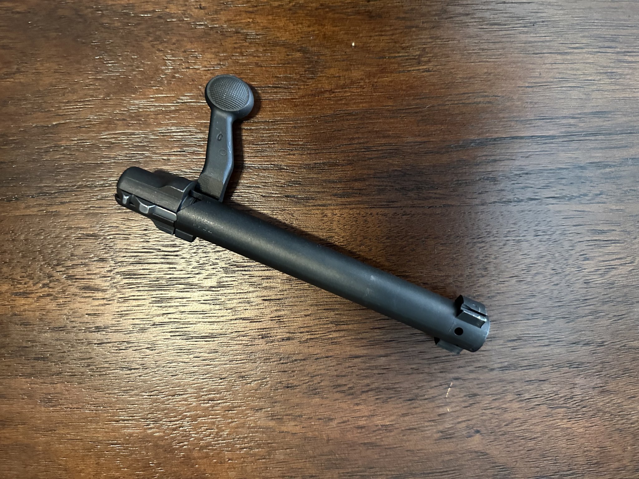

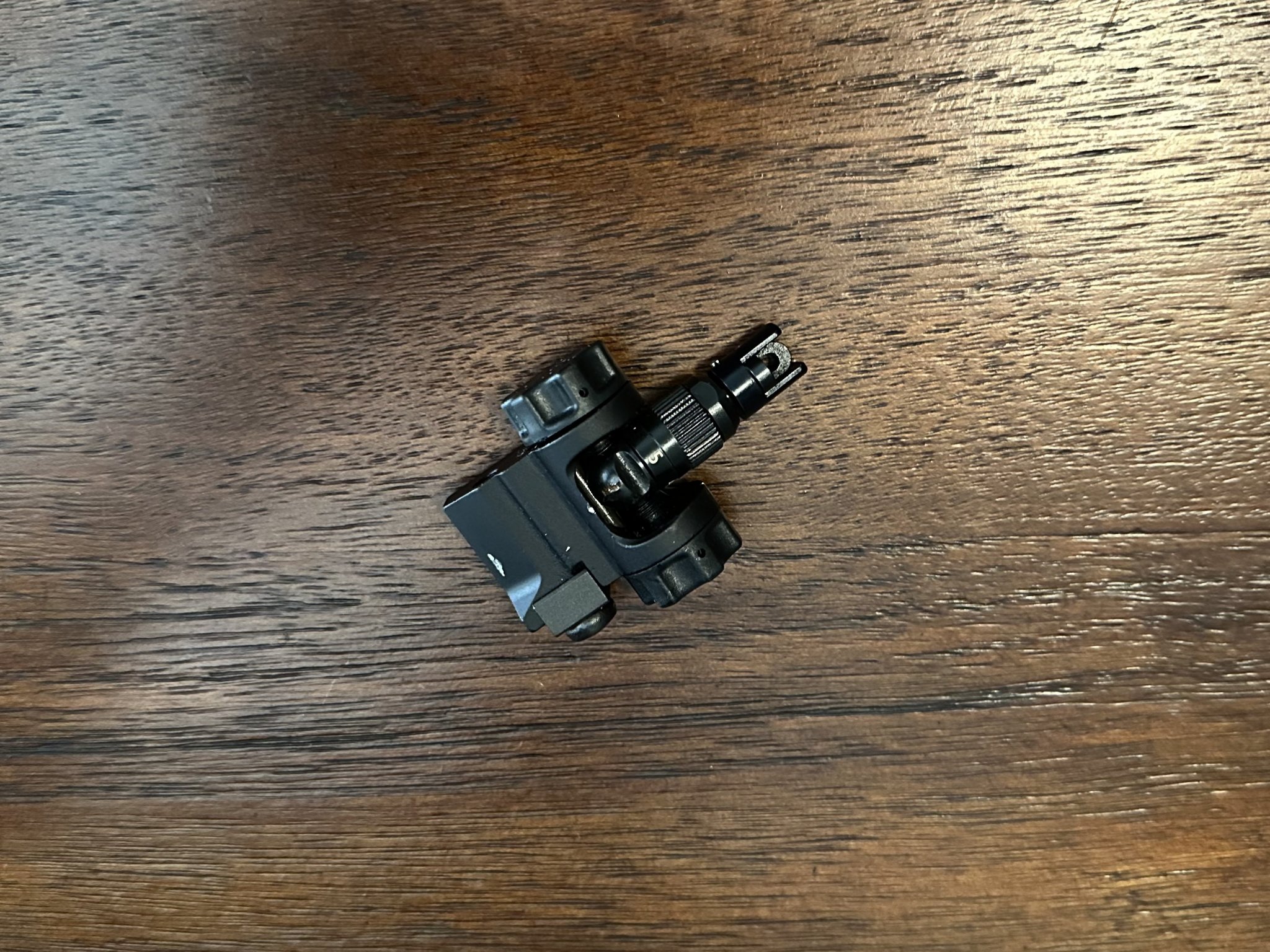

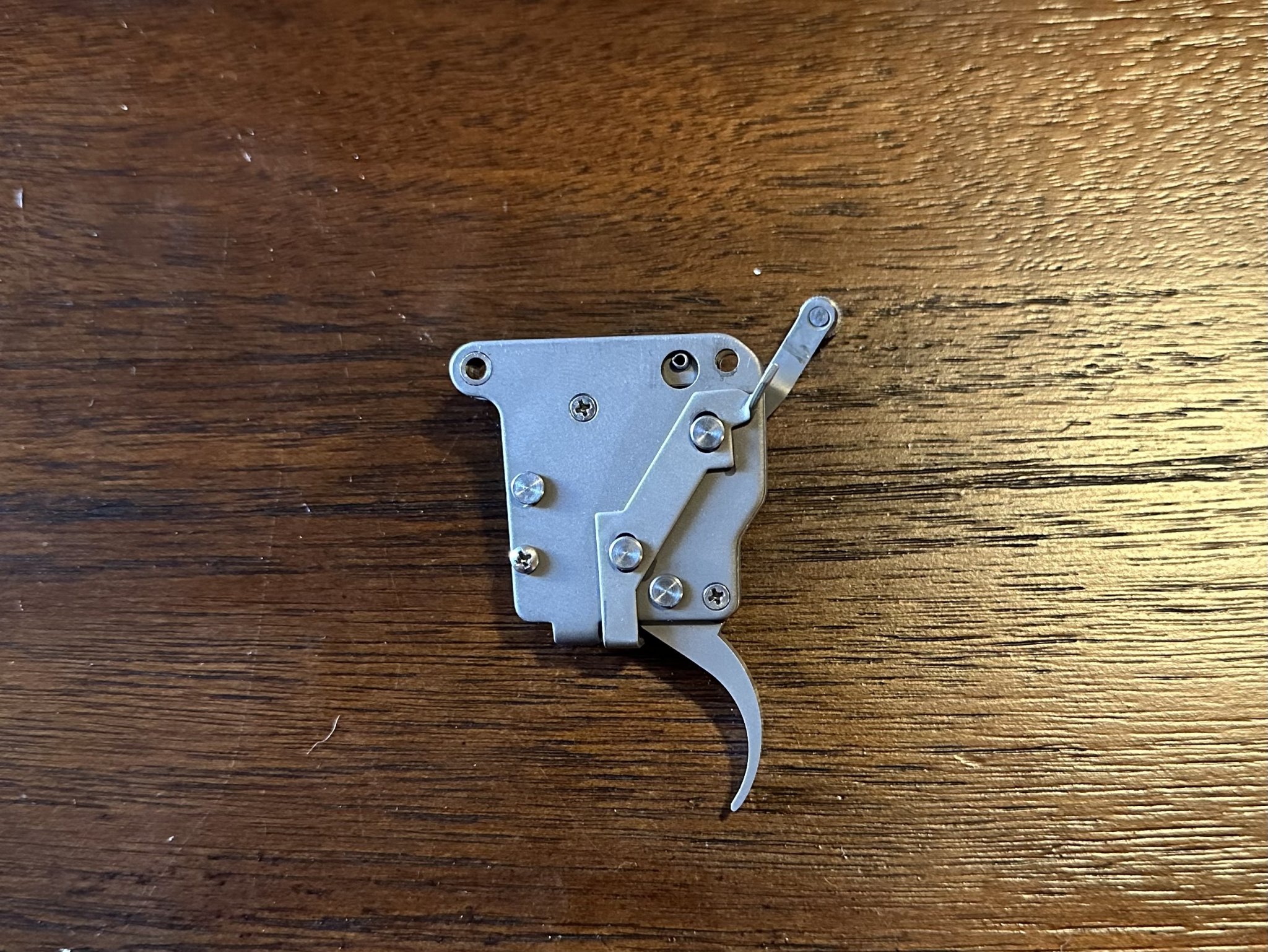

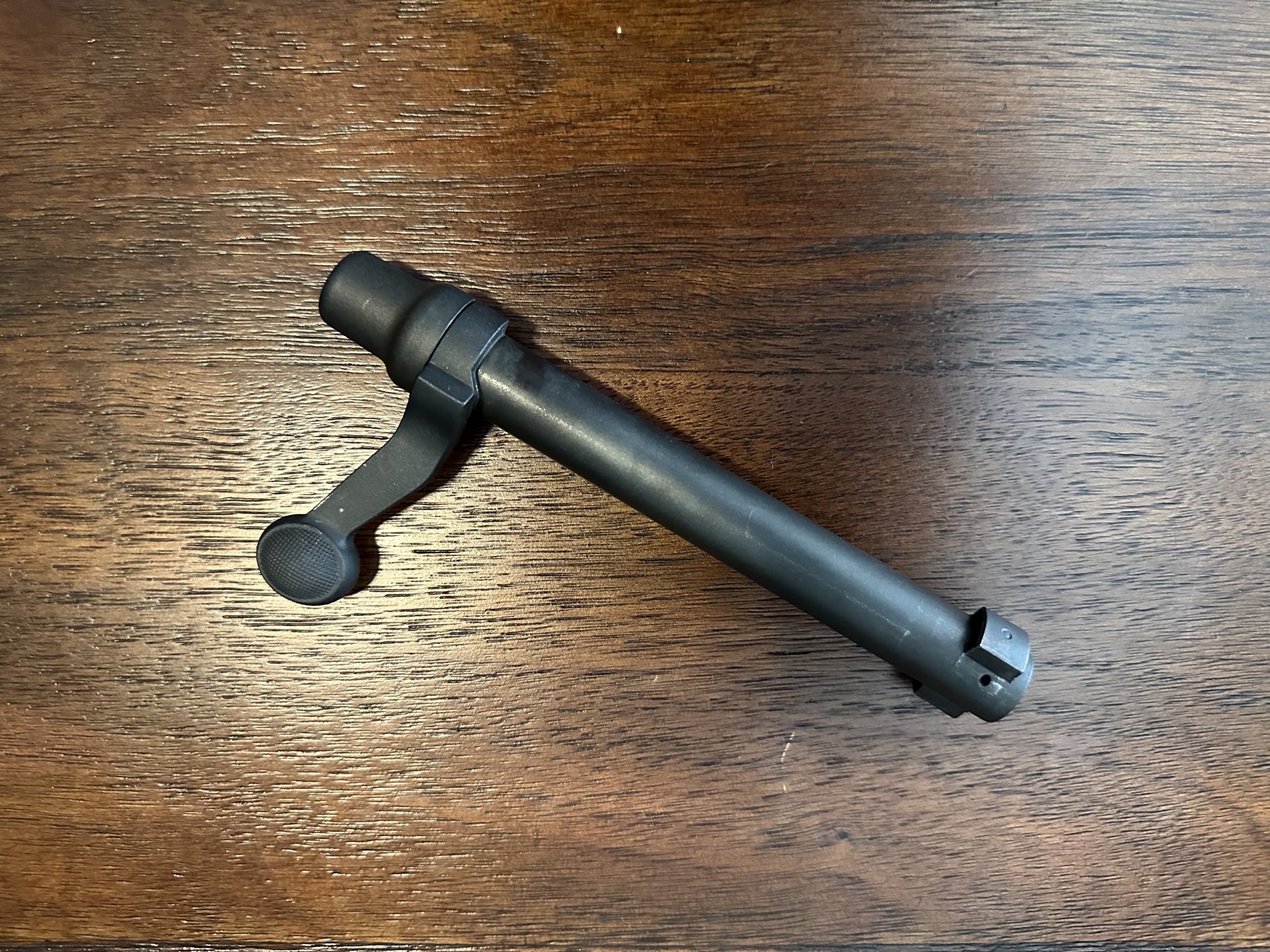

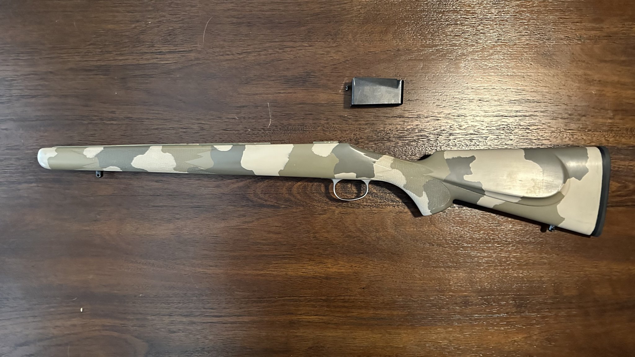

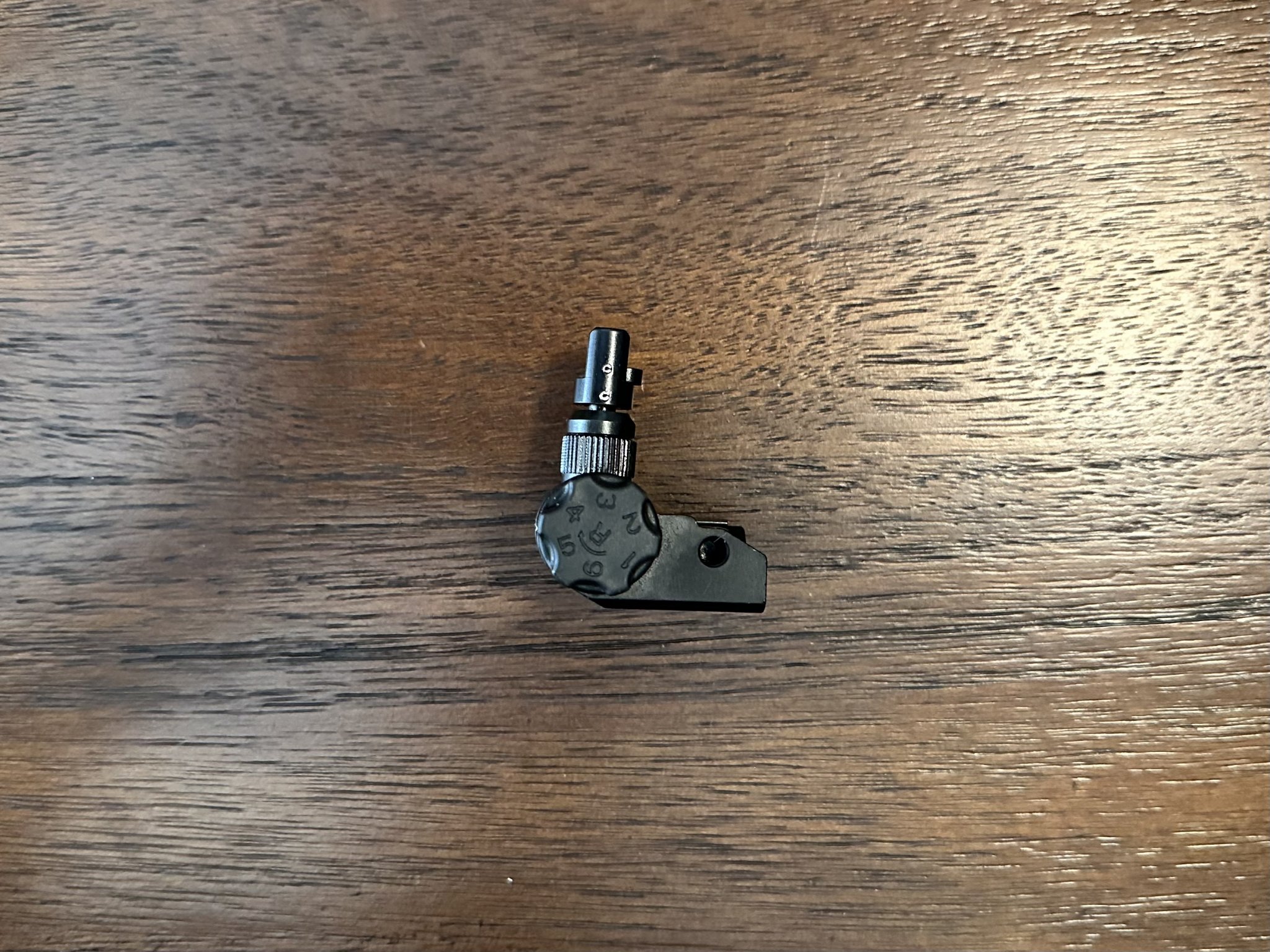

SOLD Molded Camo Remington 700 Stock -- 700SA Jewell Trigger -- Remington 700 SA Bolt Assembly -- EoTech G33 -- FN SCAR Rear Sight
Selling a few things I've gathered that I no longer need:
1. McMillan molded camo stock for Remington 700 short action. Will include short action mag box as well. SOLD.
2. Jewell Trigger for Remington 700 short action. Used but very good condition. SOLD.
3. Remington 700 short action complete bolt with bolt face for .308 and shared case heads. Parkerized. SOLD.
4. EoTech G33 Magnifier. Includes original box and all hardware. SOLD.
5. Factory FN SCAR 16/17 Rear Sight. Small ding in the finish on the front (see photos). SOLD.
Once again, all prices are shipped. Thanks for looking y'all!
