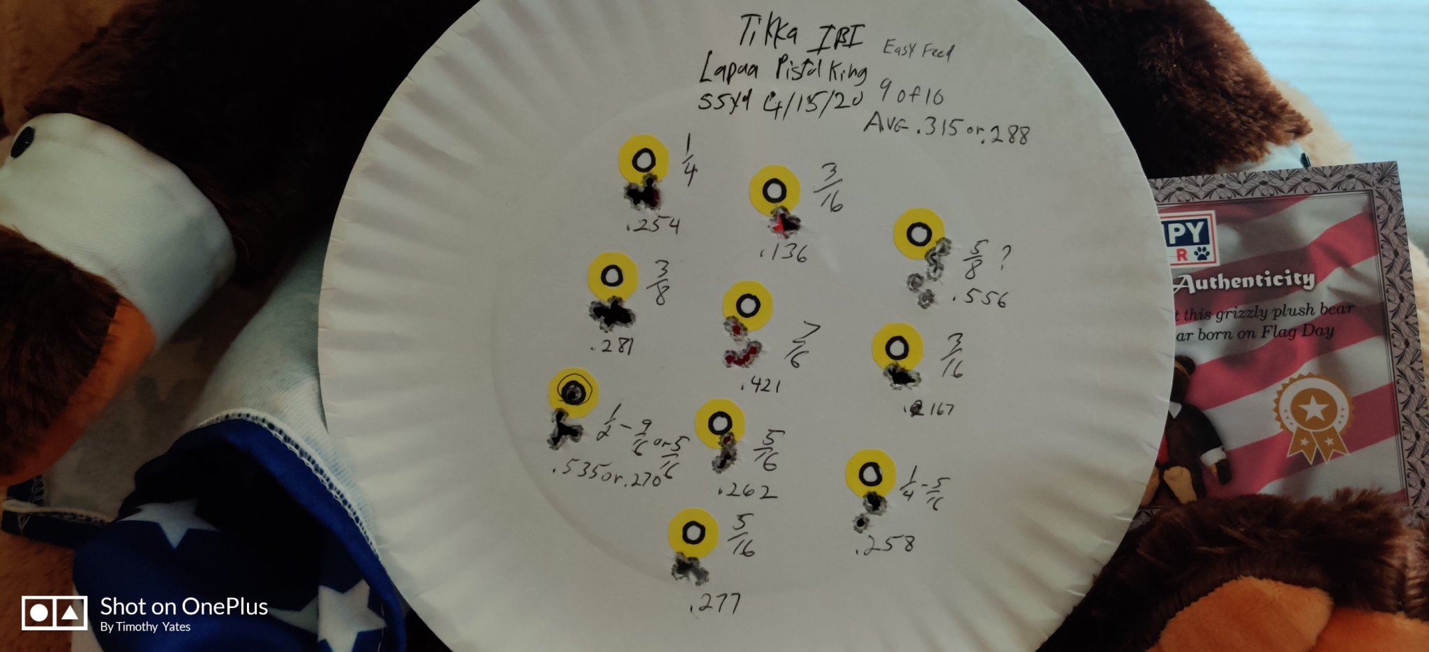

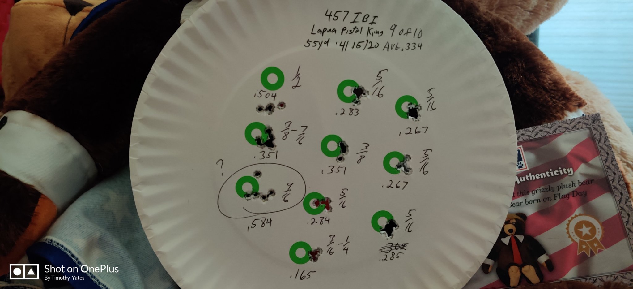

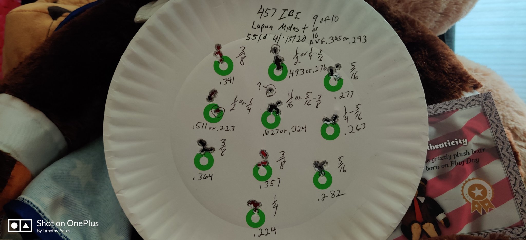

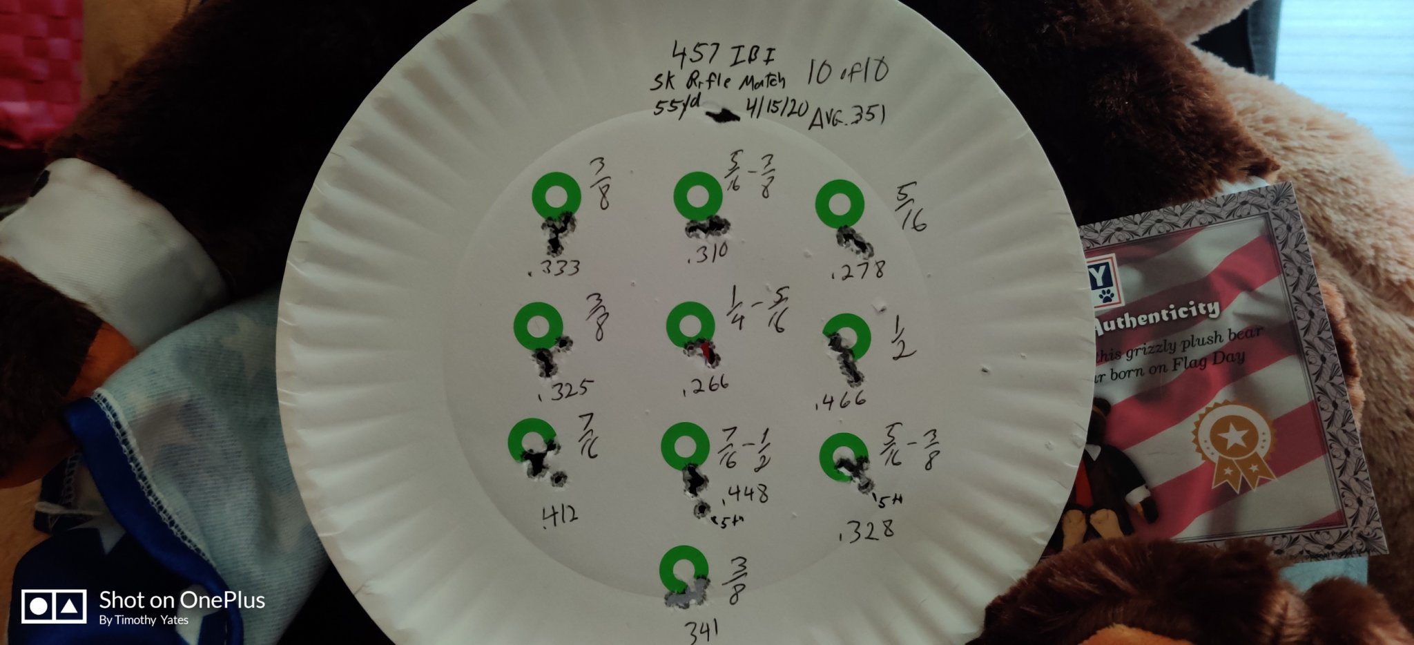

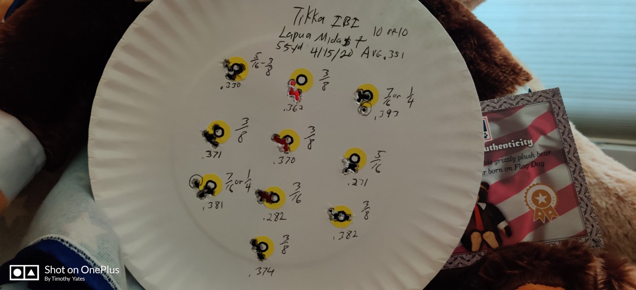

This is why I measure center to center. It eliminates all the measuring errors of a smudge mark and the arbitrary subtraction number. Of course this only works if your eye can locate the center of a hole. These are the groups I get with my T1x with IBI barrel with the Win 52D chamber and the 457 with IBI barrel that has the Calfee 4 chamber. Only reason I measured in decimals was because someone had asked me to.
View attachment 7338188View attachment 7338190View attachment 7338191View attachment 7338192View attachment 7338193
please keep doing the decimals - i for one appreciate it :)
They look a bit odd though ? for example the last plate has a 1/2" or 0.466" is this an incorrect translation of the 1/2" or is the 0.466 the correct measurement and the 1/2" is just the closest fractional equivalent ? I don't use fractions so i don't know what is "normal practice" for example would it be "unusual" to write 30/64 ? Or would this be "sniffed at" the same way as displaying 5 decimals would ?
