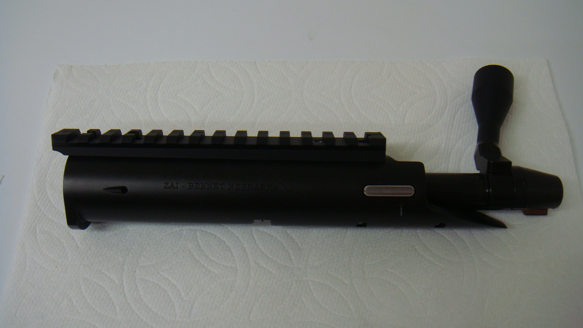

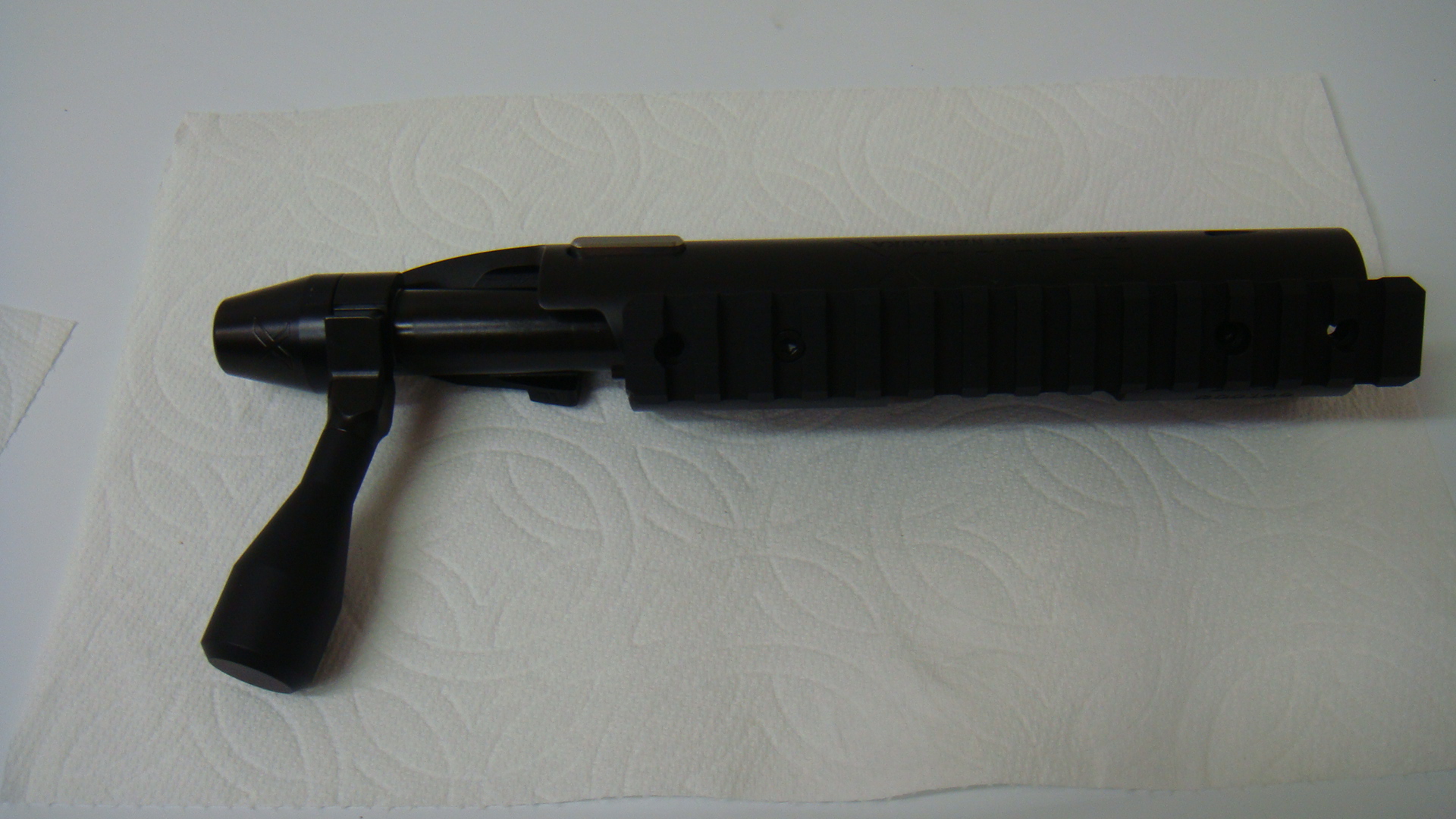

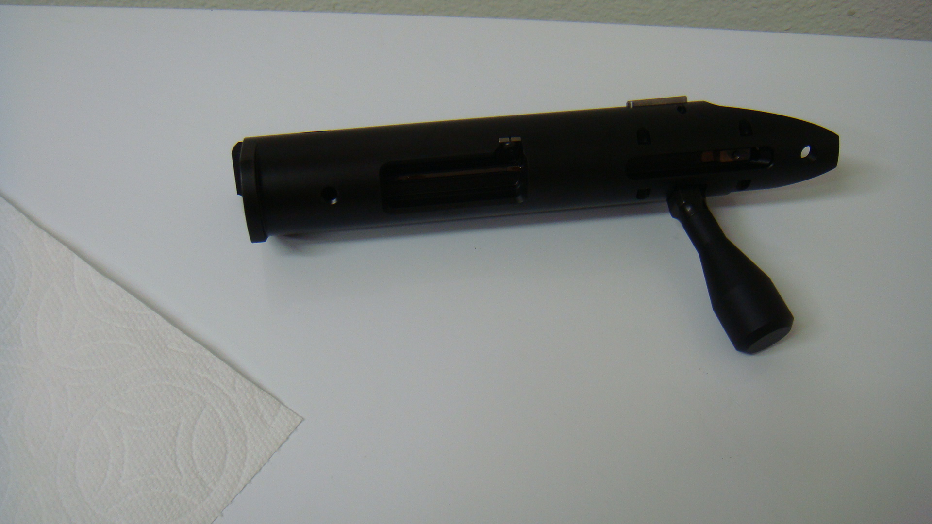

Folks, I can't believe this that i have the same problem with the above post. MY SIDE BOLT RELEASE IS NOT WORKING I TRY TO PUSH AND HOLD THE BOLT RELEASE FOR THE FIRST TIME AND NOTHING HAPPEN AT ALL. 30 OUT OF 1 THE BOLT RELEASE WORKS.AND TRY IT AGAIN THE SAME THING HAPPEN TAKE A WHILE TO PUSH AND HOLD AND IT WORKS AGAIN.I NOTICE THE back inside the action that the side spring and the push bolt release is something grabbing some metal parts from the bolt release push botton.I SEND EMAIL WITH RAY@ZERMATT with the problem just now.BECAUSE THIS IS MY 2nd action rimx and i just got it back from my dealer.
MY #00025 IS LIKE A CHARM SMOOTH BOLT ACTION EVERYTHING IS WORKING PERFECTLY. ONLY THIS ONe! btw the bolt on this one is not as smooth like butter with my other rimx action.
Maybe silly question but did try loosening the bolt release hex head screw a touch? Mine was very tight, just had to loosen it 1/4-1/2 turn
stevenc23 "IT WORKS!" THANK YOU SIR. I loosen 3/4 turn before it works like my other action. SHE IS READY .I got GM 25" that time when i order the benchmark is only go 20".so i go GM from keystone match chamber.My gm barrel had a stain like rust metal on it. Try to clean it with some stain removal and gun oil but no work.

Some of you guys just have a tight bolt release, so do I..... no reason to ge all exited. Just push a little harder on it WITHOUT any pressure from the bolt. A little lube may help too.
