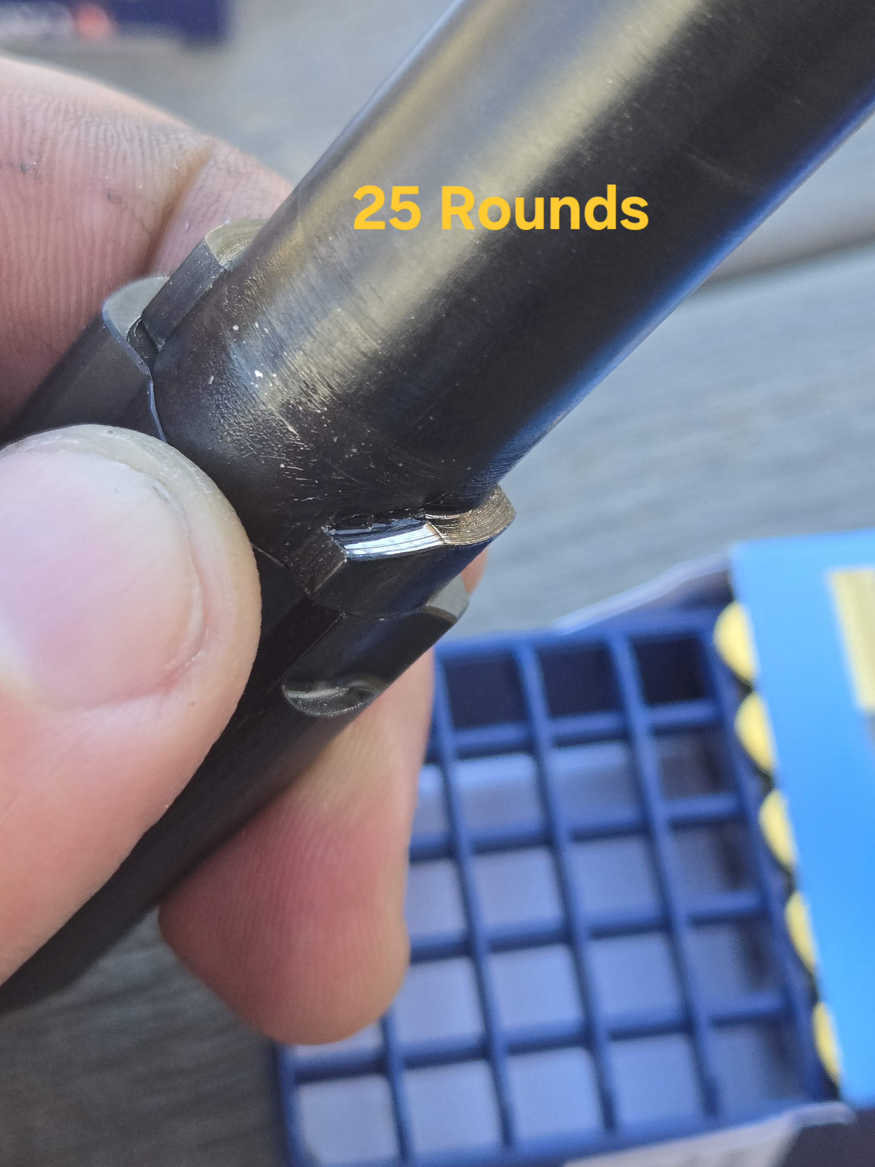

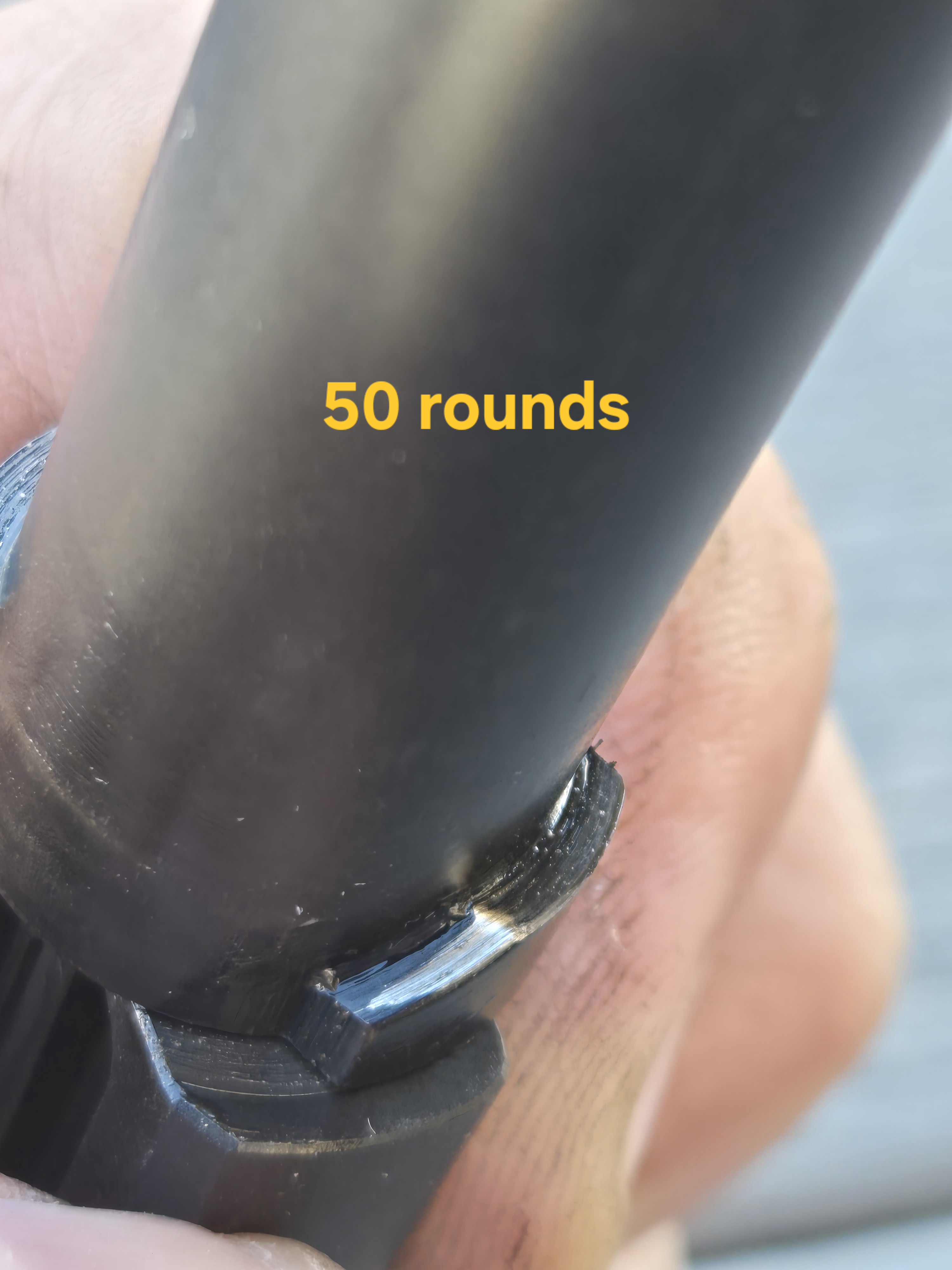

I still have not received my replacement. My flats on the lugs are nearly gone. Ray informed me they’re still working thru issues, and have halted sending out replacements.
I’m bummed.. not sure how much longer this bolt will go before losing closed tolerances. Nonetheless, it shoots amazing, and will continue to wait for the end all solution.

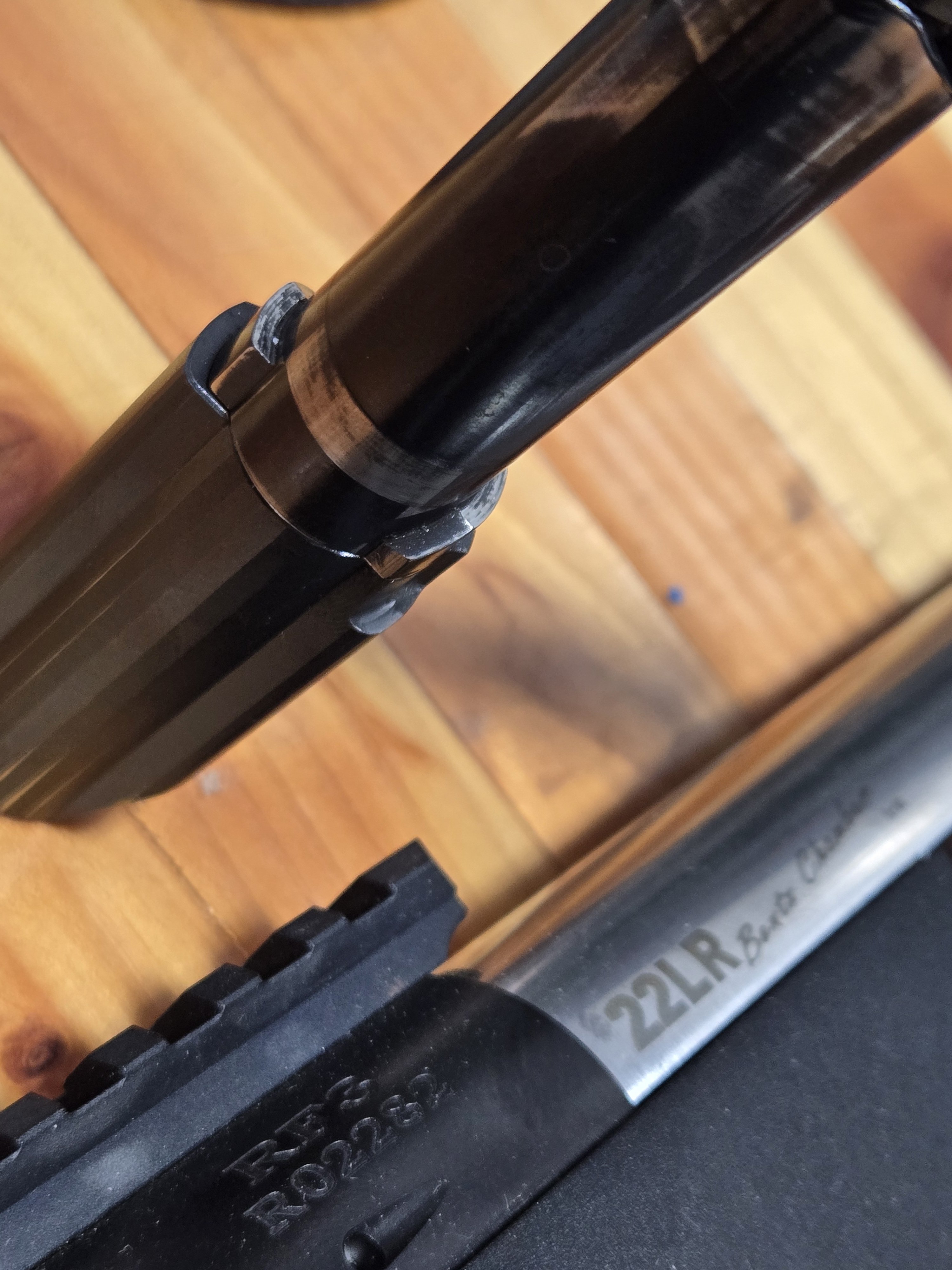

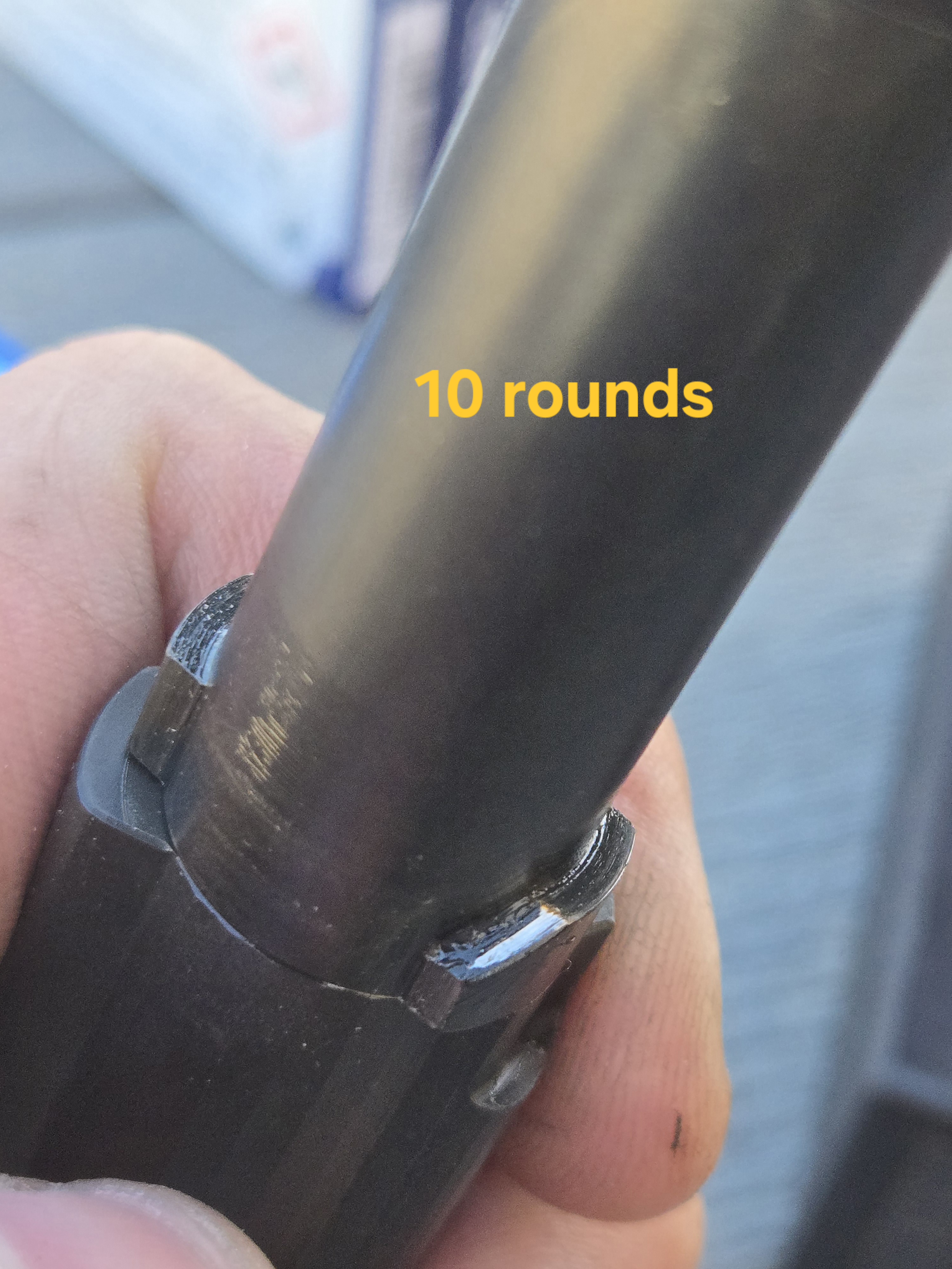

Serial #35XX
Noticed issues at 100 rounds.
Photos below as follows:
200 rounds
600 rounds
2000 rounds
(Round counts are approximate)
The flats are at they’re end…
When it cams over and the firing pin leaves the ramp, the bolt jumps back much more than as new. Maybe I got unlucky and mine is worse than others. But like I said, it shoots and cycles great…
View attachment 8658052View attachment 8658053View attachment 8658054
Thanks for the info and feedback. Glad you had documented the progression over round count.
My serial is 32xx, I have 175 rounds with no wear signs to date. Still black coating, very little wear indication. I guess I have yet to get enough cycling through. I occasionally cycle the bolt and still smooth with no wear. Lucky or just not there yet?

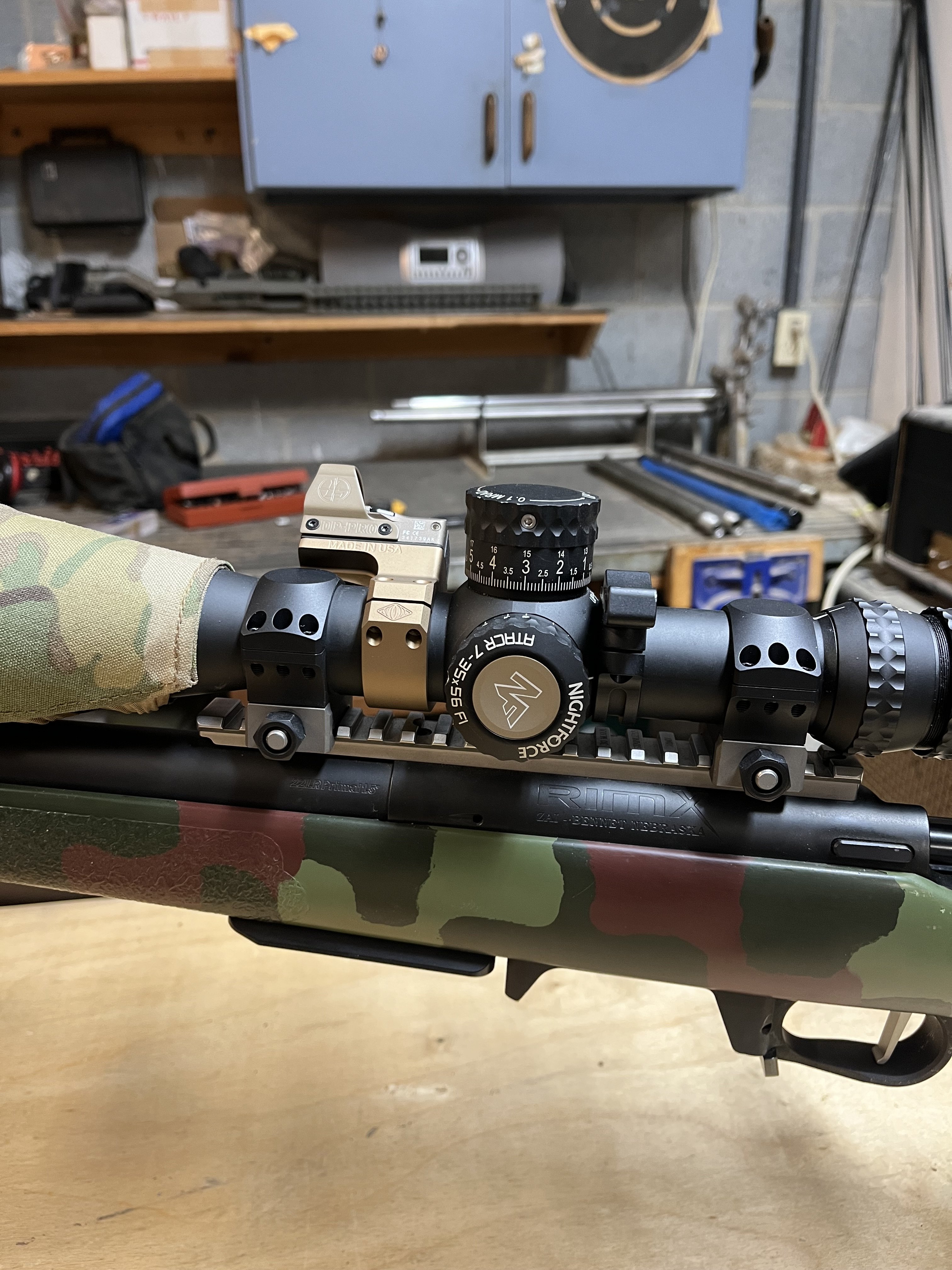

Top is #152, and below #2737, Bartlien barrels spun up by TS Customs. #152 has 18,000+ rounds fired, finishing up that 4th case. #2737, 3000+ (the ATX Anschutz 1727F has been a distraction) Never experienced the "extractor" issue. If you close the bolt with a round ahead of the bolt, you broke the extractor and you have a problem. You have to beat the bolt down over the round.........Early on jake-leg gunsmiths were causing quite a few problems, seems they could not work to the barrel print specs. Buddy of mine is getting his TS Custom Bartlien barrel next week for action #3011 he's done some dry firing with the trigger installed no visible issues. I'm confidant Zermatt will get this sorted out.
Shot #2737 at Cavalier in Virgina last weekend, bunch of RimX rifles running hard no issues. Good Shootin! See you at the range!
View attachment 8658311View attachment 8658312
Who makes that extended super rail?

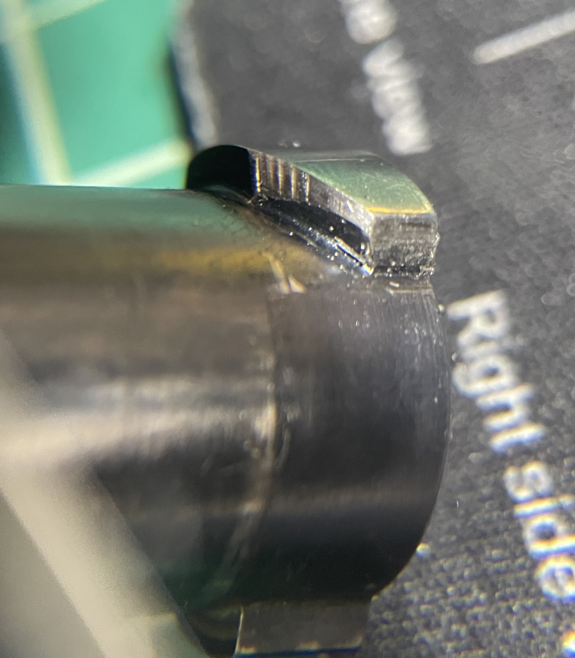

Like you said, why swap to a material that test on the HRB scale (same hardness scale as aluminum and brass) when your other actions are made with better metal.

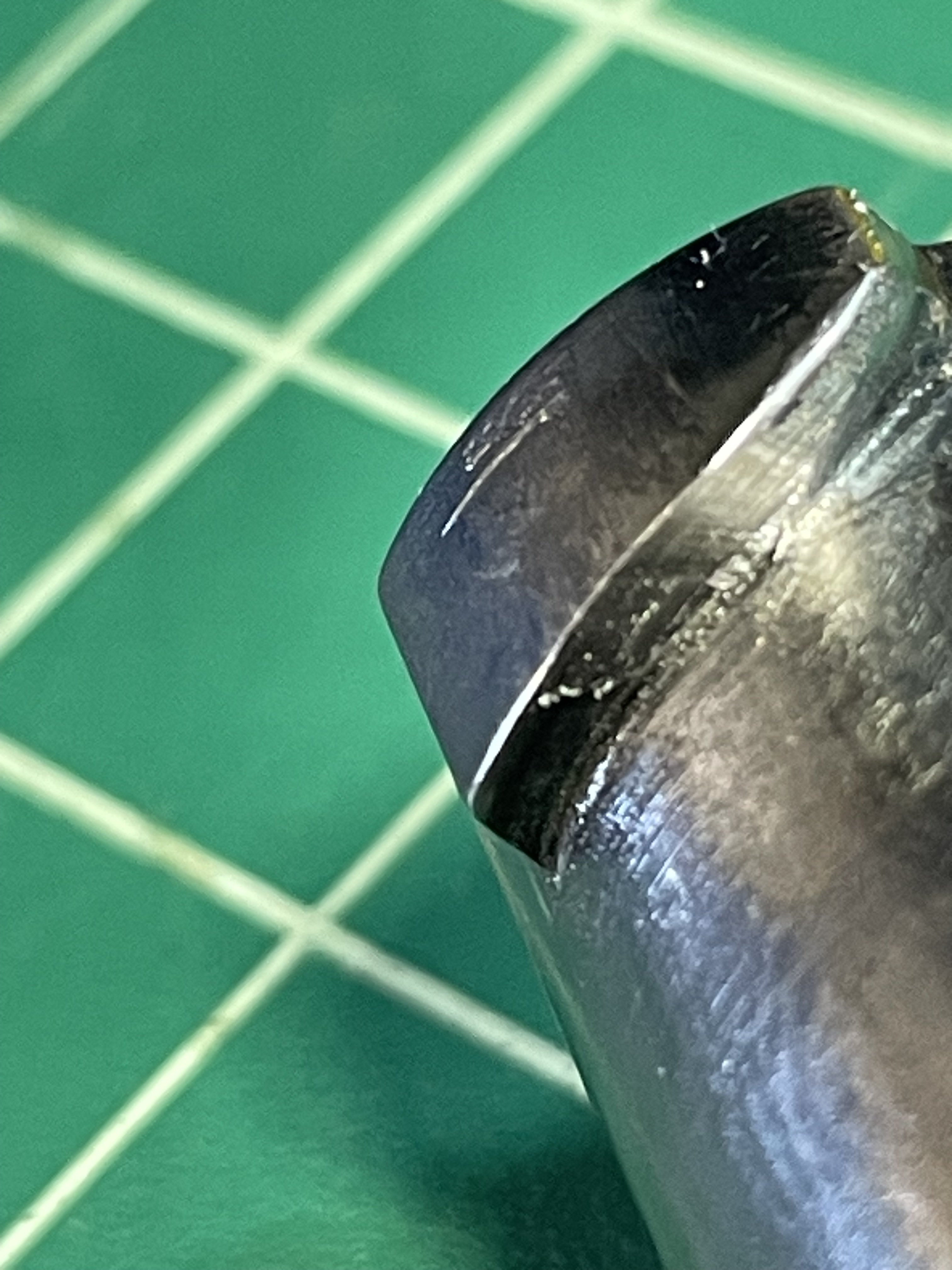

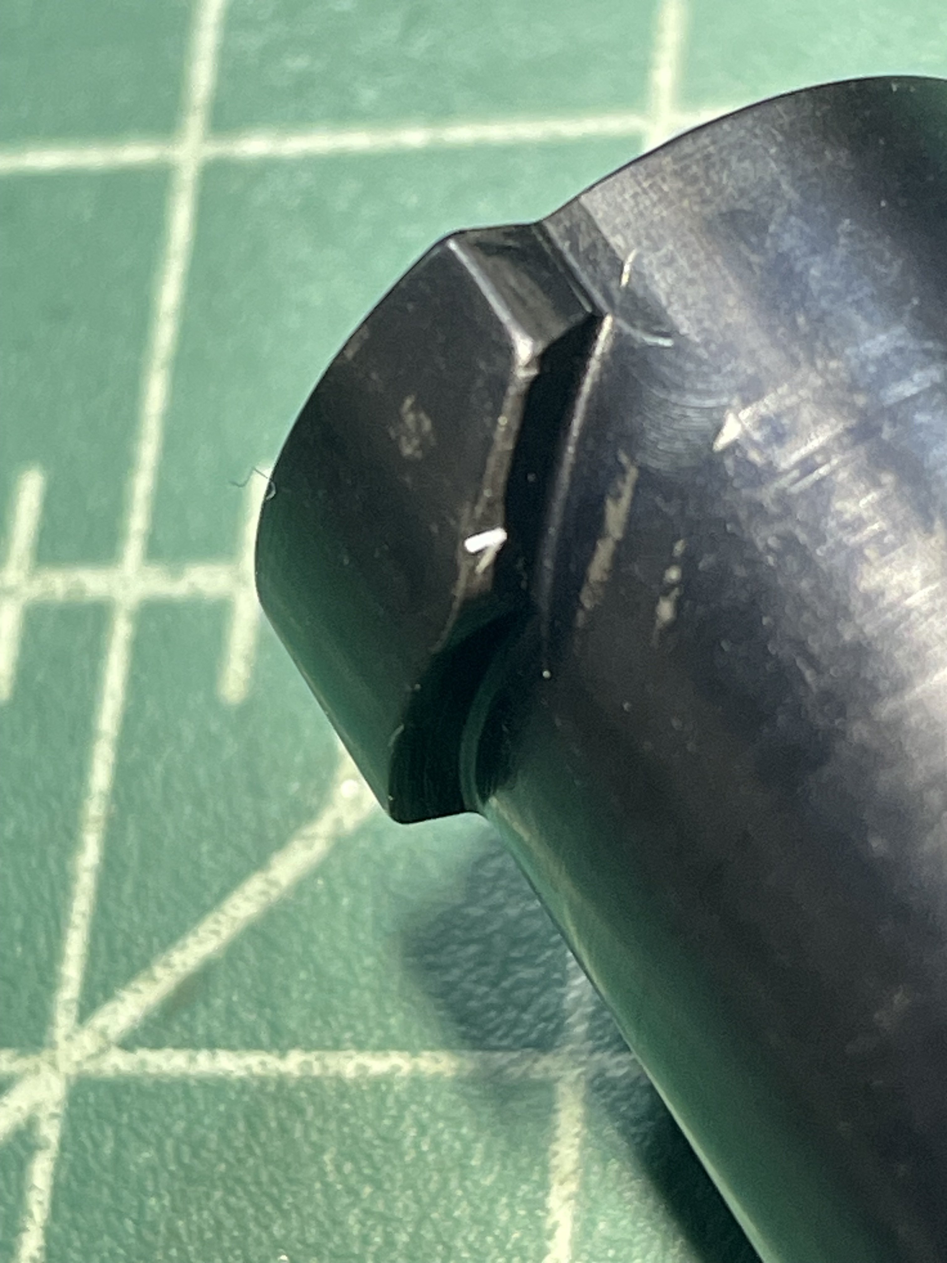

Here we have an action with well over 10K rounds... lugs looks great with full profile still and nitride still present on the lugs
Then we have the latest revisment bolts with this crap material

It's funny when you start diving into the truth and when a family buisness whos is aerospace manufacturing uses the same suppliers. Called the metal supplier Niagara LaSalle steel... from the looks of it, the new material is half the cost, easier to machine to hold tolerance and more readily available.
Then we have the latest revisment bolts with this crap materialView attachment 8660945
View attachment 8660946View attachment 8660949
