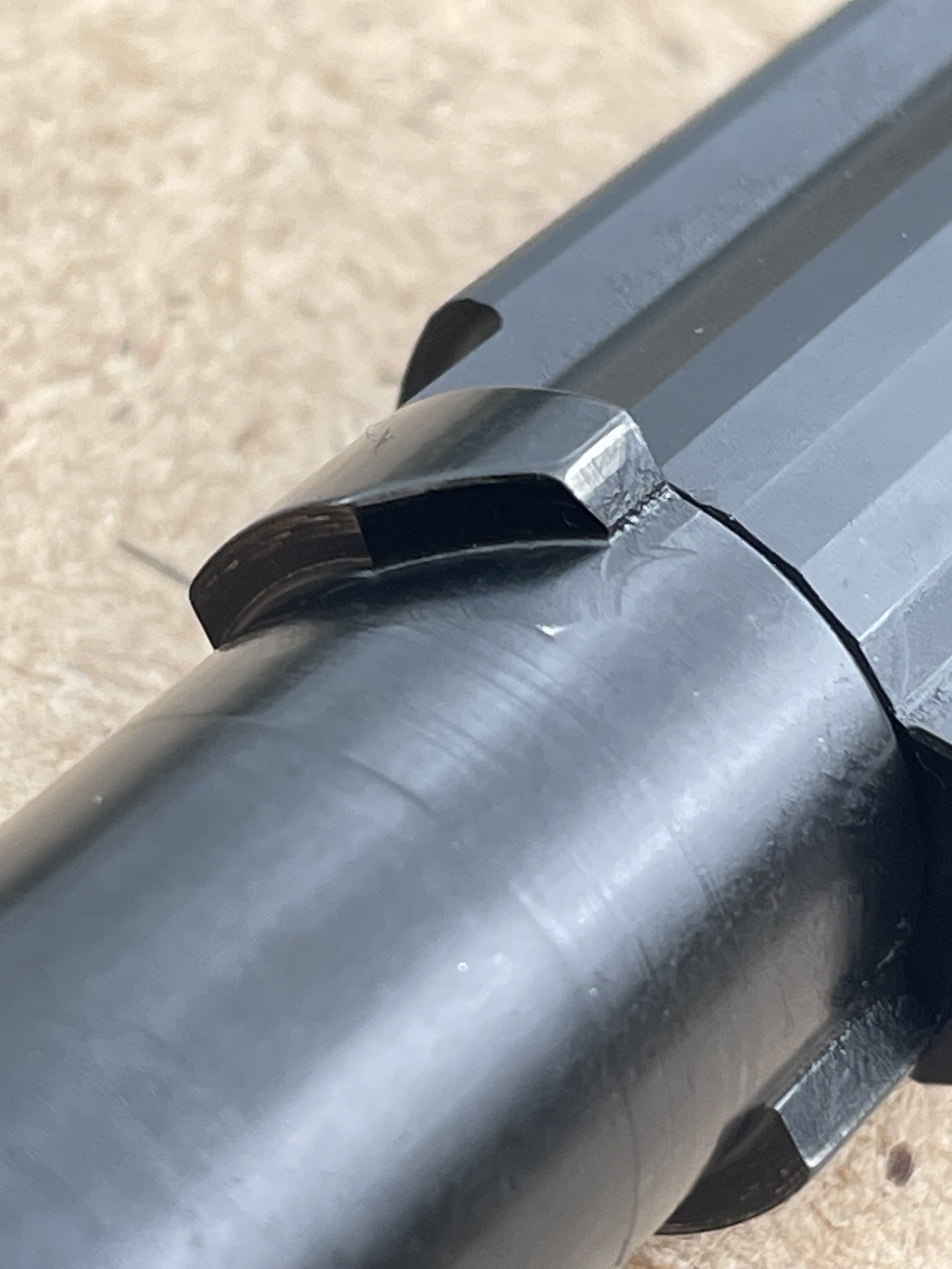

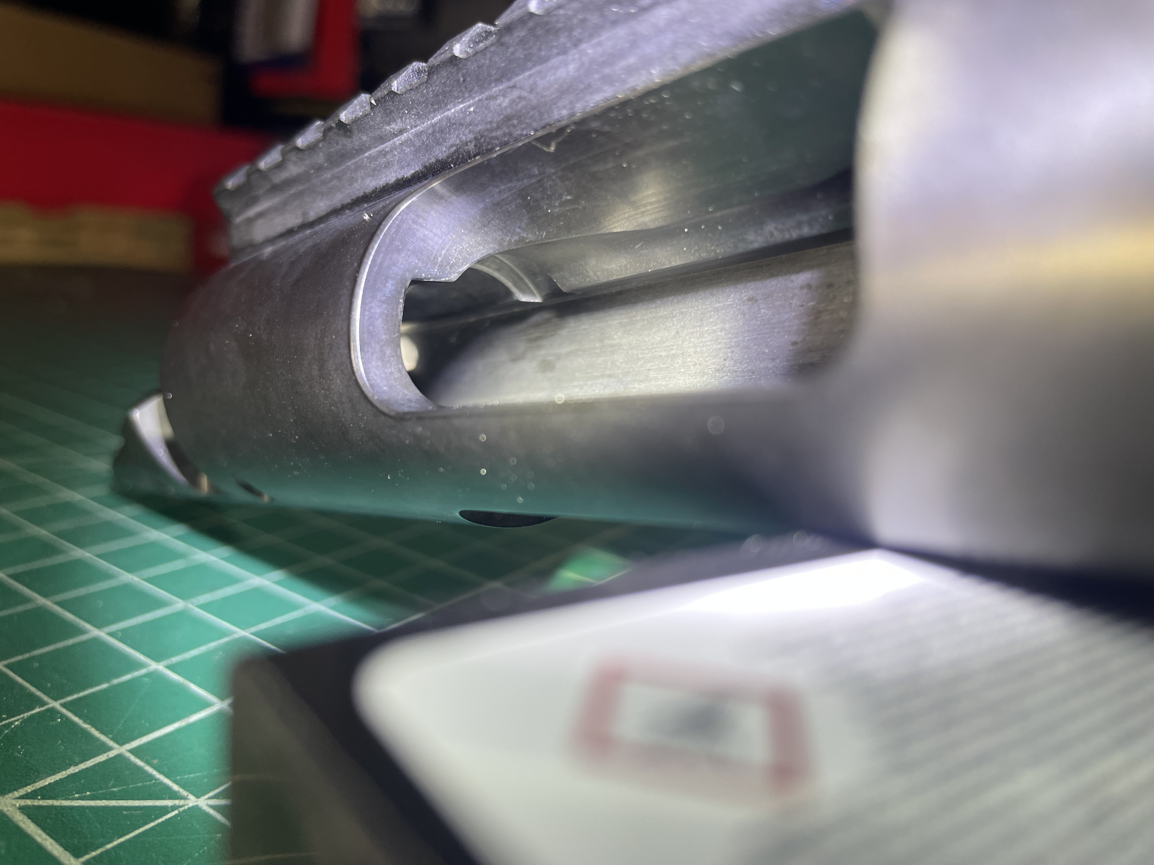

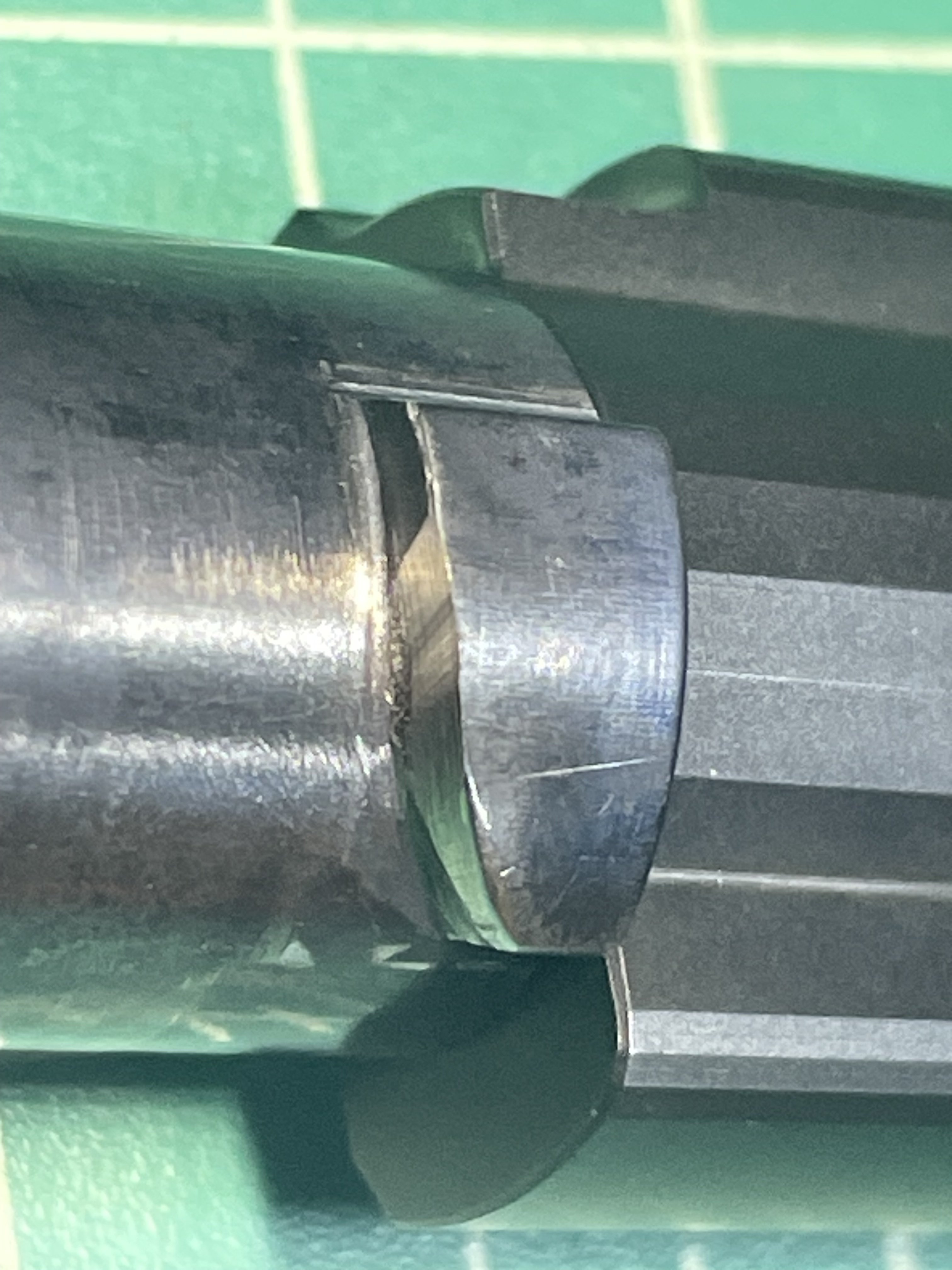

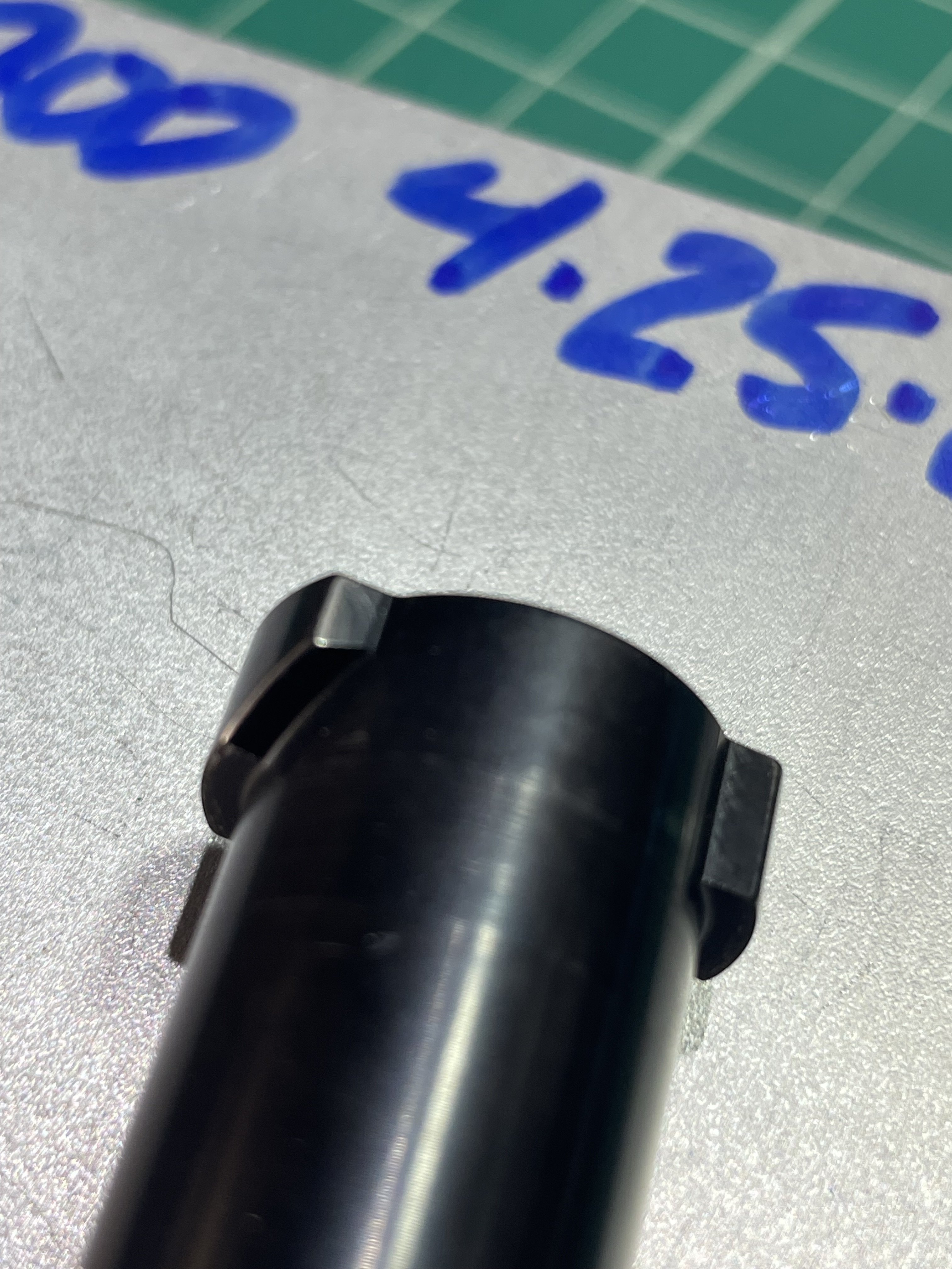

Just an FYI...

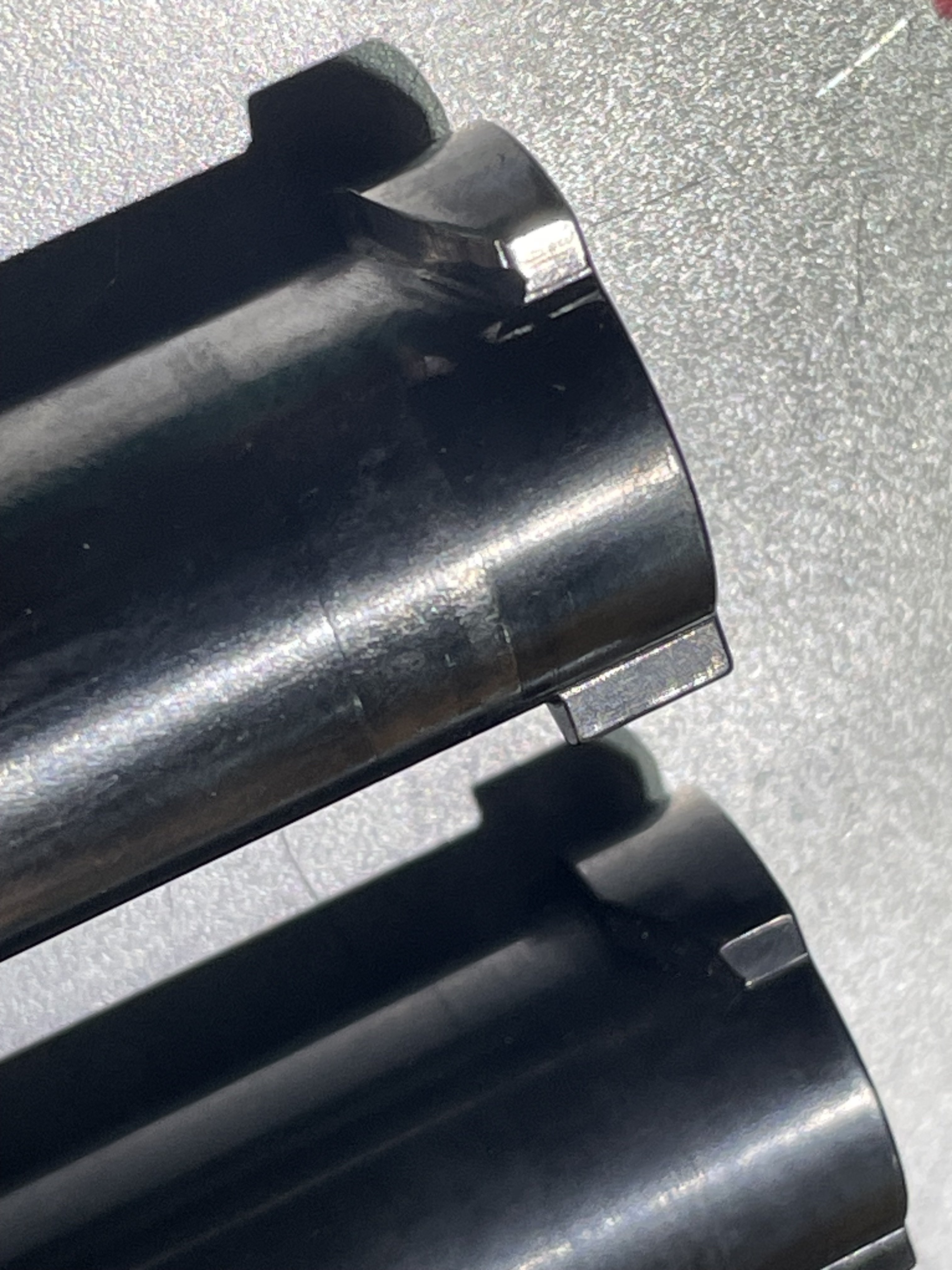

I just got my replacement bolt parts from Zermatt today. I have a 35XX serial # that was galling right away on the bolt. Zermatt said parts were arriving this week. I haven't installed it yet, but I should know soon if this fixes the issue.
Mine shows up tomorrow. Also serial 35XX.
Going to run it Friday and Sunday and get at least 1000 thru it.
Just an FYI...
That’s interesting both in the 35xx range and it happened. Did it start right away. I’m in the same range and prob have 500 rounds on it. It just looks like normal wear in. It’s good to know Zermatt is taking care of it.
Started instantly.
At 200 rounds it was very noticeable.
At 3000 it let go completely, and dropped the firing pin 50% of the time.
I documented round count vs wear, it’s posted thought out this thread.
I intend to do the same with this bolt body.
Zermatt has been good. Although waiting was a bummer, I’m hopeful this is the end all solution.
Receiver cleaned to the bone, and ready for a fresh insertion.
Started instantly.
View attachment 8671269View attachment 8671270
Where was the wear coming from did they say?

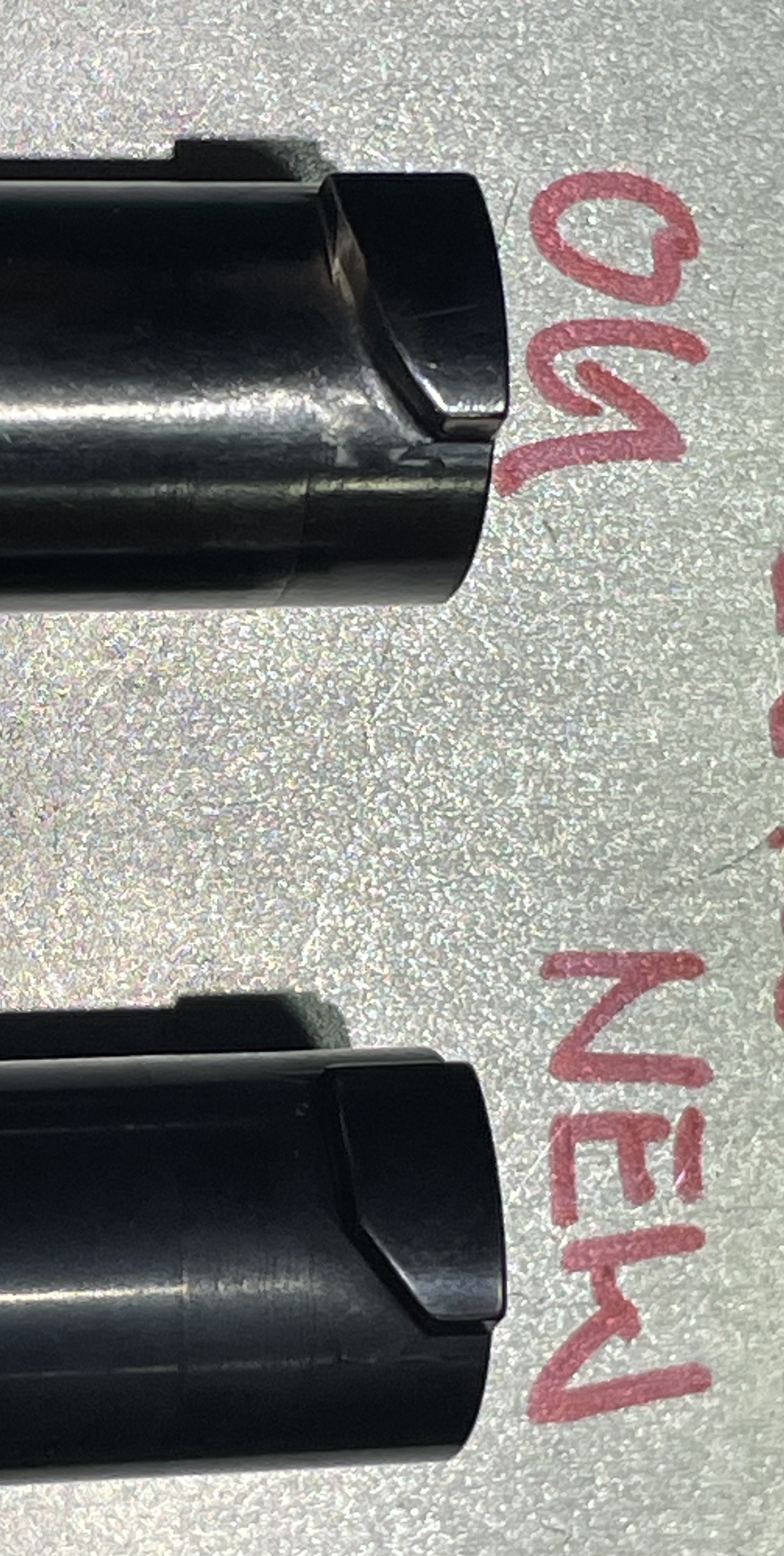

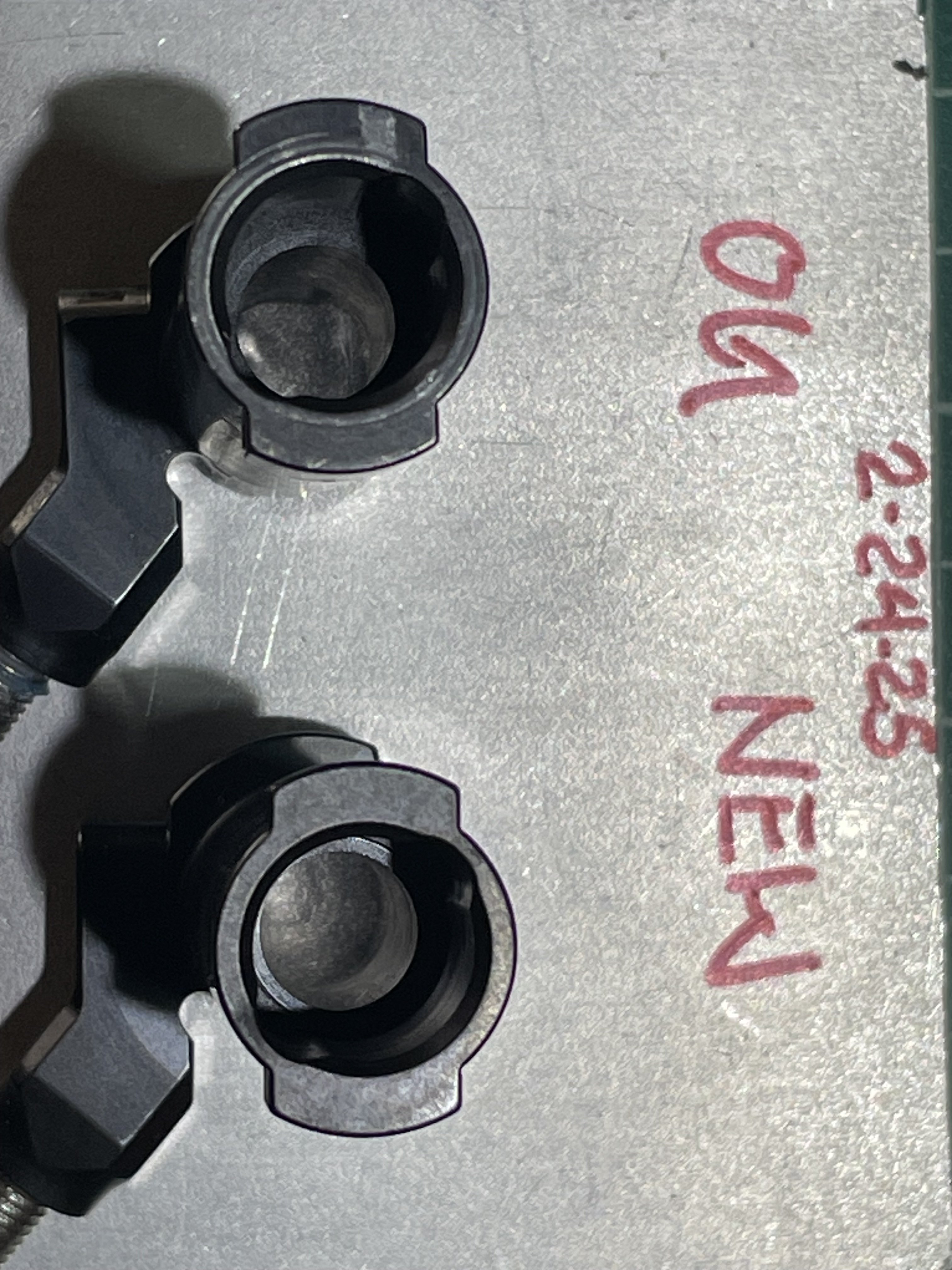

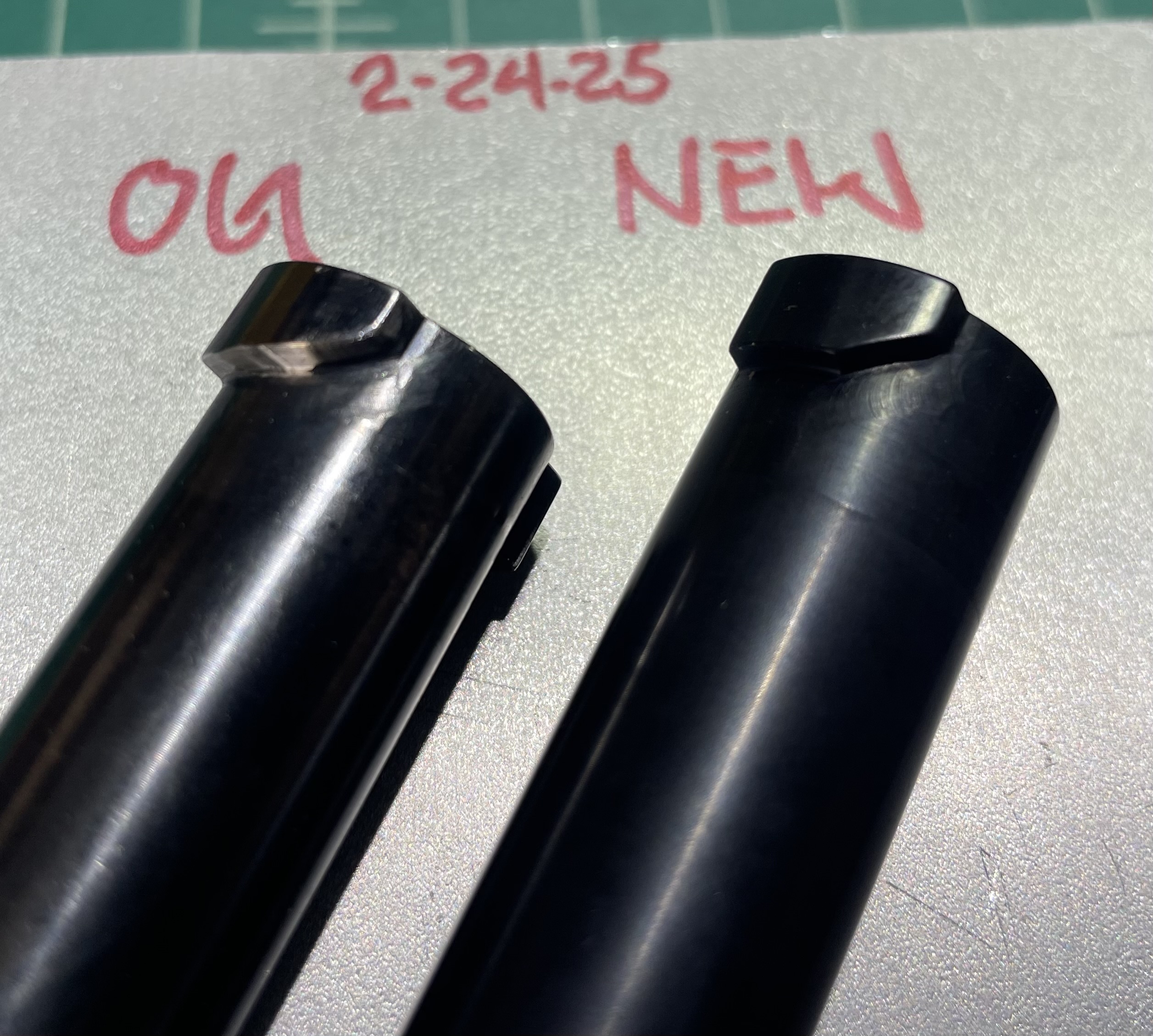

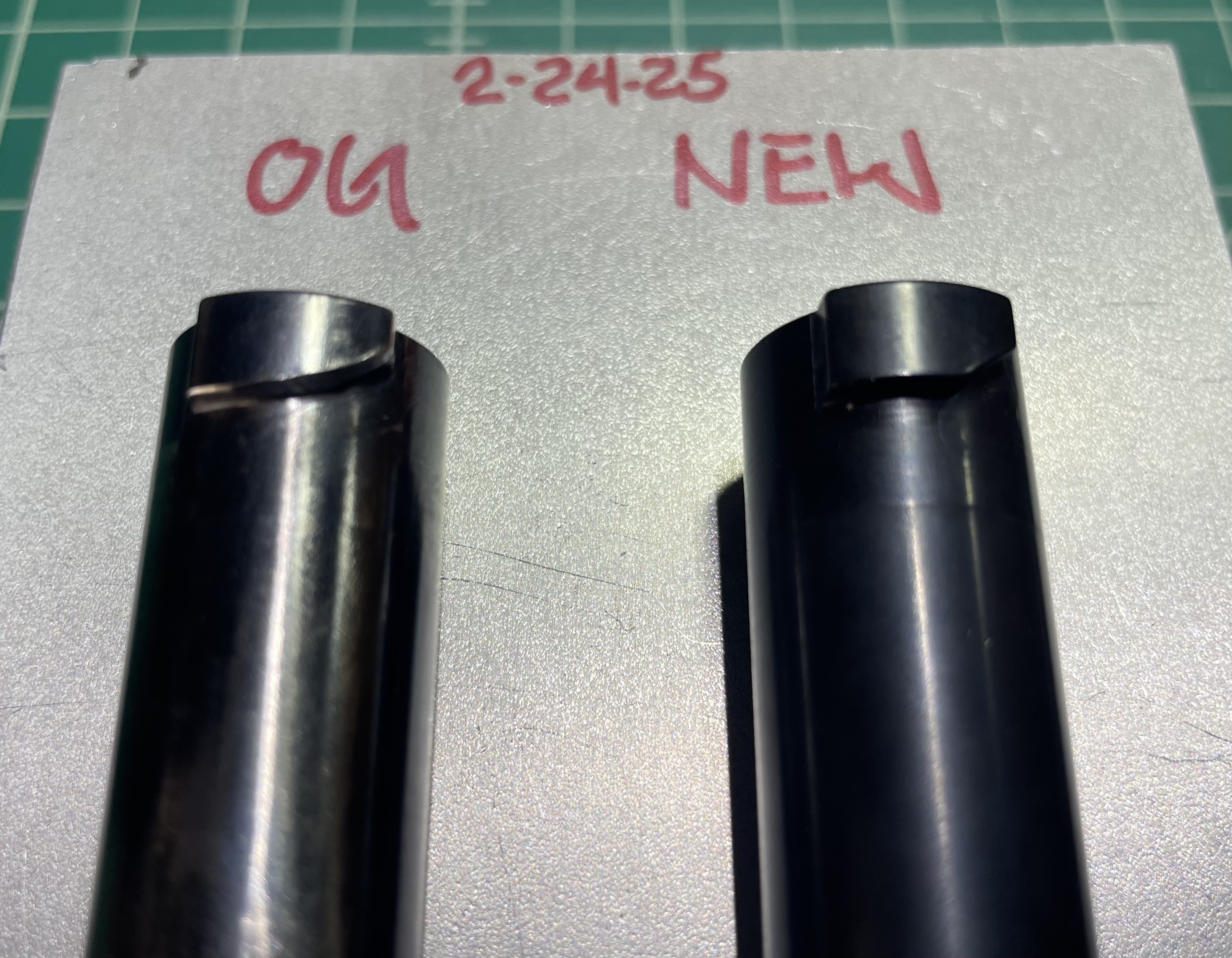

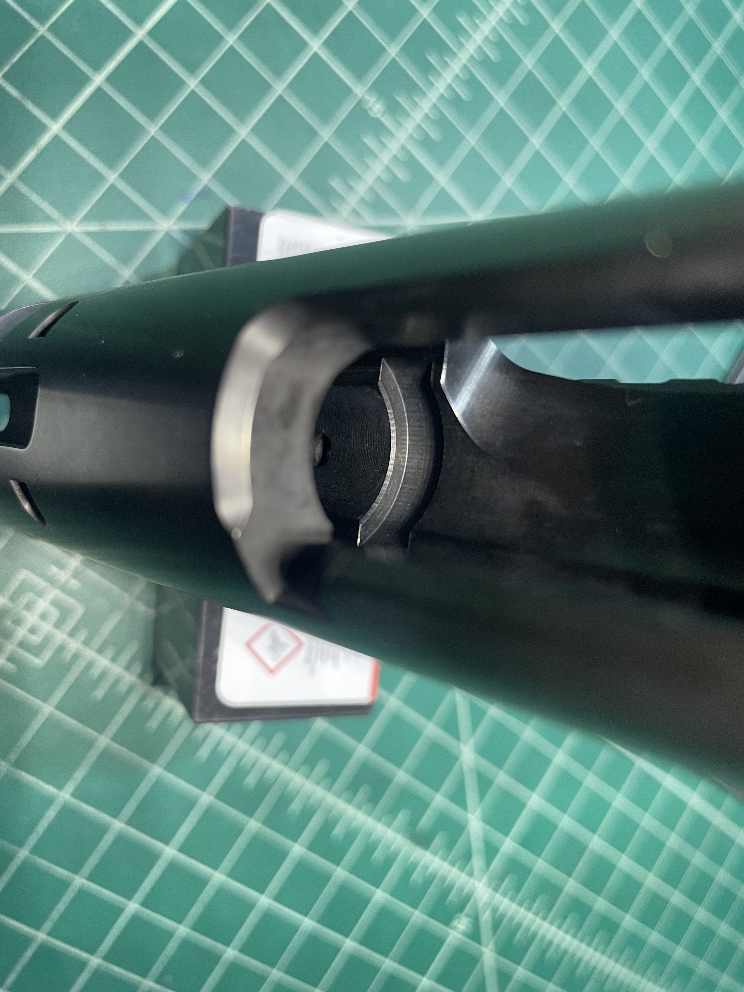

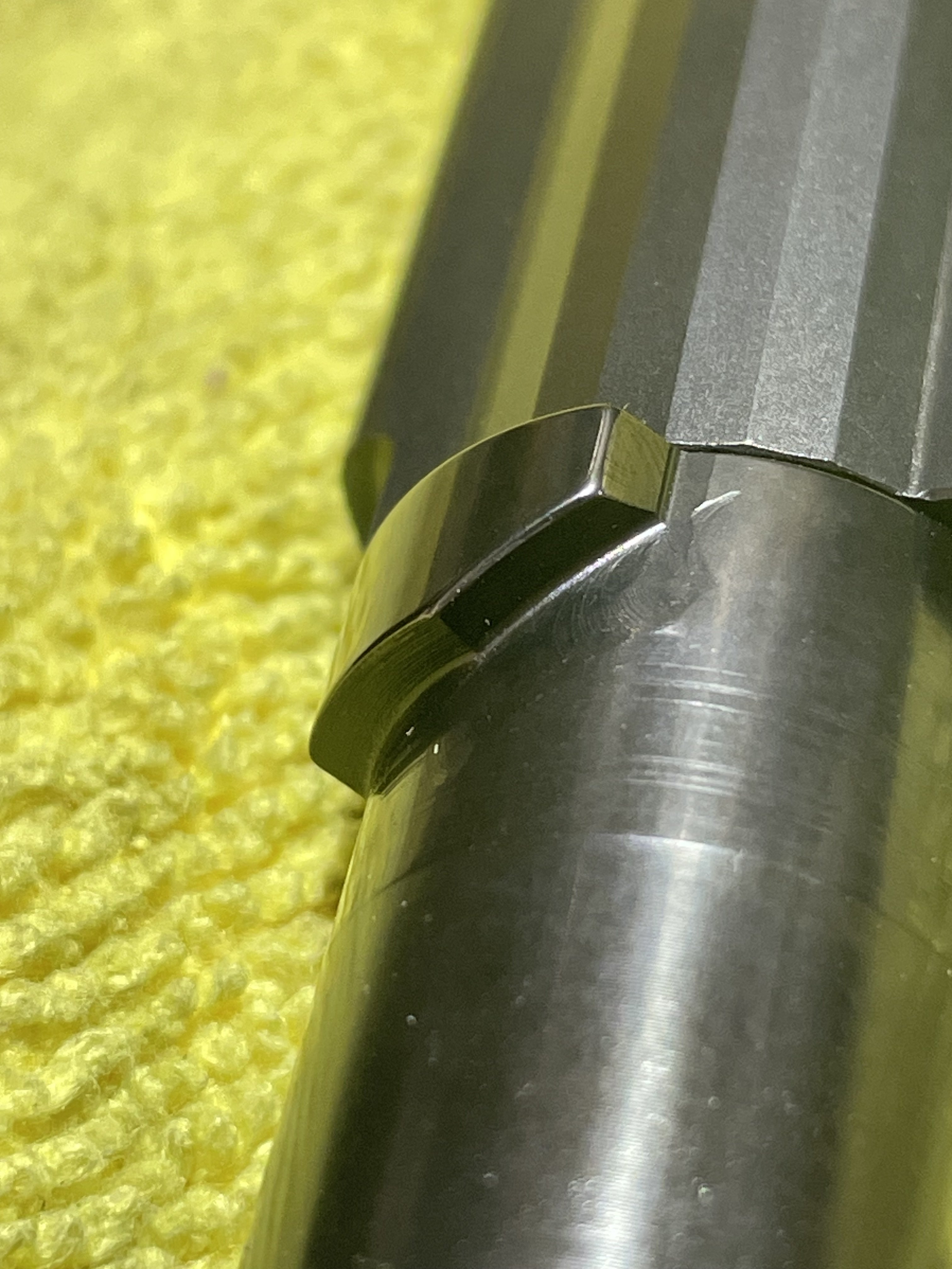

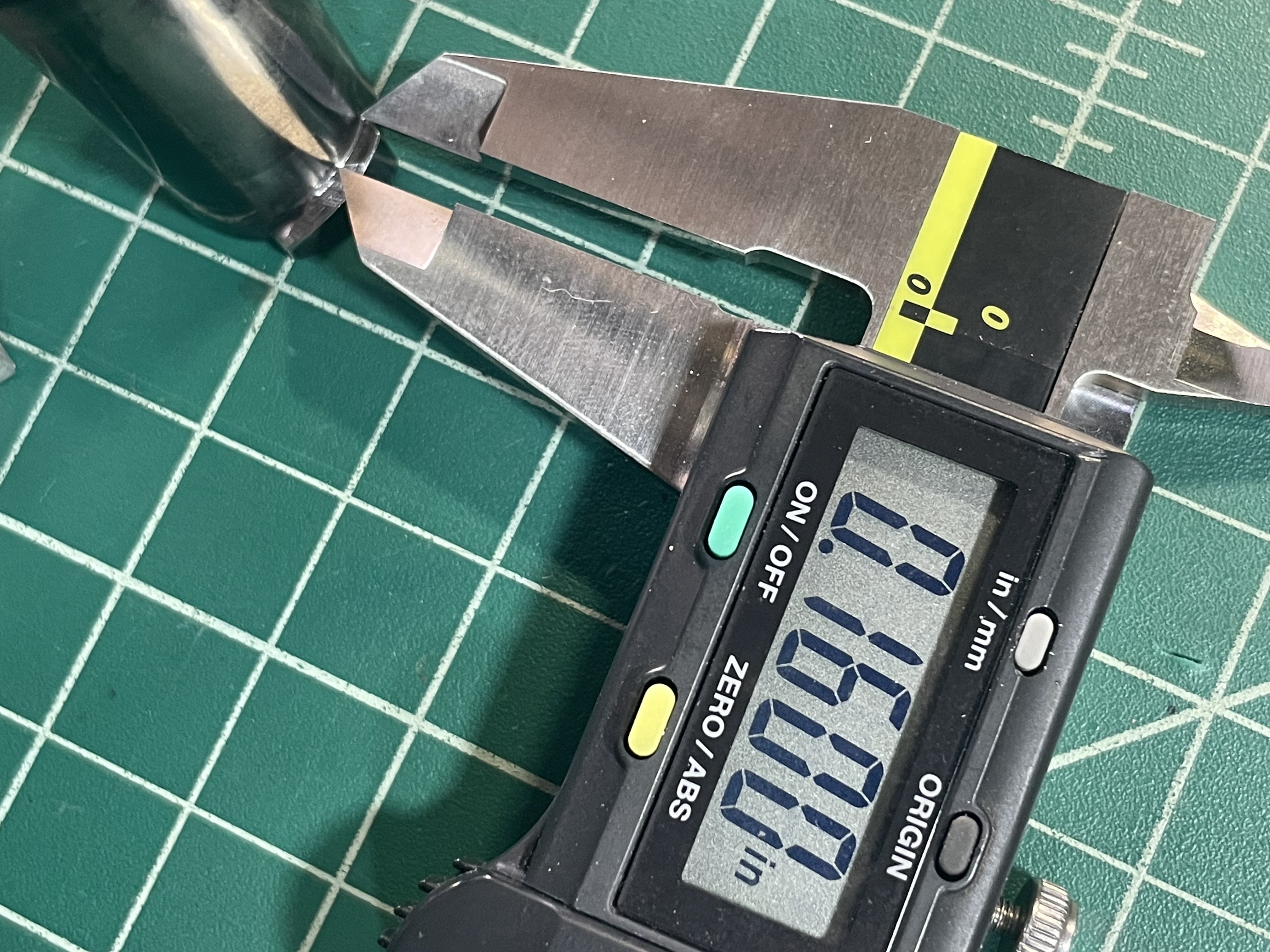

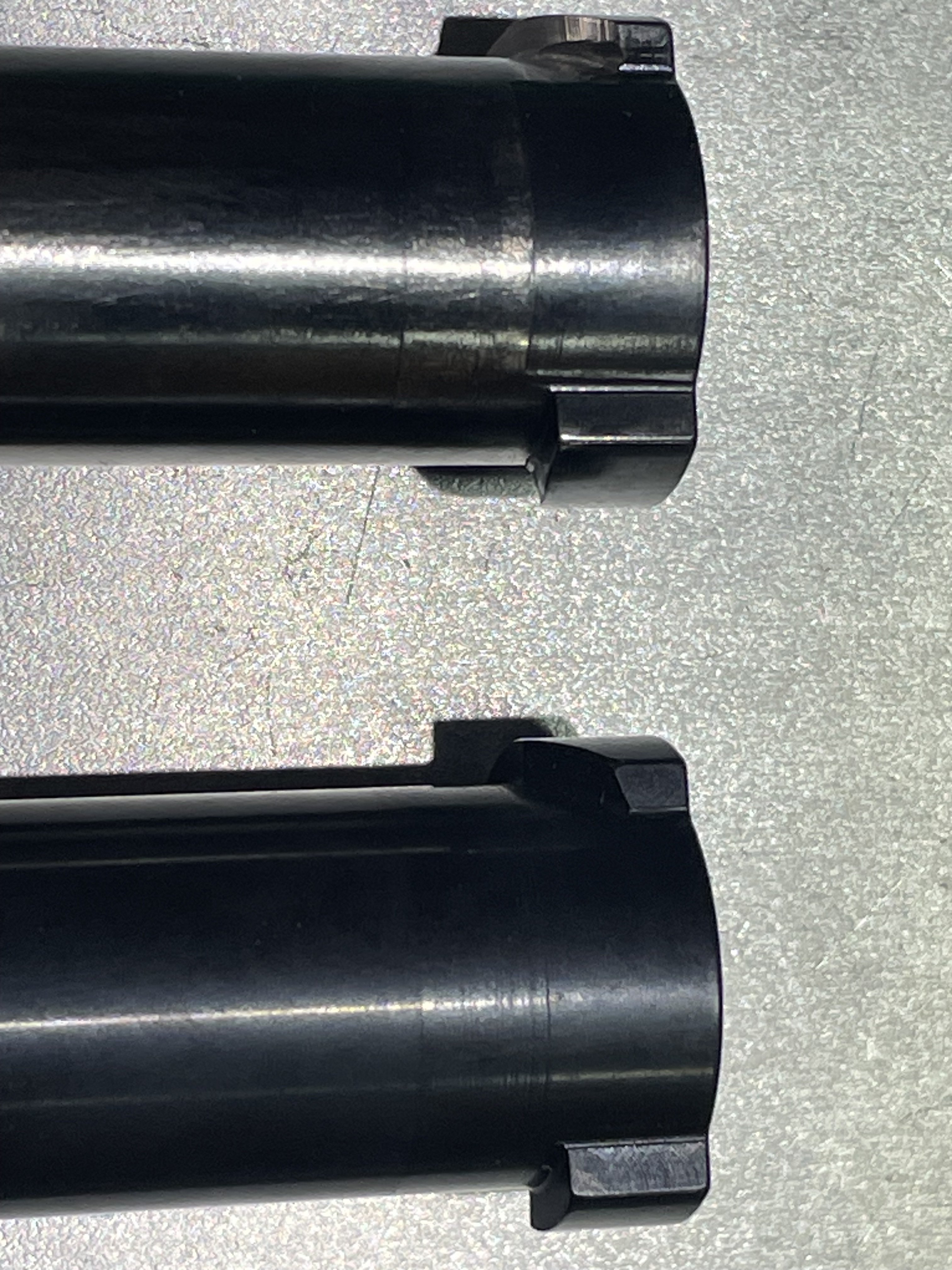

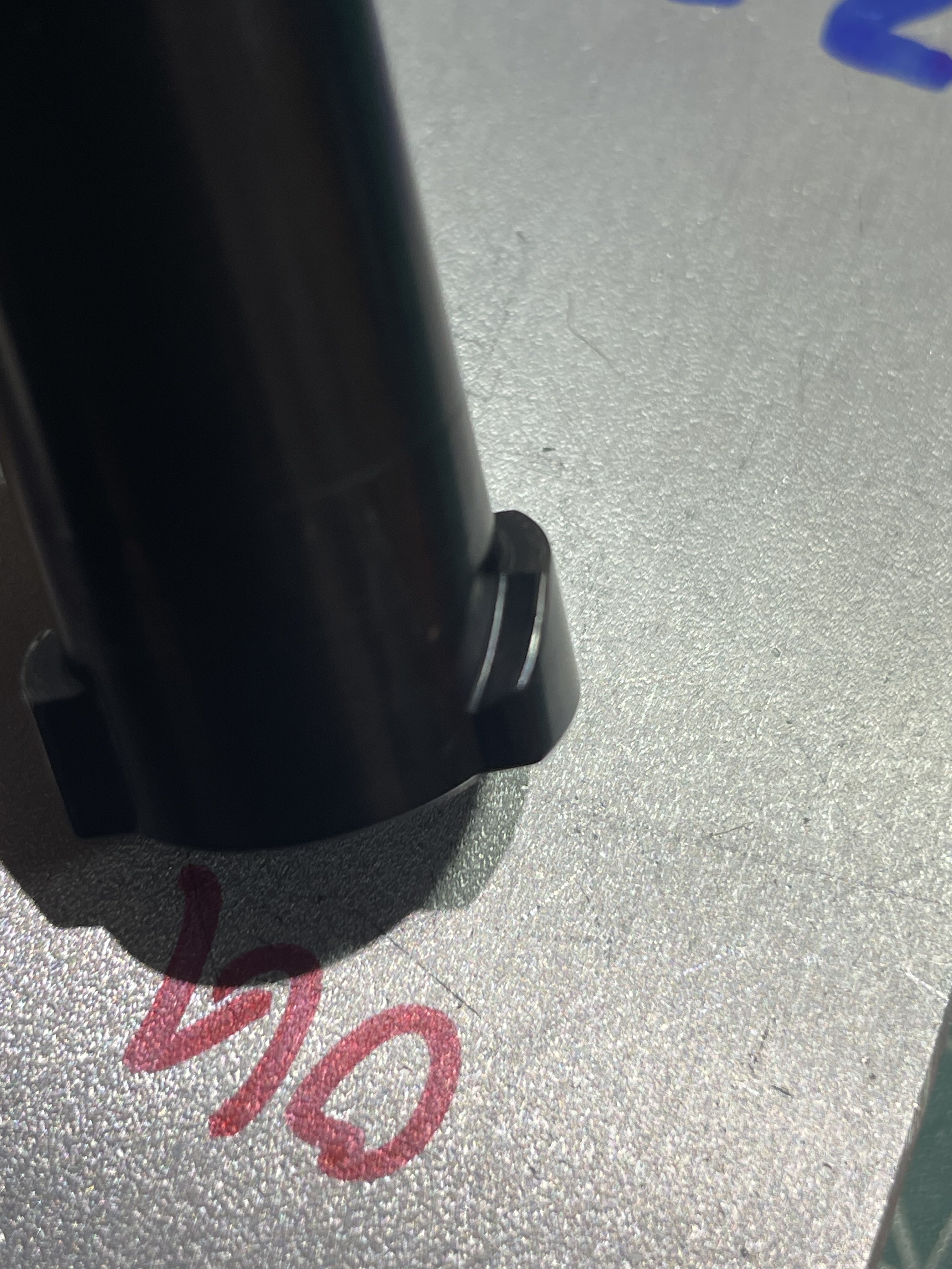

Bolt body arrived today.
Photos for reference.
NOTE: date in photo is wrong! (Got excited!)
OG vs. New:
100 cycles of 50 lives and 50 dries. (Approx.)
So far I can’t get it to stick. Which is a good sign. Don’t feel like the same gun. Shit is glass like and slick AF.
Will have ~500 rounds thru it noon tomorrow.
OG vs. New:
View attachment 8672174View attachment 8672175View attachment 8672176View attachment 8672177View attachment 8672178View attachment 8672179
I haven't shot it yet, but agreed. The action feels completely different now. Mine was galling and gritty out of the box with the old bolt nose. The new bolt nose makes the action feel slick like it should.
OG vs. New:
Keep us updated

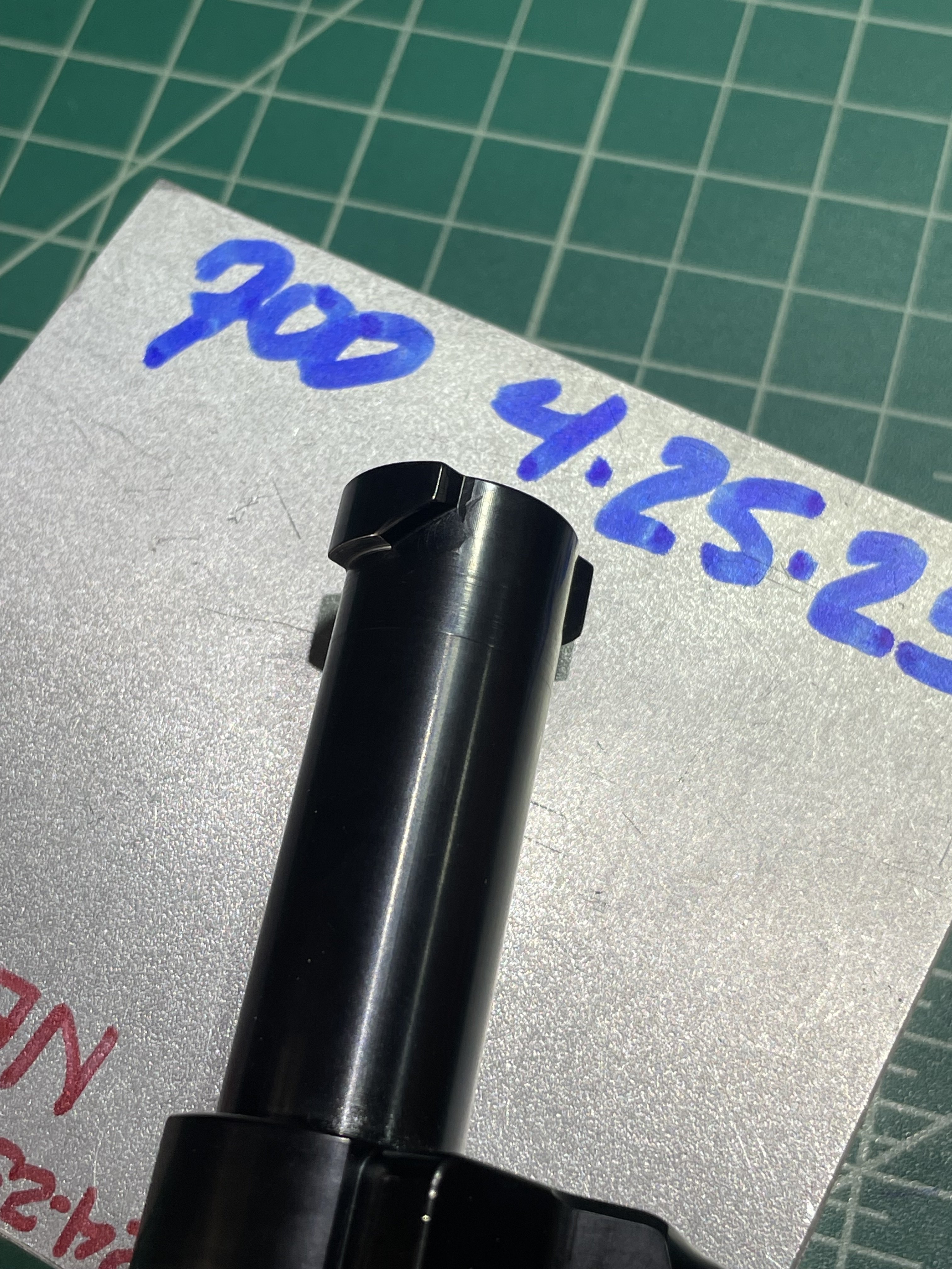

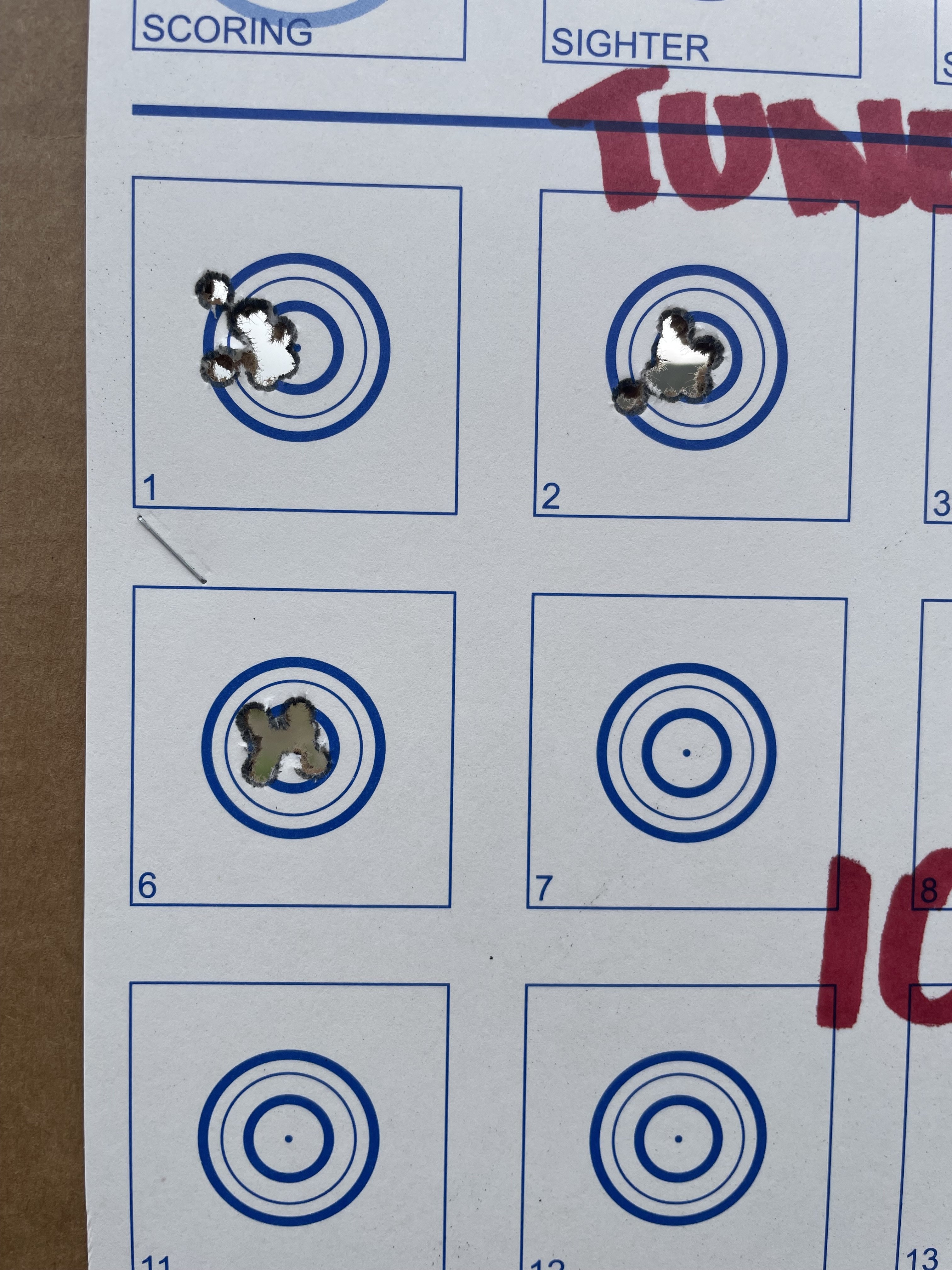

Short update:
700 rounds on new bolt.
Zero wear, even finish looks great.
Long Update:
Bolt now has 700 rounds, and is showing no wear. The original was severely gouged at 200 (check my posts some pages back). My gut says the issue is resolved. It’s very obvious from the very first time you manipulate the bolt, that something is different. It’s very slick, close and open are smooth. Firing pin stays put when closing the bolt. I now understand what an alpha action should feel like.
Yes it sucked waiting.. But what I can say is Ray kept cool. Always replied to emails. Answered any question along the way, and ultimately delivered.
No, I don’t know what changed.. Honestly don’t care at this point. My focus was a solution, and that comes best from the industry professionals.
I will remain confident that the issue is solved unless witnessed otherwise.

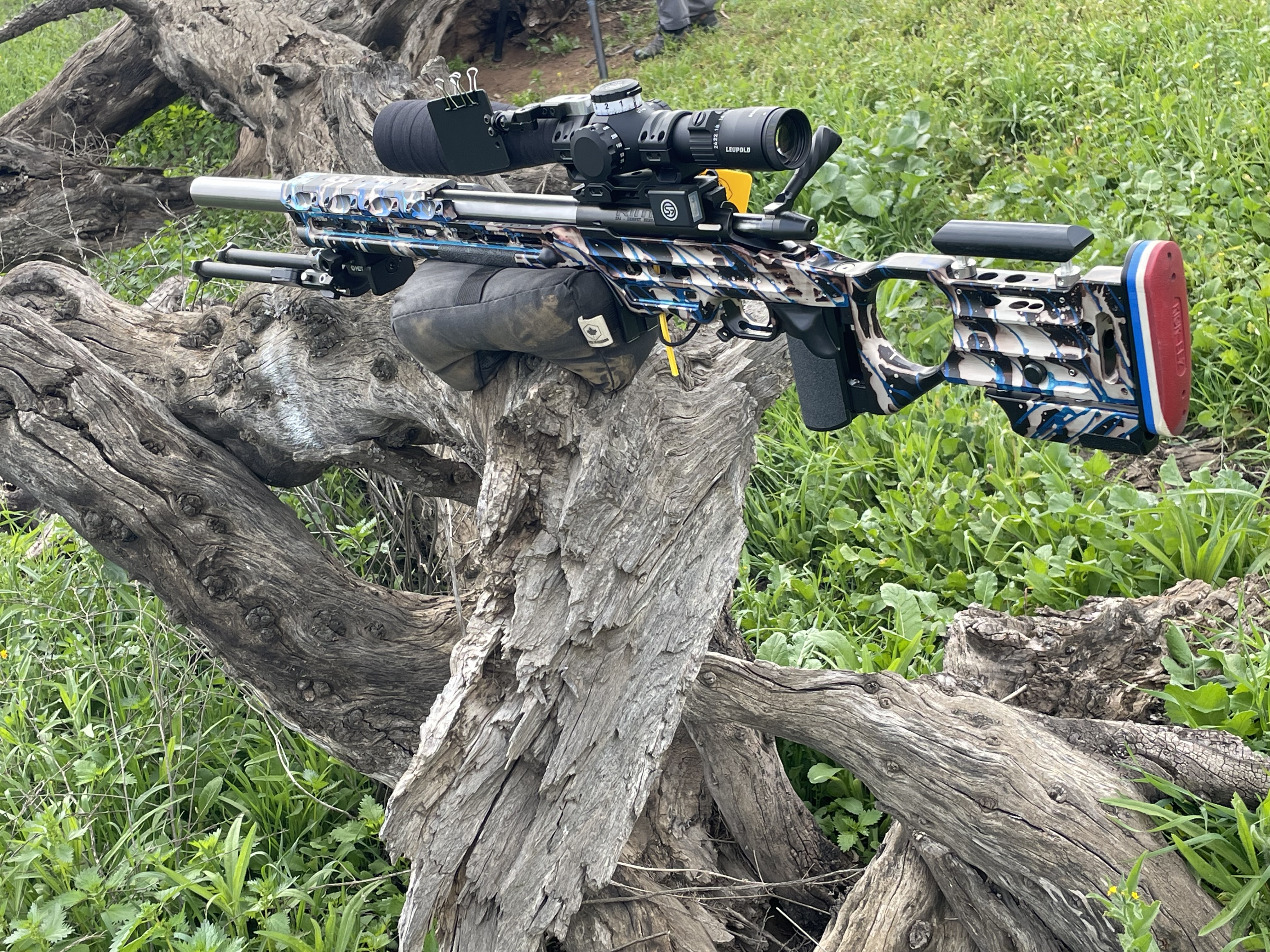

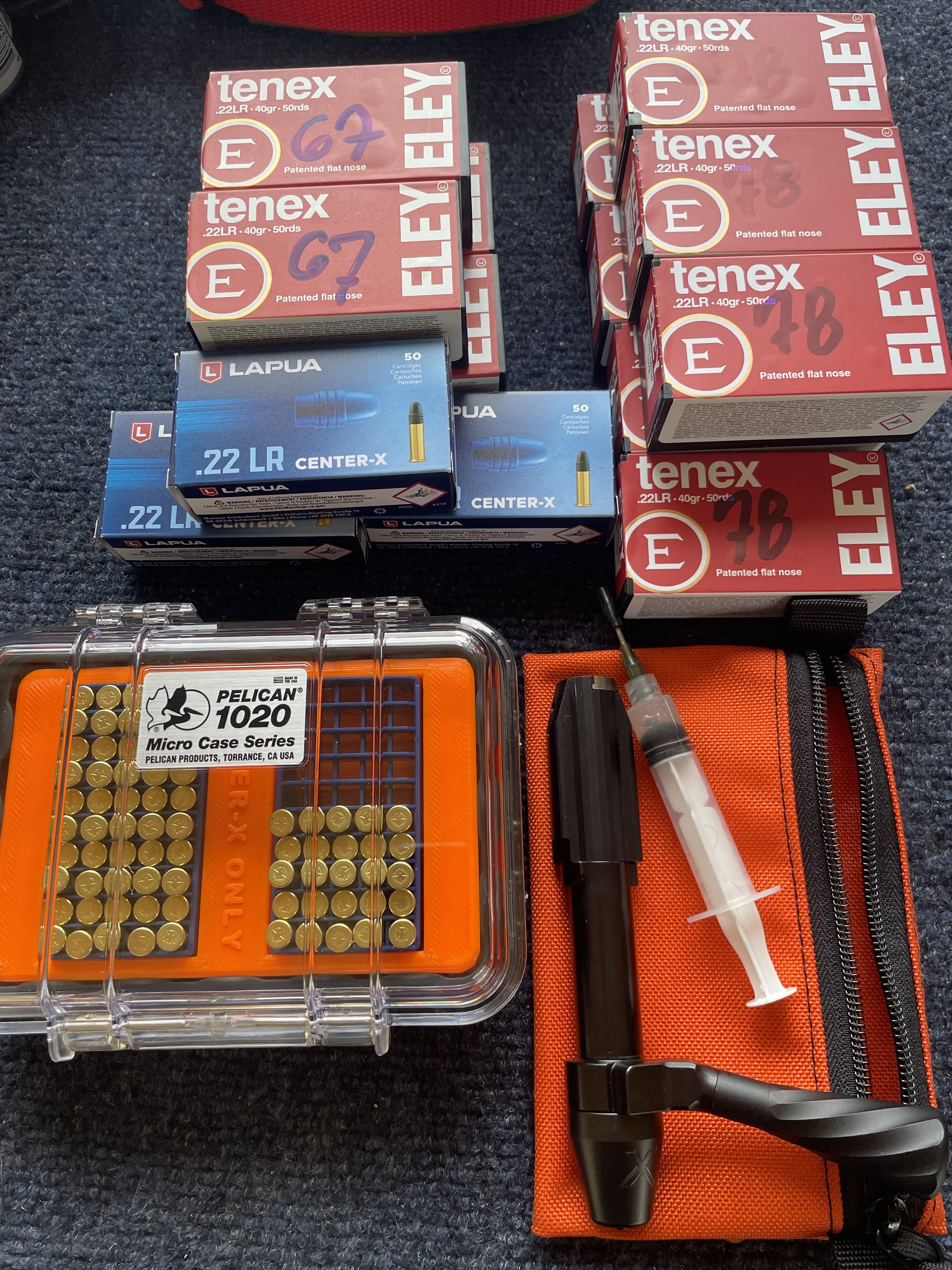

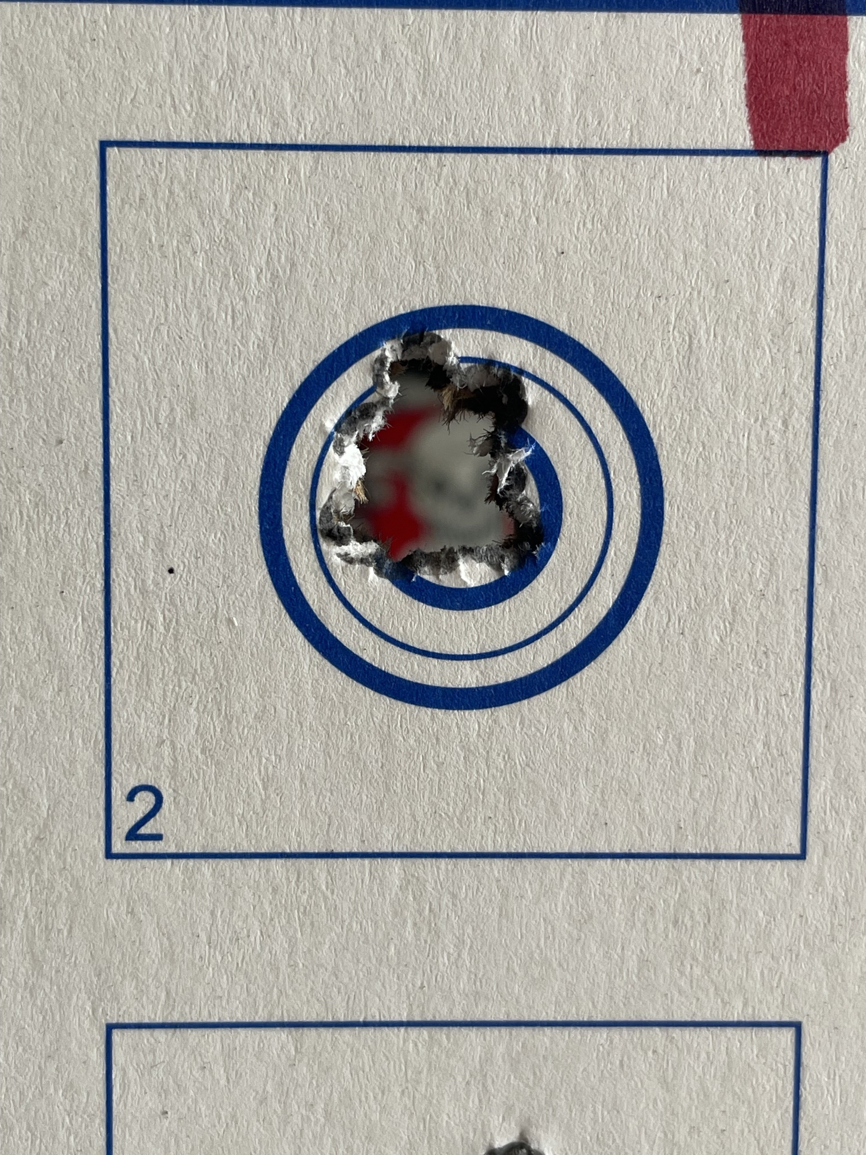

Some gun porn:
Mostly 10 shot or more groups at 50.
Various Tenex and CX lots.
Grouped first thing on clean barrel, then end of session.
Tuner only there for forward weight.
Short update:
View attachment 8672934View attachment 8672935View attachment 8672936
Long Update:
Some gun porn:

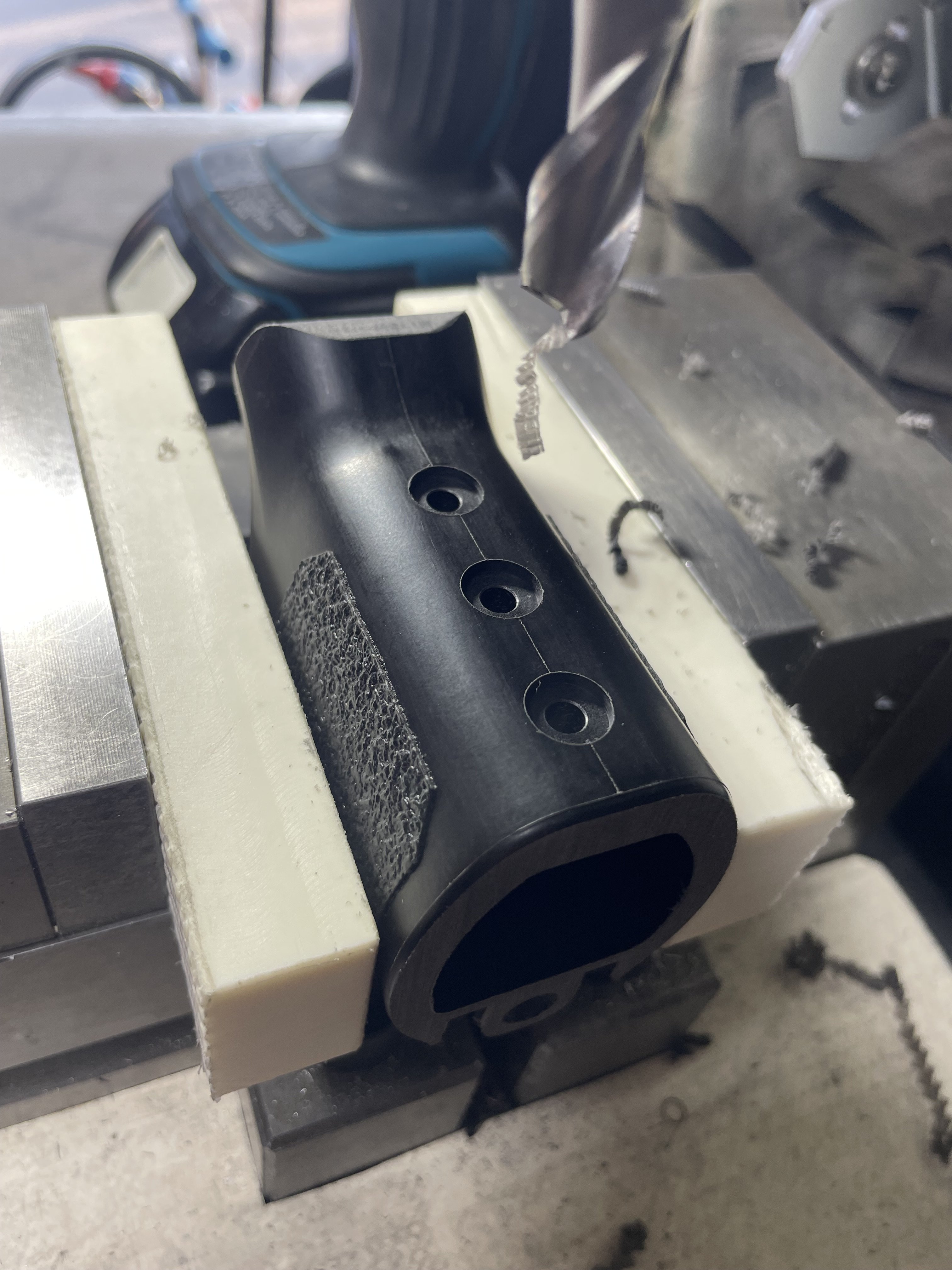

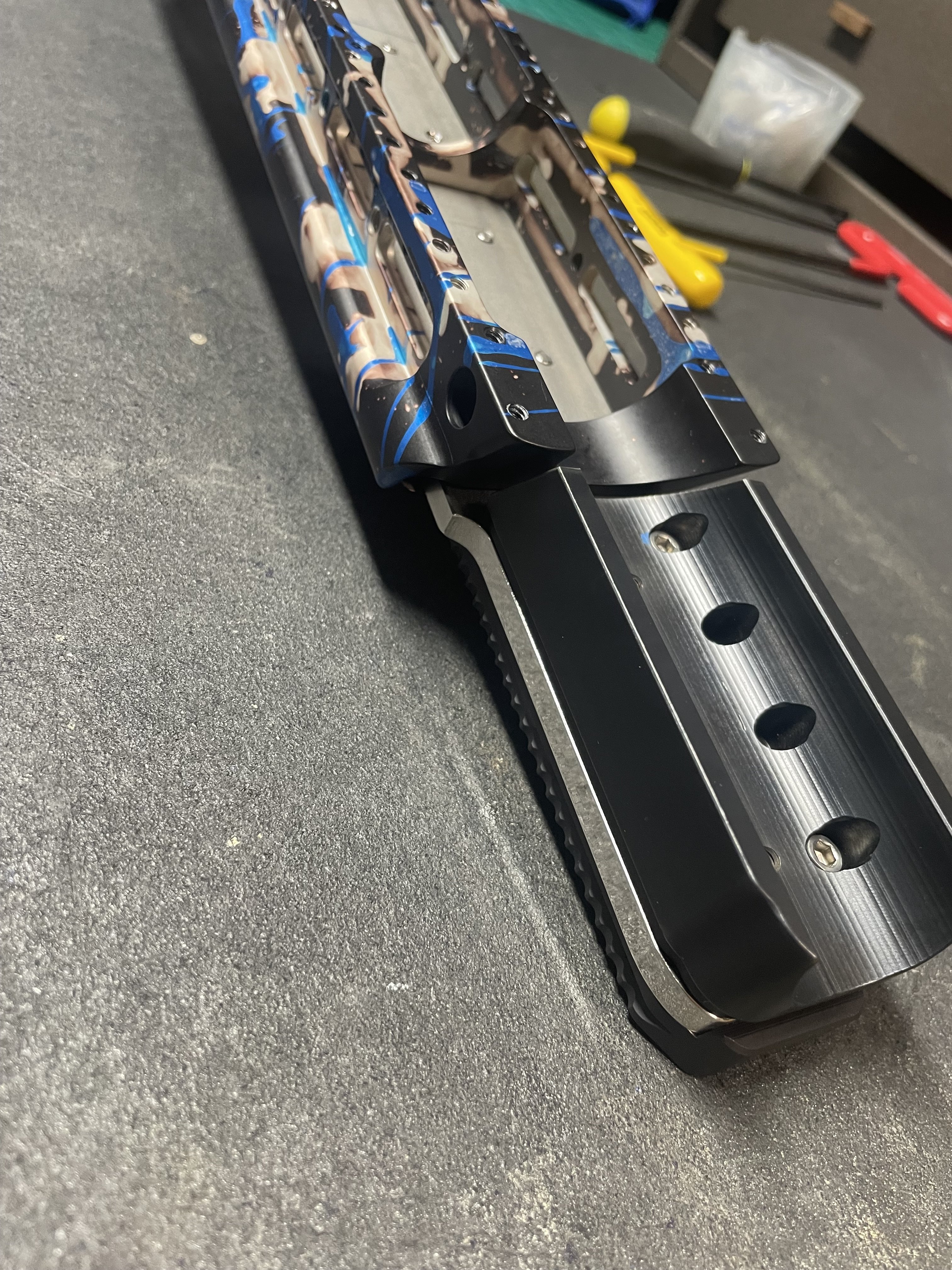

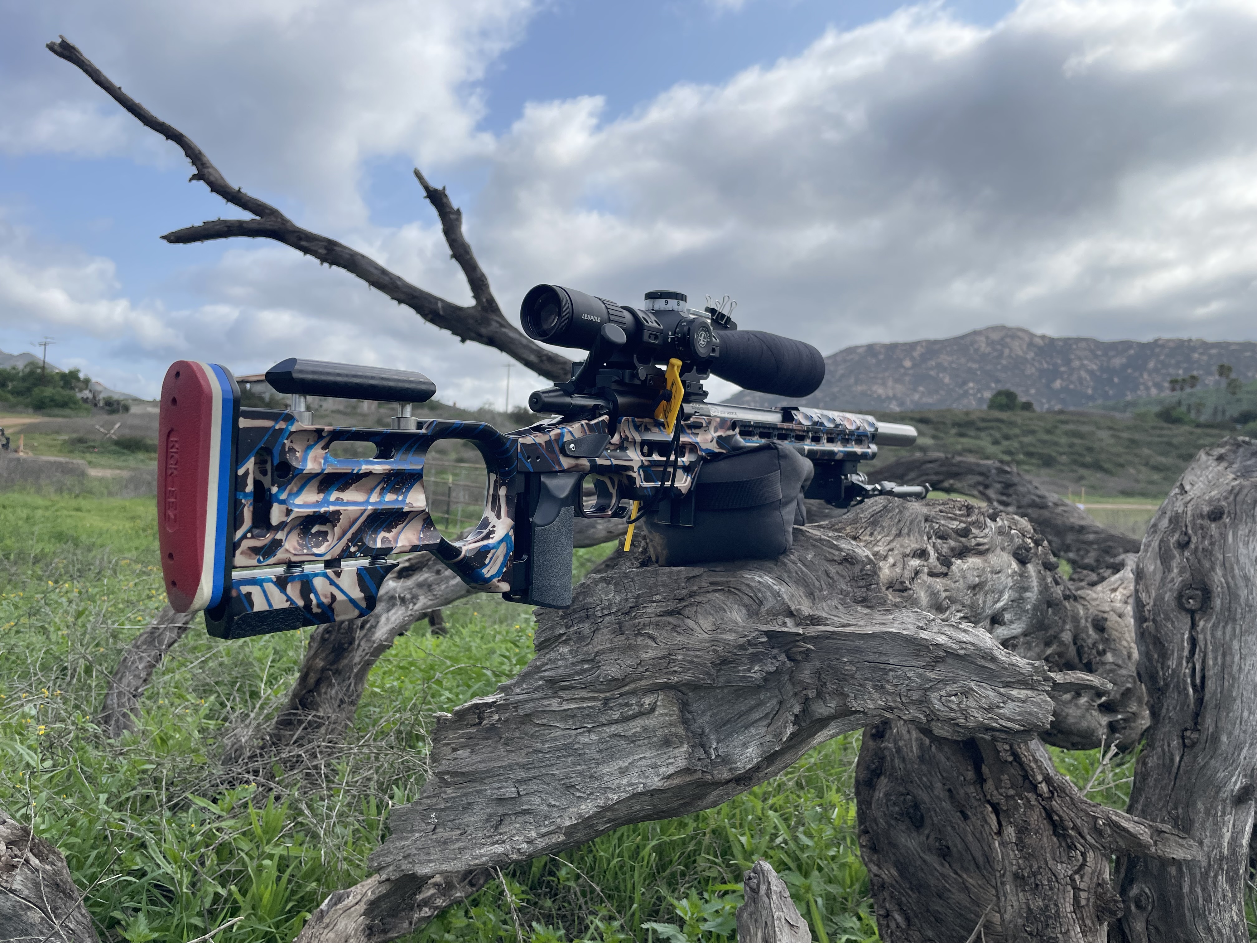

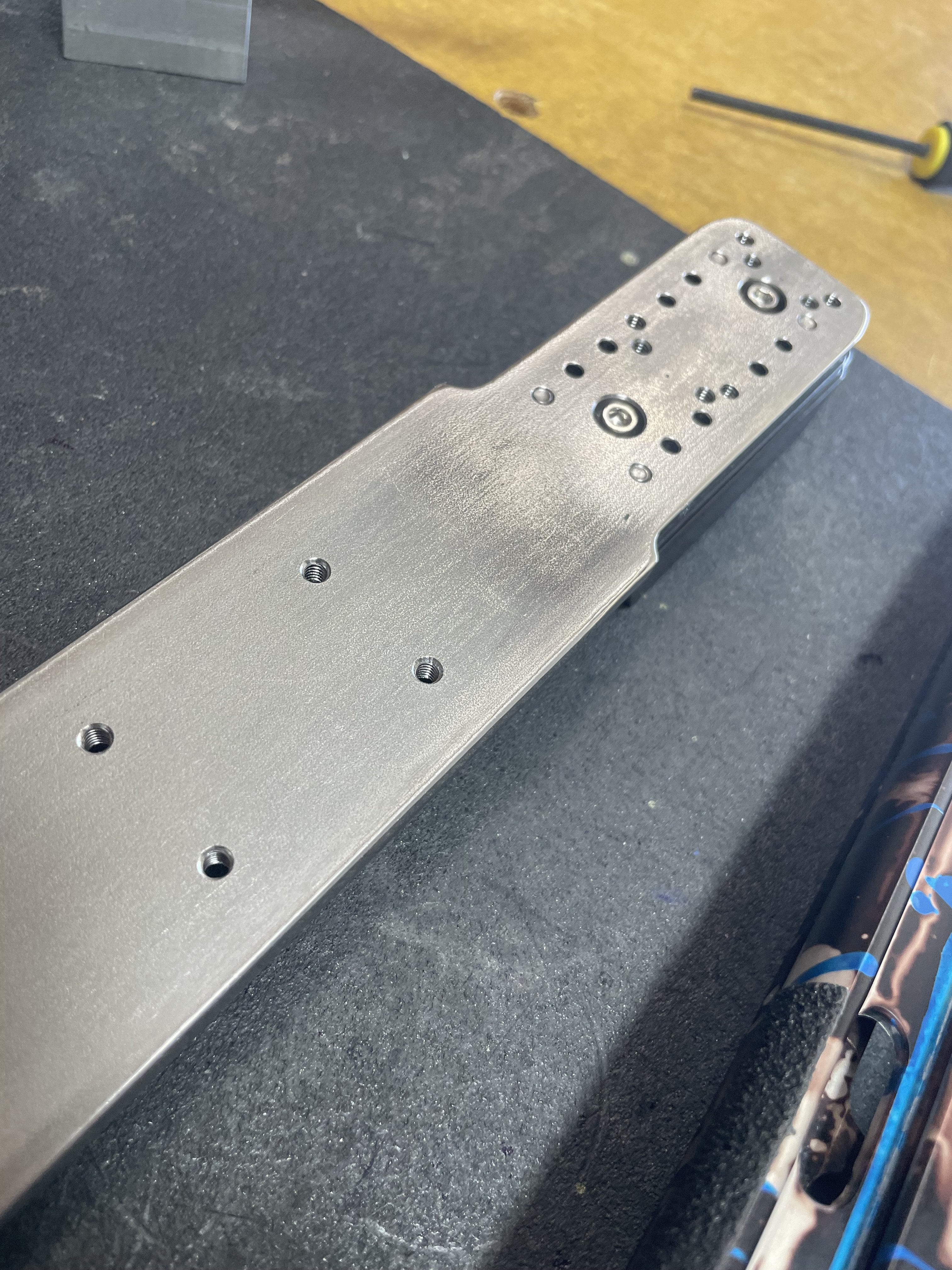

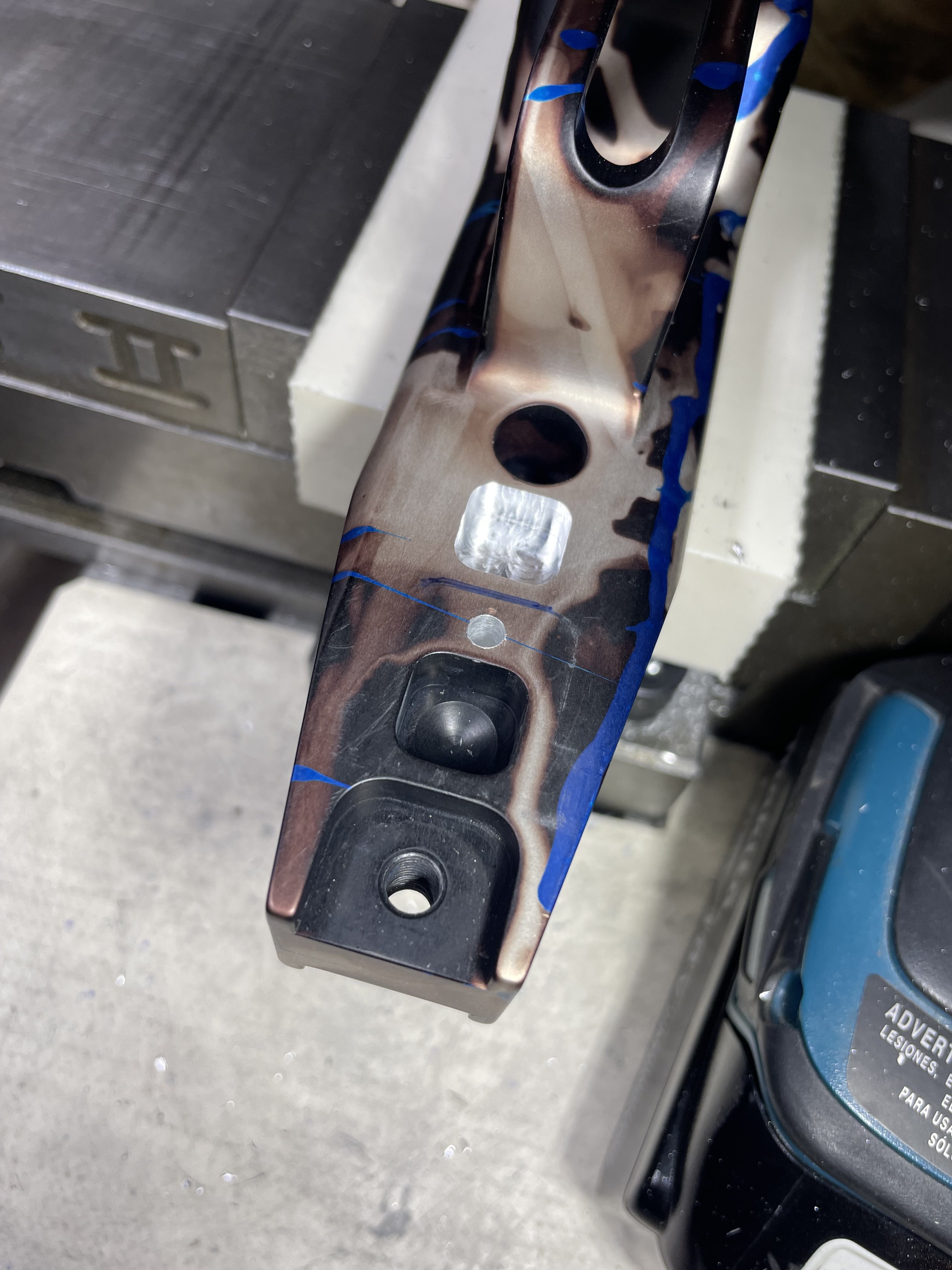

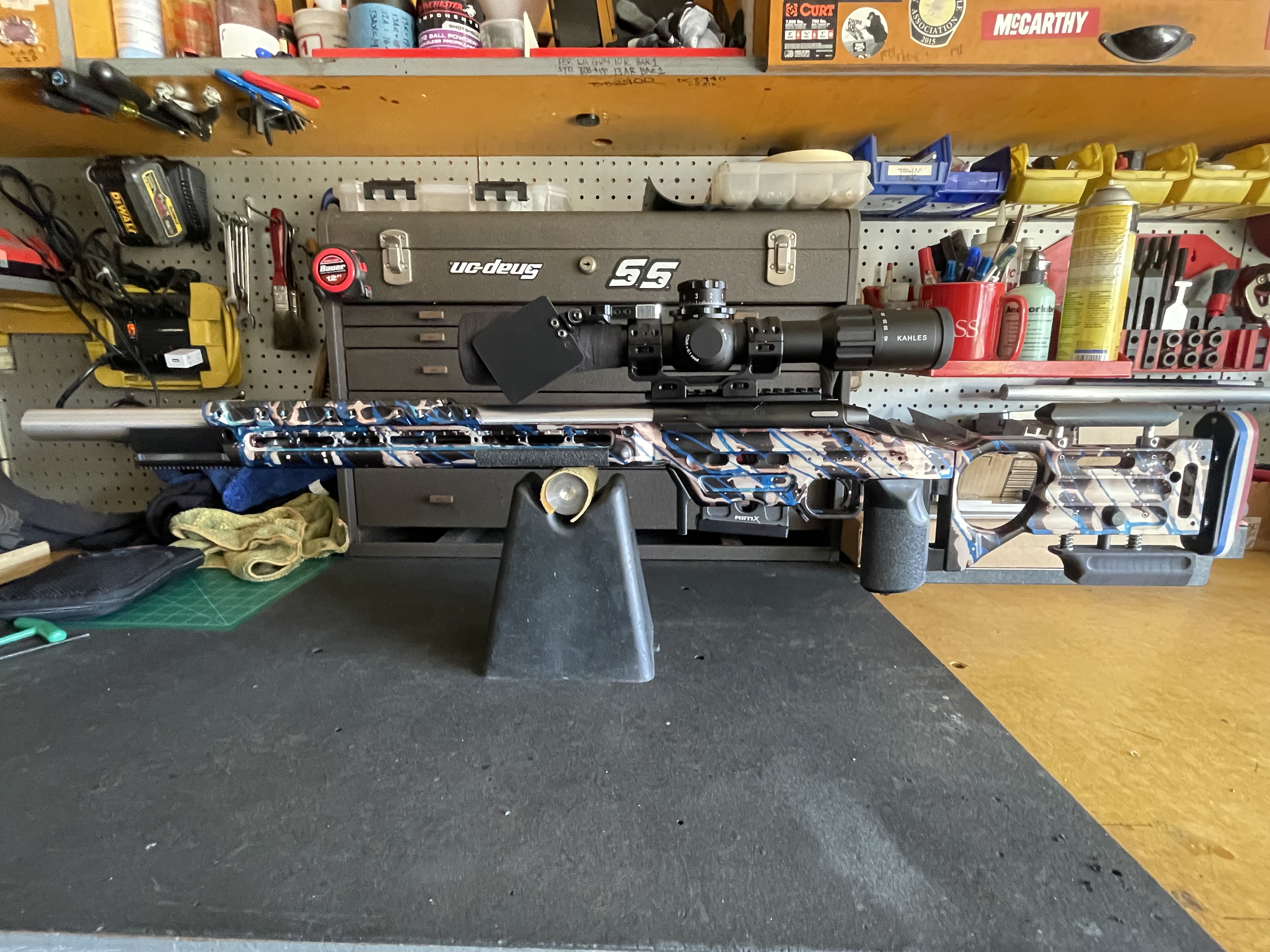

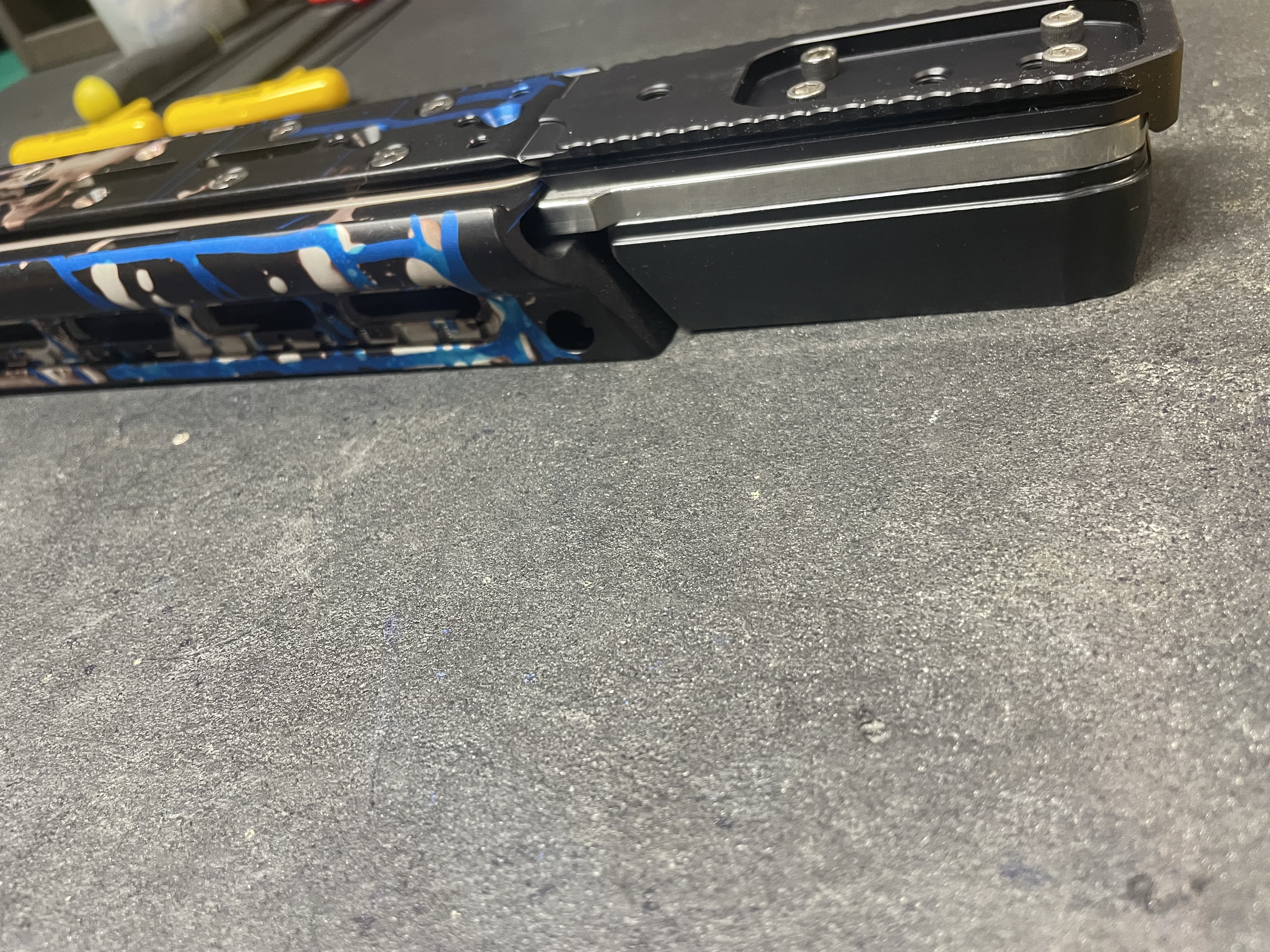

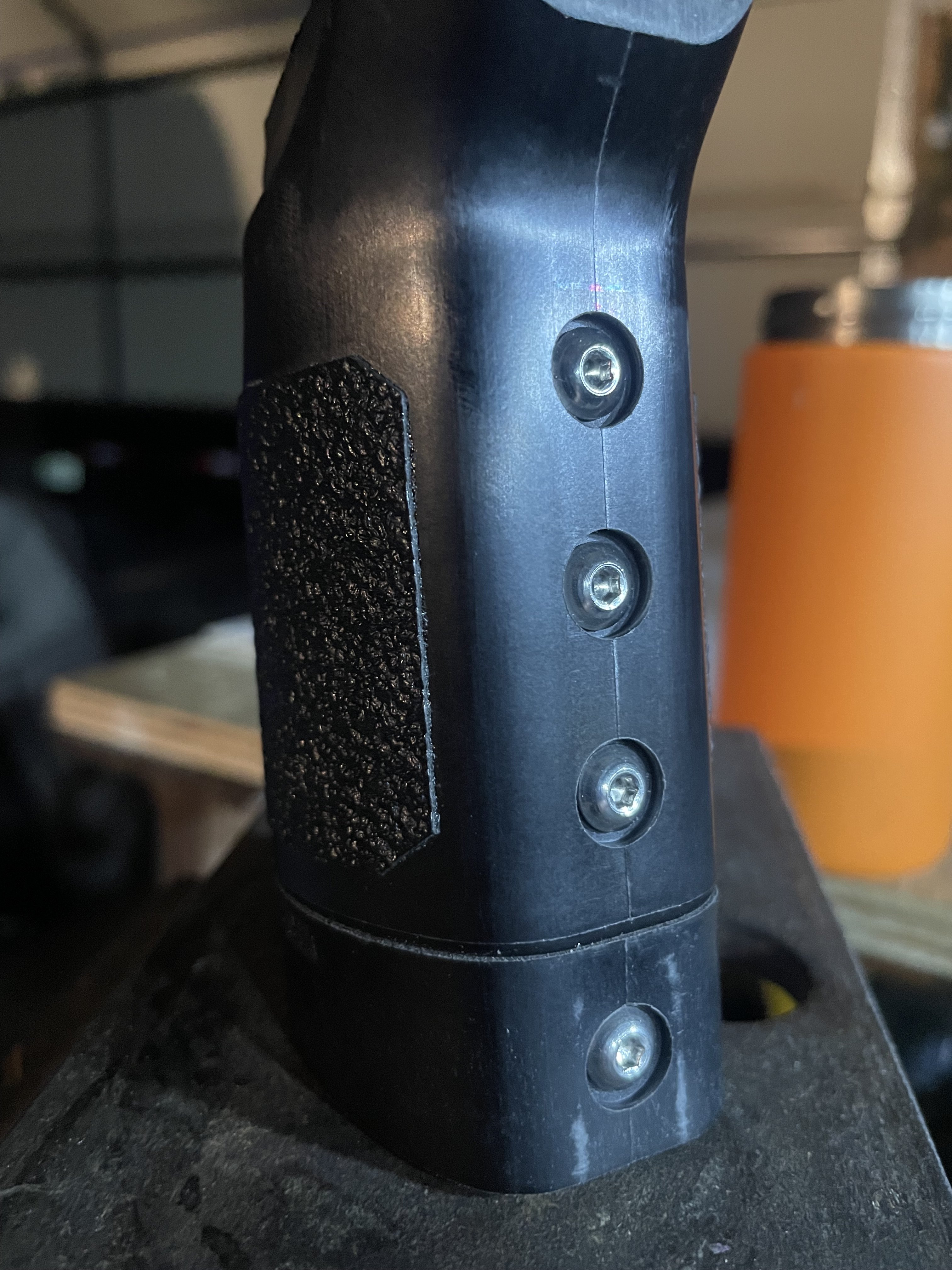

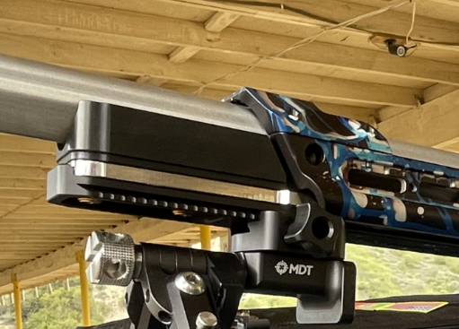

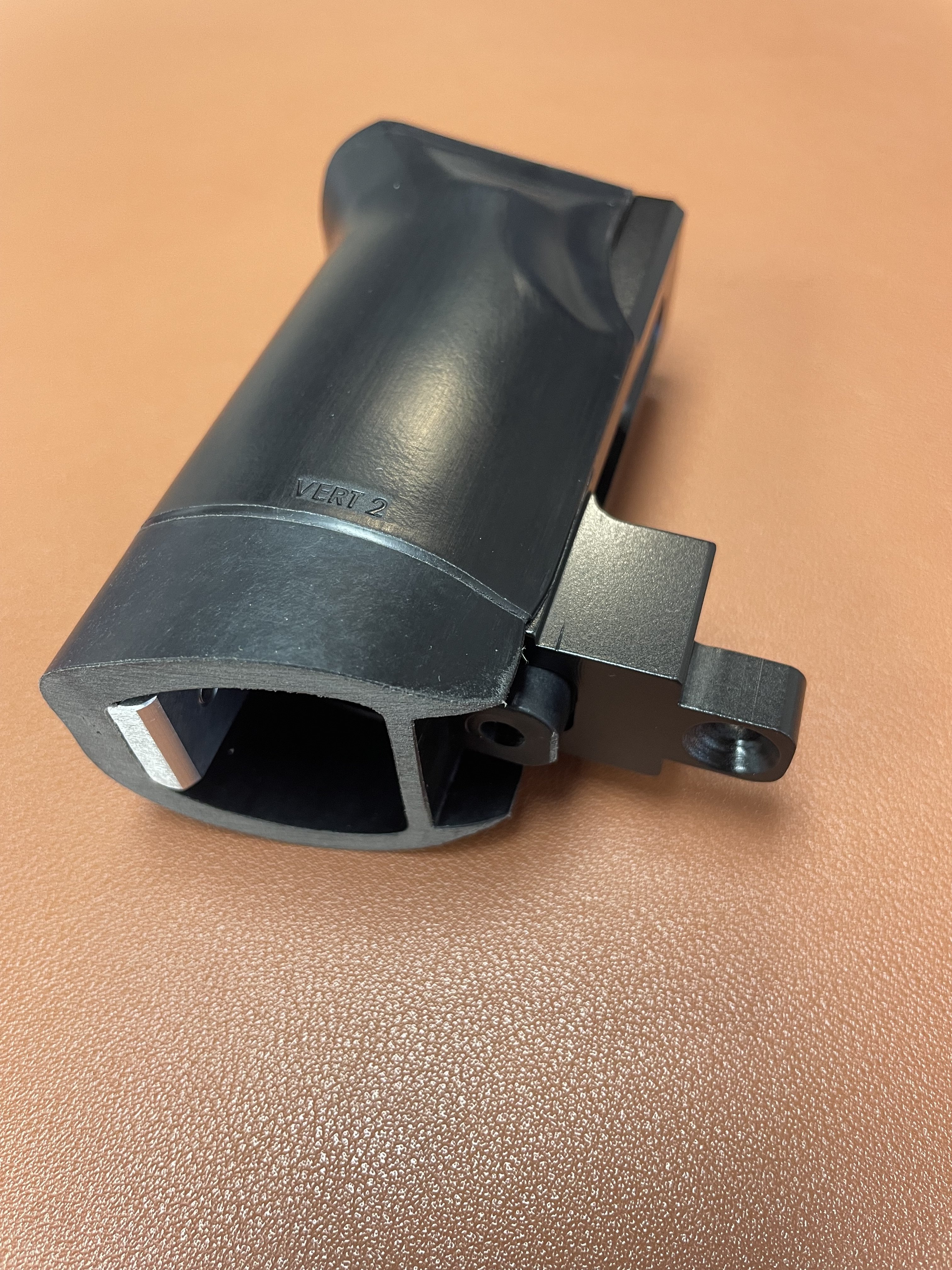

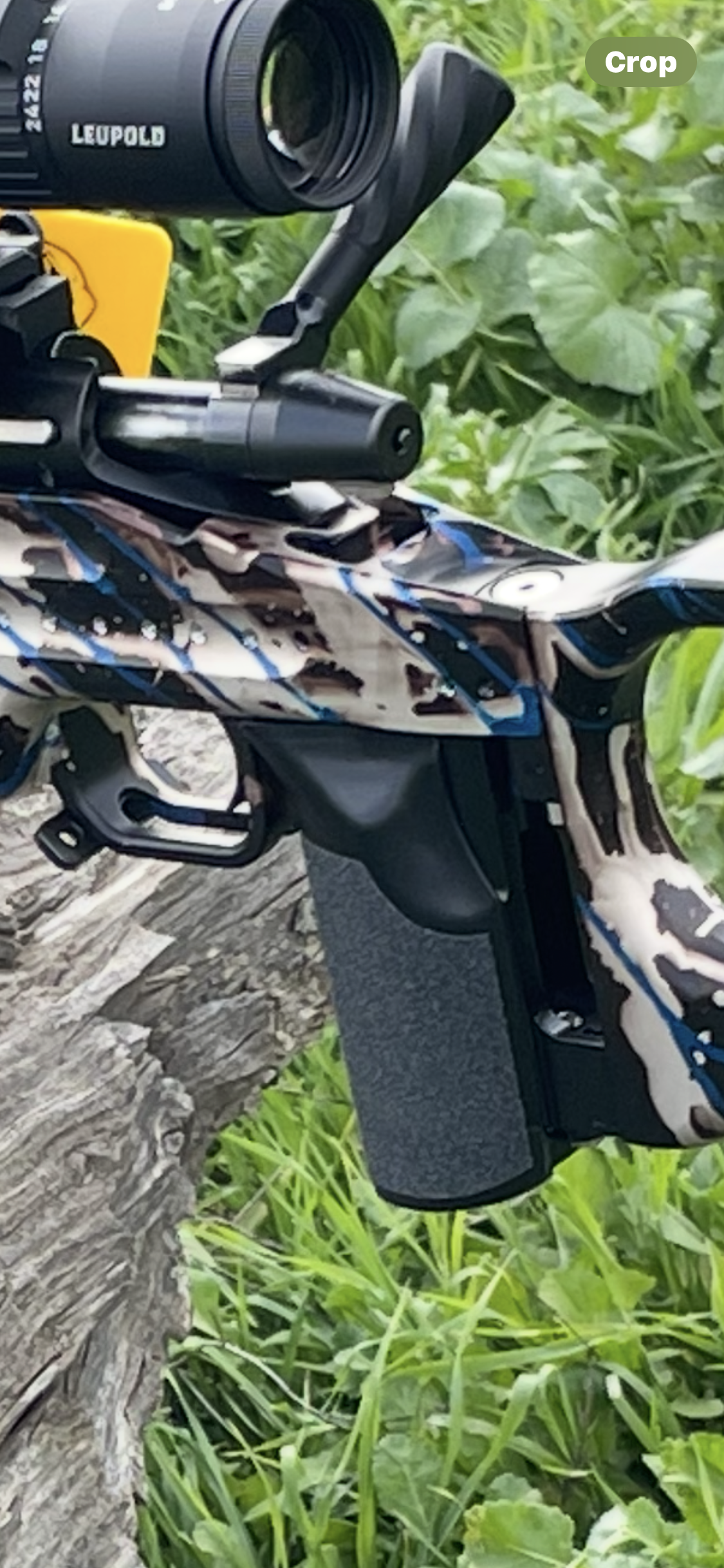

@littlepod
One piece weight.
Moved internal weight outboard.
Added ARCA flush to chassis.
The intent was keeping same weight and balance when I switched from the Mk 4hd to the Kahles K540 while adding more rail length.
Rifle is 21 pounds and balanced 4.5” ahead of the mag well and although this is the Pro II chassis, it is not the hogged out aluminum stock.
Currently working on final, which will then be Cerakoted black. But these were the mock-up’s
Busy photo. But u get the intenet.
Below is a modified vert 2 grip pushed way forward and extended in length.
Reactions: LuvDog
@littlepod
One piece weight.
View attachment 8673233View attachment 8673234View attachment 8673235View attachment 8673236
View attachment 8673256View attachment 8673257View attachment 8673258View attachment 8673259View attachment 8673260
