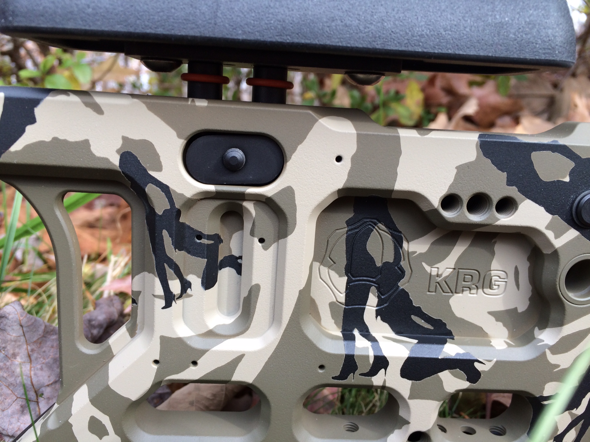

Now I just need a carbon barrel, trigger, and sexy camo paint job. This package is going out tomorrow to a maker of carbon fiber barrels to develop a line of rimfire blanks using a new machine they just purchased. Anyone notice anything interesting about this setup?
Sexy camo like this???
