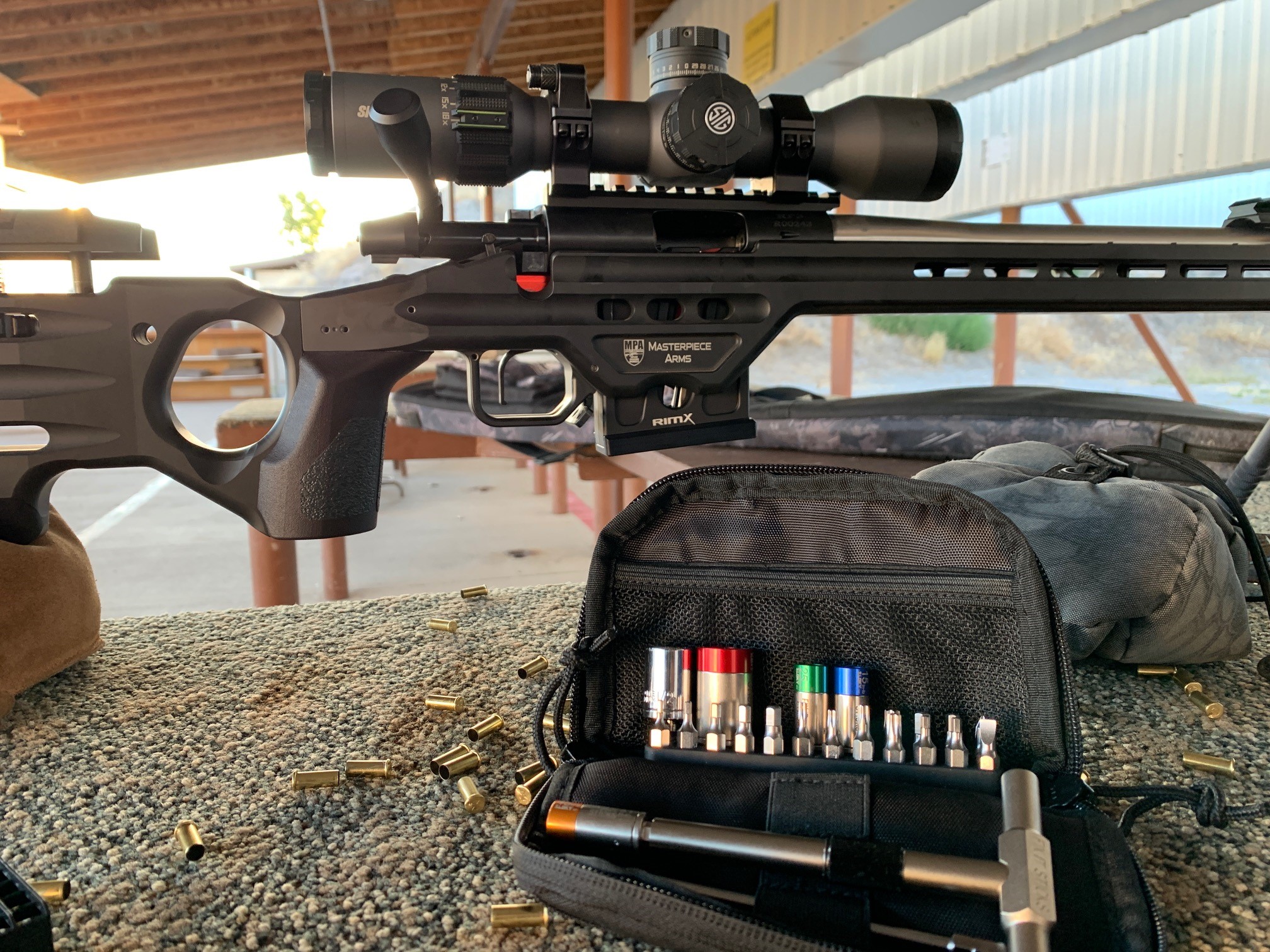

Took my RimX out for her maiden voyage. Feeding was rough but smoothed out after I got the mag latch adjusted just a little bit.
Group sizes with SK Standard were AWFUL. I knew something had to be off so I grabbed the FixItSticks and changed my action screw torque from 65 in*lbs to 45 in*lbs and group sizes shrunk by half. I don't feel the rifle is anywhere near it's potential yet but it was fun to get 100 rounds down the barrel and get a feel for the system.

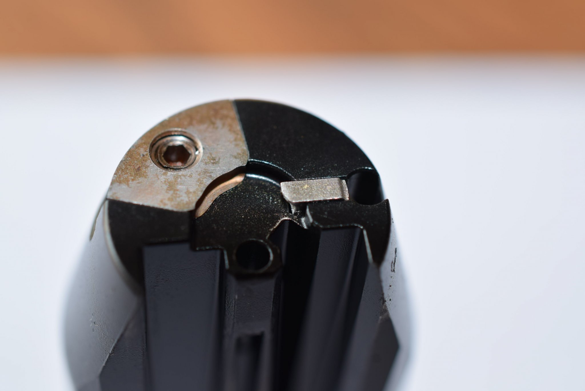

ETA - I knew I'd read that someone else had stoned a slight radius on the bottom corner of the tensioner; while looking back in this thread, I found that drglock's #1044 reply on pg 21 was the one I was looking for, concerning working on his bolt after it was dropped on a concrete floor to fix ejection issues.

For a point of reference, we have started to stone that bottom edge of the tensioner slightly during assembly. We've had fewer calls and emails regarding the issue this is related to so I think it's a solid fix for any issues. I'll keep my eyes open for more issues.

That's more than likely a result of the tensioner making contact with the case body. Pop that out and stone the bottom corner of that part away. .010 - .015" should be enough so roughly 2 passes on a medium stone.

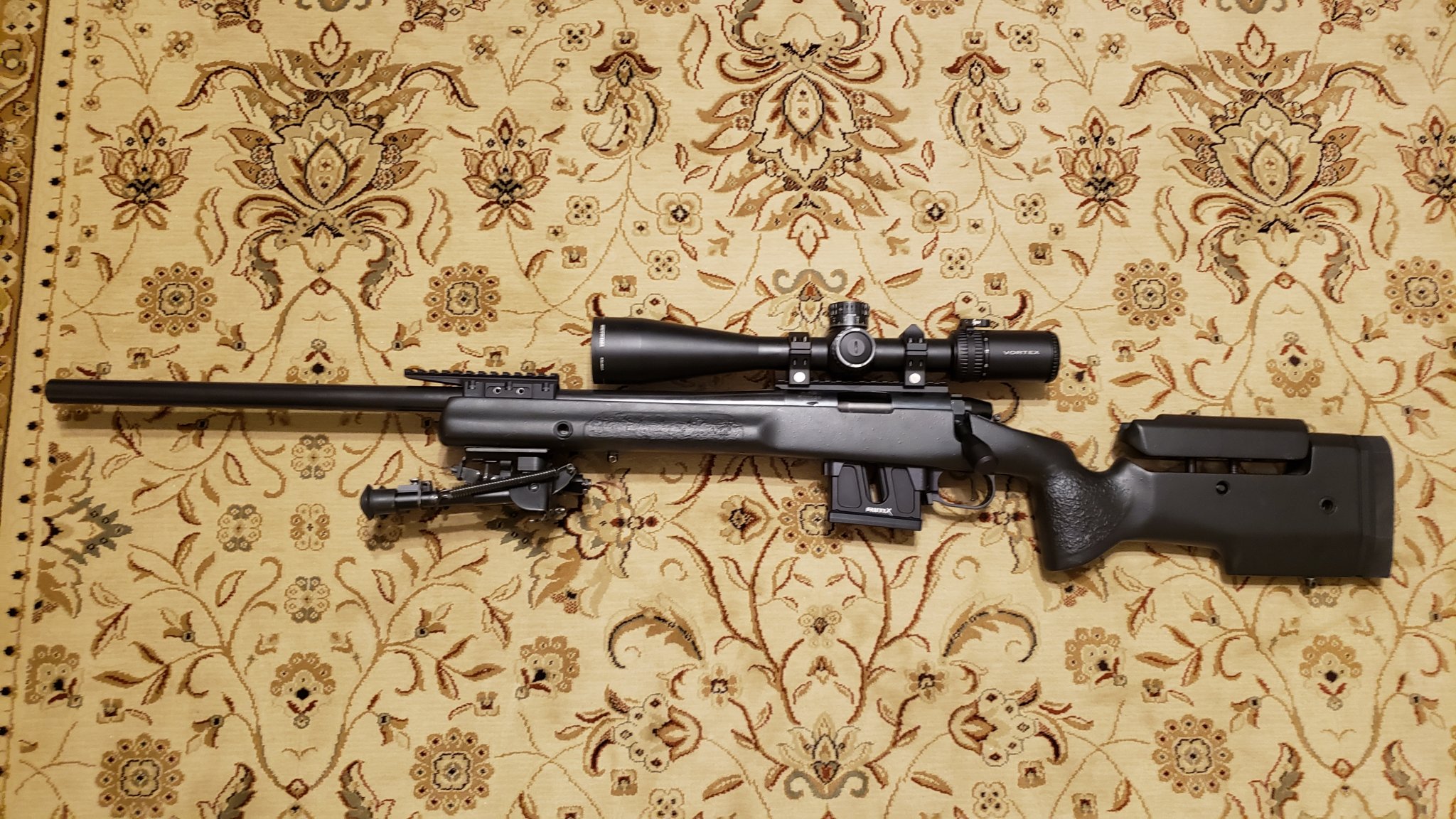

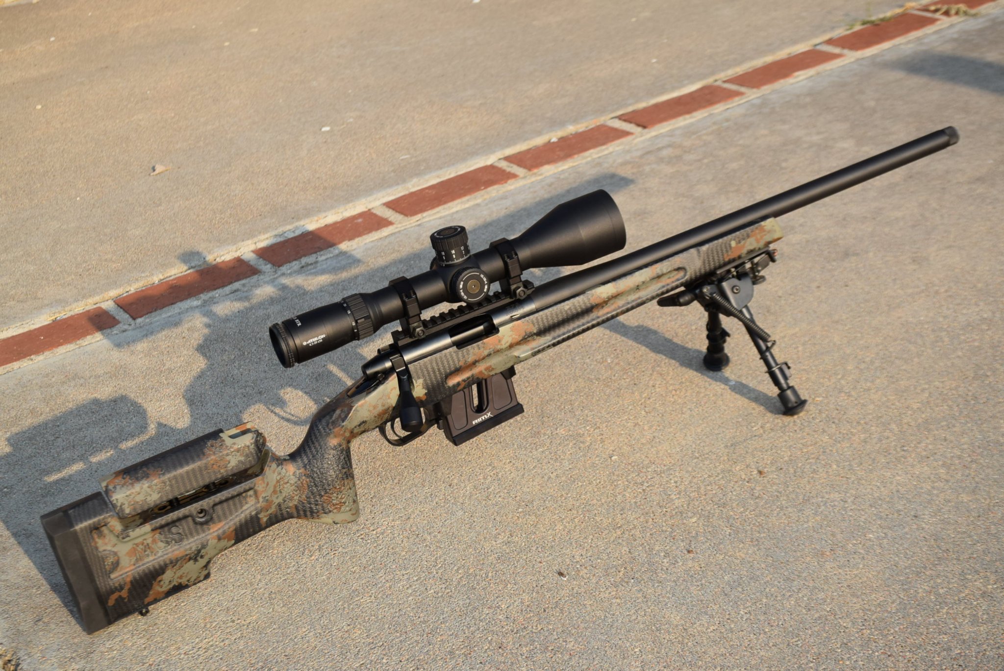

Just want to share my newly arrived MANNERS STOCK FROM THE GROUP BUY HERE 2020 BOUGHT 2 AND just finish install some accessories on it.Can someone here knows what is the torque spec.on manners stocks to the action,thank you in adavnce.
Reactions: Shifty6BR

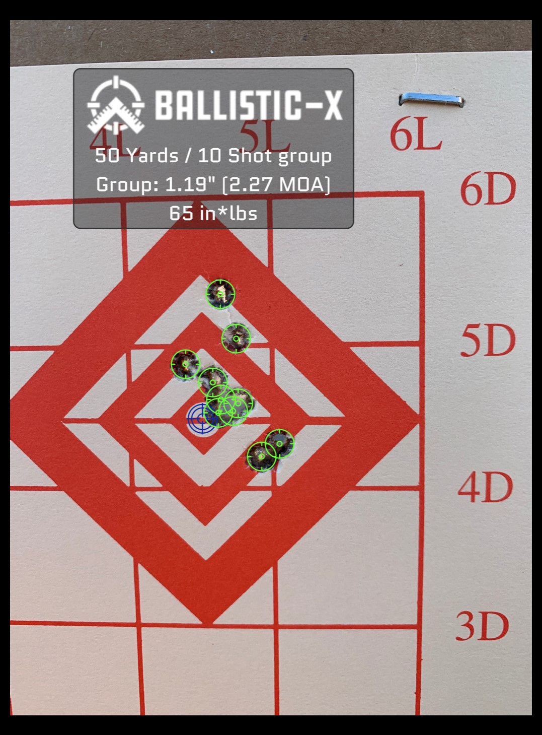

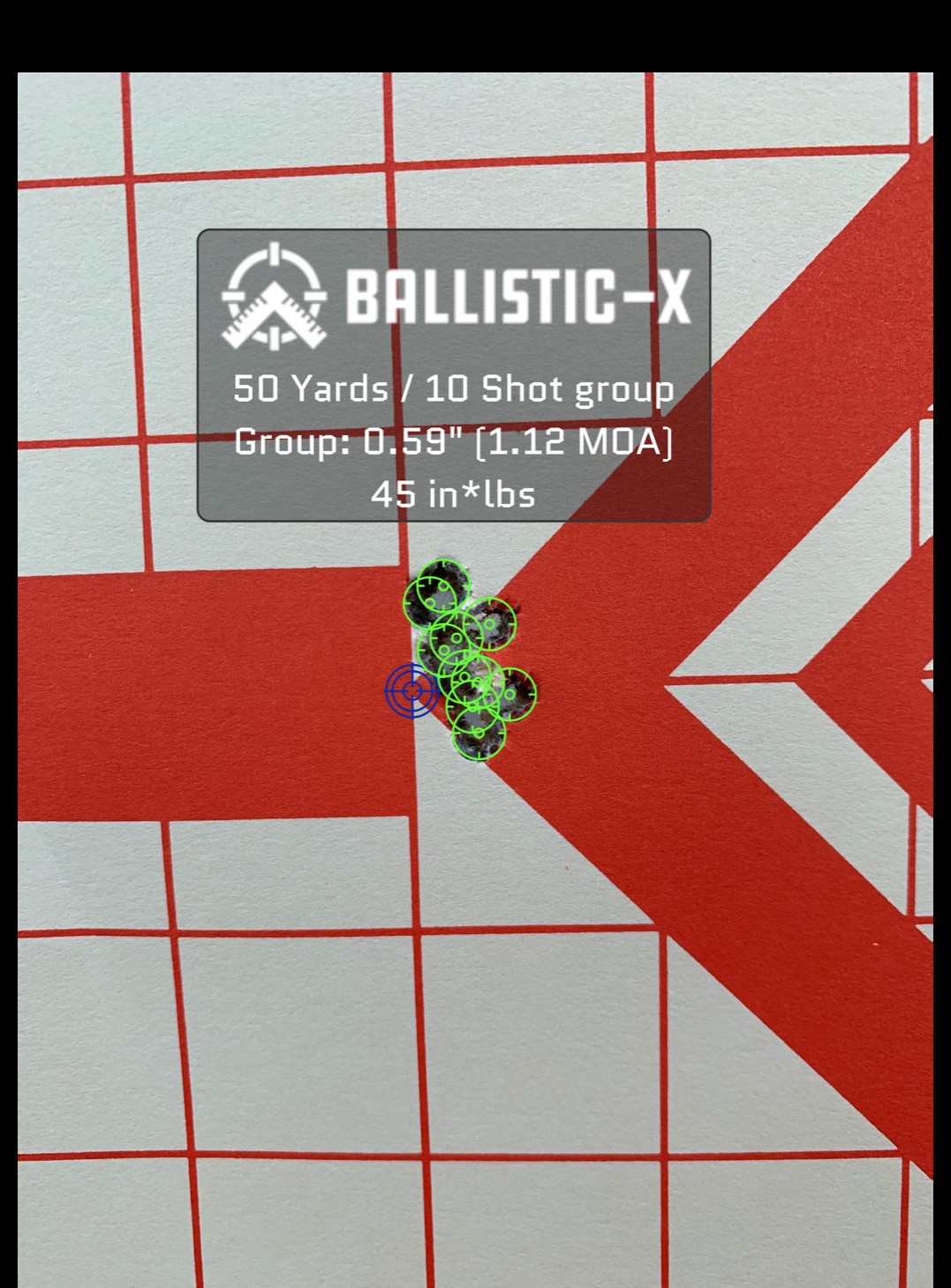

I was trying to do some testing off rests on a bench at 50yds yesterday morning to find out if various action screw torque had any effect on groups shot with my RimX in a Manners PRS1T stock. I'd been shooting with torque at 50 in/lbs both front & rear screws, so tried 55 frt/50 rear & 65 frot/55 rear. Didn't see anything that would indicate a difference, but the breeze from the NW/11:00 started picking up & letting off to the point that I felt I was wasting time & ammo. If I get a nice calm morning on a day when I've got time to shoot, I'll go back down to 45/40 in/lbs and work my way back up from there. I ordered this stock with std inlet, not the mini chassis, then glued in aluminum pillars, let them cure for 16hrs, then bedded the bbl'd action with Marine Tex. I'm thinking that optimum torque for a std bedded stock may be a little lighter than for one in a mini chassis, but only testing will tell...
The only time guard screw torque adjustment should show a difference in performance, is if you have a poorly designed/improper tolerance chassis, bad bed job, or an out of spec or flimsy action. I have witnessed some very popular chassis creating much stress in actions, which is evidenced by the improvement of groups based on guard screw torque. This is part of the reason I never recommend chassis setups unless they are skim bedded and matched to a specific action. Not to say they "can't" work... it's simply to say they often introduce problems, much to the dismay of their owners, that spend ridiculous time and effort troubleshooting a problem, never once considering the chassis is to blame.
A properly built action with correct bedding interface, will not show accuracy/precision variance from minimal torque, all the way to 65 in/lbs. Period.
Reactions: Ncbrshooter

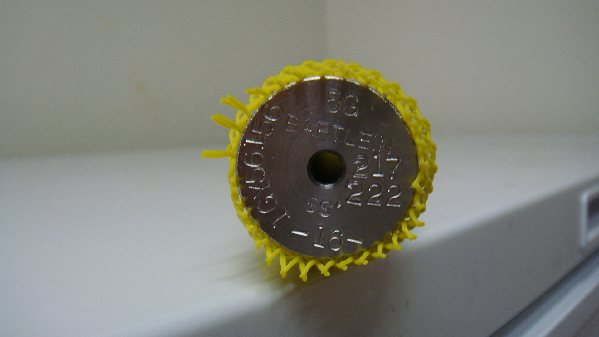

Justin,fresh from the box my bartlein barrels 5R "MARKSMAN" 26" USEABLE.
Yes, Greg is correct from my experience. The only exception is if your beating the hell out of the rifle and have super light torque (guessing under 30lbin) you may experience a screw coming lose or a POI shift.
Well, as I stated in my post, I saw no differences in group size or shape, so will simply torque the RimX's action screws to the same values I use with custom CF rifles - 55 inch/lbs front/50 rear. No point making it more complicated by choosing some different values
Yeah that a better way of saying what I tried to say. I still go with 65lbin if the bedding has metal pillars in it, if it is just a wood stock that is skim bedded I’ll torque to about 45-50 lbin.

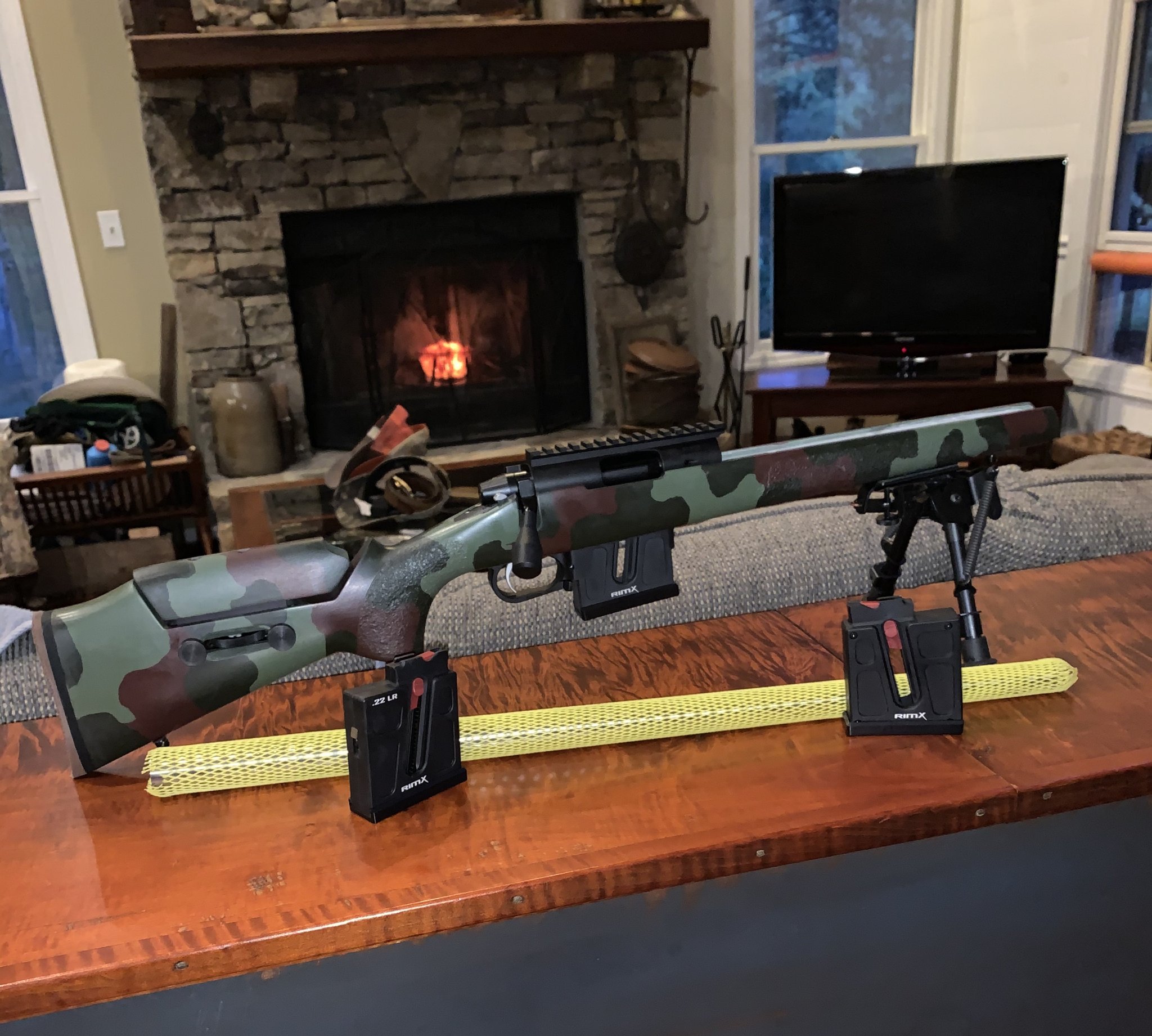

Hi yo folks, MY RIM X continue to "NEVER CEASE TO AMAZE ME!" just recently i change stock and use PTG DBM on it,and i have a problem chambering a round to it,i fire 1st then the 2nd hang up and don't chamber so on and so forth always like that happen to this new set up,but then i adjust the setscrews in the side of the magazine lower just a bit then the problem solve.I like that magazine design for rimx that scews really help this problem.
If this still continue to amaze me again i might get another.🤣🤞
