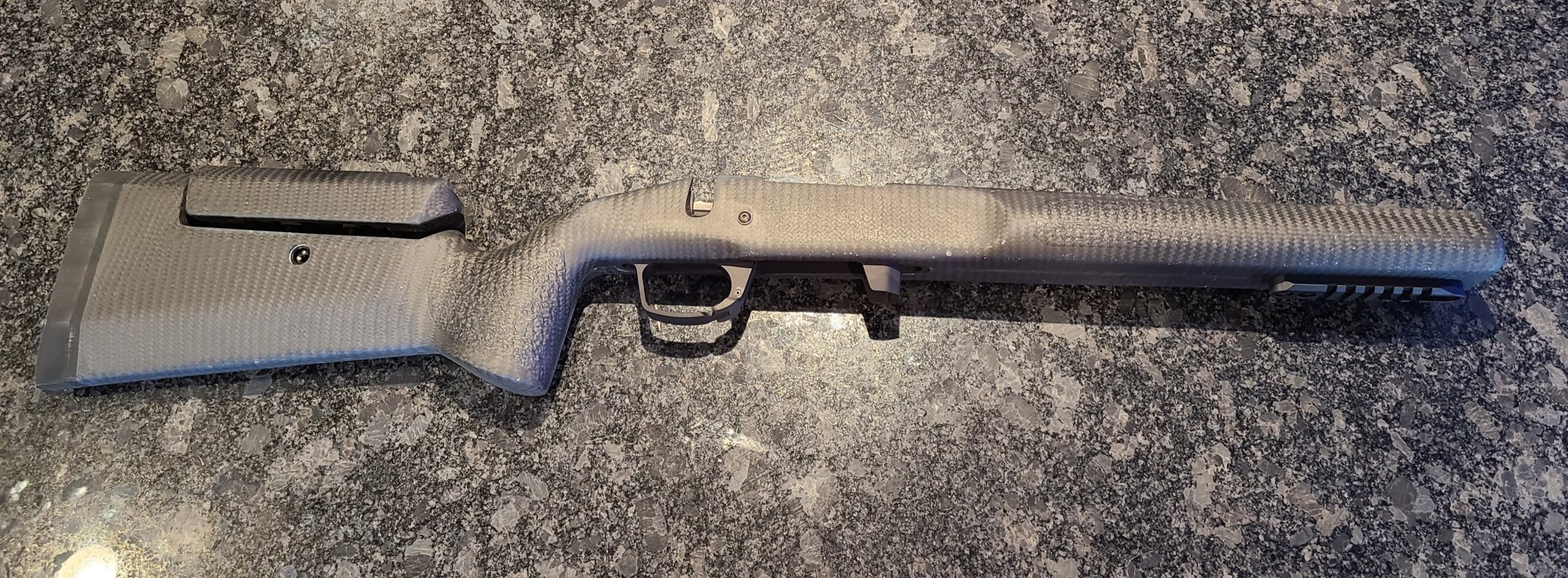

Posted awhile back that i wanted to build a rimx after building my first custom rifle early this year...well took the first step and picked this up this week from a member manners t2a with the mini chassis might get a splash of color on it but im just as happy as i was with my prs2
It was inlet for a 700 and medium palma so i may end up sending it in to manners to be opened up id really like to get a 20in proof carbon bull for it but cant seem to locate one at all (yeah ive tried most companies on here) so may end up settling for the 18in sendaro

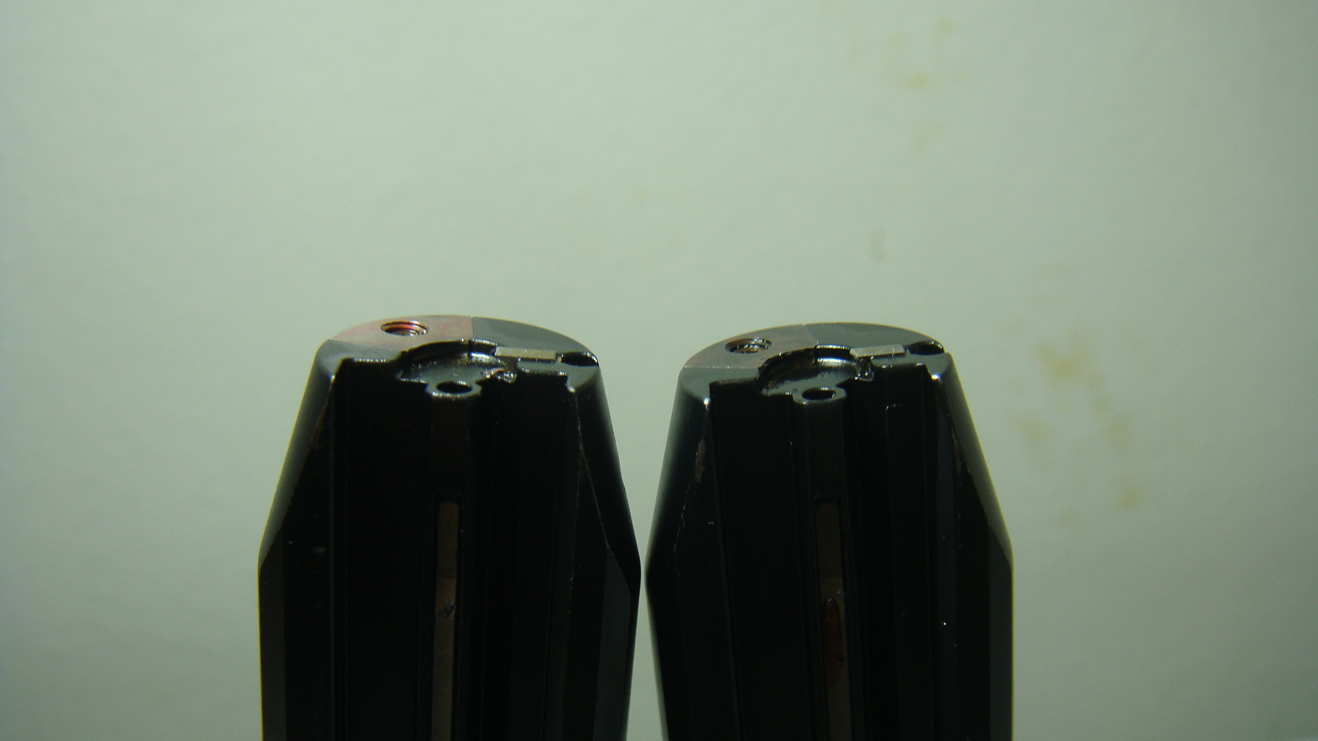

Shoot I also have problem with extraction from my other rimx i thought i have a problem with the setup action/barrel(HEADSPACE) from my other rim-x,but when i try the complete bolt from my other rimx it works perfectly eject the casing away from the actions.so i notice my other rim-x complete bolt is the problem i email zermatt with this problem for assessment/fix the issue.holy cow!
ZERMATT CUSTOMER SERVICE IS TOP NOTCH!! "BAR NONE"!

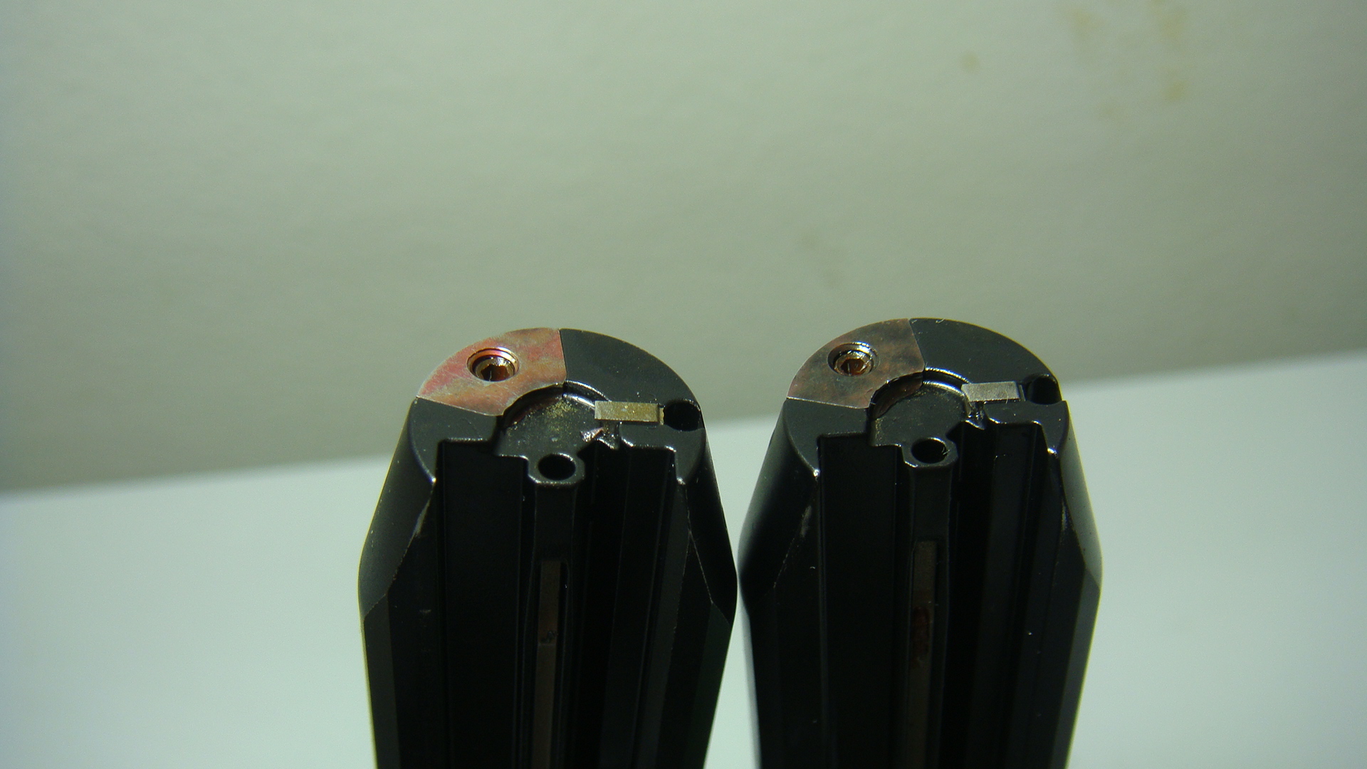

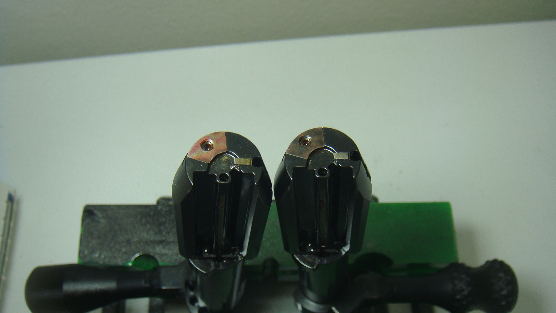

Folks I figure the problem now,I send ray a picture for both complete bolt face.I notice from the RIGHT bolt TENSIONER is shorter than on the LEFT BOLT. This has only below 12 shots from center-x ammo after i install the barrel just check the headspace then this is happening.I might already get the broken TENSIONER. thanks for the review here.

Ill have to take a look at mine tonight. So far its been working well. I first had issues getting the magazine set correctly. It would be feeding fine but the mag was sitting so high it was ejecting the brass off the mag. Now I have it sitting low enough that its not doing that but if i run the bolt super super slow sometimes it doesn't catch the rim and the round kind of just pops out the mag. Usually happens on the last round.
I still need to do more shooting with it but so far its a cool little gun and most if not all the time its catching the rim and is smooth.
