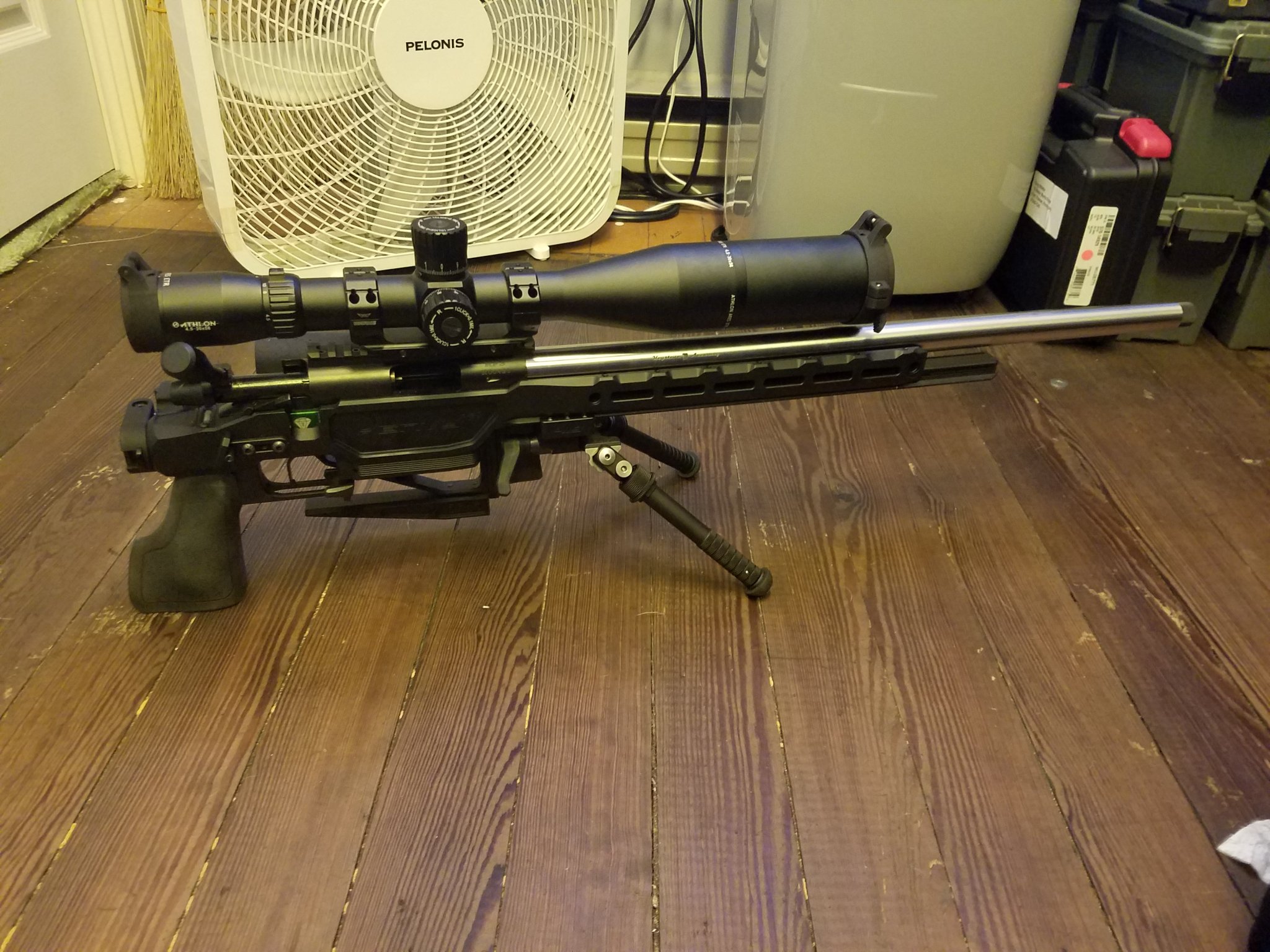

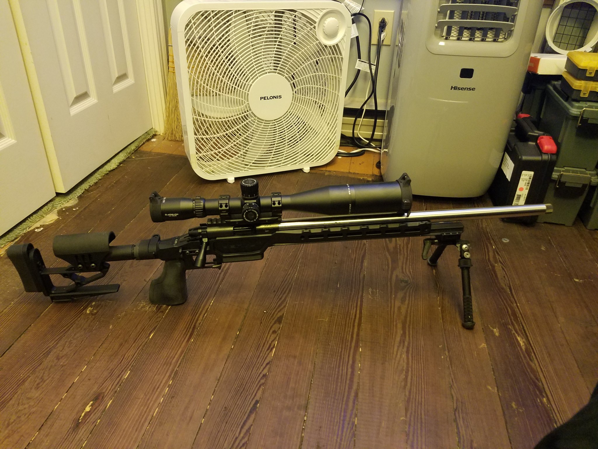

I recieved my BA action back from John earlier this week. The first time I sent it back to him, he polished the chamber and put a larger than normal chamfer on the face of the barrel to improve feeding issues I was having. Upon reinstalling and heading to the range, I was having light strike issues, so I sent it back again.
Ray at zermatt though it may be a trigger issue ( TT diamond 2 stage), and John had no issues with ignition using a Bix n Andy tacsport on my BA, so I was beginning to think the trigger was the culprit. John suggested that he re-chamfer the barrel while it was their back to original spec since he was thinking the original feeding issue and maybe the light strike issue were caused by the tensioner, not the chamfer.
I got everything buttoned back up this morning and took it out to my local indoor range ( only 25 yds) just to see how it would feed and if the light strikes continued. I'm happy to report that through 170 rounds, I had no feeding issues OR light primer strikes. I ran 50 rounds of SK standard plus, 50 of rifle match, and 70 of pistol match. I'm not sure what changed, but the rifle is finally functioning properly. I'm keeping my fingers crossed it continues to do so, I'm going to try to get 1000 or so rounds through her next week on my "stay"cation.

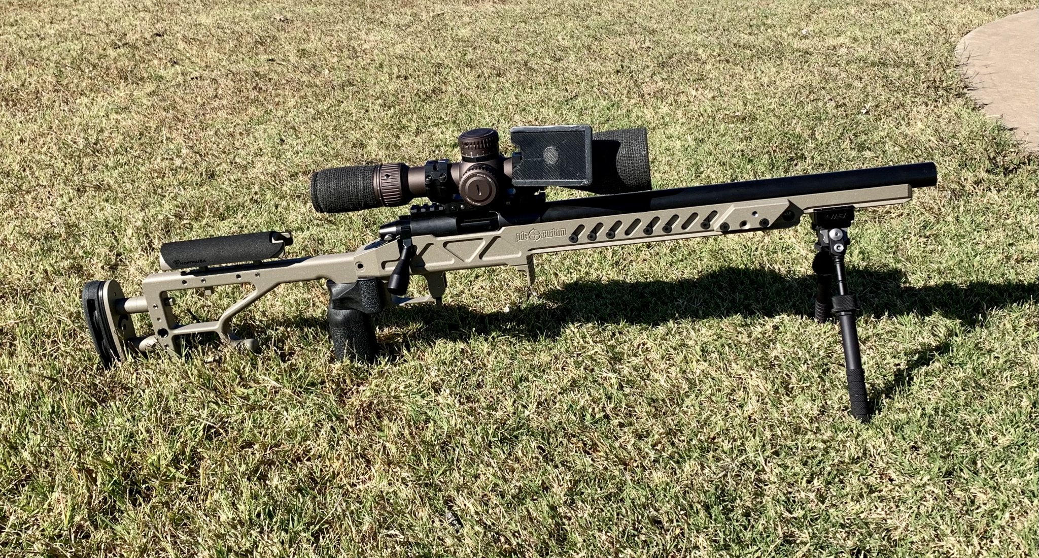

RimX
24 inch Keystone Accuracy Bartlien M24
TT Diamond 2 stage trigger
Athlon Ares ETR 4.5-30×56
Warne Skyline precision mount
XLR industries Envy Pro chassis
Atlas Cal BT65 w/ Area419 Arca clamp

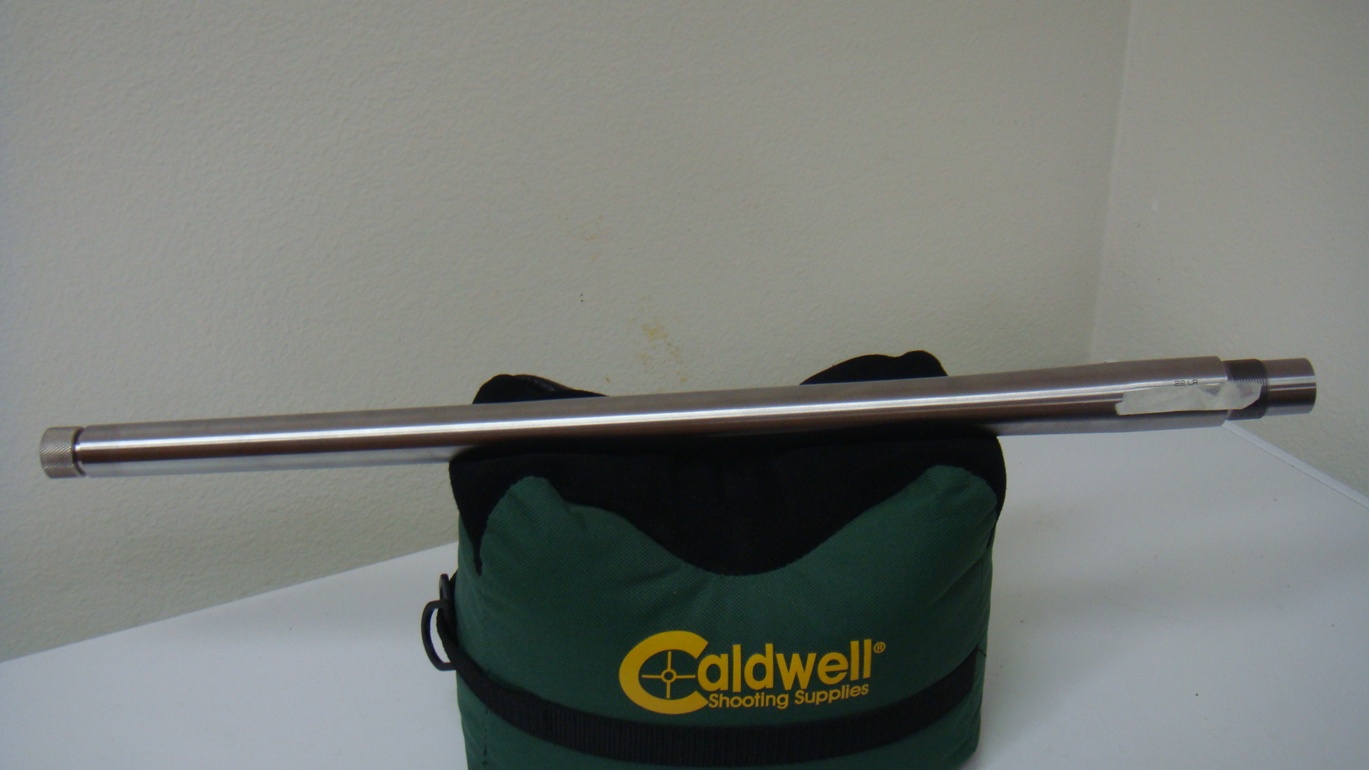

Here is a forum members barrel he sent me to look at/test that was having some accuracy and feeding issues. Ill leave it up to that member to decide if he wants to claim it but it doesnt really matter. Its a Keystone Accuracy Green Mountain with my 22LR Match Eachus chamber.
Barrel shot great, zero feeding issues and accuracy on some lots was great. When I received the barrel, I scoped it and saw some carbon or some type of build up in the front half of the chamber closest to the lands. I cleaned the barrel with BoreTech RimFire blend but it didnt remove that chamber build up. I spun some either 00 or 000 steel wool (whatever I had on the bench) in the chamber on a dremel and it removed that build up quickly and left a nice polish on the chamber. I then patched it out and screwed it on my RimX. Torqued to 55 ft lbs.
I loaded a 10rd mag 10x, running the bolt for those 100rd and it fed perfectly. Zero feeding or ejection issues and no hard bolt close. I then took it to the range and shot 8rd of SK+ on the clean cold bore at 50yd. I then shot a 5 shot group with that same lot of SK+. I then shot 4 lots of CX, then 3 lots of SK RM. All randomly grabbed partial boxes laying in the bottom of my bag from previous testing.
As you can see, it loved some lots, and didnt like some others but all in all accuracy was great for not doing proper lot testing.... No barrel fouling, no cleaning between ammo, no multiple groups of each lot.
Also, for those of you that maybe measure your groups a different way or subtract a different #, the group sizes noted on the targets below are measured outside to outside black smudge ring minus 0.223". So if you subtract a different number, add 0.223" to those group sizes and you will have outside to outside measurements...

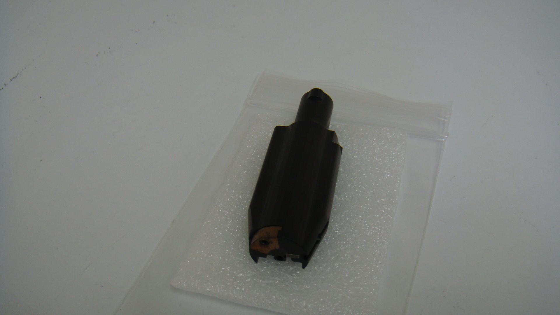

Thank you Ray of Zermatt! I just received the complete bolt face assembly that you send me even though I don't ask for it.My problematic bolt is not a problematic anymore it turns out to be smooth,flawless and works like a charm now.Thank you ray for your help!

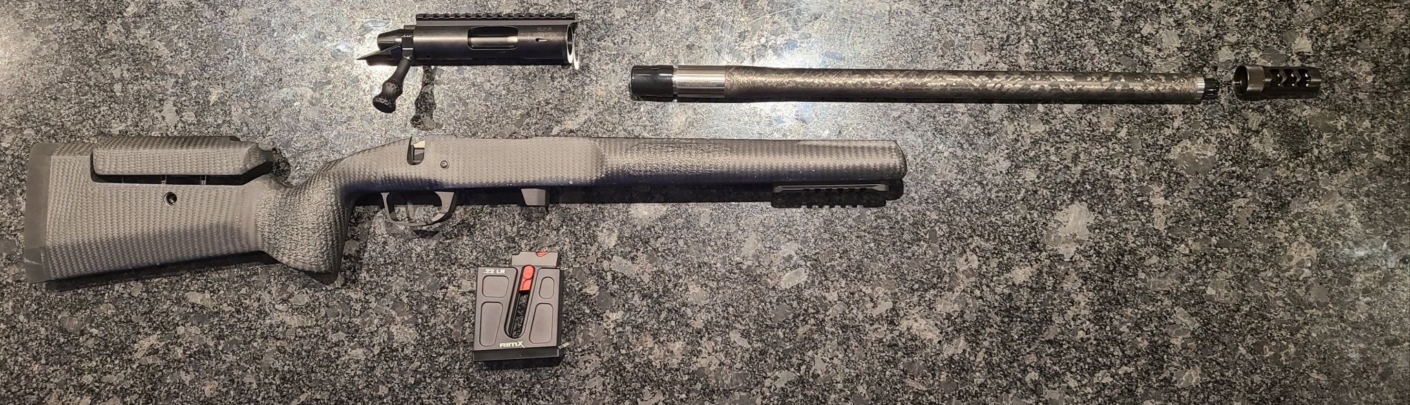

Gun is together got the stock opened up no issues, trigger installed i did try to remove thr firing pin and boy just didnt want to pop off so i gave up for now
Going to switch out the bolt knob and unfortunately was sent the wrong brake so will need to get that exchanged i threw a spare a2 on now to protect the threads
I habe a spare viper pst 4-24 i will throw on it for now but will eventually end up with a strike eagle to match my 6.5

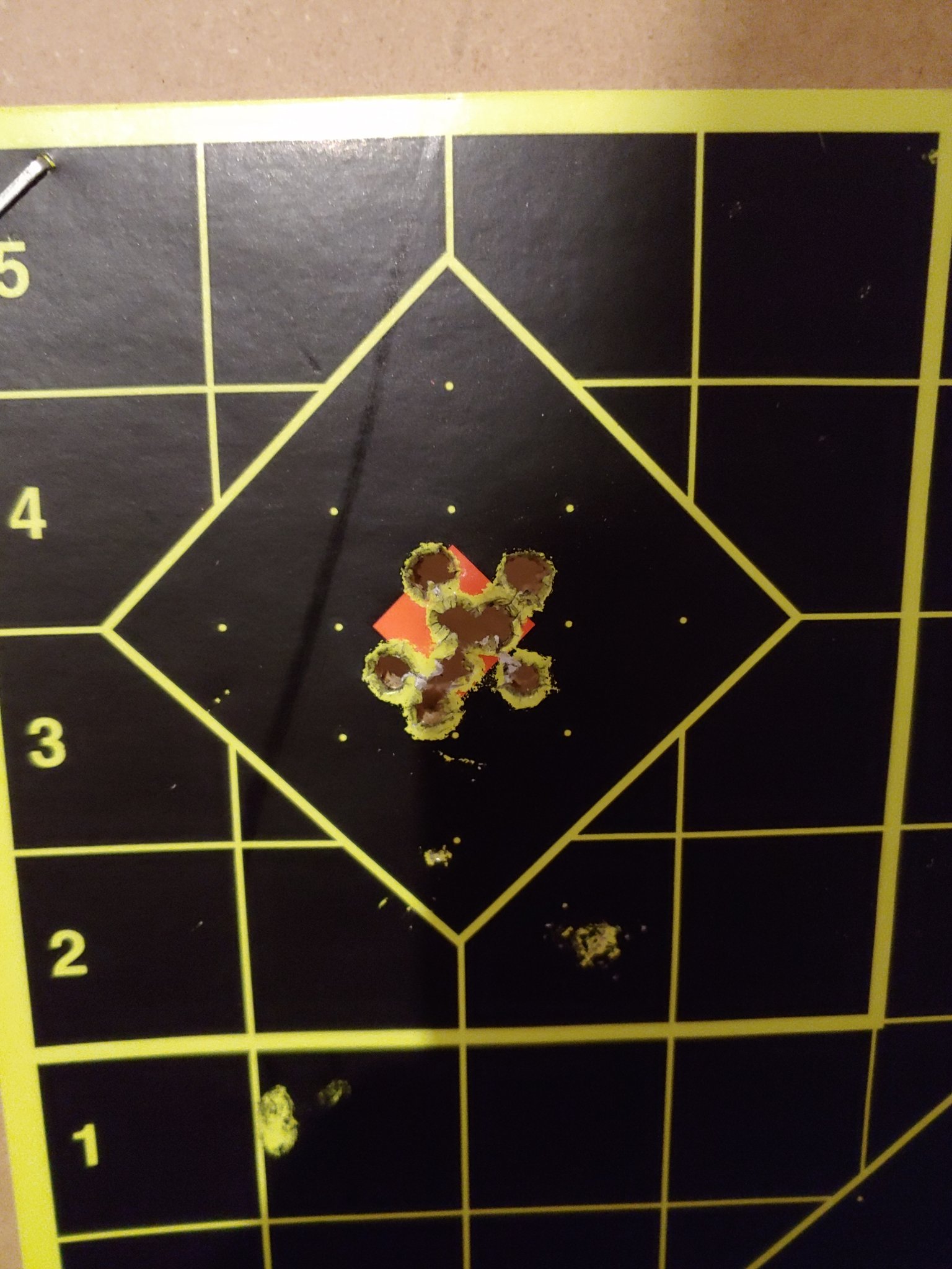

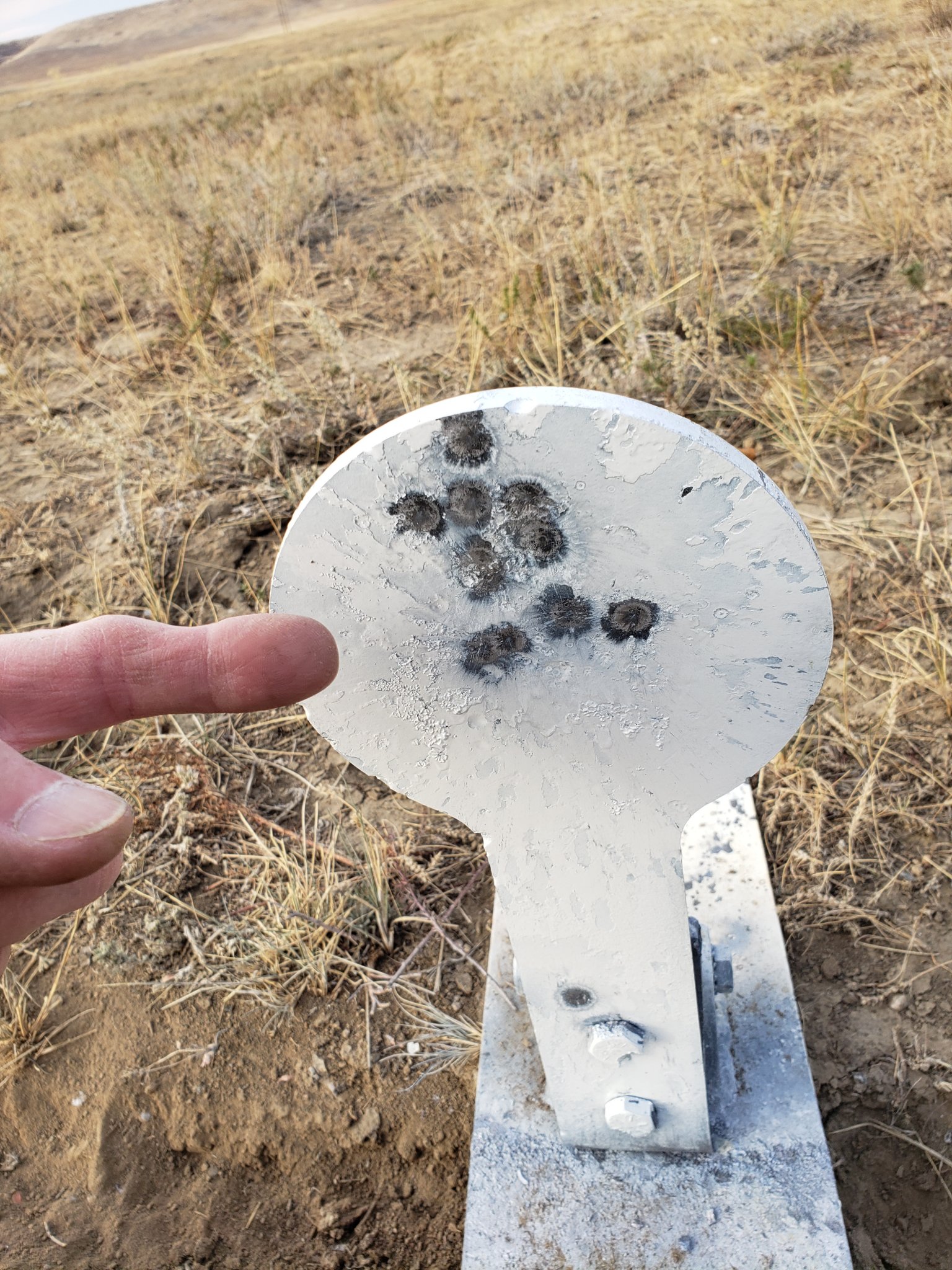

200 yards. Bipod, bag, off the ground, 45*, 4mph switching wind from 7-9
Had some new lots of SK+, SK RM, CX and R50 I got out and tested today at 50yds. Shot 50rd each prone, rear bag out of my 20" Bartlein with Rugged Oculus attached. Didnt really have any terrible lots in todays testing. I was happy with all of them. RimX is still running great going over 6500+ rounds on my setup today.
All groups are outside to outside black smudge ring minus 0.223. Add .223 if you want the outside to outside numbers.

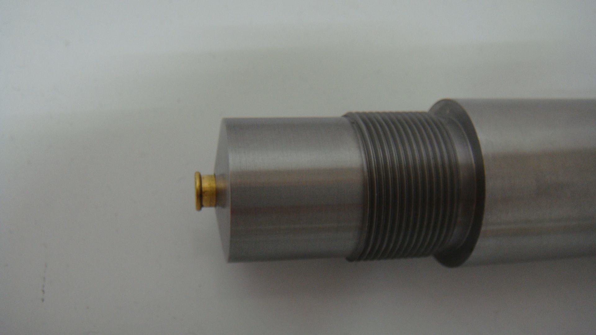

Folks, I just got my new threaded barrel for RIM-X. Chamber: My Own Match Chamber PRS(Personal Research Spec. Reamer)
Barrel: Lilja 3g/16t 22" useable Length
Chamber:Bullet engages the rifling with about more than 1/8th inch. of brass left to go in.Ammo seen: Center-x
My Rim-X new bolt face:Licking it very much on this combo.

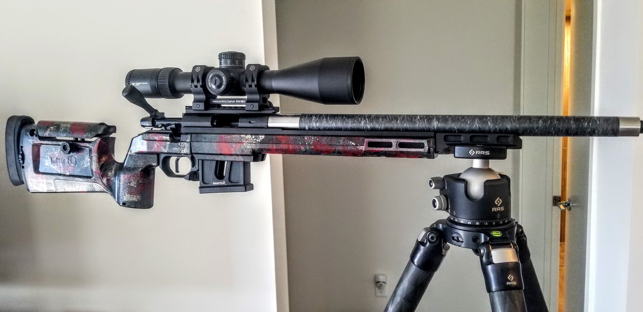

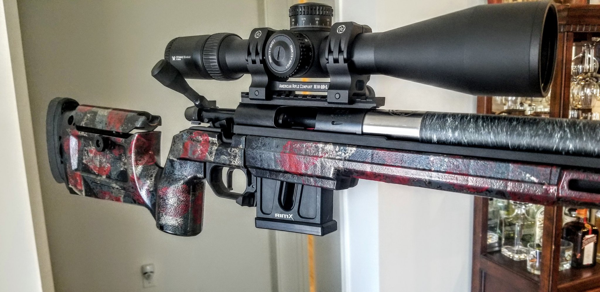

Got my rimx finished and ready for the range
Manner t4a with mini chassis
Proof 20in
Trigger tech primary
Viper 6-24
Currently has a dd a2 on thread protection duty but will prolly order a hellfire 2 port so it matched the 6.5cm big brother
Built the 6.5 earlier this year and it was the first rifle ive build from scratch and the first bolt gun ive had that wasnt a base 700.....well thanks to the info and help sh has provided and the customer service i got from these companies i justified building a 2nd one sure the wife is pissed ive got $3600 in a 22....oh well
