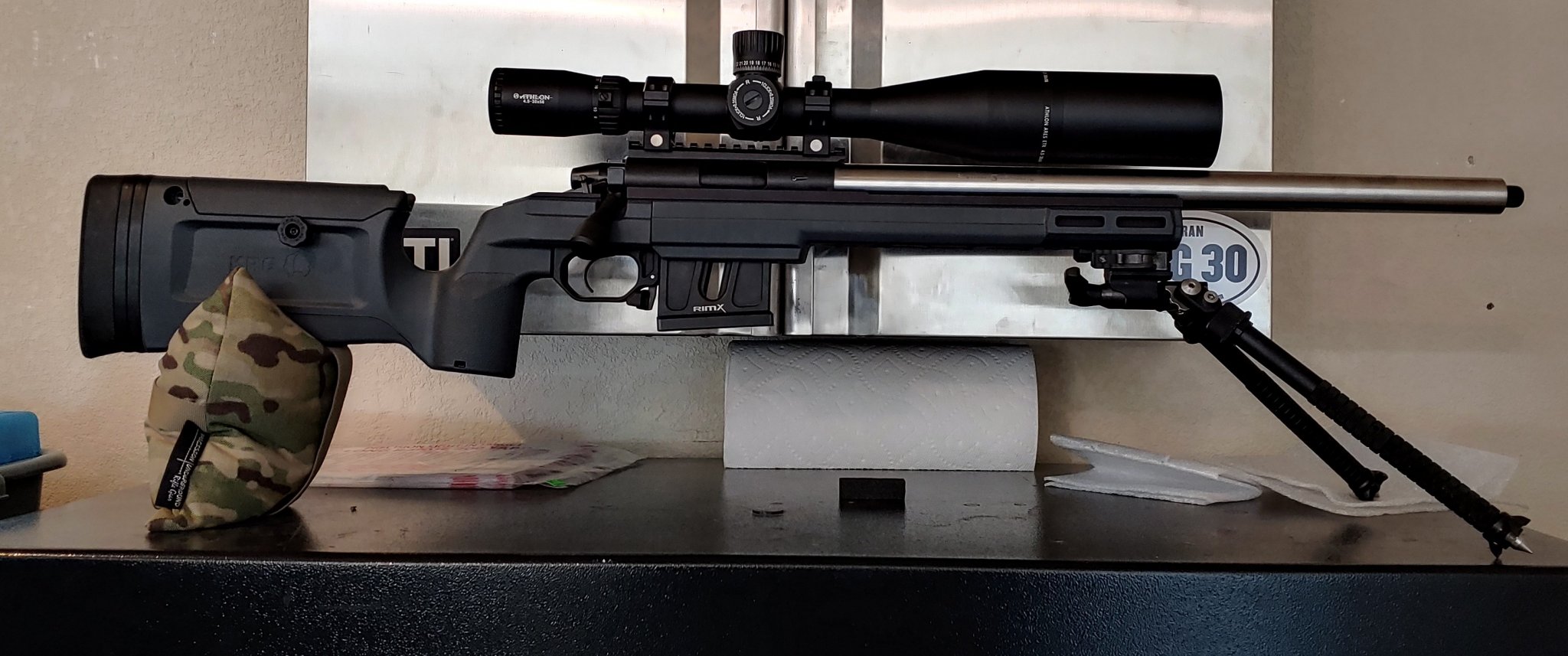

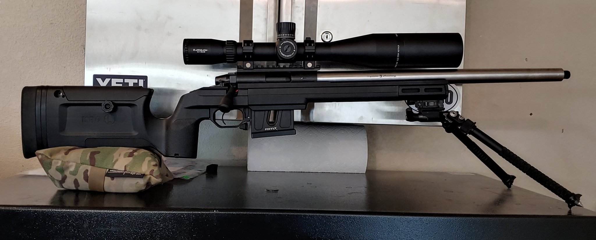

Got my 2 twin rimx's put together this mornin.
Keystone GM 20"
TT diamond
Krg bravo
Athlon ares ETR
Hawkins rings
Haven't got a chance to shoot them yet. Adjusted the mags and played with how they fed etc. They both are shaving a ton of brass on the bottom of the chamber no matter how I have things adjusted. Only used center x at this point. Everything else seems ok. I hope I don't have to do a bunch of work to them as that's not what I'm into or have a ton of experience in. Time will tell.
After playing with it a little more it seems to like a "normal" speed of running the bolt. Like you would at the range, field, etc. If I run it slow trying to diagnose problems, tune it etc it shaves more brass and has a harder time feeding/chambering. I really just need to get out and shoot and see how things settle in. Maybe towards the end of the week. Will report back

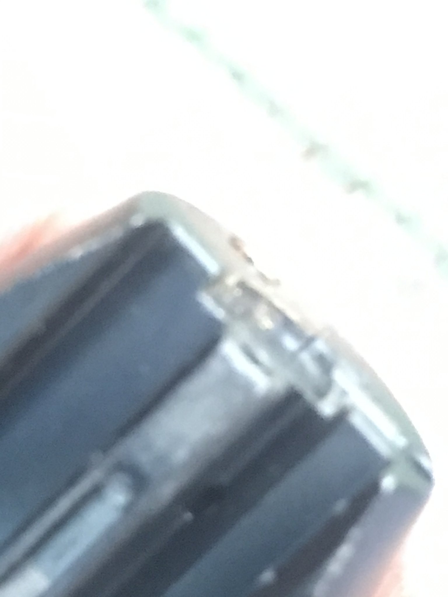

It is possible your mag is dropping slightly in the front. Thus, your round is tilted down going into the fixed extractor and tensioner and not being fully captured as it goes into the chamber.
A possible fix with the KRG Bravo is they have a mag well adjustment, all be it trial and error, remove the barreled action lay that aside. Before making any adjustments insert mag in mag well. Pull it back down into the stop, pull down on the front and see if it comes down. If so, remove mag and loosen the top front trigger guard screw. Then push the trigger guard forward holding it while tightening. Re-insert mag and check to see if the front will pull down any. Just be sure while tightening you don't tighten it to much to where the mag won't drop. Just tighten it to where you won't have play in the front and it will still drop freely. Hope that makes sense and helps !

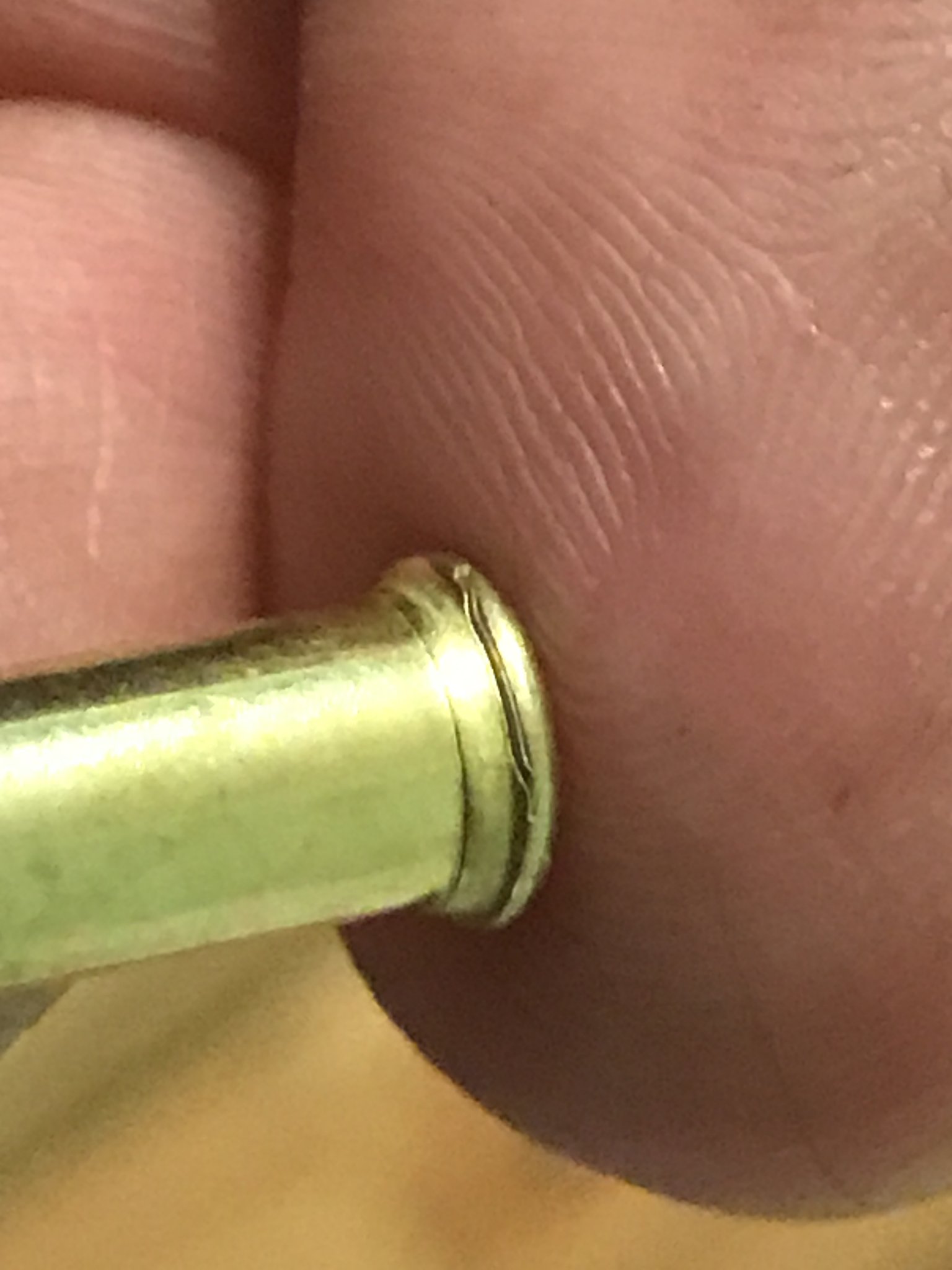

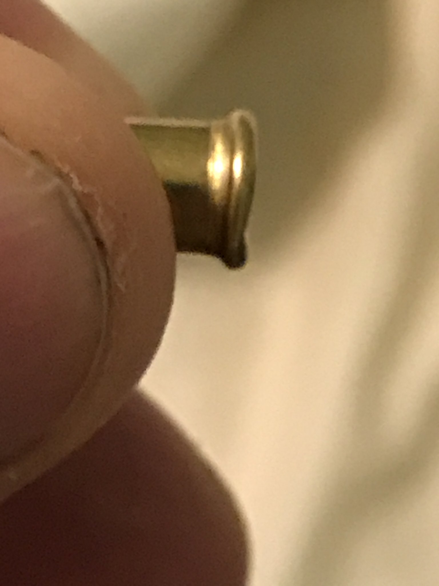

Anyone else have cases that look anywhere near that. Have had enough ruptured cases in the past is 22 AR uppers figured this had to be near that. Not like you need to reuse the cases just safety concerns.
I hate to say it, someone overchampered your chamber. I did that once with a Ruger 10/22 trying to make it feed better. My cases did nearly the exact same thing. Read chamber that with a 52D reamer and be amazed at how well it shoots.
