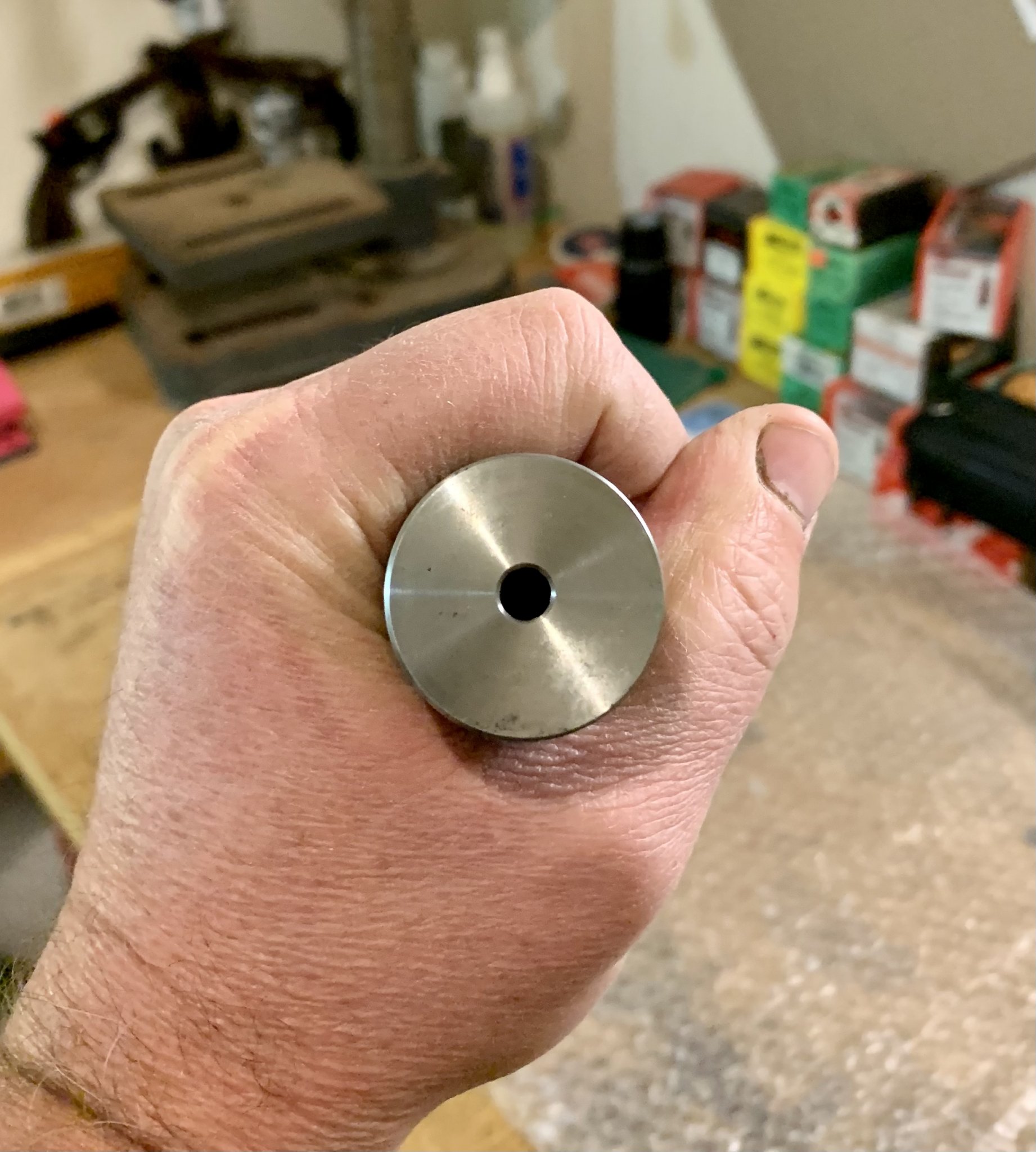

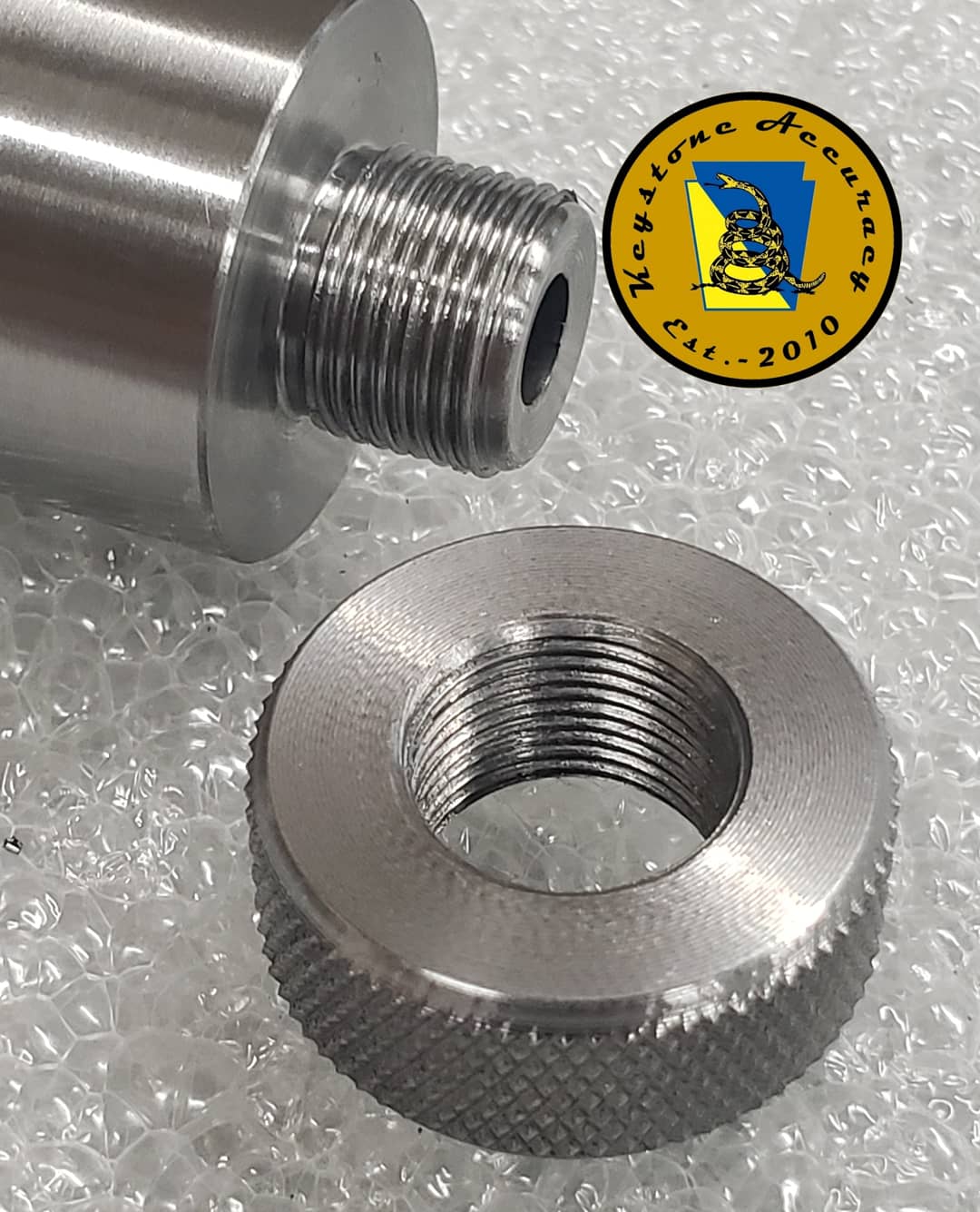

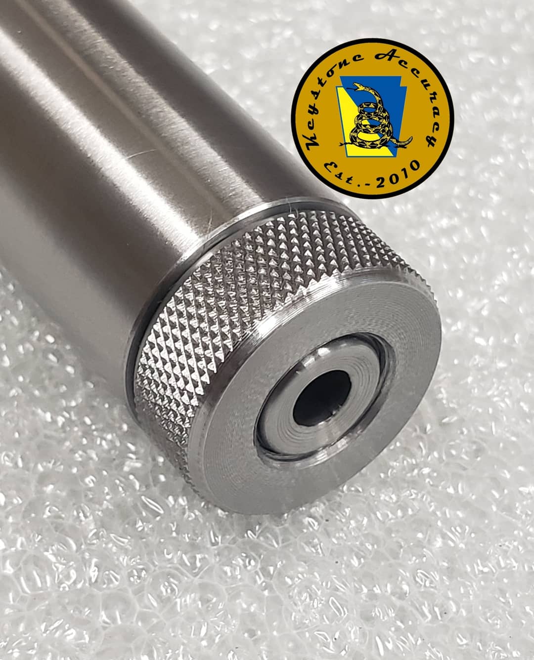

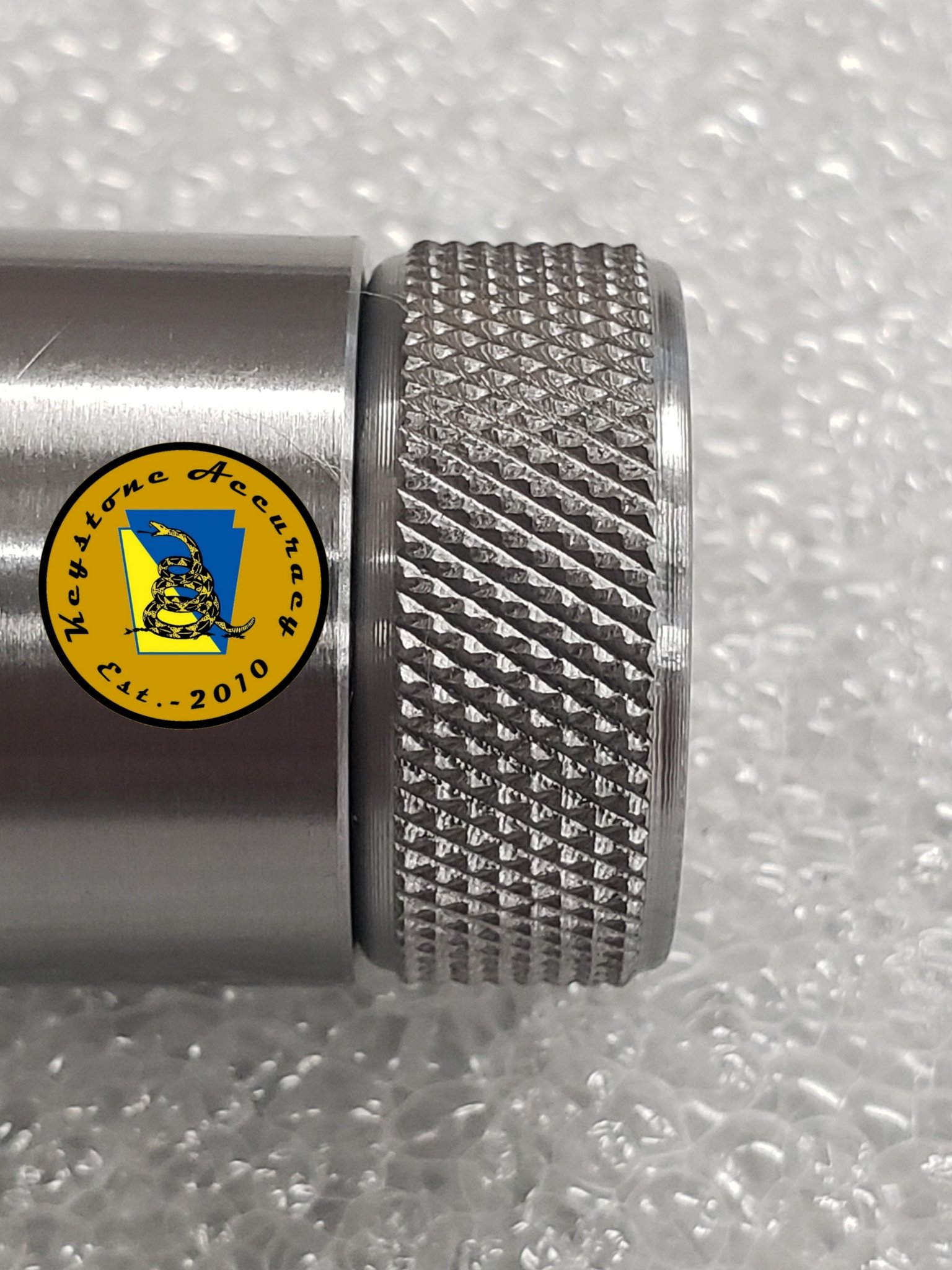

Does anyone know where I can get a thread protector to match my benchmark barrel for my RimX. I thought when you order a barrel that is threaded that it would come automatically with a thread protector to match the barrel.
anyone with a lathe can easily make one
A lot of smiths are not doing blended theead protectors atm since it is not worth their time vs getting the next barrel in. You are better off finding someone with a lathe locally to do it
John at Keystone just made some thread protectors up. Check them out.

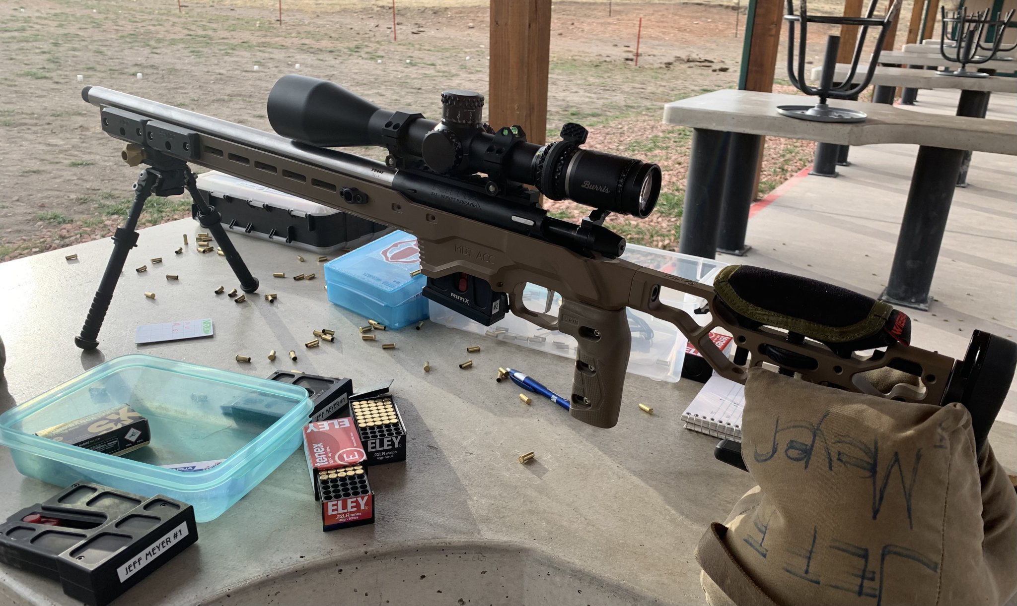

Range Test
First time shooting RIM X, Accuracy International AI AX, 20" BenchMark Barrel, BIX N Andy Single Stage trigger under 1 lb, Rear Homemade Bag, Front Atlas Bipod Extend 2 notches up, Concrete sitting bench, @ 50 Yrds , Wind 5-8 MPH to Light Wind, Lapua Center-X Ammo

Right now with my 18” barrel and chassis weights it weighs 16.7 lbs and still don’t quite have the balance point I want for shooting off of barricades and props. This should take care of that plus get rid of the weights.
