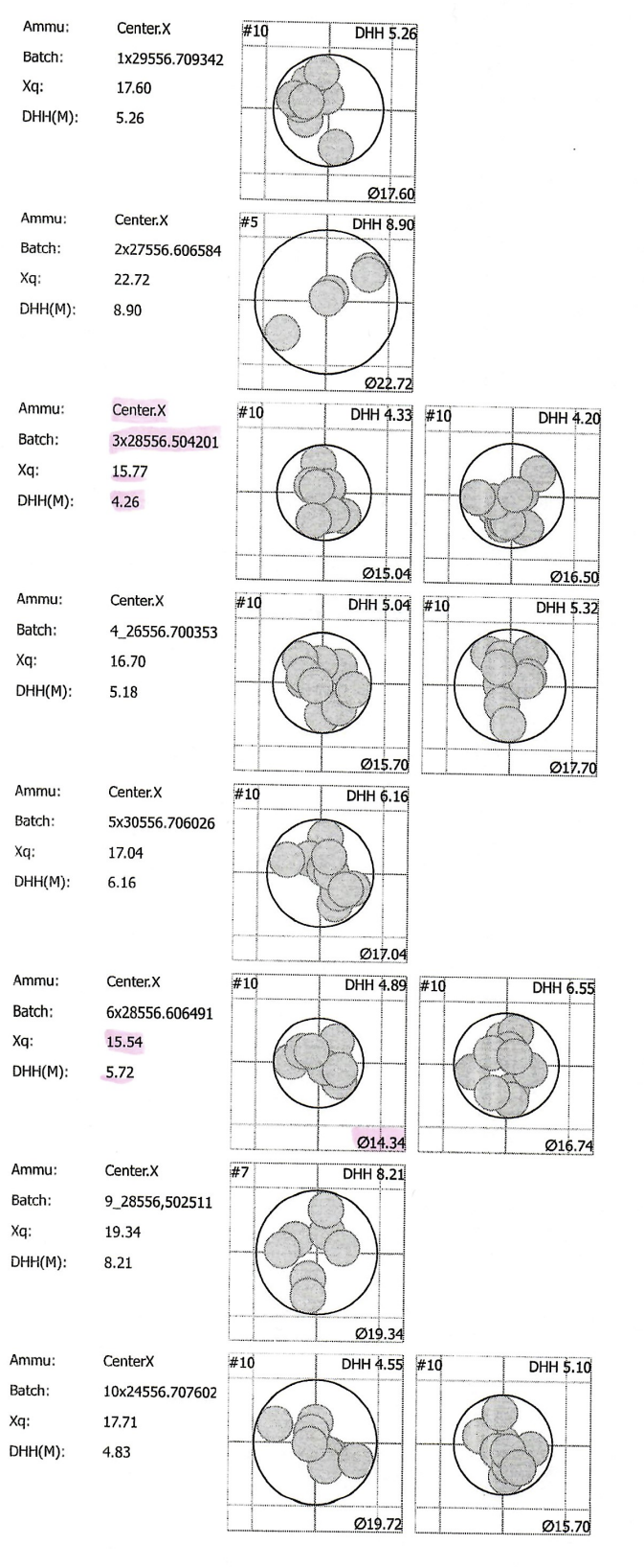

My last lot of CX testing was pretty meh, and some lots did do better than others -

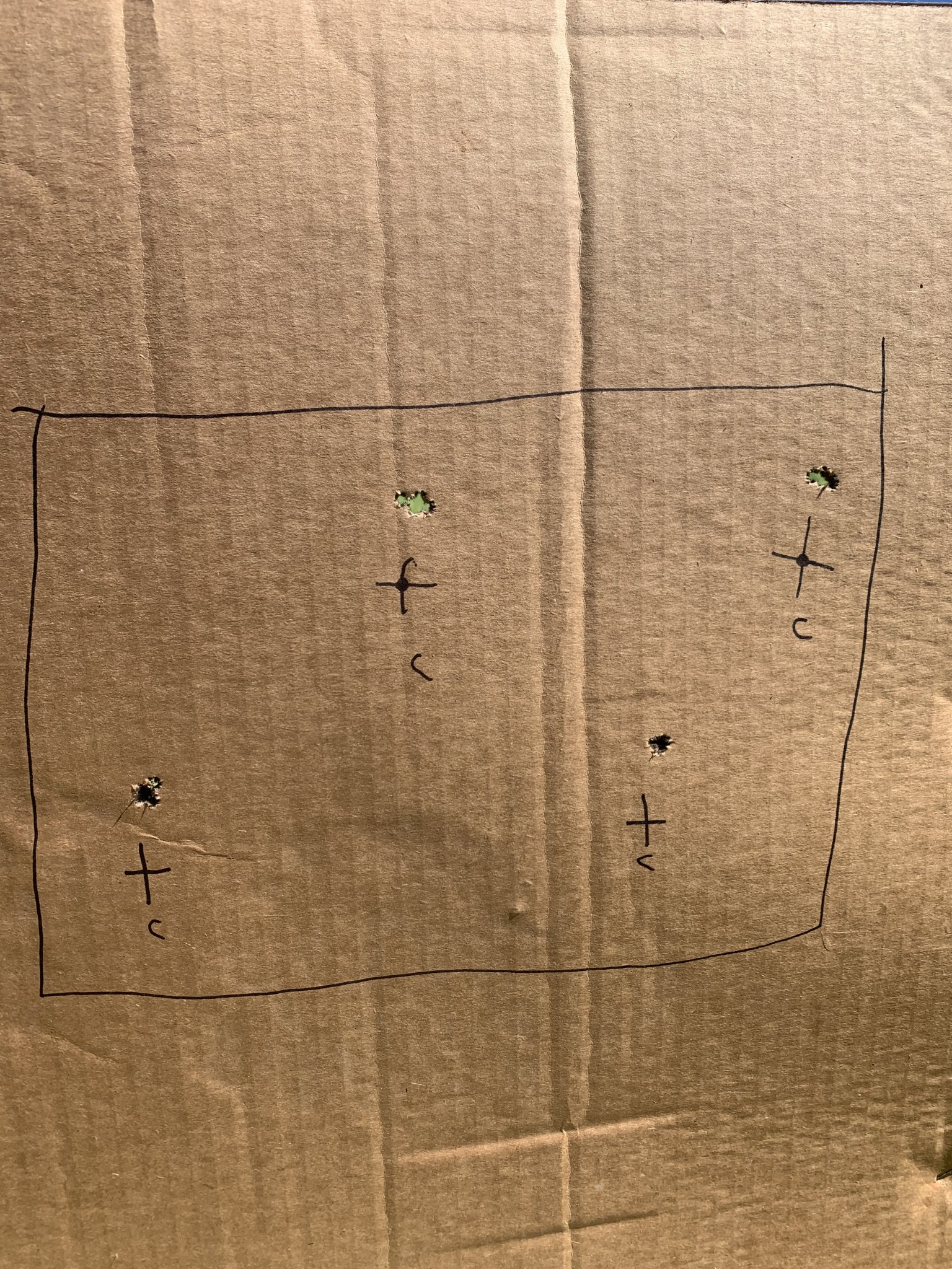

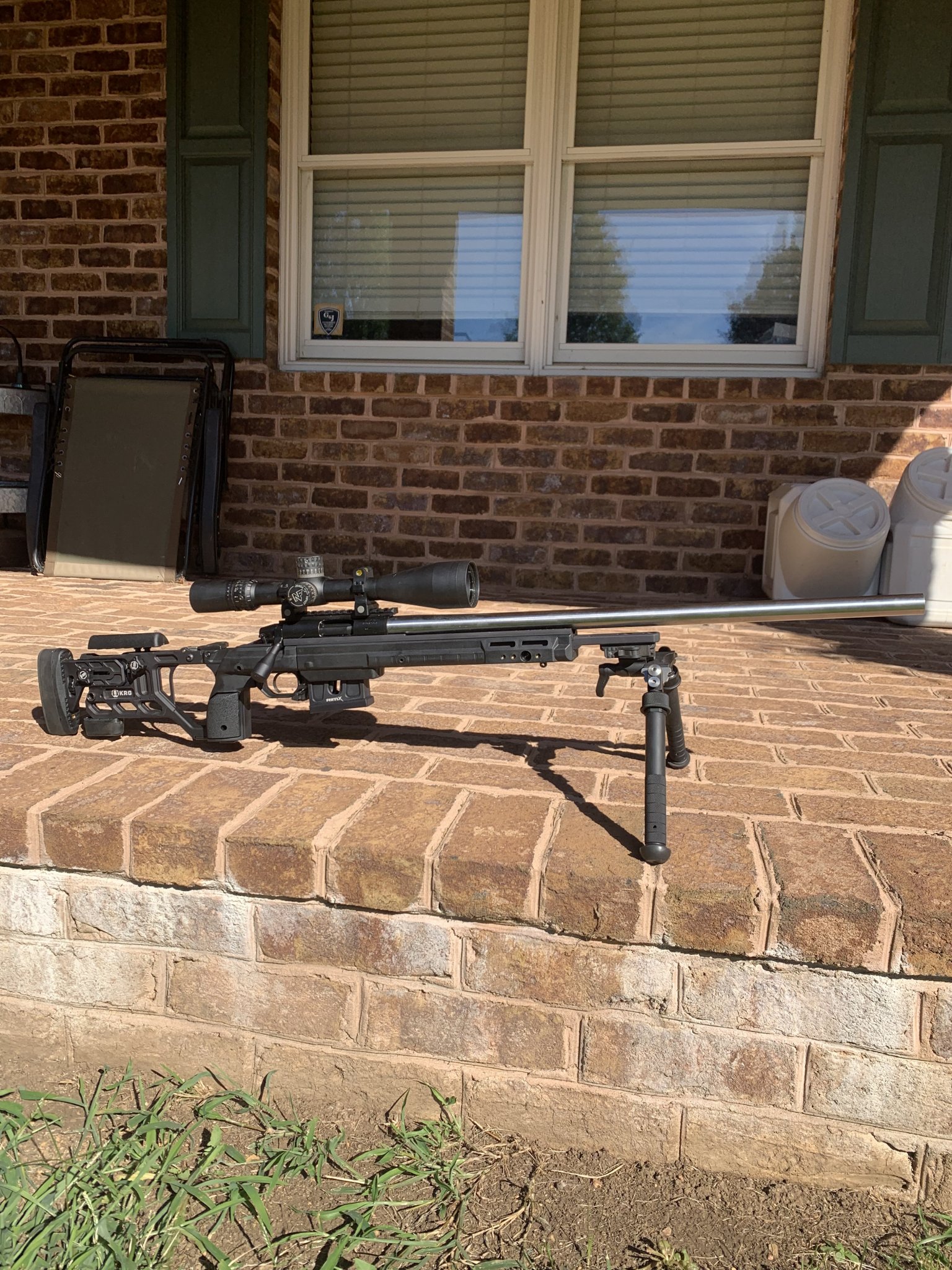

Finally got it put together 26” Bartlin heavy palm spun up by keystone. First time to the range after I got it close to being shot in. I ran 4 5 shot groups with center X. I think it will shoot, kinda wish I did 1 more group for a submission for 6-5. Didn’t have anything to measure it with but it looks tight enough to me. Should be fun
