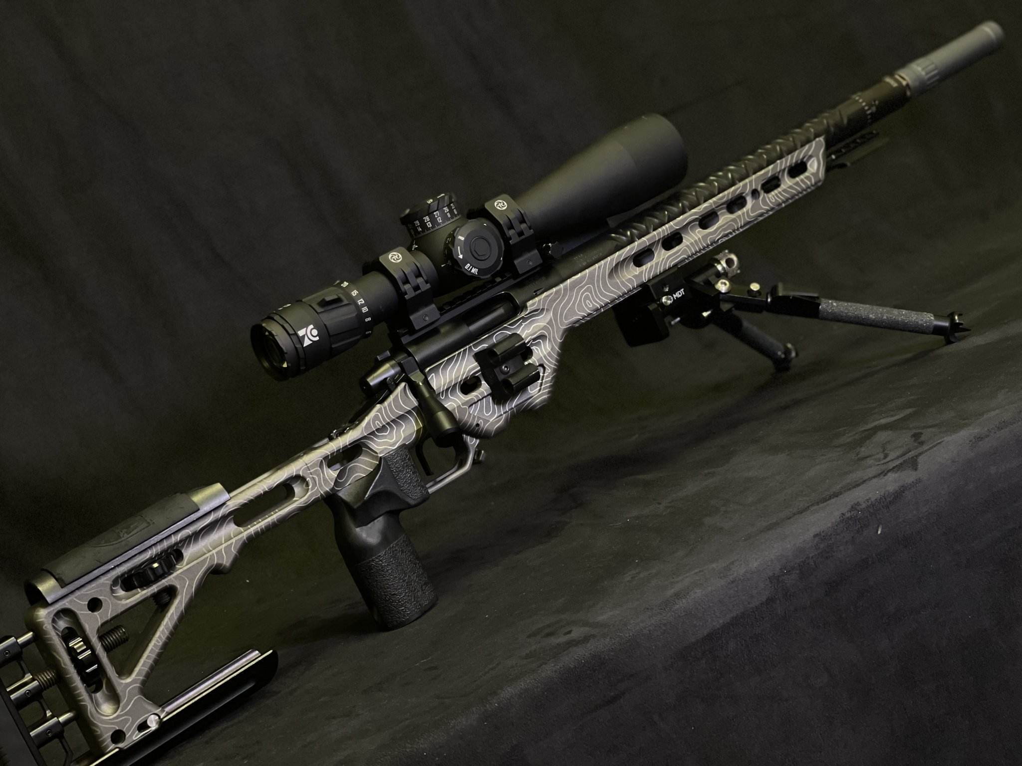

RimX, anschutz barrel, MPA, TT, ARC rings, zco and a ec tuner.

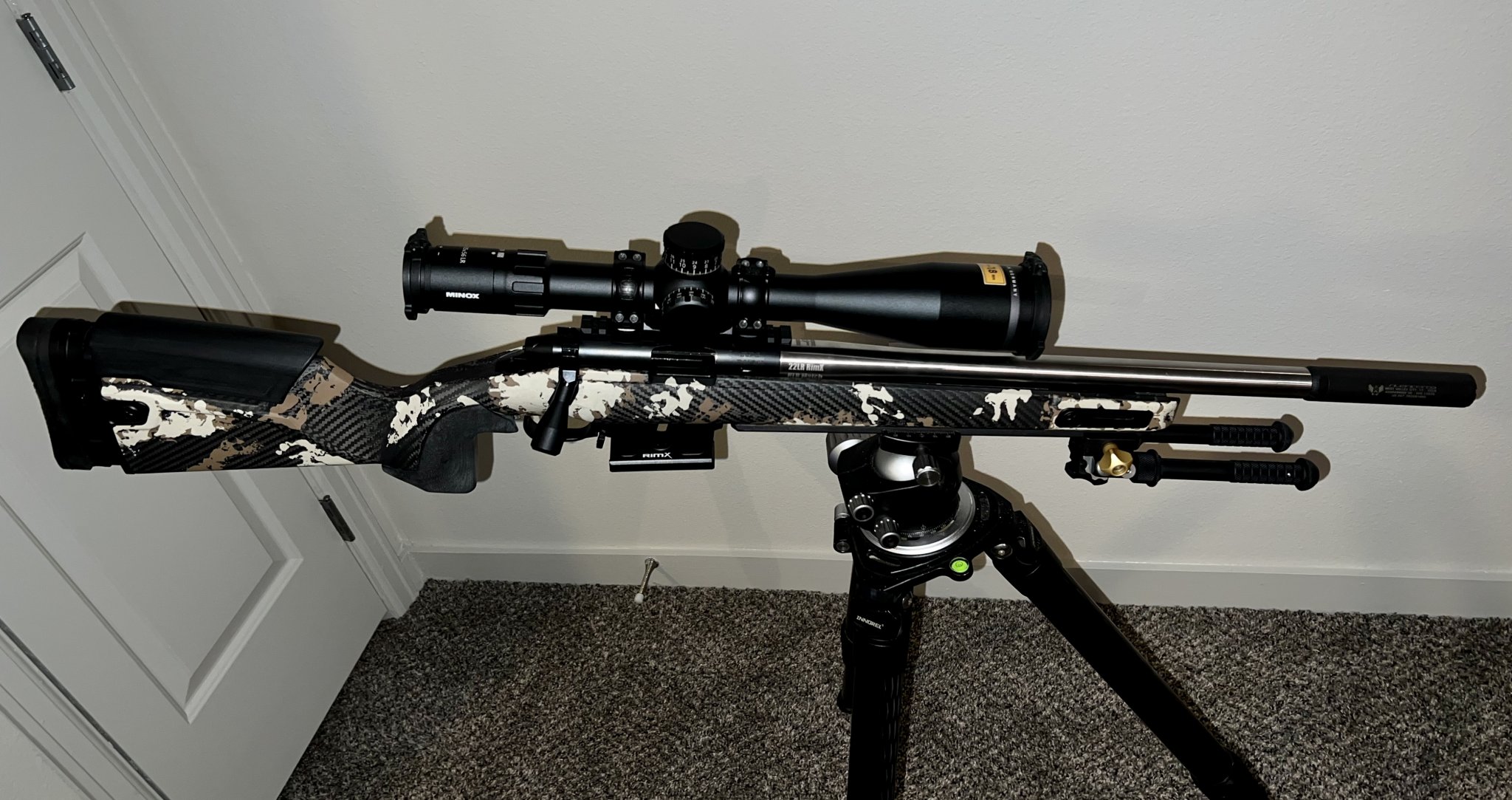

Took awhile, but it's together and a lot of fun to shoot. Bell and Carlson Stock, Zermatt from Northlands. Barrel was a bit of a hassle. Ordered a Lothar Walther from Optics Planet and they kept sending me updates that my order was postponed. After 3 months, I canceled through them and ordered a custom barrel directly from Lothar Walther. After 2 more months of hearing nothing, my order was never in their system. Then the operator said they had the barrels in stock and could pull one off the shelf, well duh went that route. Then I get the barrel, install it myself, and find out that the tennon is too long and can't close the bolt. Send it back, few weeks later get a new barrel. This one headspaces OK and seems to be working fine. No pictures of groups as I haven't had it to 100 yards yet, but I'm sure it will be a performer.
I used one of these stocks on my 1st Jelrod converted 40X repeater. Was an excellent shooter in that stock, with a Benchmark 3-groove bbl chambered with an EPS reamer. No waiting on one of these stocks, unless I want it in a paint color that they don't have in stock - and even then, I can get one in a week. Am looking forward to hearing how your LW bbl shoots once you get a chance to do some shooting with it!
