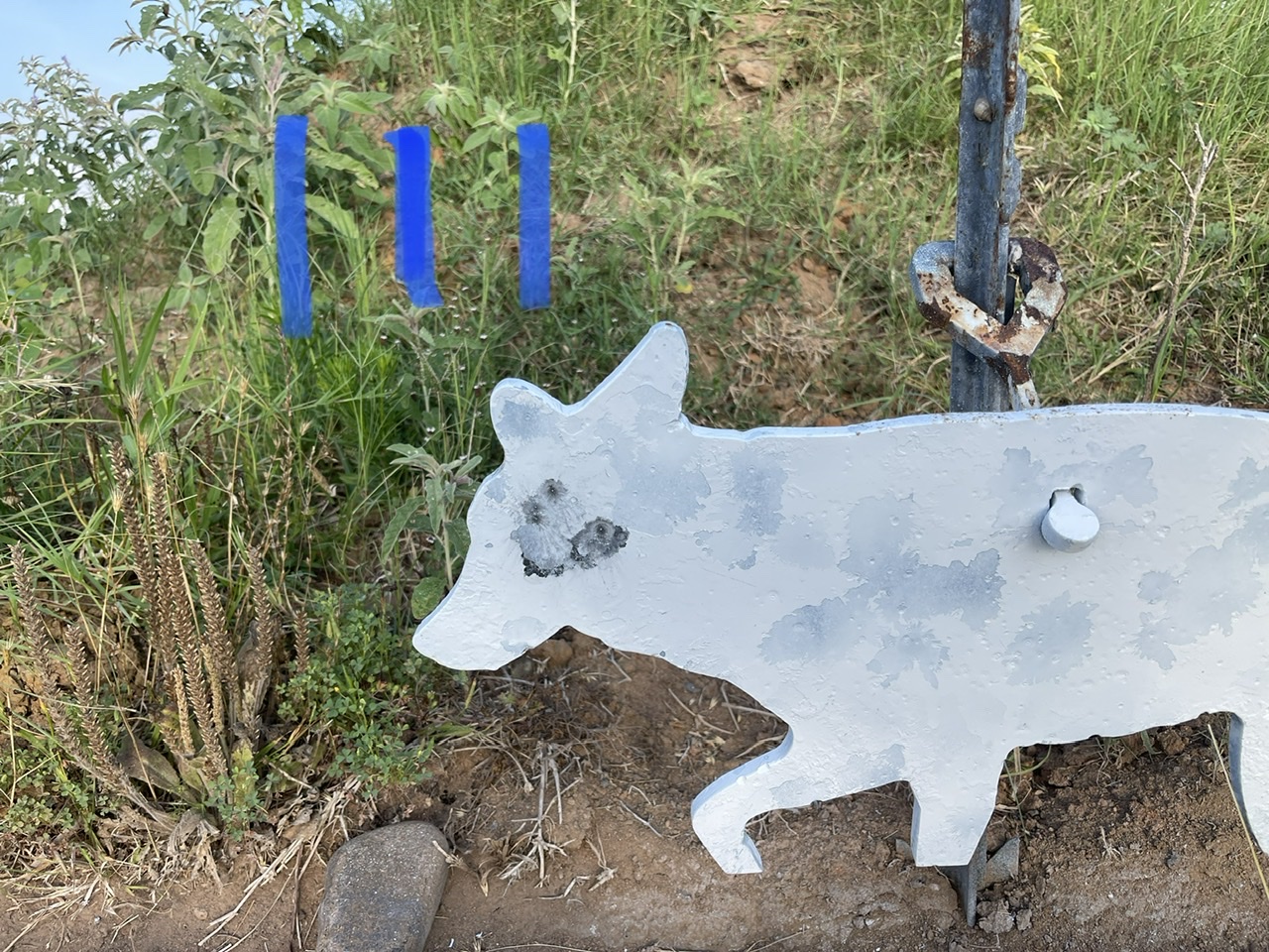

The new Keystone GM axle performed very well yesterday. We had engagements out to 192y and a mover stage at 165. Zero issues running SKRM. Every round fed, fired, and extracted. My dope was pretty much dialed in. The only limiting factor was the guy pressing the trigger.. me. The match was challenging and a few stages had you thinking a bit on what position would be best. I ended up being in a 3 way tie for 14th. A few stages F’ed me pretty good.
Our squad was solid and the match winner was also in the squad shooting a RimX.

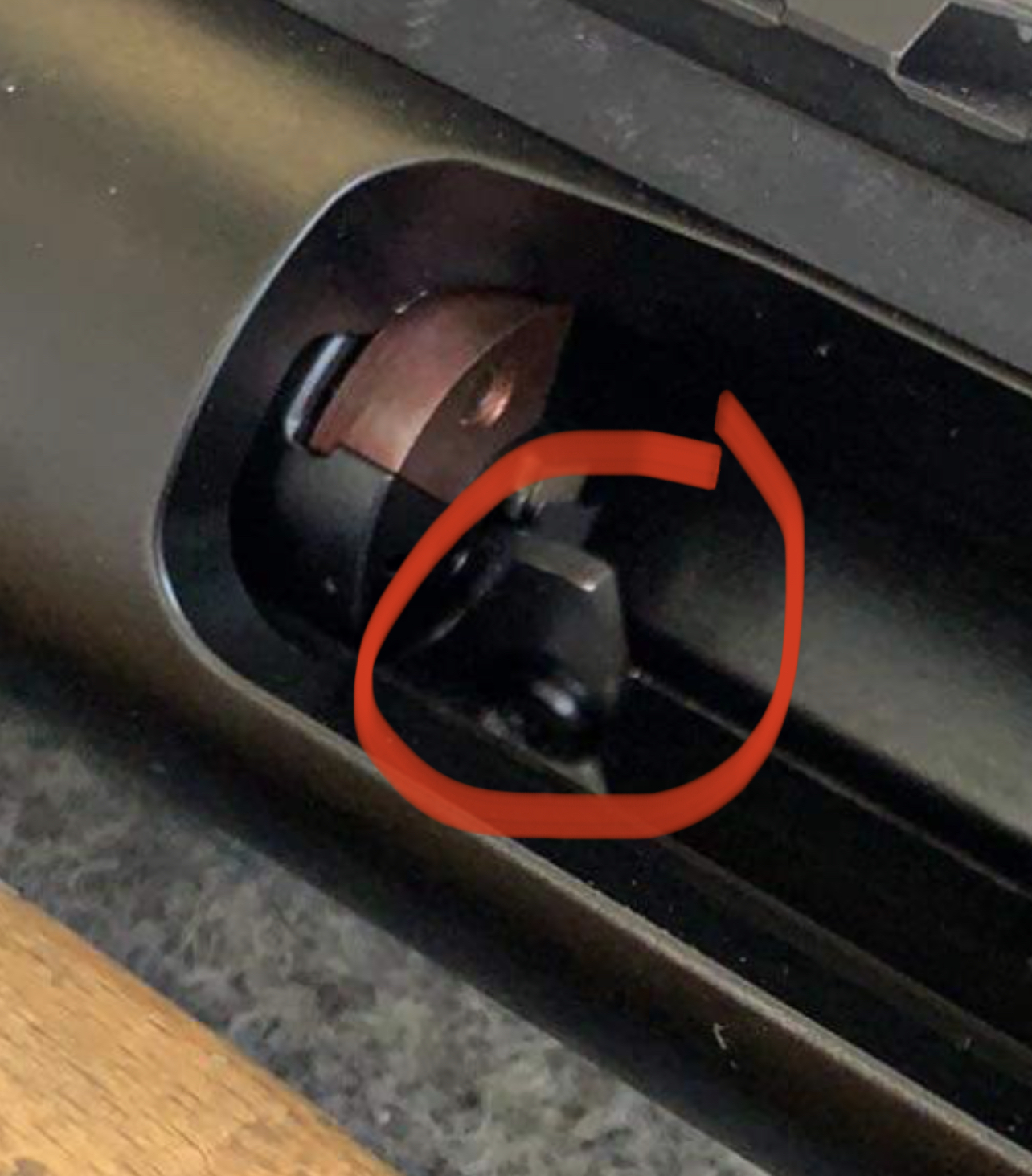

In the mean time I replaced the extractor and now it does not eject at all. (I also noted my extractor appears to be the newer material). I came back here and re-read and it looks like I am missing some key knowledge?
I can ID the extractor, and the tensioner. Both appear to be in good shape.
What and where is the "ejector"?
Think I need to figure out the ejection issues before I tackle mag height tuning. (I can remove the mag and it still does not eject)
So I just around to digging back into this. I called Zermatt and was shocked that a real person picked up and was knowledgeable and helpful. I was waiting for a automated directory, and it caught me off guard, lol. A new extractor and tensioner are on the way.
The ejector is attached to the action. It’s the “blade” thing poking up. If you peek in the port you can see it.

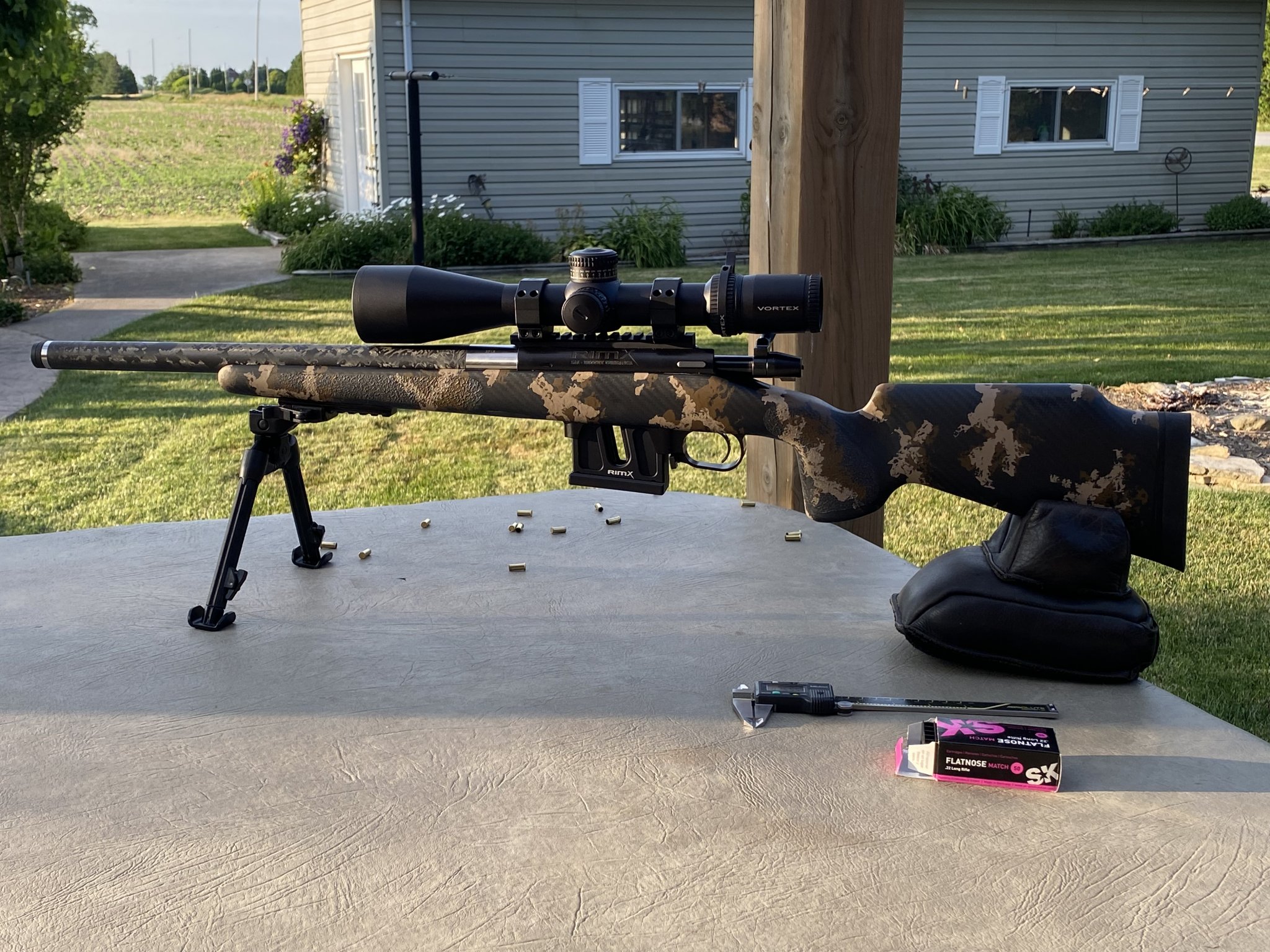

Christmas came early. The "Brown Santa" dropped off 2 packages: the 26" Vudoo Shilen barreled action and the Keystone 24" GM. Rimx prefit.
The Shilen has the EPS Ultimate chamber and the GM the Eachus.
John did a great job on the GM. I am looking forward to making a comparison between the 2 chambers before deciding on which to use with my other Shilen.. I am really intrigued by the Eachus chamber. It is super tight, but allowed me to chamber and extract unfired CCI SV, Eley, and SK. I am surprised because I had "heard" that tight chambers don't always allow this and both of these chamber engrave a good amount. What surprised me even moire is how tight the Eachus is. I have an Eley Ultimate reamer, which is a straight .220" which is one of the narrowest chambers I have seen listed. The reamer will not go into the Eachus chamber. It is very tight and probably explains why it performs so well. Looking forward to wringing these 2 out.
I am totally impressed with the Keystone GM workmanship.

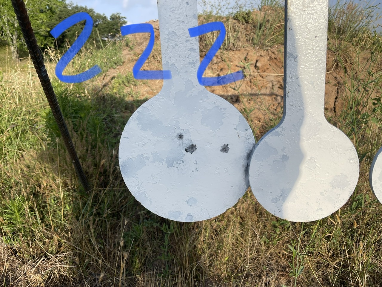

I'm shooting a GM 22" from Keystone that I believe has that chamber and it's been great. Kinda wish I went with a 24", but it shoots well, no issues with feeding/extraction, and is plenty accurate with SK rifle match.

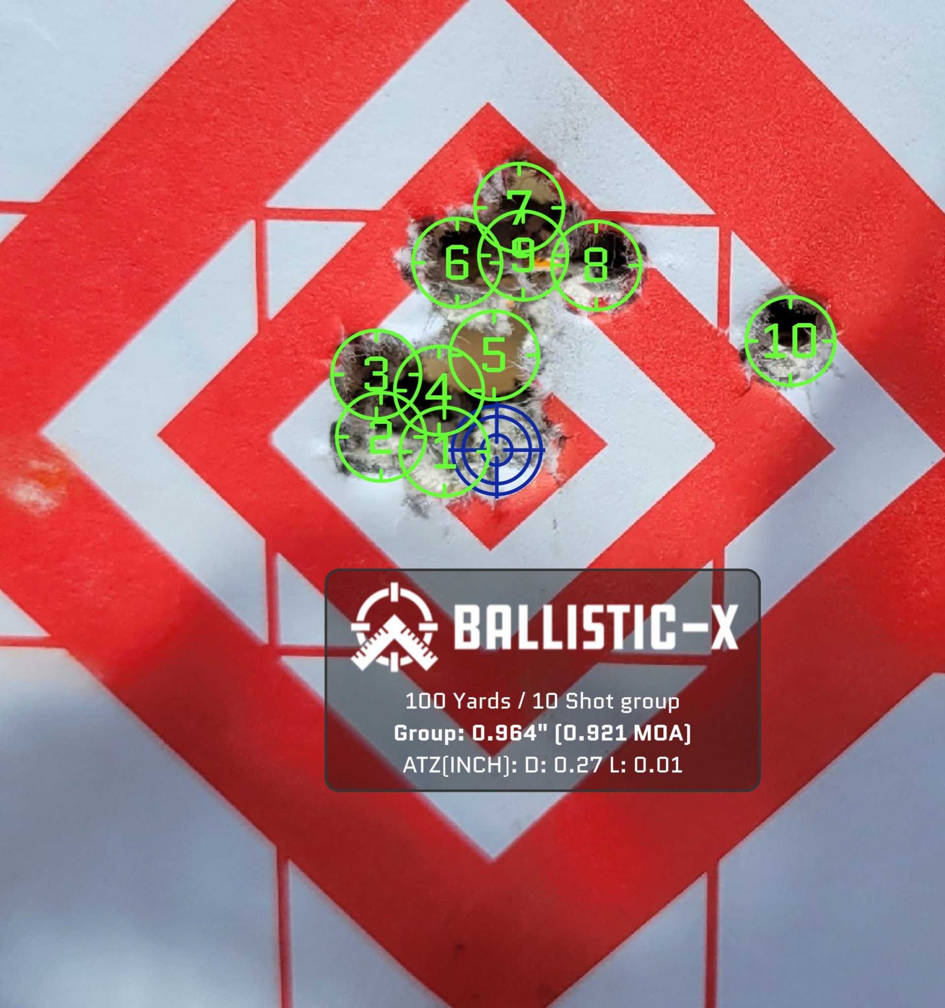

I rarely shoot for groups so this is the only pic I have at the moment. 10 shots off a bench, bag and bipod, shot in rapid succession. The flyer was probably on me.
  • Ballistic-X-Export-2022-06-06 22:41:41.762812.jpg

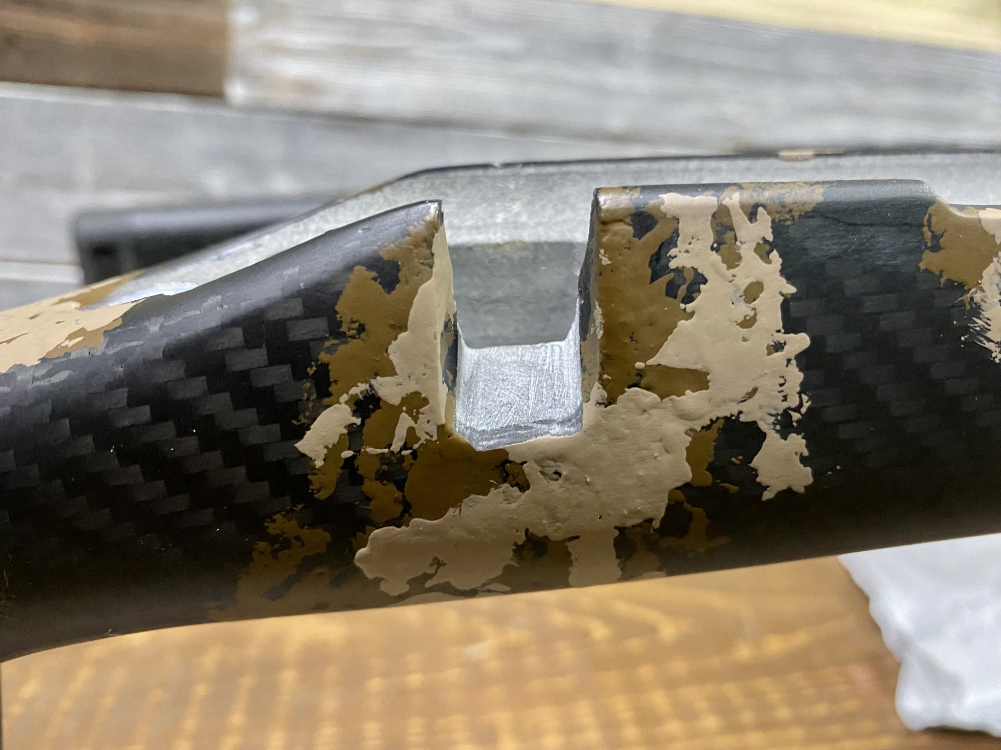

My new stock (Mesa Altitude) came in, opened it up to Hawkins M5 today, and could not believe how much I had to remove from the bolt handle inlet, and I could still remove a little more to get it to close a hair. Is this normal? I had the same amount of interference with my Bergara HMR stock.
I stayed light on the stock, it’s just at 9lbs for a plinker with the strike eagle on it. I would prefer not to carve up my new stock like this…
I stayed light on the stock, it’s just at 9lbs for a plinker with the strike eagle on it. I would prefer not to carve up my new stock like this…View attachment 7901514View attachment 7901518
Open it up as much as needed to positively close with additional clearance all the way around the resting bolt handle. Some stocks can easily accommodate the 20 degree swept back bolt of the RimX others cannot. That's pretty sweet setup, actually been thinking of going a similar route with my second RimX action, lightweight overall with a scope more in the 3.5 to 18 range and a suppressor.
