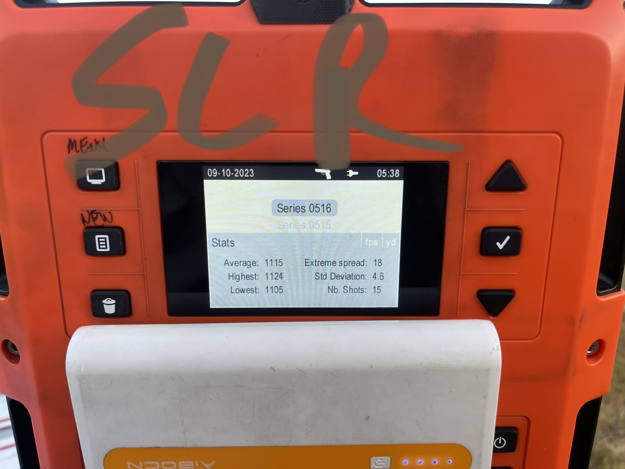

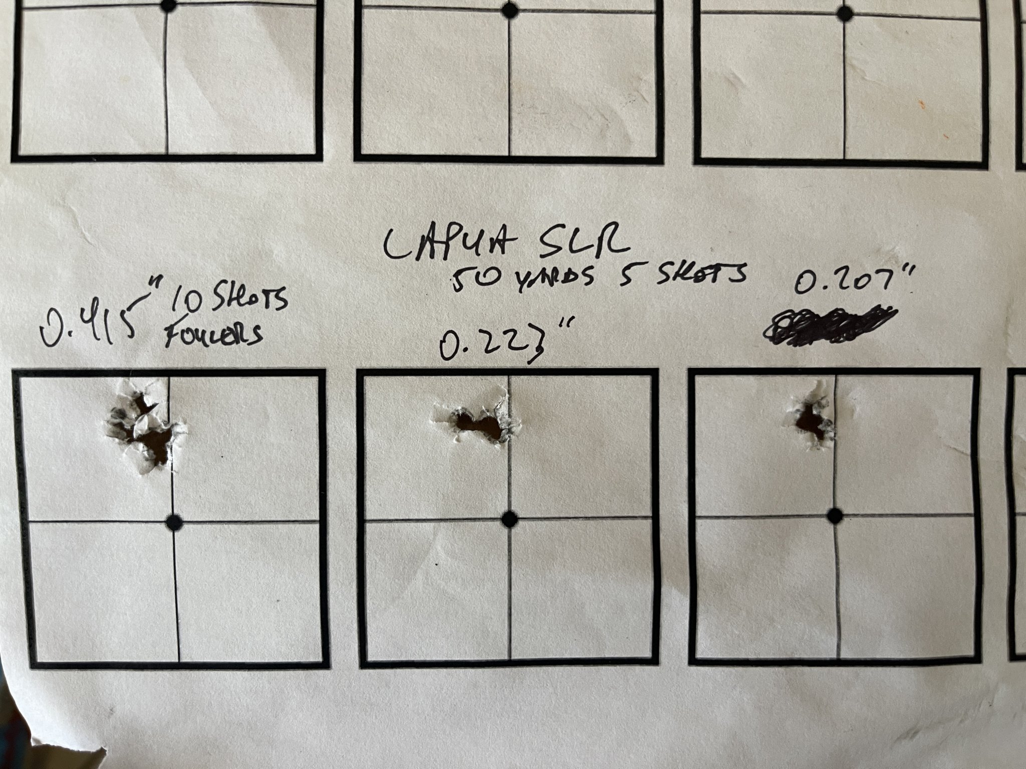

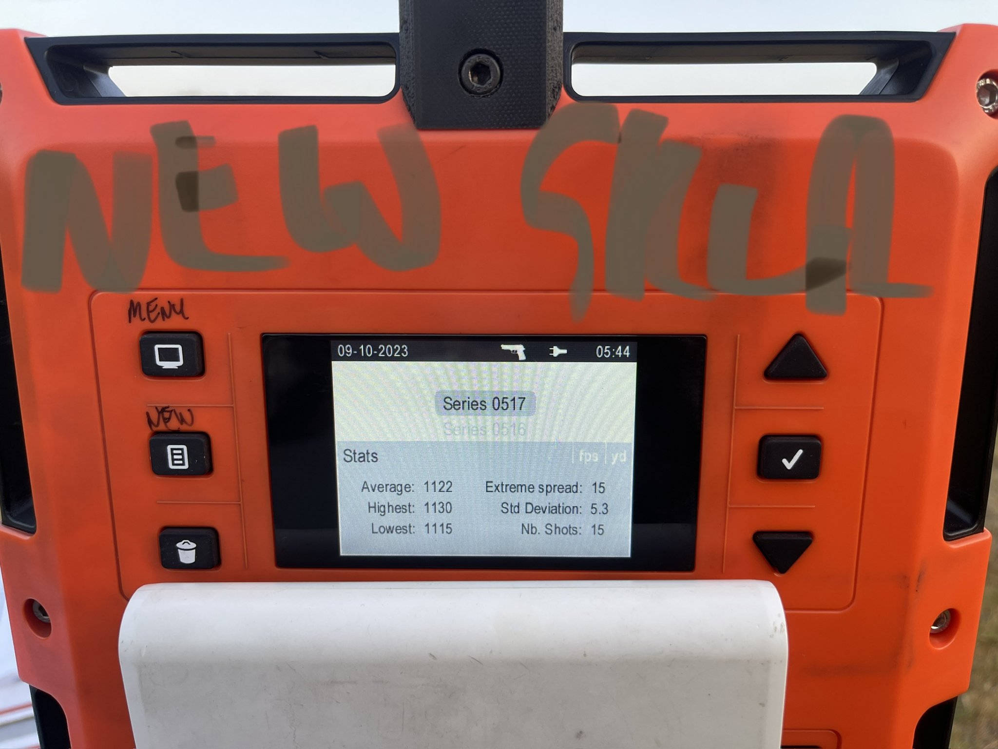

Finally got a few boxes of Lapua Super Long Range in along with new bricks of SK LRM to replenish my stash. I don’t know.. I don’t think the juice is worth the squeeze on the new SLR after today comparing it to the lot of SK LRM I got. Could it be more consistent in the long run? Who knows.
Both lots of the ammo shot almost identical this morning. Numbers were neck and neck as well as group sizes. I’m going to burn up the SLR at an upcoming match.

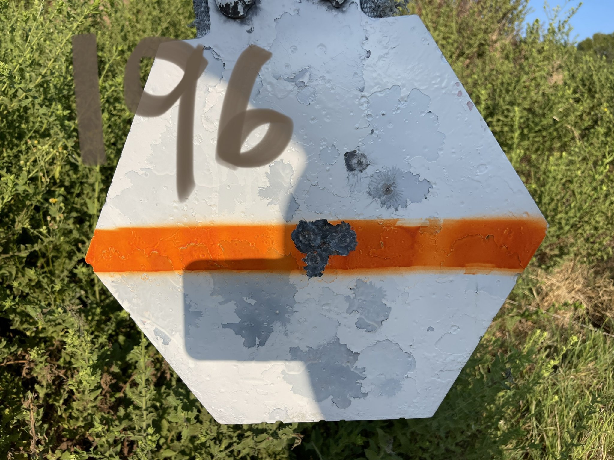

I also reverted back to how I trued dope which was how I did it last season. I’m using G1 instead of CDM and Cal DSF. My truing method today was tweak MV at 100 and tweak BC at 200. I moved to two different ranges this morning to accomplish the task.
At 100, my MV was dead on. I didn’t have to touch anything there. I then moved to the next range which had 96, 196, and 226. Since 226 was the furthest at that particular range, I adjusted BC at that distance. I had to come down 4 tenths which brought the BC to 0.170. I verified at 226 and then went and shot at 196. Stacked them as you can see. The height of the water line was 1.4”.

That's a nice brick of LRM if it stays that consistent. My last 3 lots of LRM were an ES of like 40 and an SD of 9-10. My SLR is similar to yours with an ES of 20 and an SD of 5.

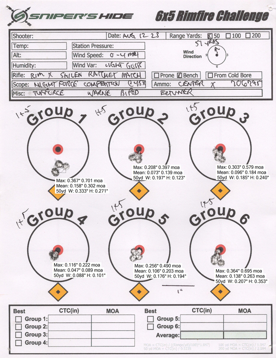

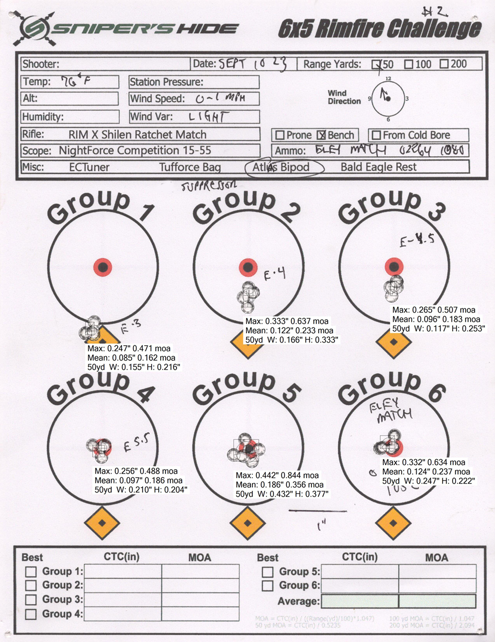

I have a kreiger 22" by Manzella I can test some Eley Match and Tenex this weekend if you want , I can post 6x5 with a shilen ratchet match too. The shilen shoots very very good with eley match and midas plus.
I’d be interested to see that. I’m looking for a chamber that will shoot eley as well. Lapua/sk is a little hard to find consistently
That would be great 😊 I have a Krieger with Mike now. I have a brick of eley match that my Lilja barreled CZ likes. I was going to order some more ammo . I have no problem using SK.
