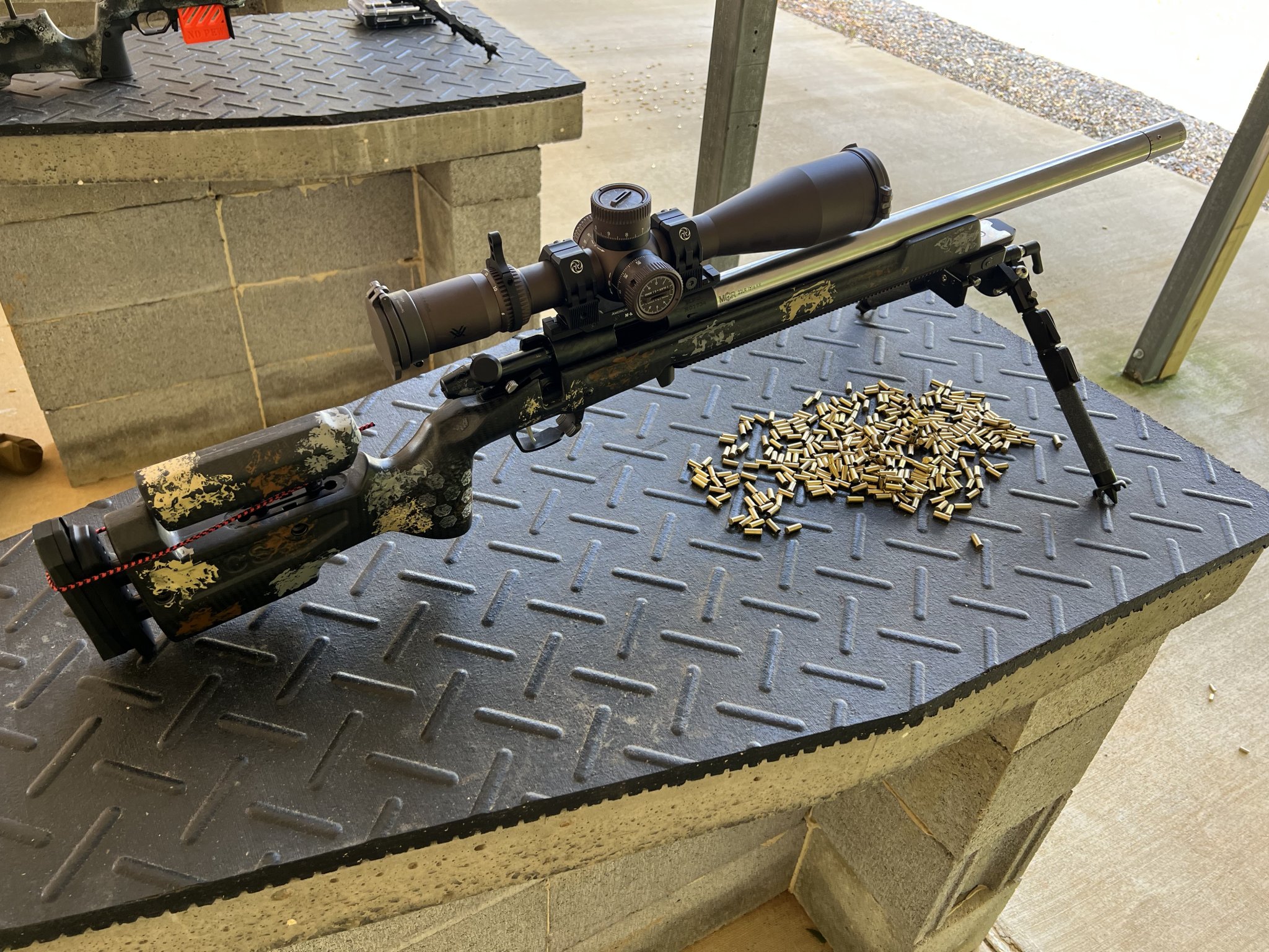

Barrel work done by Mike Manzella with a padom Eachus chamber. Absolutely hammers with Midas+.

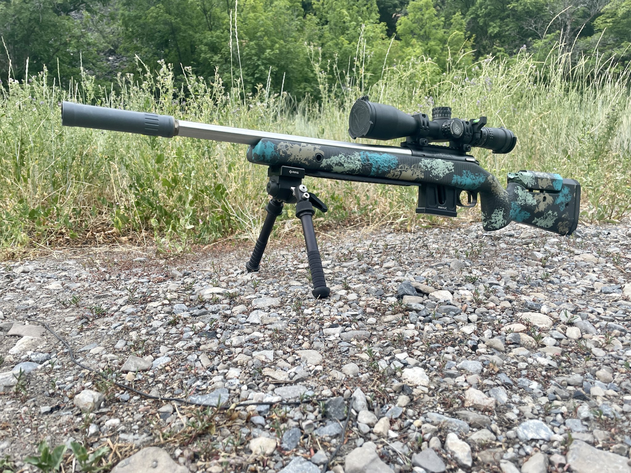

This is a Shilen barrel cut to 22 inches in an ACC chassis. That's a KSS tuner, where the sleeve extends back over the barrel instead of out ahead of the muzzle. You can see the front of the thread protector protruding in front of the tuner.
The tuner is right at 2" in length, so a 20" cut's muzzle would be very close to the rear of the tuner as shown in this (fuzzy) photo.

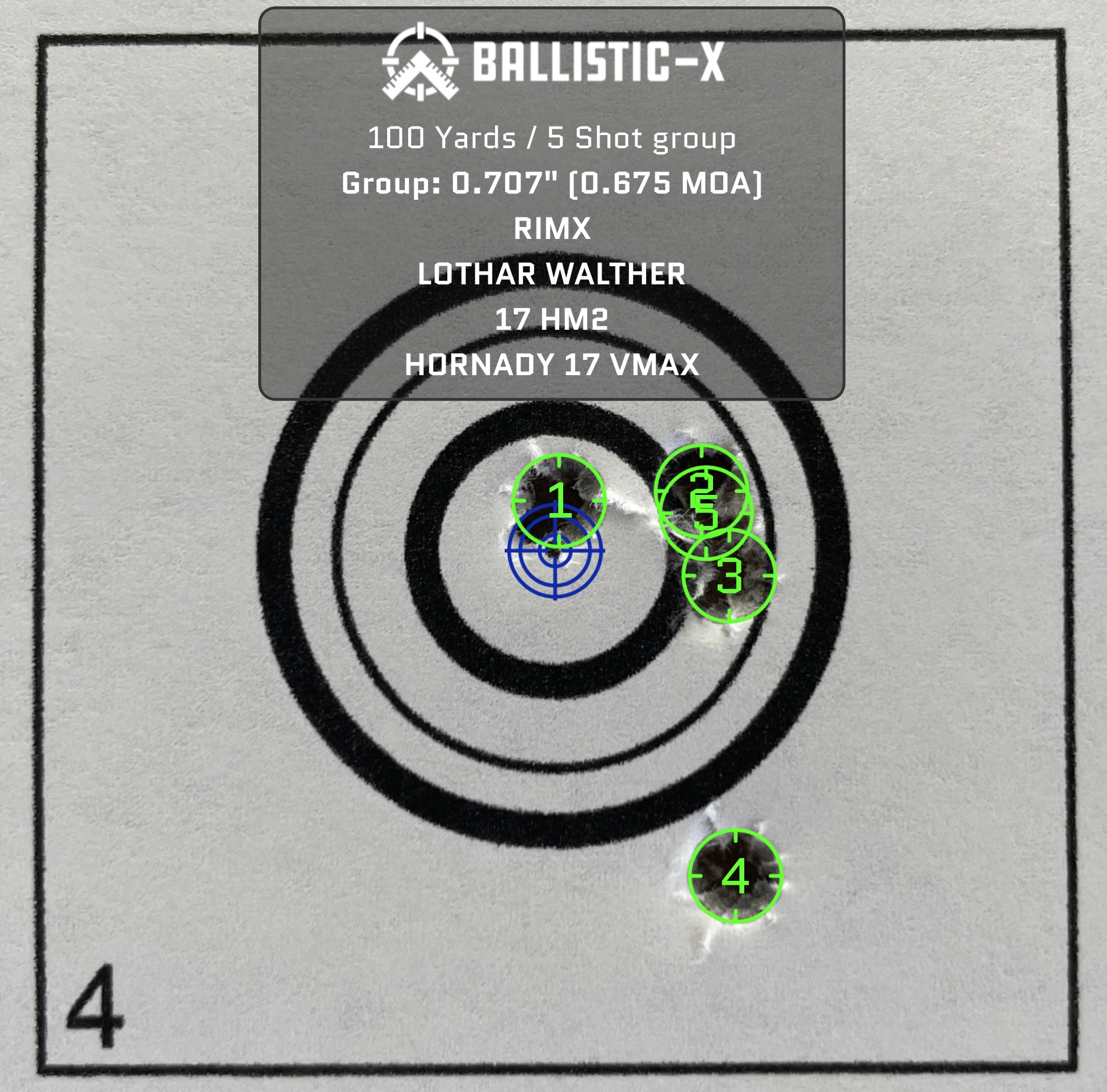

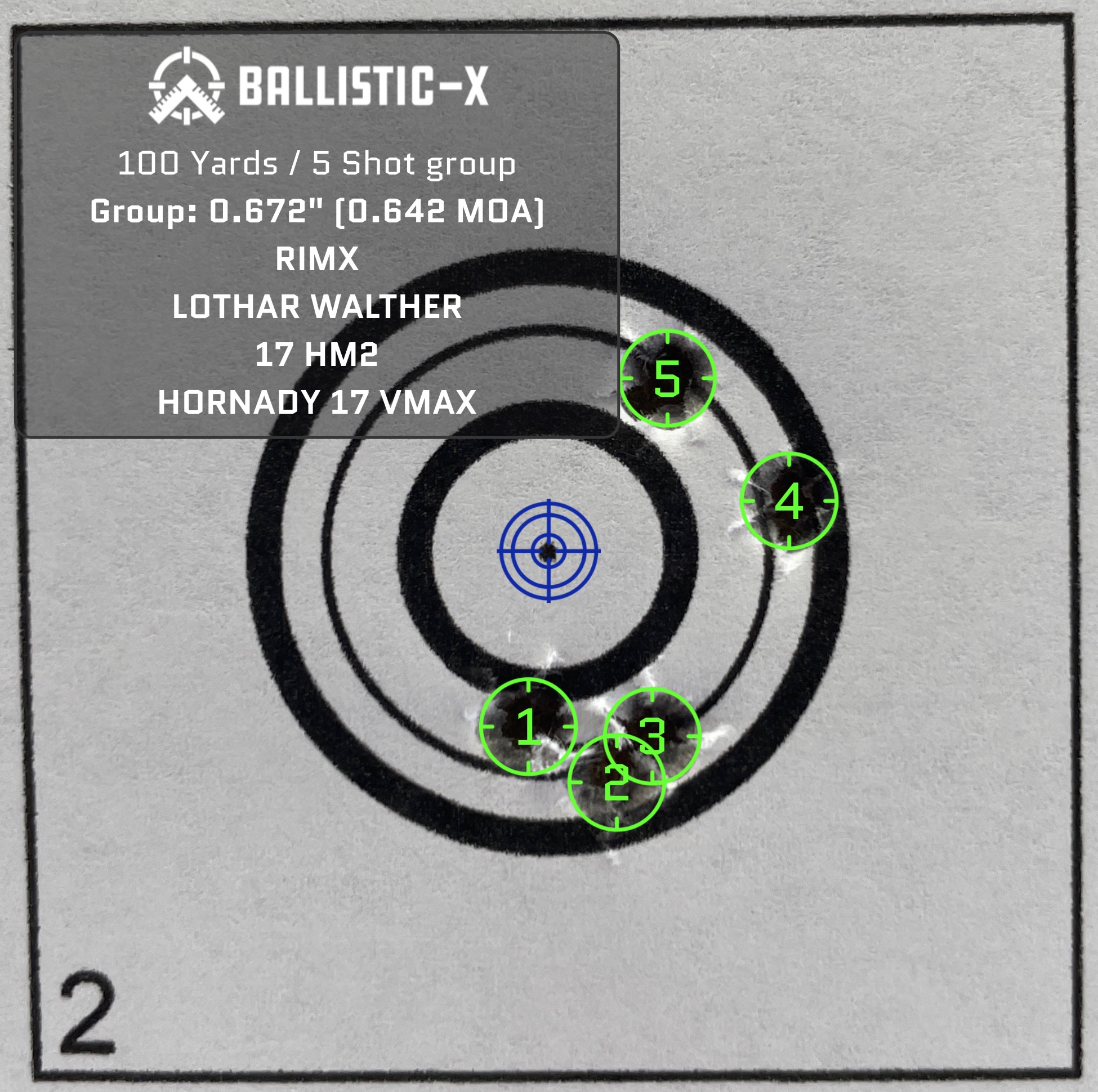

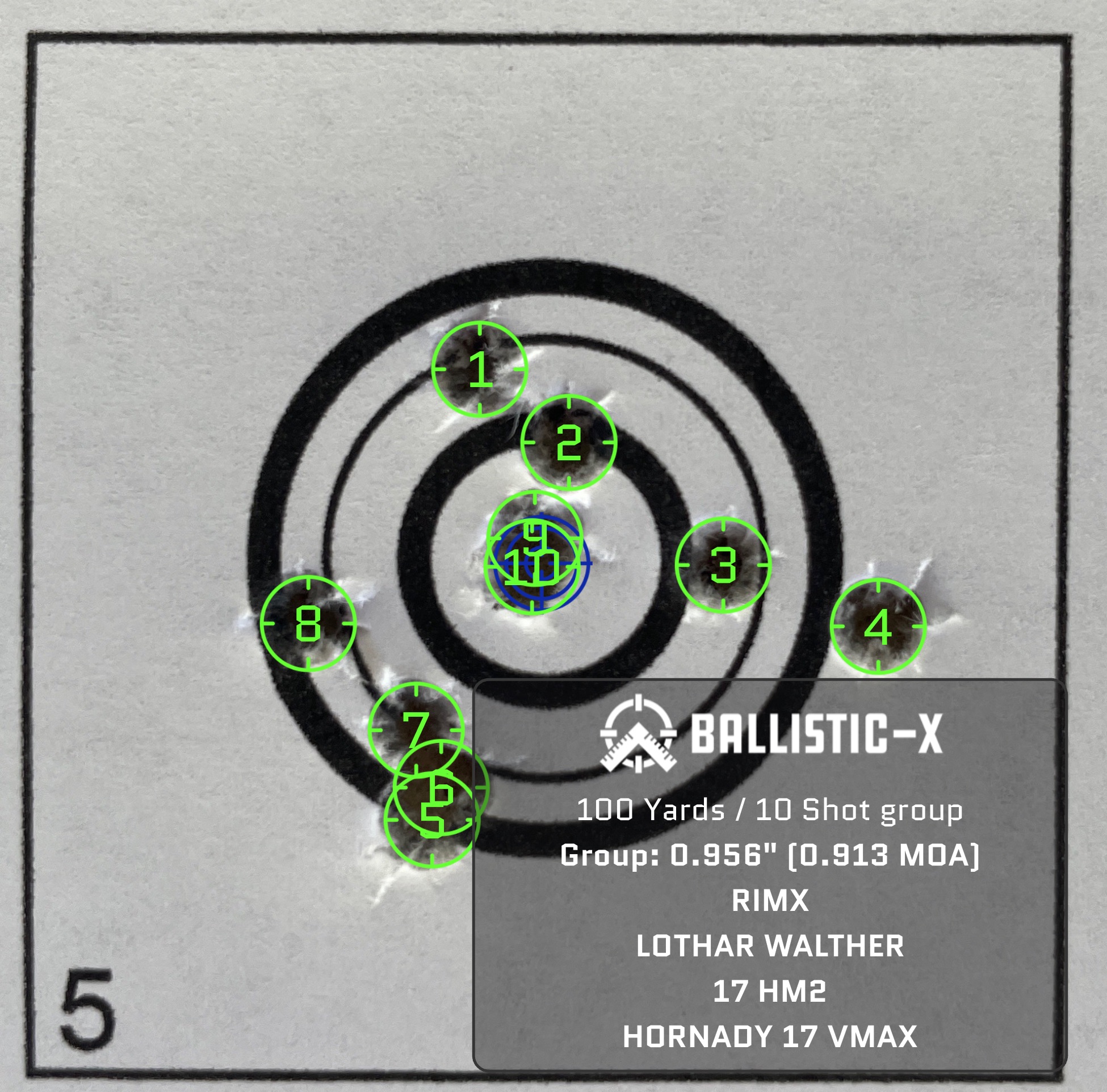

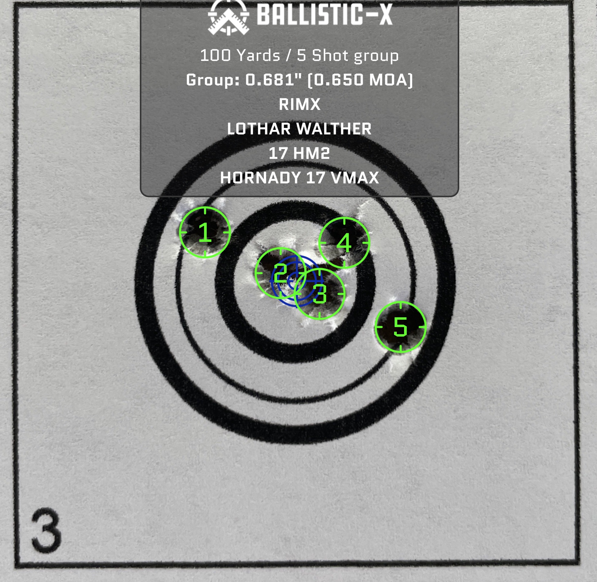

I just got in a a 17 Mach2 barrel from Lothar Walther to try on my RimX. I'm hoping its an absolute varmint zapper out to 100 yards. 🙏

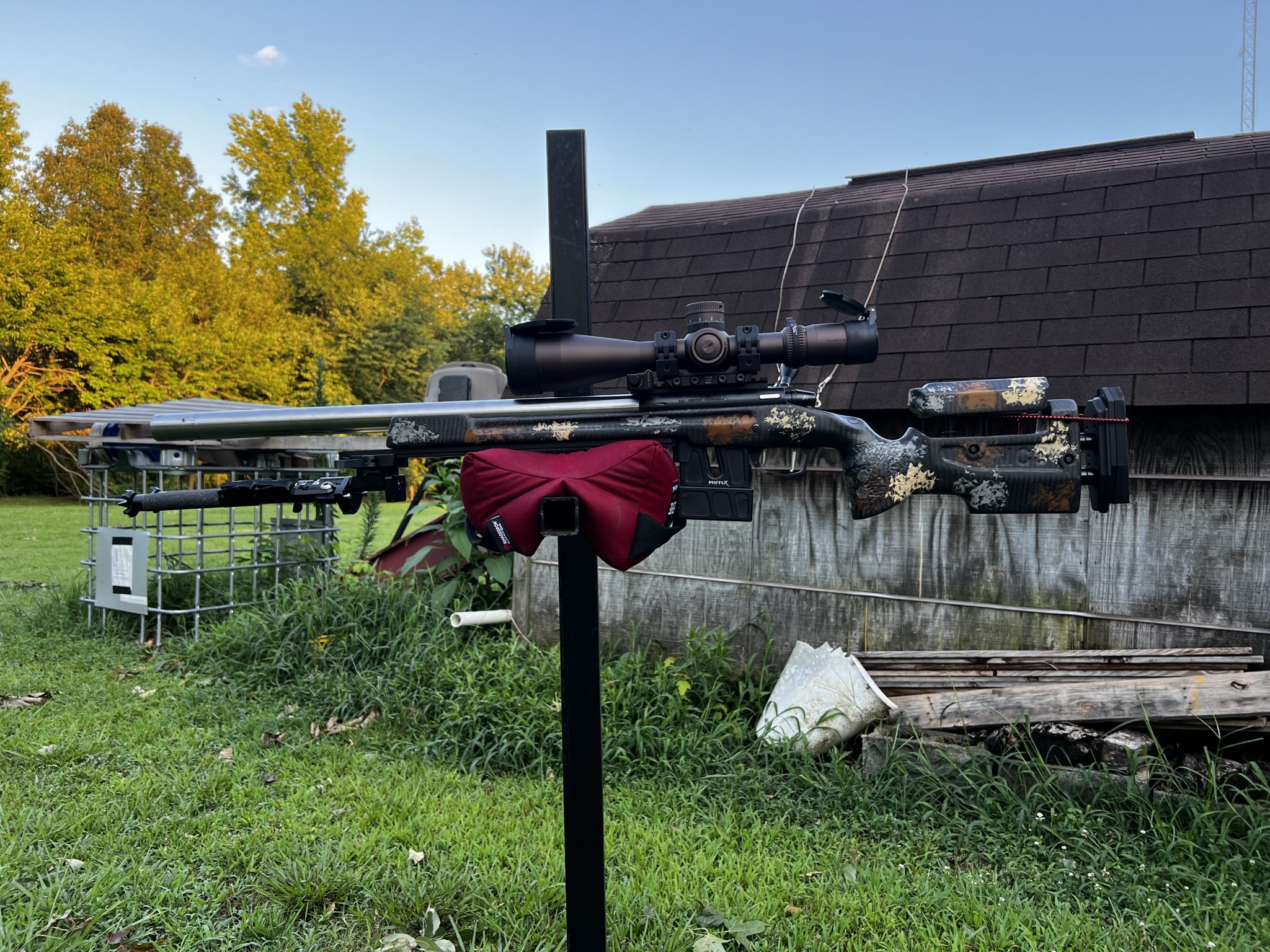

Krieger 16t 23.5' w/ Gen I EC Tuner
Manners TCS Stock
Vortex Gen3 Razor
ARC M-Brace
Modacam Custom Rifles Built!!!!!
19.6 lb as pictured.
Tuner Test
200Y 10 shot group after tuner test.

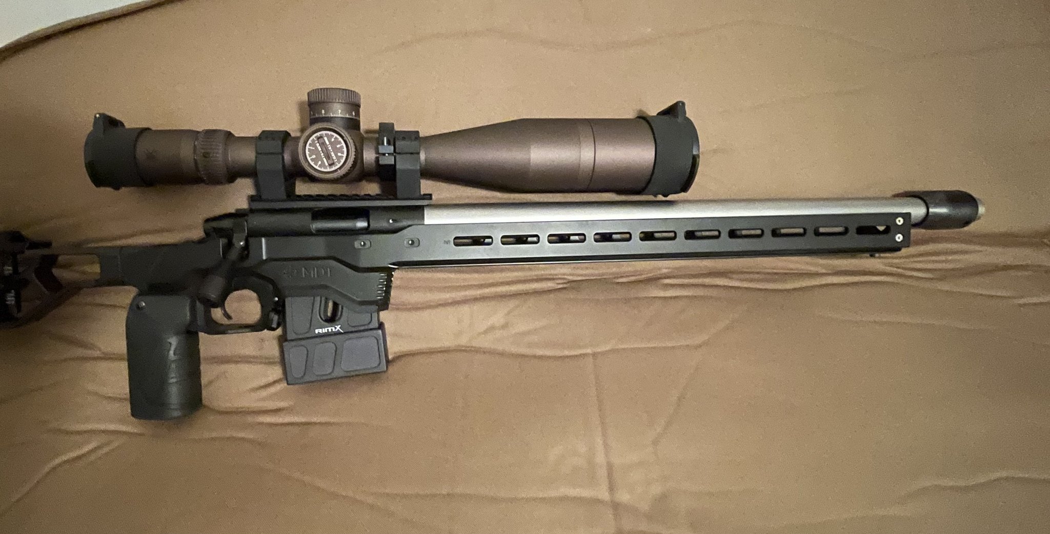

I'm building up a RimX in left hand. I've got optics and a barrel. Action on the way.
Any recommendations on a trigger? I'd love to not have issues, but also not spend 250+ dollars on a trigger. I'm fine with used. I just don't see much out there.
