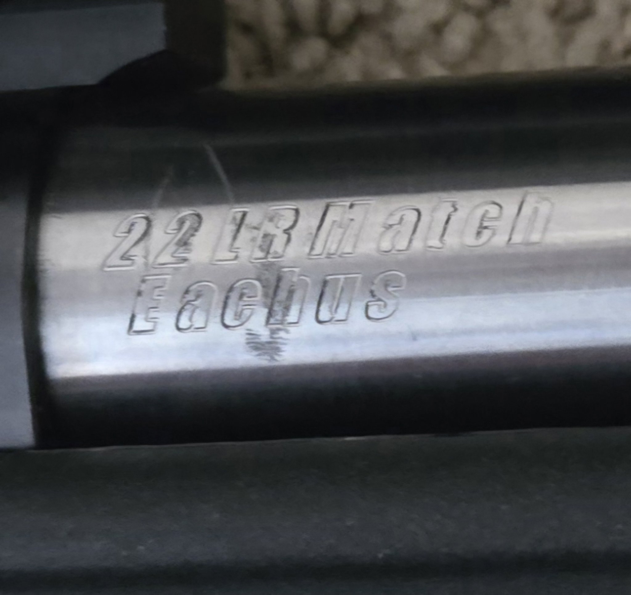

I didnt touch on chambers and engraving in my above reply to keep it as simple as possible to understand what I was trying to say while answer your initial questions..
But to answer your question in bold above about chambers and engraving, I personally believe they play a HUGE part in accuracy and consistency I describe.
Having designed my own (22LR Match Eachus) chamber back in 2018 (with the help of a retiring oldtimer 22LR smith at the time) which has now cut well north of 650 barrels, I firmly believe the chamber has a LOT to do with the accuracy and consistency of a 22LR. Up until I created my owner chamber and had a reamer made, I used and tested close to a dozen different 22LR chambers and had various issues with all of them whether it be accuracy, consistency, ammo picky, etc. it set me out to develop my own.
I would say my chamber speaks for itself at this point. You can flip through the pages of this thread alone and find dozens and dozens of results from myself and lots of members shooting barrels with my chamber with unbelievable results across a range of ammo and distances. I have found in my extensive testing of 39+ RimX barrels tested and over 27,000rds of various high end match 22LR ammo that the chamber, combined with a specific amount of engraving makes my combination not ammo picky while providing excellent accuracy and consistency from 50-400+yds.
About engraving, in my initial testing with my reamer before the RimX was released, I found a specific amount of engraving that gave excellent accuracy and consistency on CZ455/457s and Vudoos. These are the rifles I was shooting for years up until RimX's release. I ran multiple CZ barrel fitting and installation group buys for Green Mountains, Bartlein steel and Bartlein Carbon Fiber barrels. Now, because this was before RimX, we were setting headspace and amount of engraving based on Lapua ammo which is what I shot primarily back then (before it became so hard to find consistently). Every person here on SH that took part in the group buy had to send in their actions because every barrel had to be hand fit to their action and headspace. (Again, another reason why we love the RimX, they are so consistent) The accuracy we were achieving with these CZ's and Vudoos with my chamber and the engraving I found was excellent.
When the RimX came out, and we through set headspace out the window, I still required the specific bullet engraving I wanted from the smiths I was working with that used my reamer and cut my barrels. This translated to again excellent accuracy and consistency but this time across all types of ammo, Lapua/SK, Federal Gold Medal Match and Ultramatch, Eley, RWS, etc.
Today, the smiths with my reamer still cut and chamber ALL their barrels to engrave Lapua/SK the way I instructed from day one and the results are still what they were back during my initial testing. I know this because I still get new RimX barrels cut by the smiths to this day and test for accuracy and consistency and compare to my extensive database of results from previous testing. I have another 2 barrels about to by cut right now from my smith for continued testing. Now, cutting a chamber and setting engraving is just one part. Properly finishing a 22LR RimX chamber is very important as well, especially for feeding consistency.
So, just because we dont set headspace based on ammo anymore with a RimX doesnt mean chamber designs and engraving go out the window. They are extremely important along with properly finishing a chamber after cutting..
