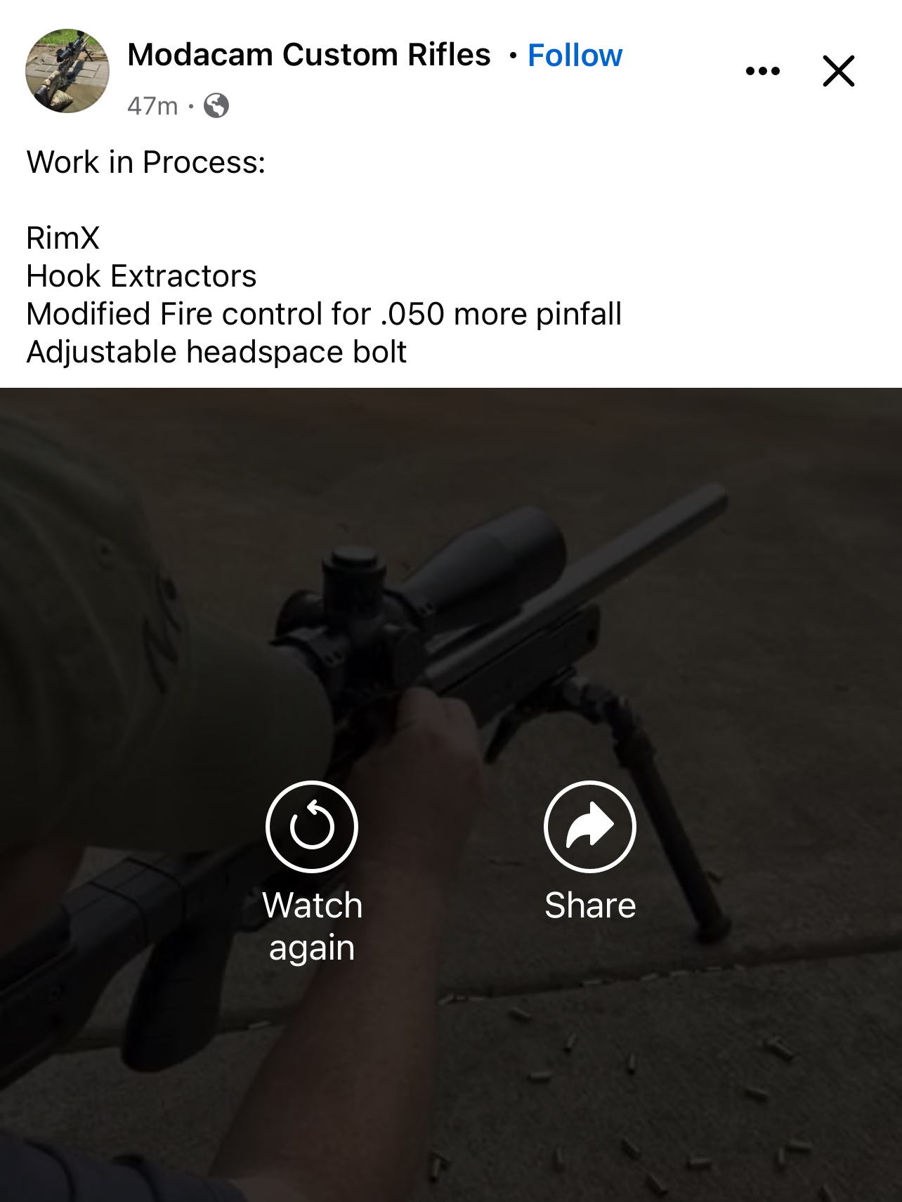

Not my picture. It was from Modacam’s FB post. Interesting..
This changes the design of RimX entirely.. you now need to have a reamer and set headspace for each ammo type you plan to shoot for proper ignition just like any other rimfire that came before the RimX.
That's why the RimX design is so revolutionary for high accuracy rimfire repeaters..
I have no issues with my RimX. This isn't necessary IMHO....🤷‍♂️
Also, you now need properly timed extractor grooves for thus. There goes all your prefits. Full custom timed barrel now.. at that point why not just go Vudoo instead of voiding warranty and cutting up your bolt??
The RimX is a very well made action. This conversion won’t be for everyone and that’s fine and is not the purpose . A lot of people like the idea of a Vudoo with a RimX mag. I more like the idea of a RimX as the base. I just took the things I liked the most from both and put them together to create an option. This particular one is my personal rifle and I also added some other modifications for experimentation. Zermatt is not changing anything here. I get asked for a lot of things and these are merely options for the ones that want them.

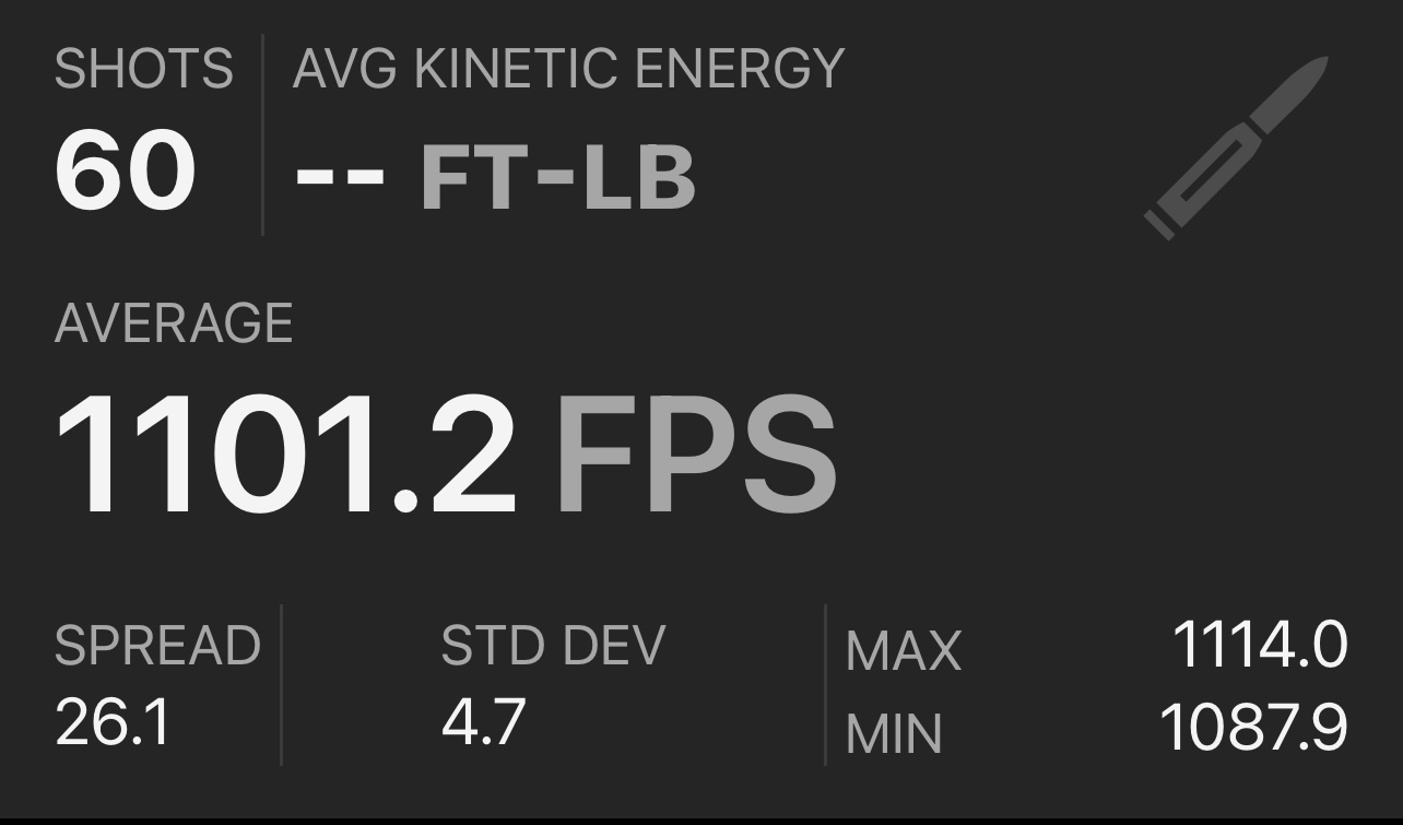

What length is your Ace? Did you chrono your ammo ?
Hi, Mike just called me and explained the situation. My Ace is 24" and putting Eley match at 1120 fps, my 21" Lilja barrel CZ puts the same ammo at 1130. I did show a flier in the photo but attributed it to myself. I shot it a fair bit today out to 300 yards and was very impressed. I'm off work again tomorrow so I'll try a few 100 yard best groups here at my place. I guess I've put about 600 rounds thru it. Super impressed that Mike called me and I hope your situation is resolved soon.
Reactions: padom
Mine is good to go. Just took a few rounds to settle in. I only had it out once before today for a quick session. I'm at 635rd after today's session and it's really hammering.

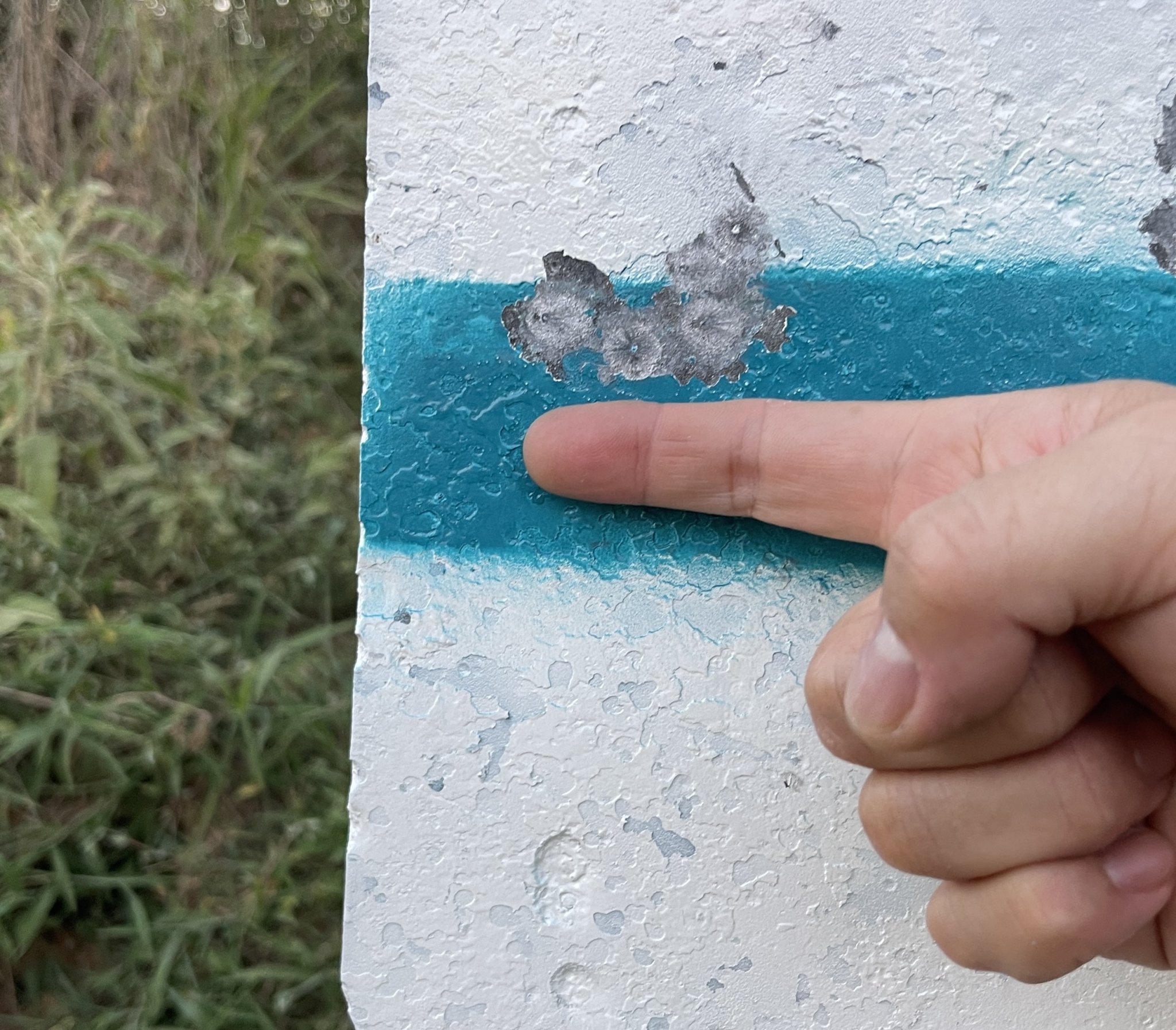

Here is today's target @ 50yd. I scrubbed it clean after putting 500rd down 2 days ago before today's session.
Started with the CenterX bottom row shooting left to right.. it really tightened up after those first few groups..
All 30rd AGG's in the 0.2s with multiple groups in the 0.1s. Smallest group just a hair over 0.100 measuring 0.106.

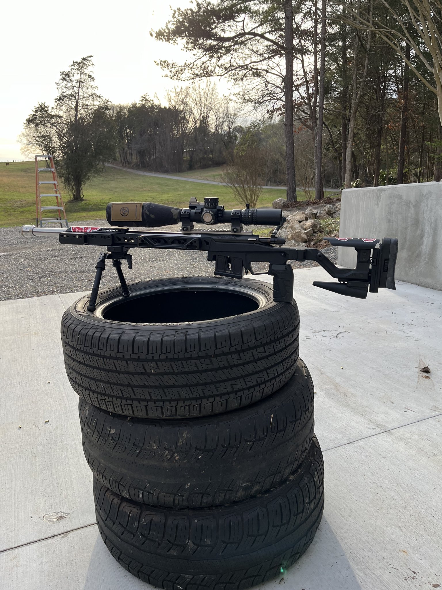

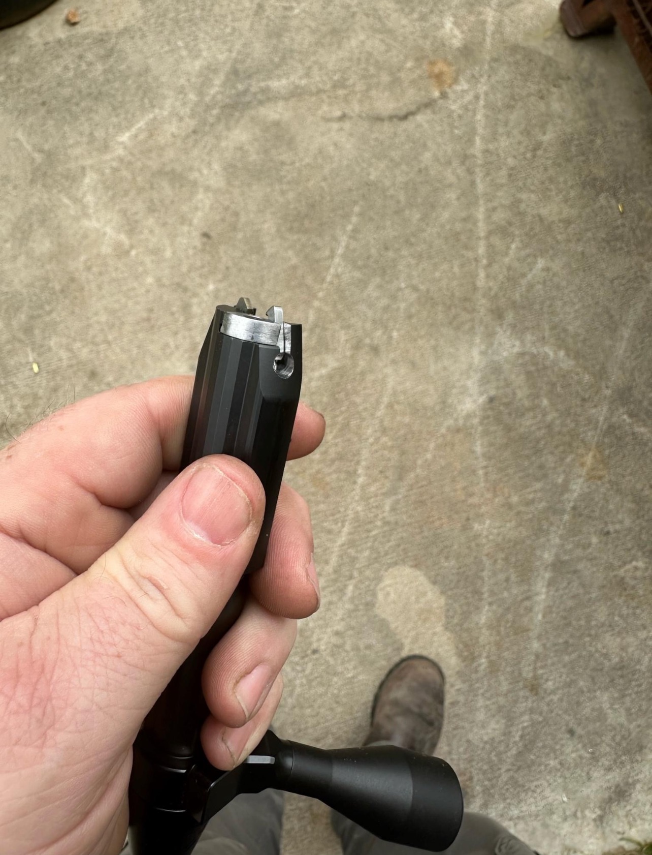

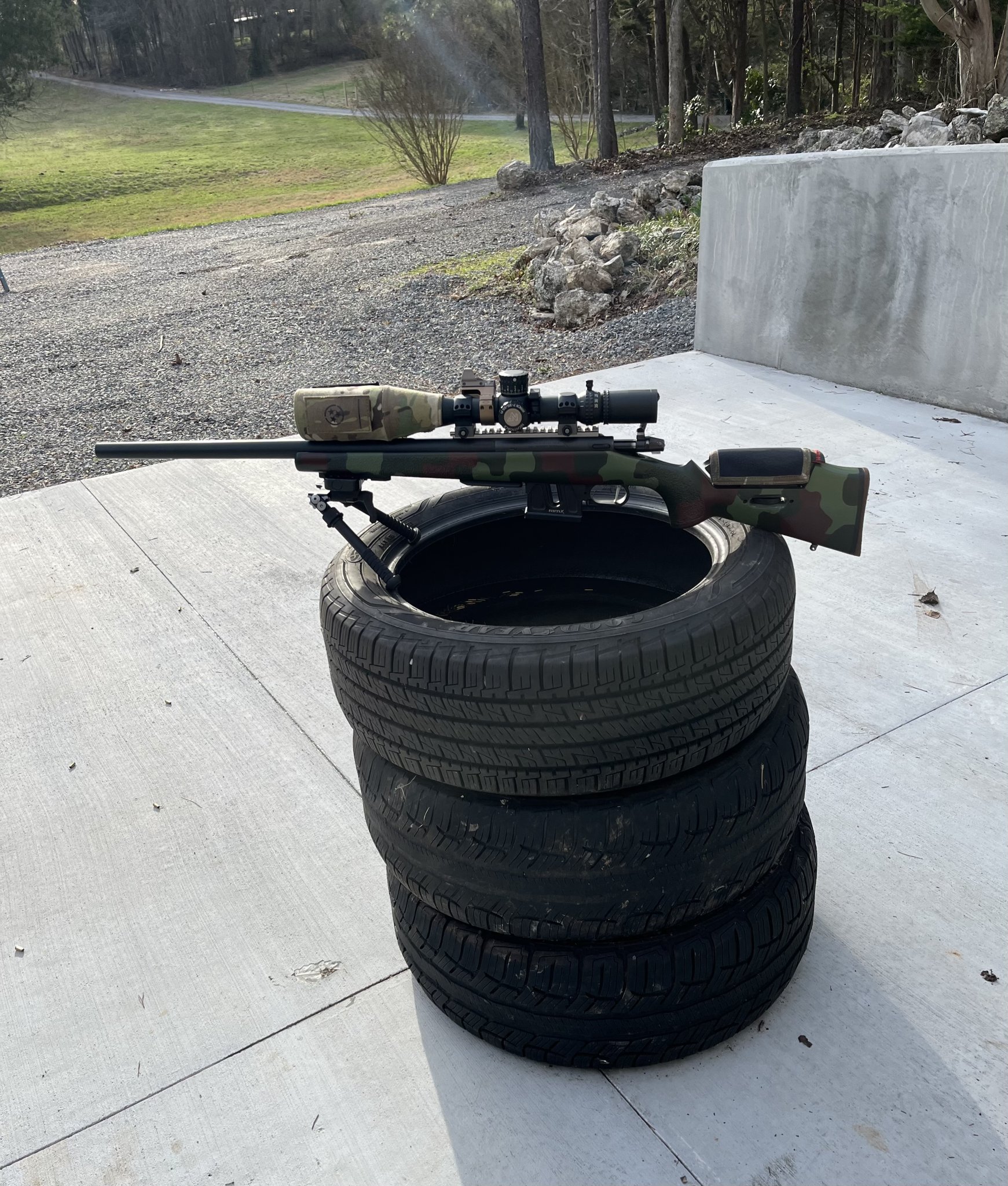

The extractor mod.....things that make you go hmmmm. The RimX in the McMillan has 17,000 + rounds on it. I have had to stop and remove a round ahead of the bolt 3 times and each time I was to blame. Not an issue.
I've heard of knumbnuts knocking the bolt down over the rim of a cartridge and breaking the extractor. No shit! You should know what the result will be every time.
The rifle in the AT-X chassis has 2500 rounds no issues. Here is the key to flawless RimX operation if the bolt has gone forward (contacted the rim of the cartridge) never pull it back. Wait until your in position to shoot (no sky-loading) push the bolt home and go on.
Downgrade to the Zermatt original extractor :ROFLMAO:
I have 2.5 PRS Rimfire seasons on my RimX and maybe less than 5 occurrences of pushing a round in without it under the extractor. Those are rookie match numbers to many but I have a shit load of rounds through my RimX. I’m good with that and find it as a non issue. But what these extractor mods do IMO is take away any special “procedures” that need to be done while on the clock. It’s not a big deal to me one way or the other which style of extraction you want to go with.

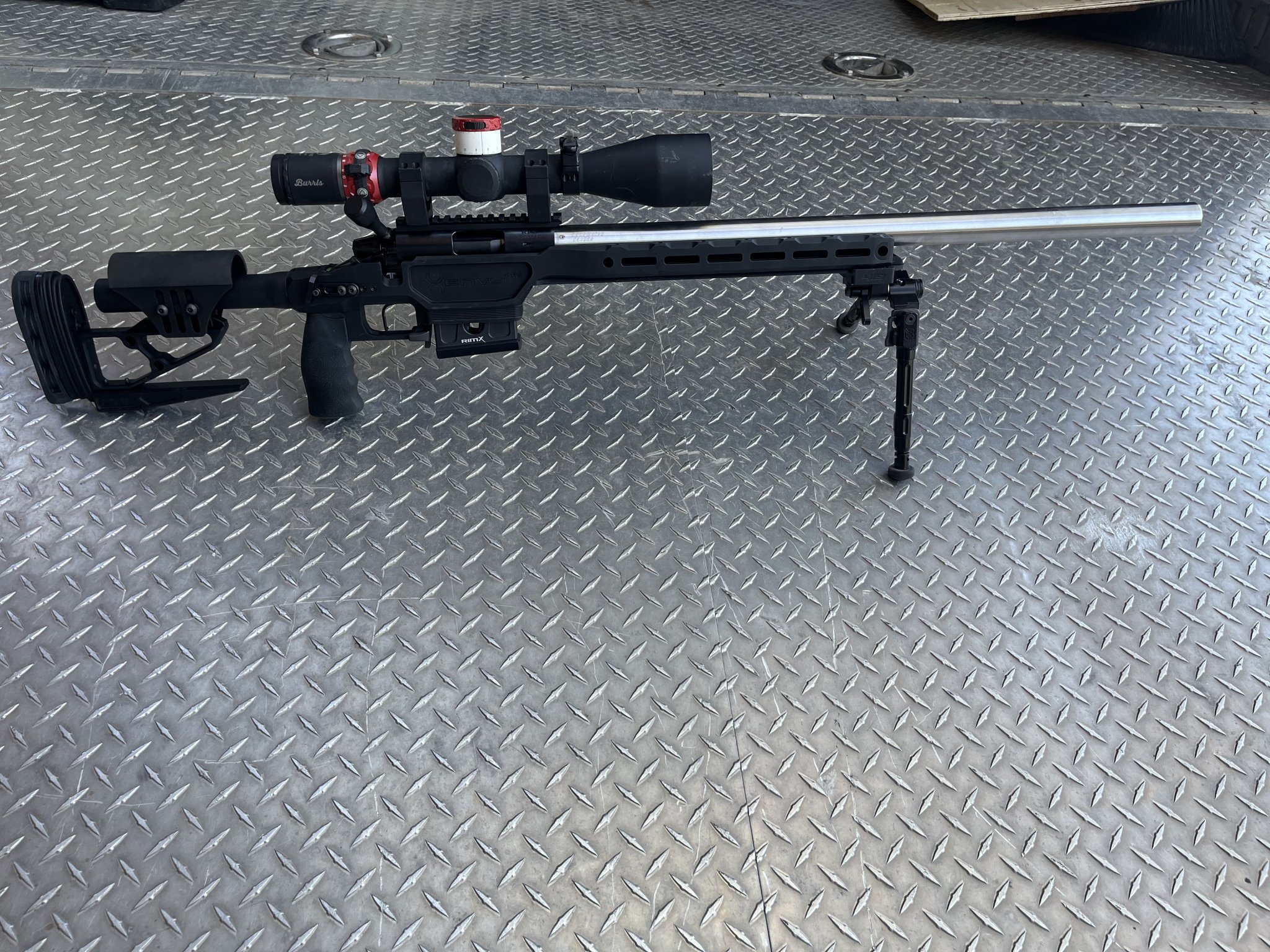

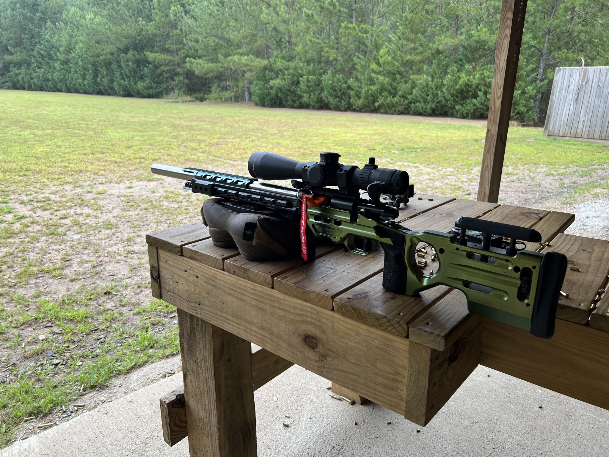

Picked up my first rimx today. Everything on the rifle was picked up used off here. Unfortunately in the middle of moving so likely won’t shoot it for at least a few weeks. Very happy with how it turned out so far. Matches my match rifle balance perfect.
Blown away with how smooth the action is and how flawlessly it cycles rounds from the mag.
Barrel is a Manzella precision green mountain 25” 1.2 straight

These ACE barrels are really hammering! Also nice that the lead times on them are short, even for custom ordered blanks. Manzella has 3 M24's and 1 VCC contour ACE RimX barrels left in stock when I was talking to them yesterday.
